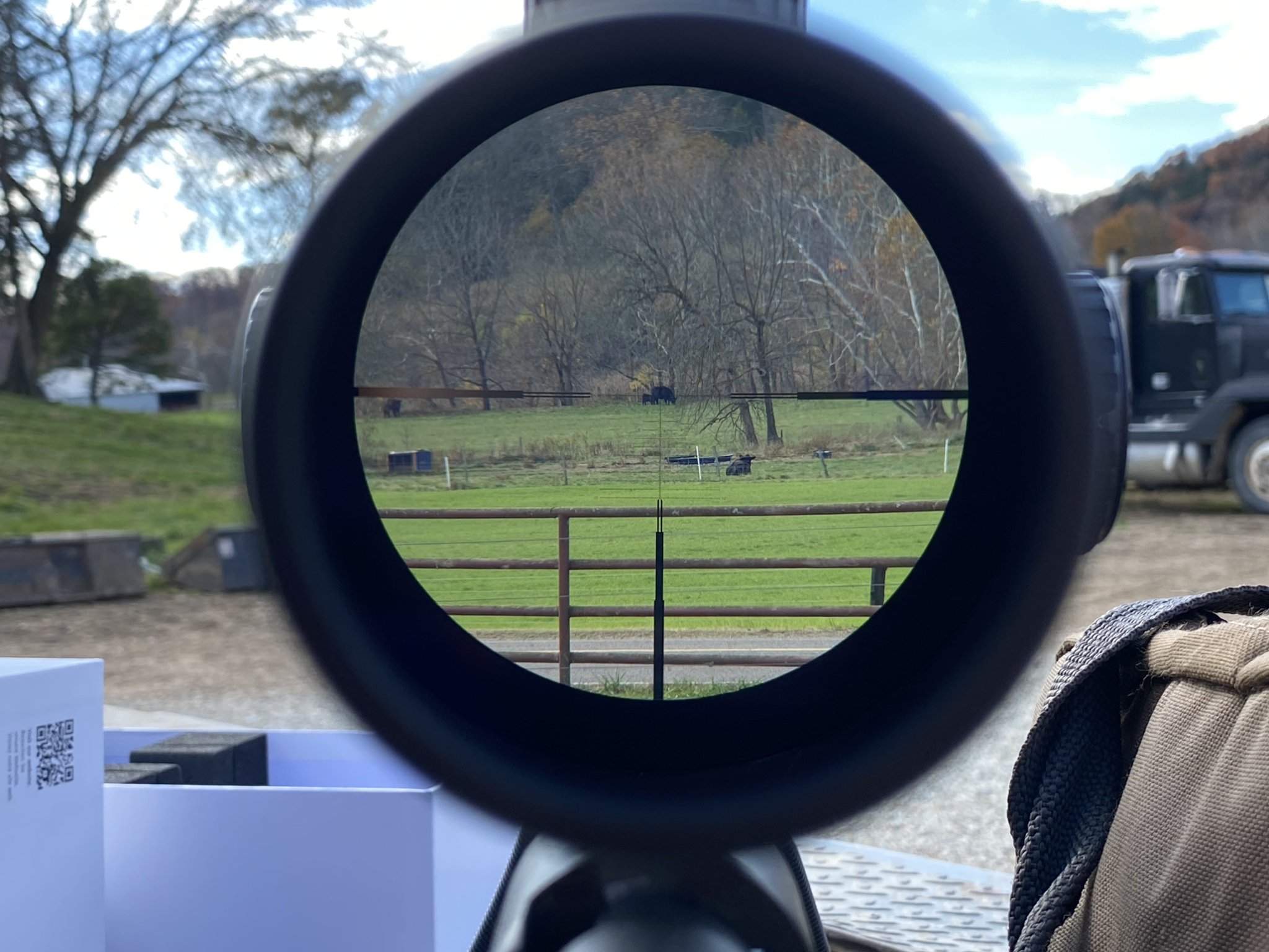

Here's some more anecdotal shots as the lighting was changing quickly. I think what you can see here is both scopes perform damn nicely, even when the sun is directly in front of scope, kinda washing things out. The ZCO and Zeiss at 10x are good examples of having the sun washing things out but still having a good image. Conditions were changing so quickly and the Kahles was obviously outclassed in the glass department so it wasn't included in these pics.

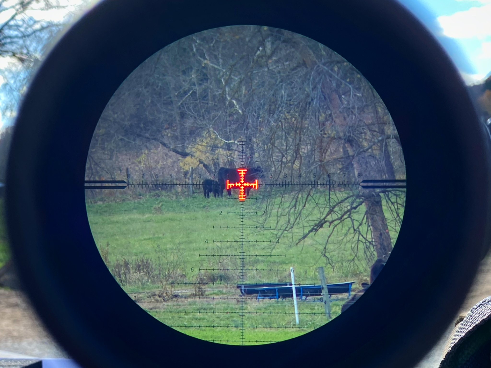

One thing I wanted to include was a shot with the Zeiss and the reticle illuminated at well less than full power. It will get completely daylight blind you bright without substantial bleed and is infinitely adjustable. I don't use an illuminated reticle hardly ever, but this one is well-done enough that I could be a convert.
ZCO at 5x and 10x
Zeiss at 5x, 10x, 25x, and then unknown mag but illuminated
Absolutely agree with the above on the Zeiss. Phenomenal describes it perfectly.
How far out are those bovine?
ETA I missed it in post #56. 650 yards.
I particularly like the clarity between the black trough and the blue metal frame several hundred yards in front, still looking crisp!

“Anecdotal” is a correct assessment so thank you for being honest. Says a lot about you. The first thing I looked at in your images was the sky, that pesky thing around the scope tubes. In the images of the Zeiss the sky is blown out. Not so for the ZCO. That tells me one thing. Whether on purpose via processing or done automatically by your camera, The ZCO images are High Dynamic Range images, the Zeiss ones are not.
HDR images by default, and without processing will soften contrast. They bring detail into the shadows and control the highlights. Less contrast is the unedited result. Color richness is also affected because of lack of contrast.
Look at the fence in the foreground. It points to different lighting conditions. The Zeiss image at 25X is the only one at that magnification. That one is soft. It’s quite possible that the cows were not in the same focal plane as the reticle (parallax in scope terms), or it was an issue with the camera's focus.
All in all, the images are much appreciated. I do expect the Zeiss scope to absolutely dominate in the glass department. I know Zeiss glass well and love it. I look through Zeiss glass (plastic really) 24/7 because I always specify it for my progressive eyeglasses.
If we are going to use photography to compare scope glass it must be done in a strictly controlled environment and parameters spelled out as such. The truth and nothing but the truth kind of thing.
