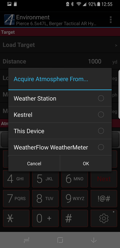

I'm also having major trouble linking an Elite with a S5 phone. Claims it cannot communicate with device, and will not link in Kestrel Link Ballistics app.
Is the pin code on or off?
Tried with pin code on and off. No luck. Kestrel is paired in phone (S5) and shows up on paired list. Every time I try to "Start Kestrel Atmosphere" it gives me an error of:
"Failed to connect:Read failed, Socket might be closed or timeout Read ret-1"
This is a Kestrel 5700 with Link bought through AB....Any ideas??
Don't pair until the kestrel app is open and then pair it inside t he app
Please expand on your answer....
Are you saying the Kestrel 5700 Elite will not work with Applied Ballistics app?
Yes. Because the applied ballistics is built into the kestrel.
To to my knowledge, only the kestrel 4500 is Compatible. If you download kestrel link app you are getting everything you get in applied ballistics mobile but displayed through the kestrel interface. Not sure why this is, I agree I would like to use the weather functions of my 5700 in AB mobile. Maybe Doc will see this and expand on the engineering and probably on a lot of stuff we don't know that makes all this work or not work. My gut tells me this is a kestrel limitation and not applied ballistics.
You are essentially performing a redundant calculation when you run the Kestrel through the app. It has already solved the firing solution, but then you are solving it again. It is much faster to just get it off the Kestrel itself. However the next version of the app already has this feature:
