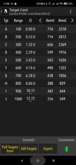

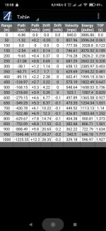

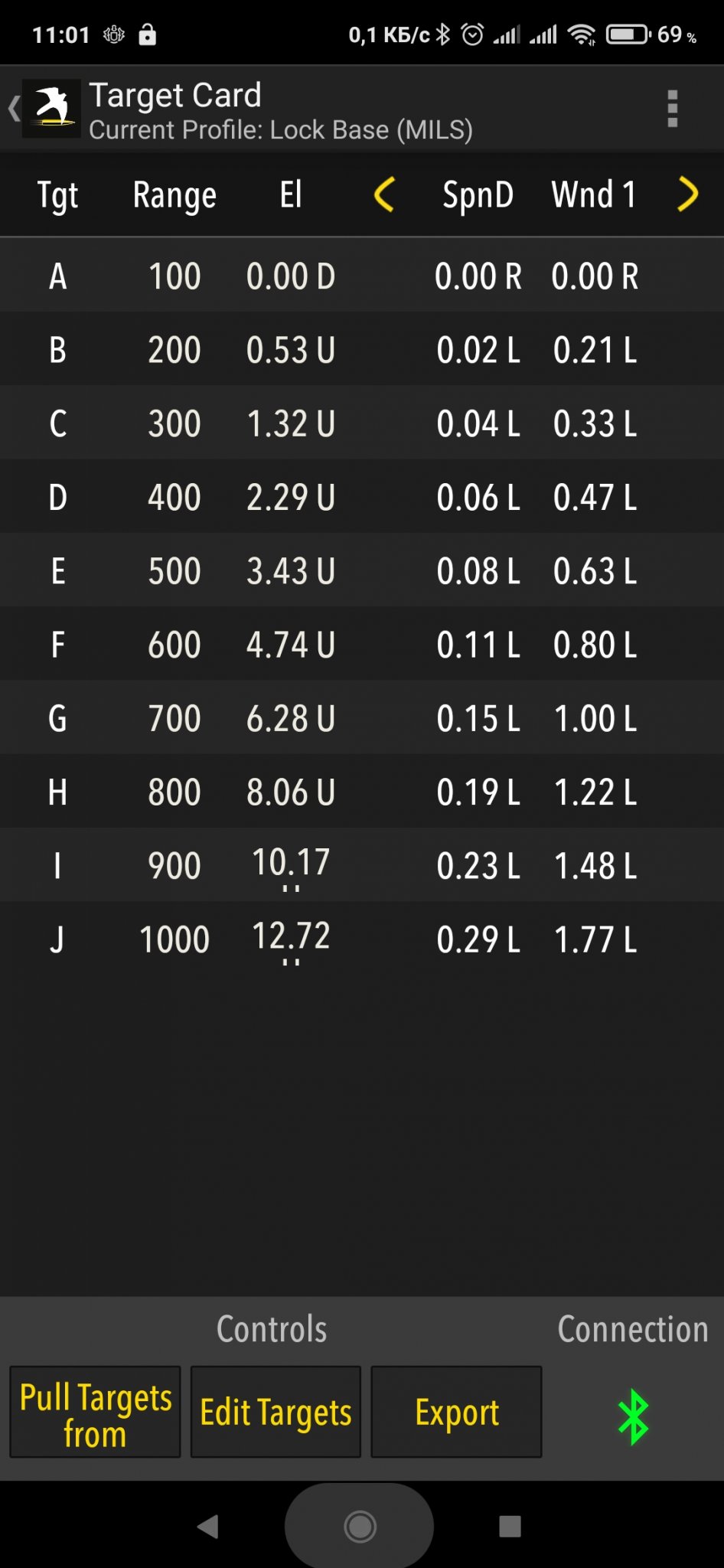

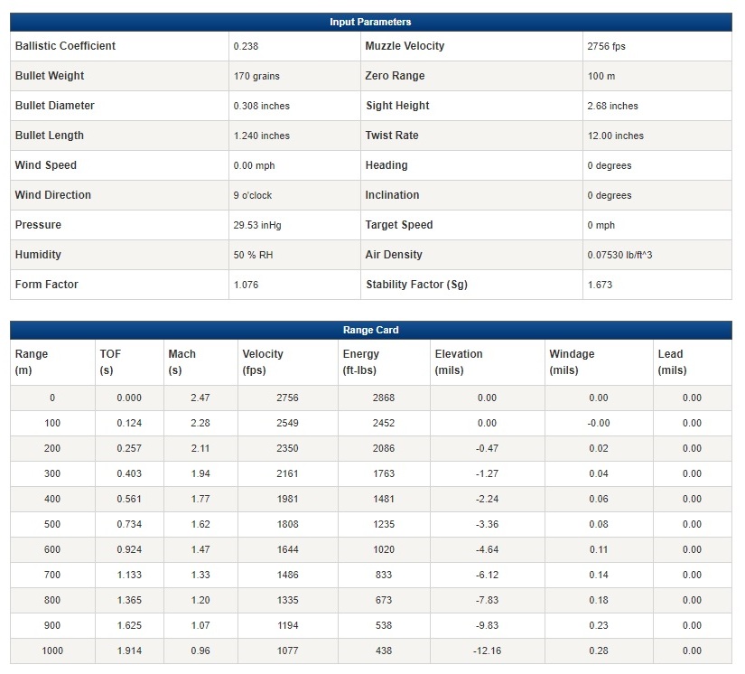

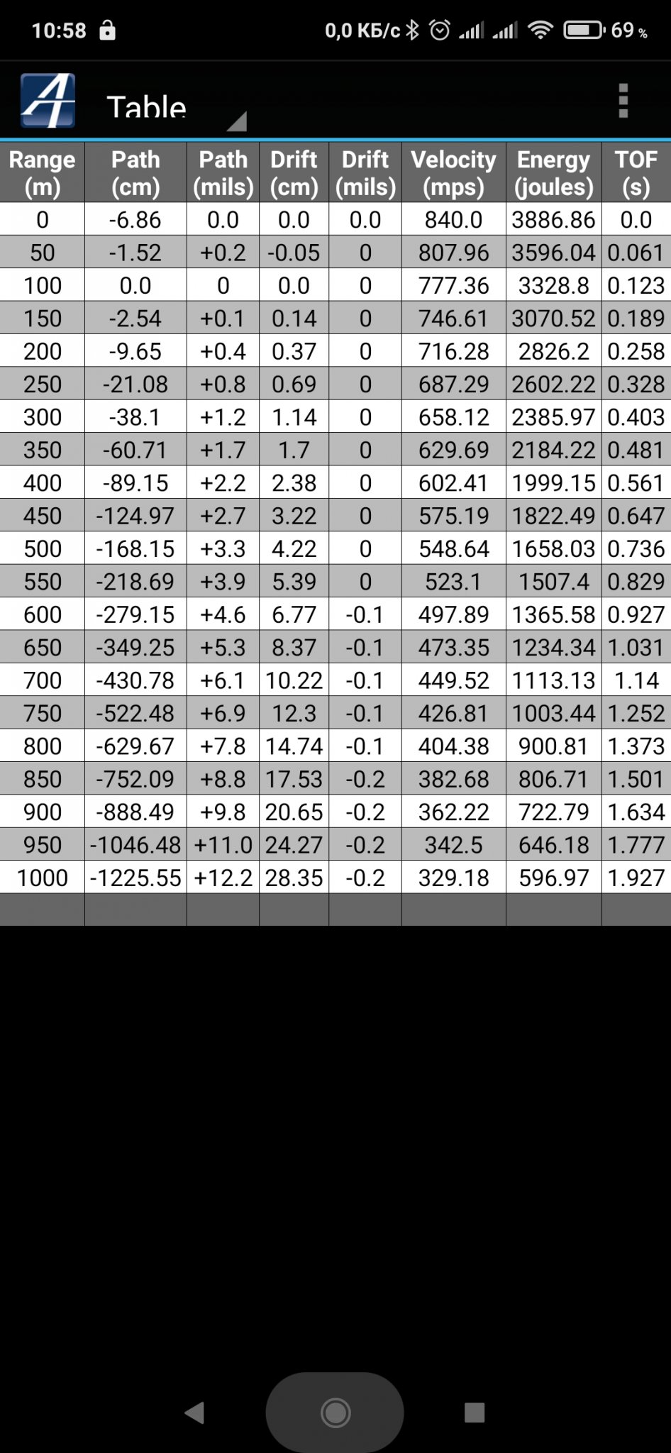

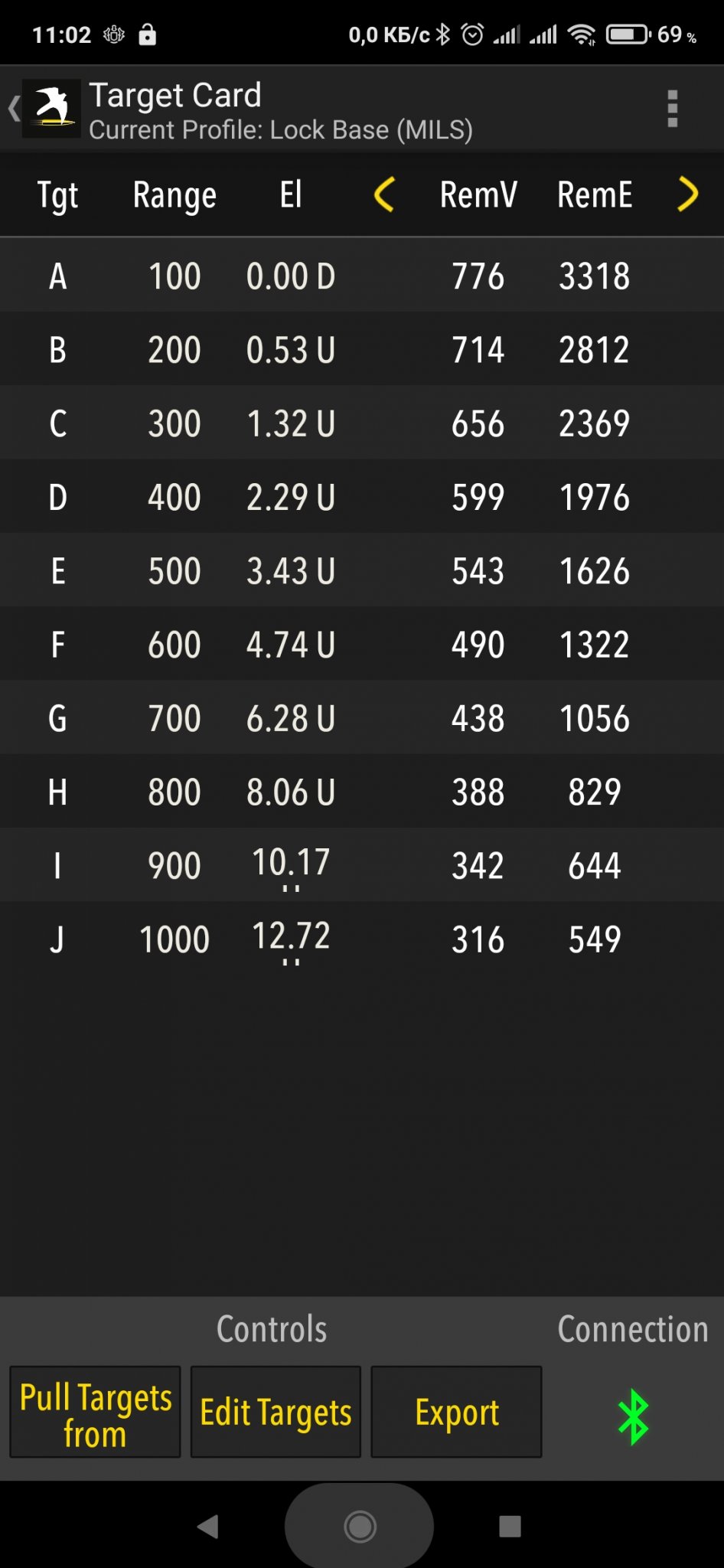

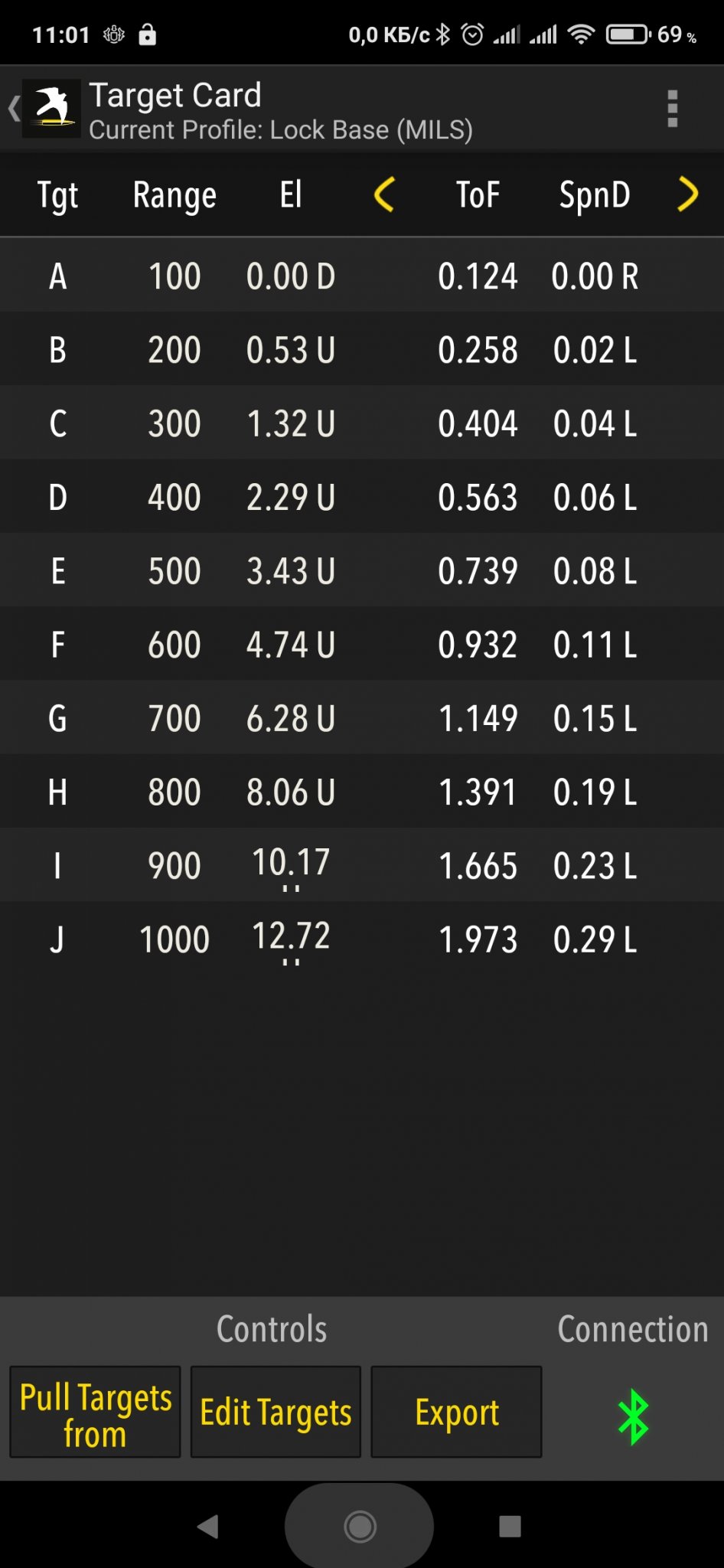

Hello! It's me again. I have Kestrel 5700 Elite with AB. Discrepancy between Kestrel Link ballistics and AB app is about 0.2 - 0.4 mil
All data is the same: gun, bullet, MV, ВС G7(or custom), sight height, spin drift.
The BC is custom on both applications Kestrel Link Ballistics and Applied ballistics.
Discrepancy of elevation adjustment begins an ranges after 550 m.
Temp +15 С
humidity 50%
Baro 1000 hPa
Bullet .308 Lapua Lock Base 170
The BC G7 is 0.238 or custom on both applications Kestrel Link Ballistics and Applied ballistics.
MV - 840 m/s
barrel 26"
Twist 12"R
Scope height - 6.8 cm
Remain velocity, Energy, TOF , do not match with each other in all distances
screenshots Below : left to right
Applied Ballictics Application, Kestrel bBallistics App (Kestrel device the same ), Applied Ballistics web calculator
Can you explayn why is that ?
Temp +15 С
humidity 50%
Baro 1000 hPa
MV - 840 m/s
barrel 26"
Twist 12"R
If you change them both to the same g7 do they line up?
If so it confirms your setups are the same and would point to different custom curve versions in my opinion.
Check your latitude and firing direction are the same in both app & Kestrel.
all the same. If I input the same data and G7 BC , it shows like the same. When I set purchased custom drag from AB App and downloaded custom drag from Kestrel Link Ballistic my elevation adjustment don't match
As I said previously, if the curves match when using g7, then the custom curves are different revisions.
AB maintains and publishes different curves of the same bullet over time, depending on when the device releases the library, and if and when you update your devices can allow the versions to be out of sync.
