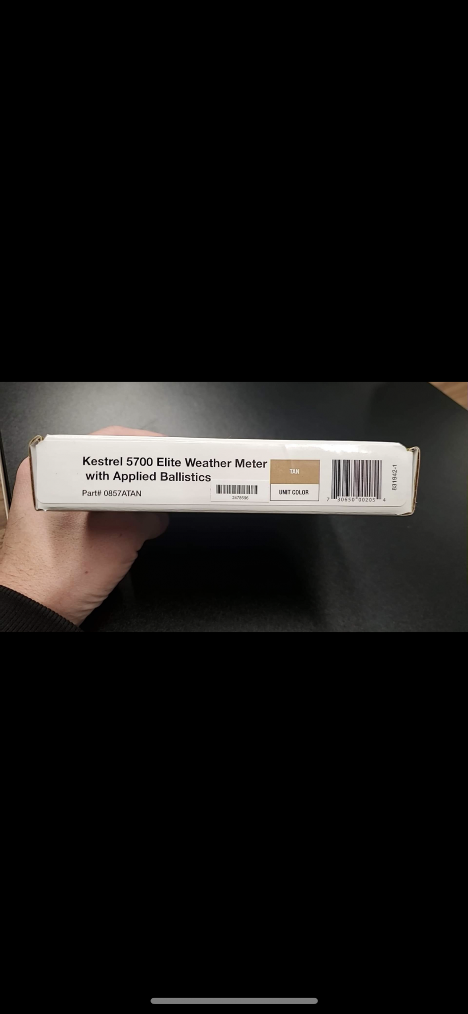

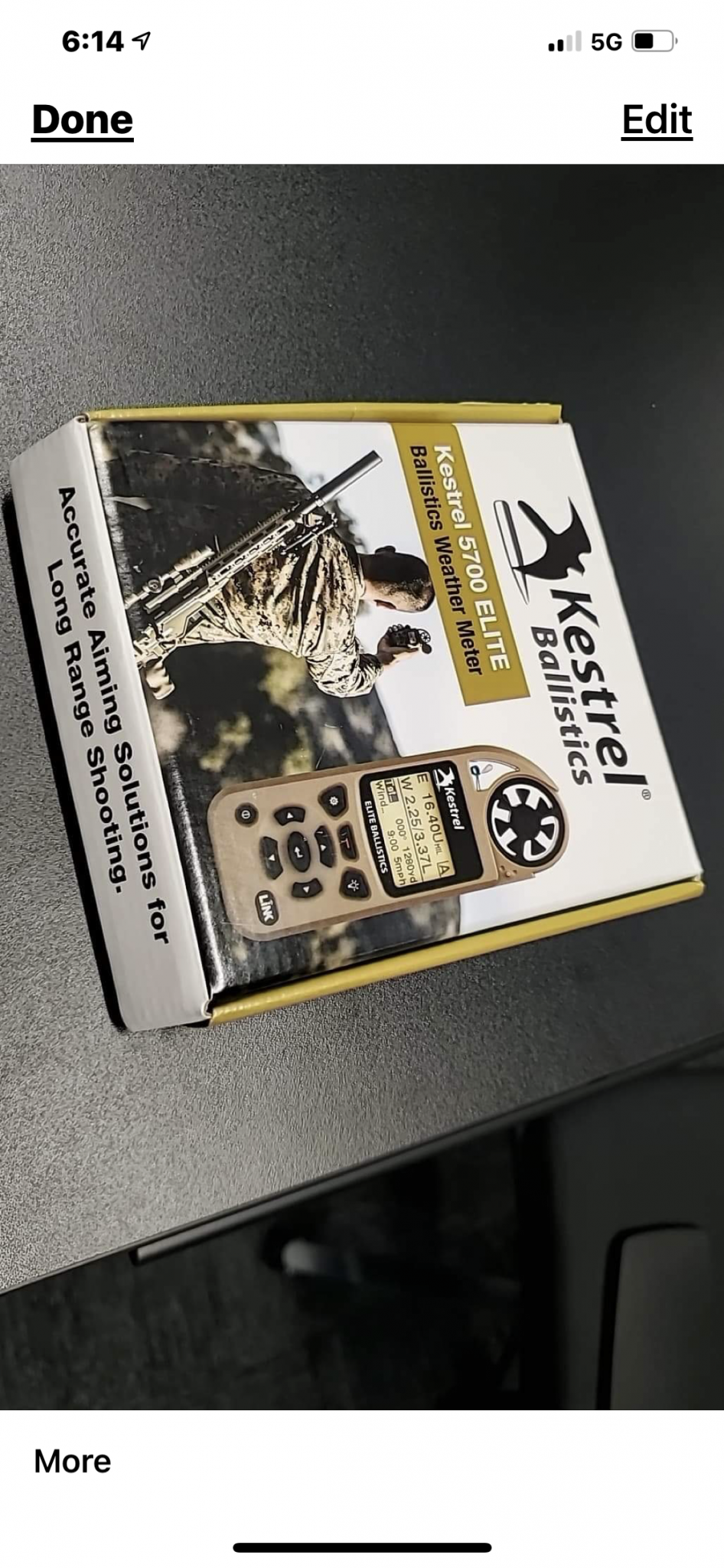

Disclaimer-Complete newb with the Kestrel.
So, I bought my first Kestrel. Wasn’t paying attention and bought one with out Link. Mine says “Elite Ballistics” on the unit. Can Kestrel add link to it?
