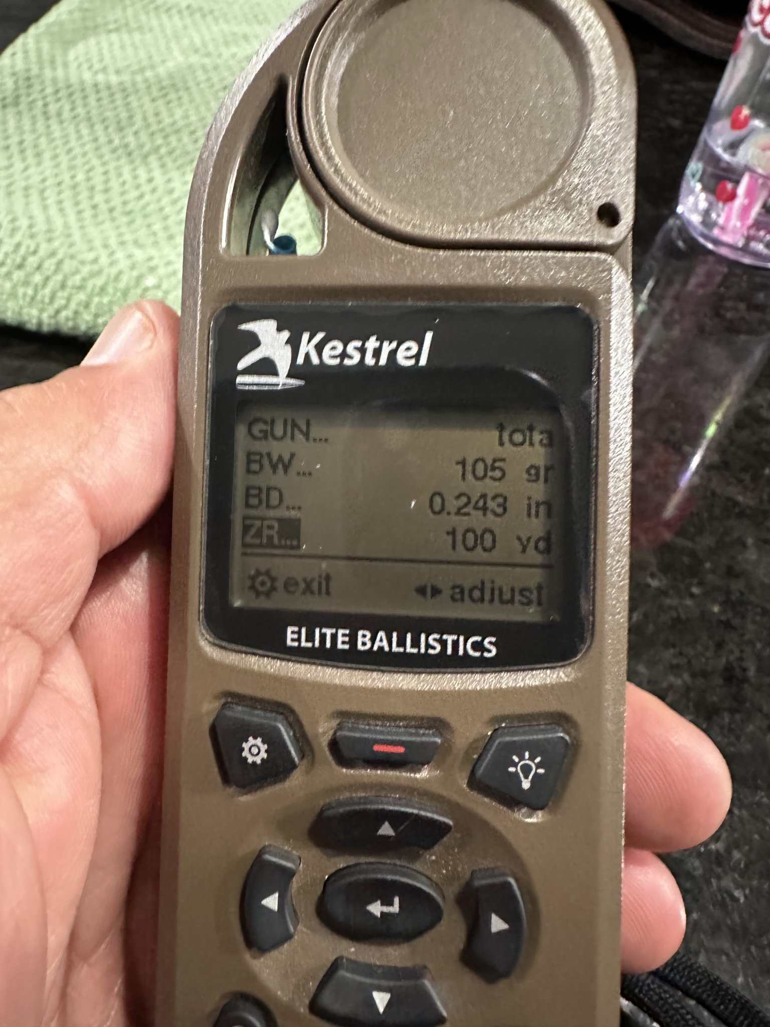

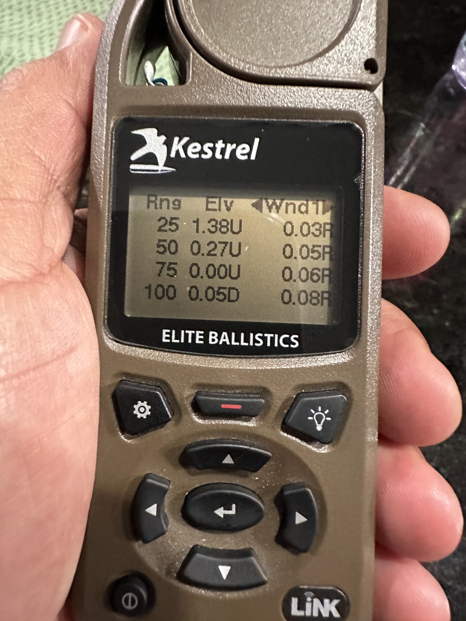

Here is what I get

Here is what I get
Did you take a new DOF and Wind reading or just change and go to the range card? Range card does not update until new reading.
The holds you seen in the range card are holds based on the gun profile and the current environment, so there will be a hold, even at zero distance, because the projectile will have some environmental impact on it. Usually the zero hold is a number so small you can't dial to it, but it shows the meter is processing. I am not sure if you have zeroed at 100 or 200. 100 is recommended as you may have environmental impact on the projectile at 200 yds and that gets baked in so all you holds assume identical impact. AB recommends 100 yds to be impact free.
