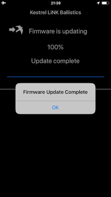

Anyone that had issues with the 1.35 update and Kestrel Hornady 4DOF units, a fix is going to be pushed out later today that will fix the issue with the gun profile transfers. Sorry for the trouble but thanks to all for the feedback so we could address this as quick as we could.
Just downloaded the latest firmware update, and am happy to report that all is functioning well.
Thanks to the crew @Kestrel Ballistics for getting it fixed in a timely fashion.

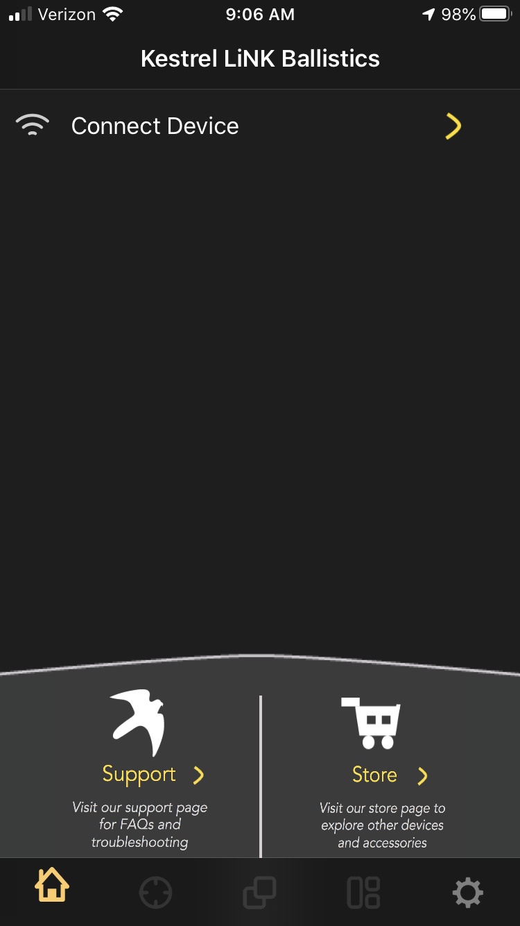

I have a problem with the app downloading like it should. I have deleted it and reinstalled it, watched Kestrel videos to link the device to my IPhone 8, rebooted my phone, nothing helps.
here is what the home screen looks like after the app is downloaded.
It looks like there is not enough options to locate my device.
I noticed I need to turn on flight-mode and disable WiFi to have the app connect to my Kestrel.
If WiFi or Cellular is enabled, the app won't find the Kestrel.
Bingo! Viola!! Winner, winner, chicken dinner!!!
Thanks for your help, and thank you to Kestrel for actually putting this solution into the comments on the app in the App Store.
You're welcome. Happy to help and glad hear that it worked for you.
However, if you do it like that (flight-mode on, disable WiFi) you won't be able to update the Kestrel unit's firmware...
At least I'm not.
Reactions: Lapuapalooza
