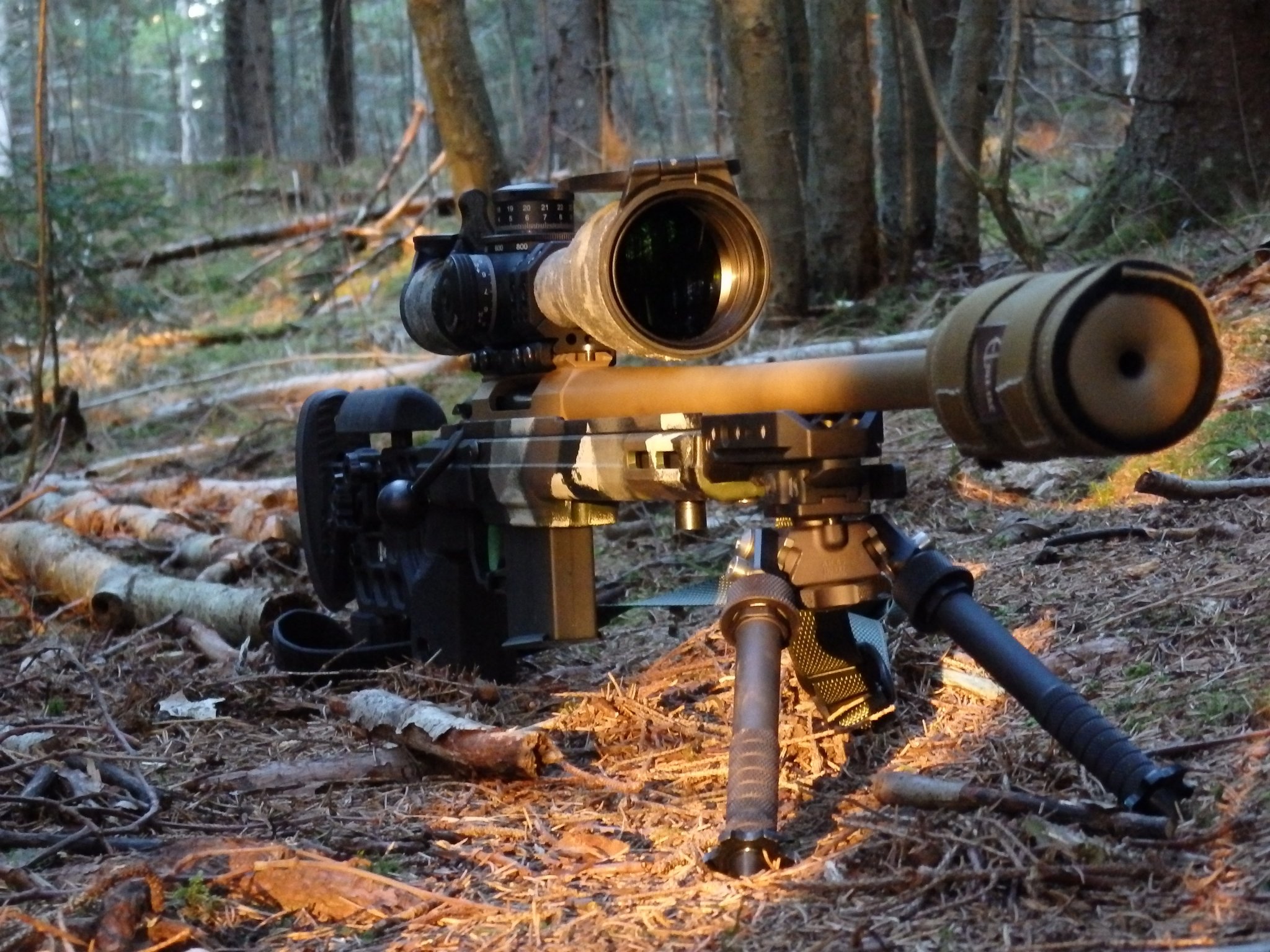

I have a TL3 in one of the newer Bravos (Whiskey 3 backbone), and with a 26" heavy palma profile barrel, Gen 2 Razor, and bipod it weights 15.5 lbs and balances nicely in front of the magazine well, but most of that weight is in the barrel and optic. As you said, if I were to add some accessories to the stock (Arca rail & accessories, spigot, NV bridge, replace the polymer forend with an aluminum one, etc) that weight could pretty easily go up.

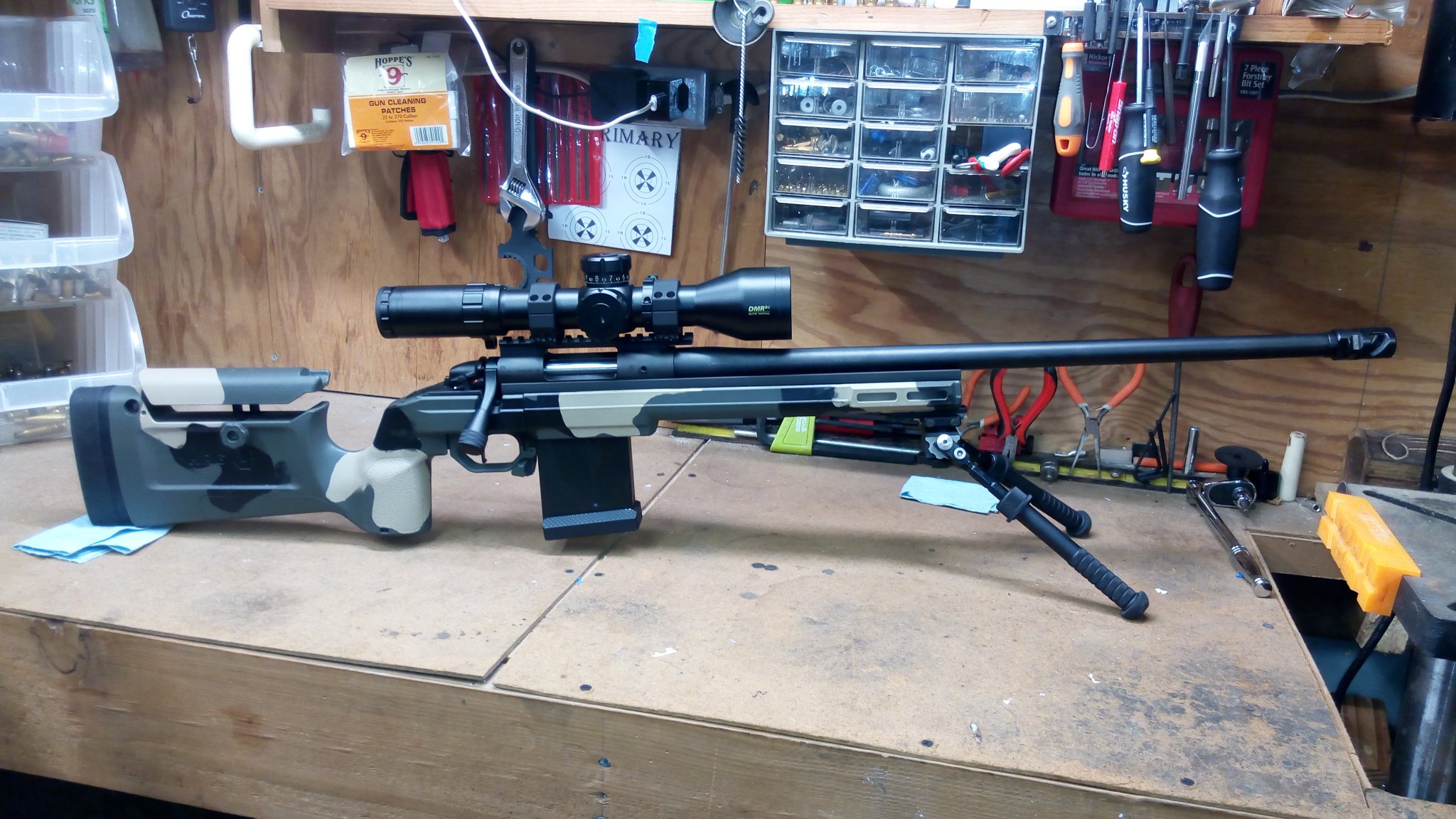

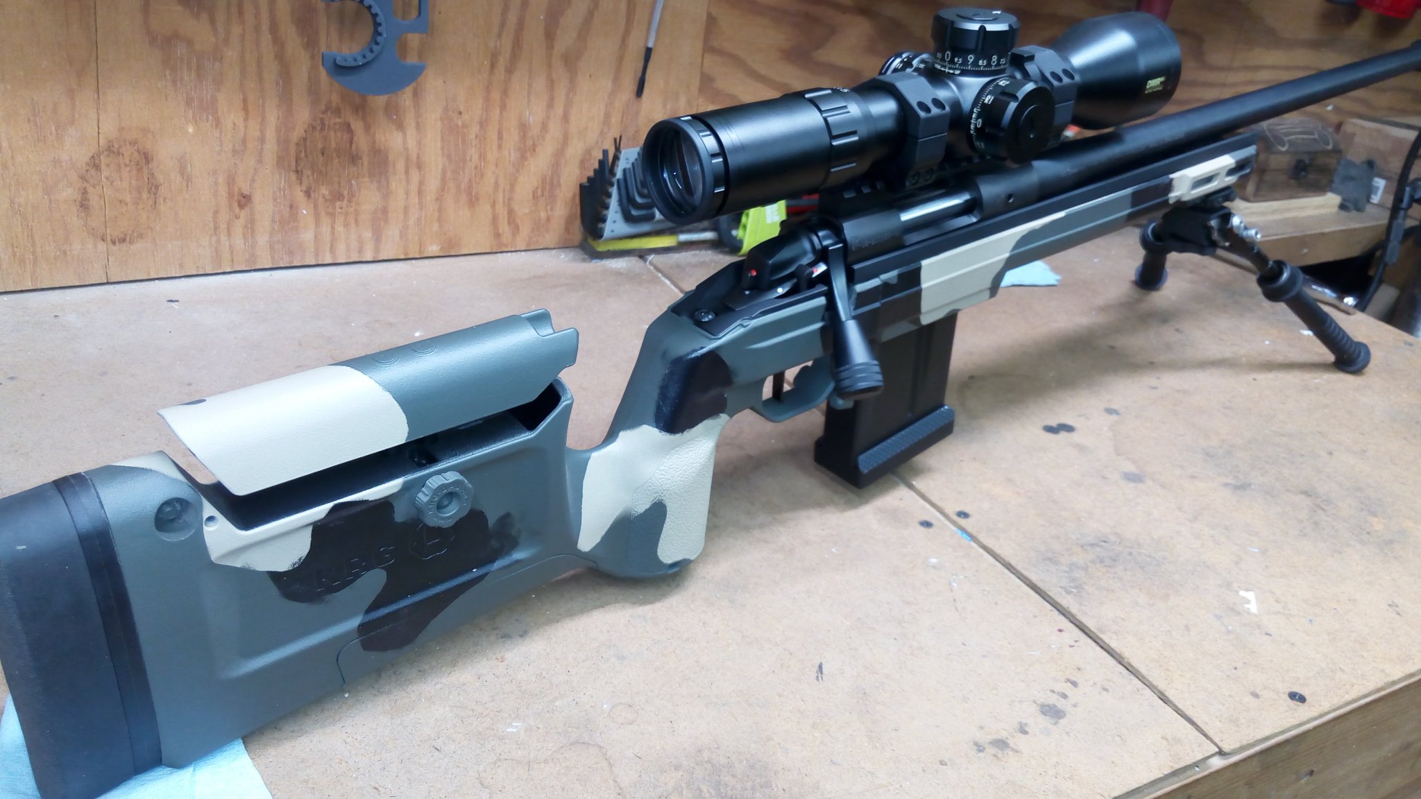

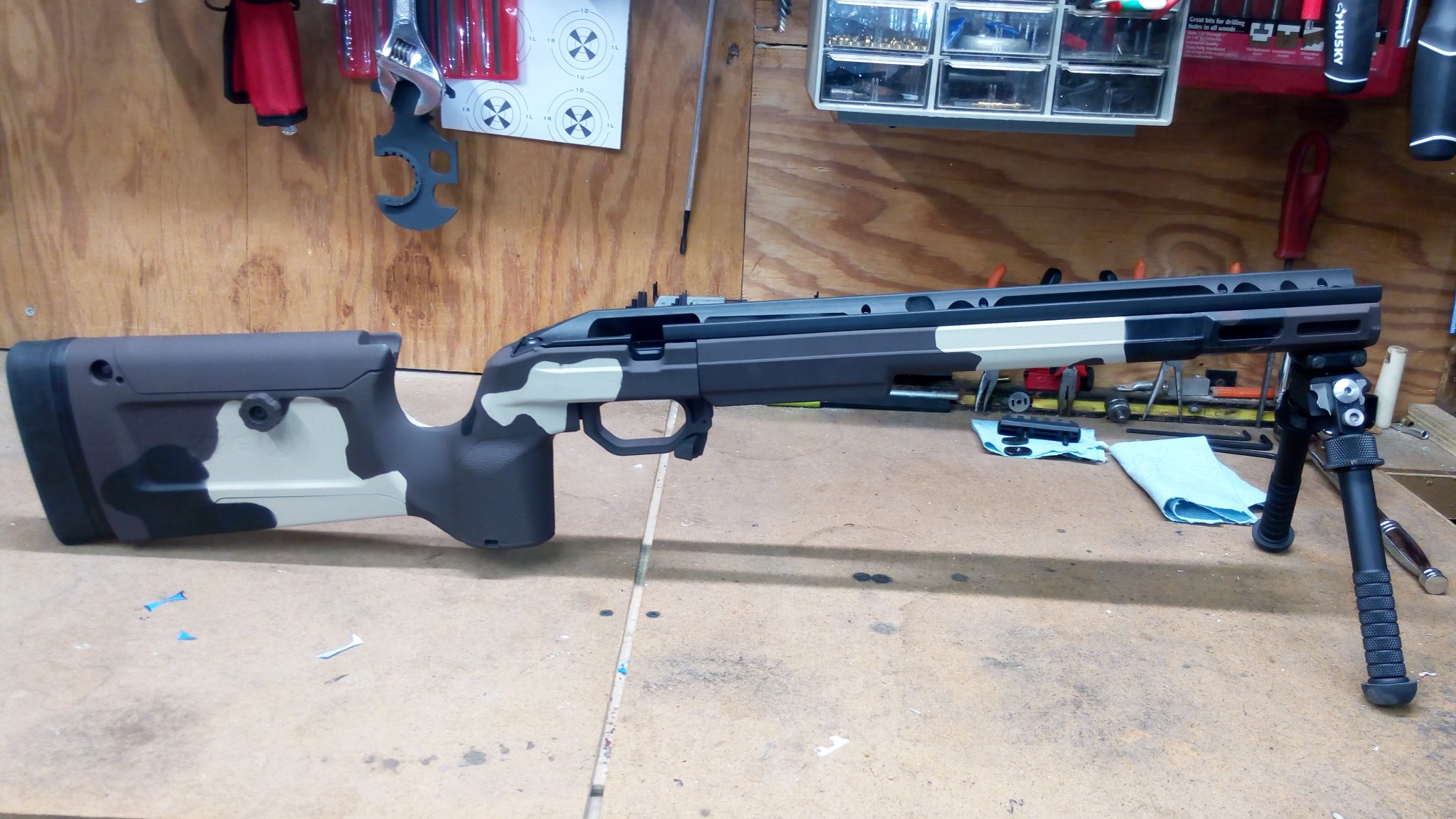

I really like that color scheme on the Bravo. DIY or Cerakote?
Thanks much! I did it myself, I've been getting better and better with my multi cam skills. I practice a lot with different schemes :)
Here was a chocolate milk one I did lol. Wasn't thrilled with it but it would grew on me

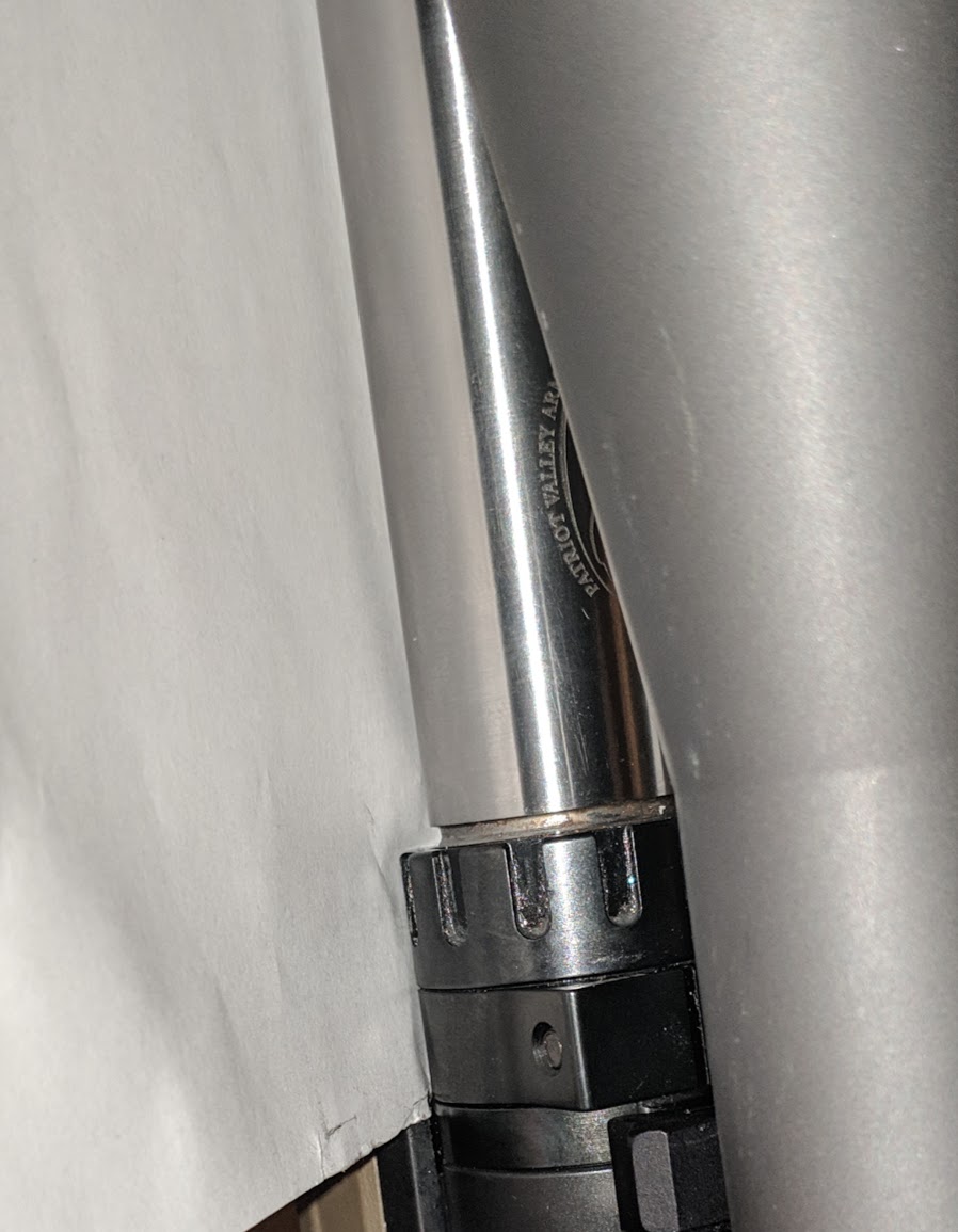

Has anyone tried a Nucleus/Barloc nut in their Bravo, I dropped mine in last night just as a test fit and it looks like the nut will be rubbing against the aluminum backbone.
So I just mounted the Nucleus/Barloc and 100% it does rub the barloc nut. I'm not certain that you can remove enough of the backbone to let it clear and still have the integrity of the backbone. May have to find another way, lose the barloc nut or find a different chassis.

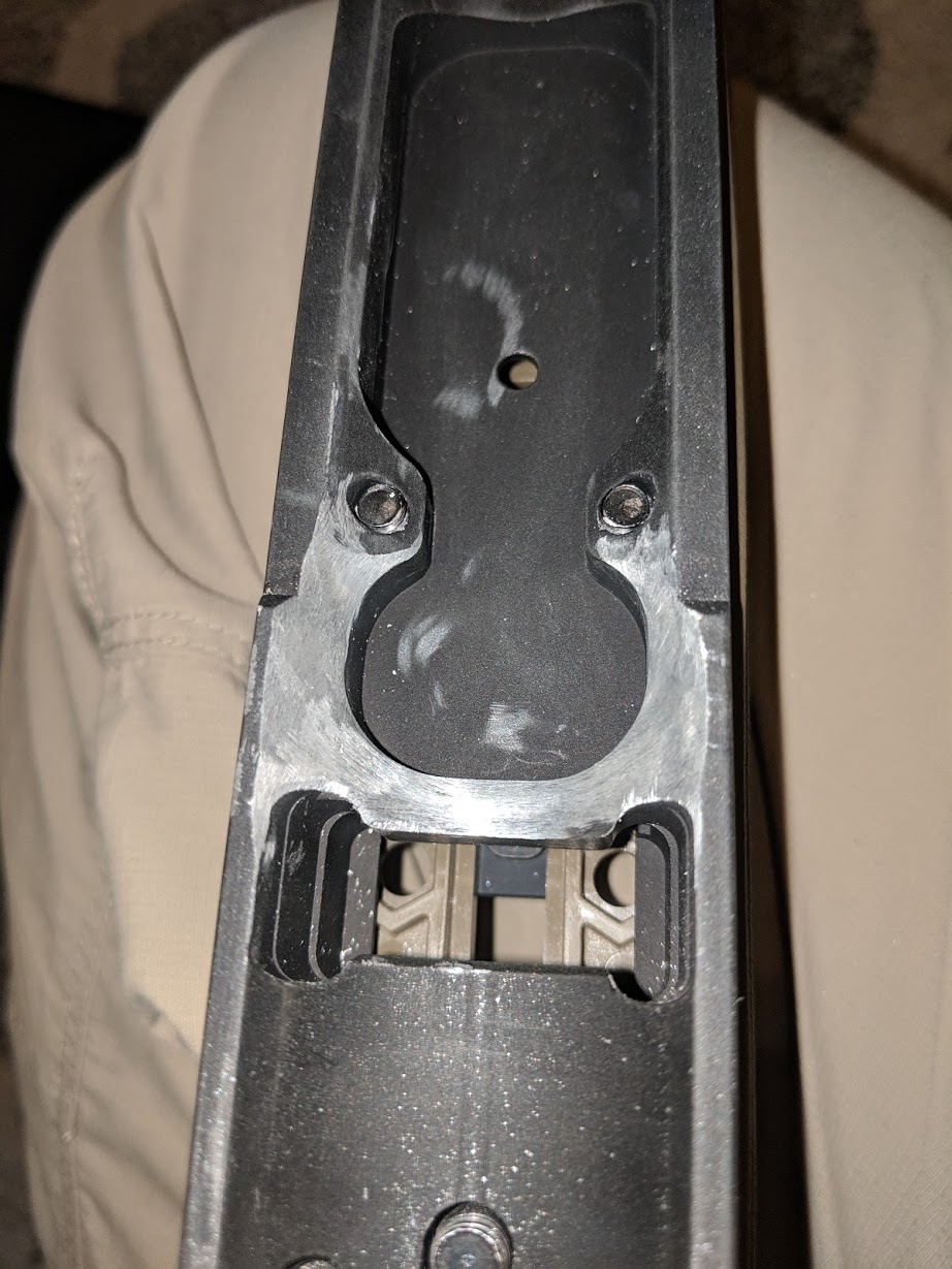

Ok so played around tonight with (gulp) the Dremel and the Bravo chassis, the problem was/is the bravo chassis and the nucleus with a barloc nut are not simpatico (ie lots of contact on nut and aluminum backbone). So after much aluminum flying around in my basement, a nice gash on my index finger, a great idiot mark on the side of the chassis, and some extreme yelling from the wife that I was disturbing family feud... the deed was done. I did this whole project for two reasons number one I wanted to be able to change the barrel without removing the chassis and with the nut touching it complicated things. Number two I had the nucleus/barloc in an MPA chassis and the damn thing shot one hole groups (not an exaggeration), when I shot the same batch of my reloads in the KRG I struggled to get an inch group. Granted I probably had a sh*t day of shooting and it was the native american not the arrow... But I have to blame something.
Here's the pics ps @Massoud you can make it up to me by sending me a spigot mount and possibly a dvd of family feud :)
I will shoot it with a much clearer mind this Friday whilst everyone is shopping and blame it entirely on that damn nut when it returns to one hole.
And yes I am damn salty as hell that I can see threads on my PVA barrel with the Barloc nut.

This situation exists because the barrel you have is made to work with a BarLoc on an action with a much longer (+0.25") tenon than what you are using it on. We have the option to get a Nucleus barrel for a BarLoc with no barrel nut. There is an easy fix for this situation you have, we have an extended flange nut that will cover the additional threads necessary for the other action. And you can still use it with the BL. If you would like to fix the problem please call us Monday. We have the nuts on the shelf.
I am happy to read that it shot 1 hole though.
