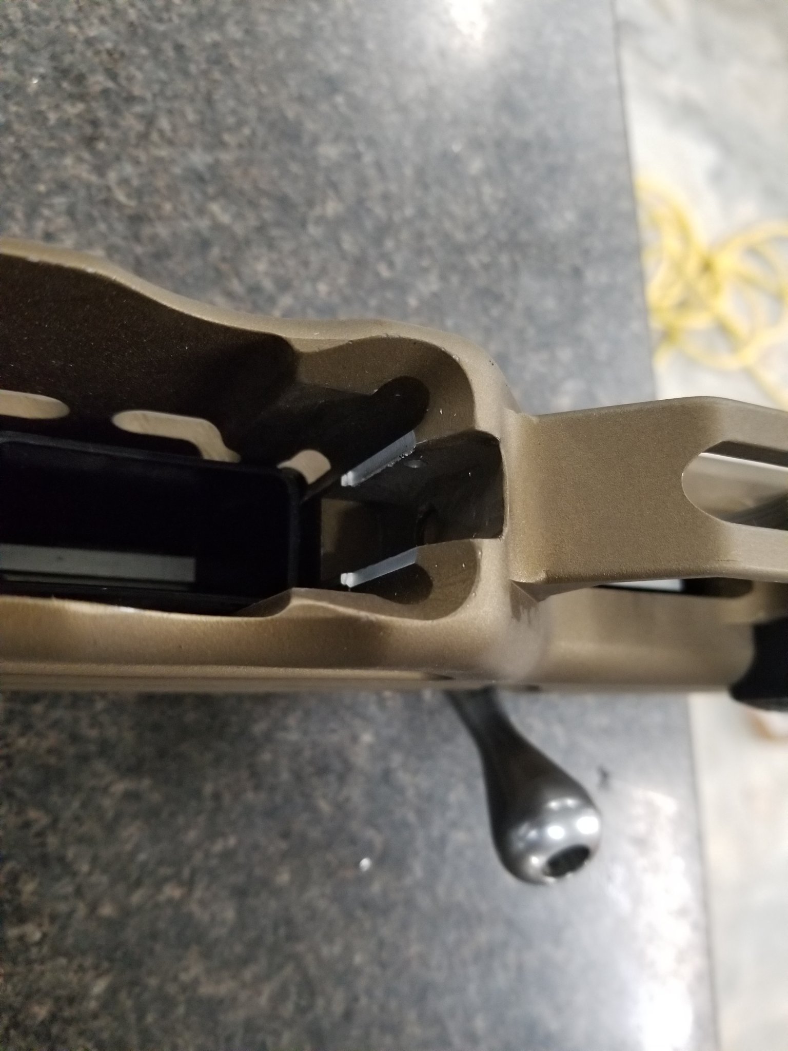

@Bayoubigcat it is not that simple as a magwell adapter, the integral base pad of the T1x mag hits the bottom of the magwell and you need to make a clearance cut like I show on this MPA
However a existing KRG bravo can be made to fit a T1x with a little re-engineering , for more details see my posts in the T1x thread.

@Bayoubigcat it is not that simple as a magwell adapter, the integral base pad of the T1x mag hits the bottom of the magwell and you need to make a clearance cut like I show on this MPAView attachment 6989266
However a existing KRG bravo can be made to fit a T1x with a little re-engineering , for more details see my posts in the T1x thread.View attachment 6989267
