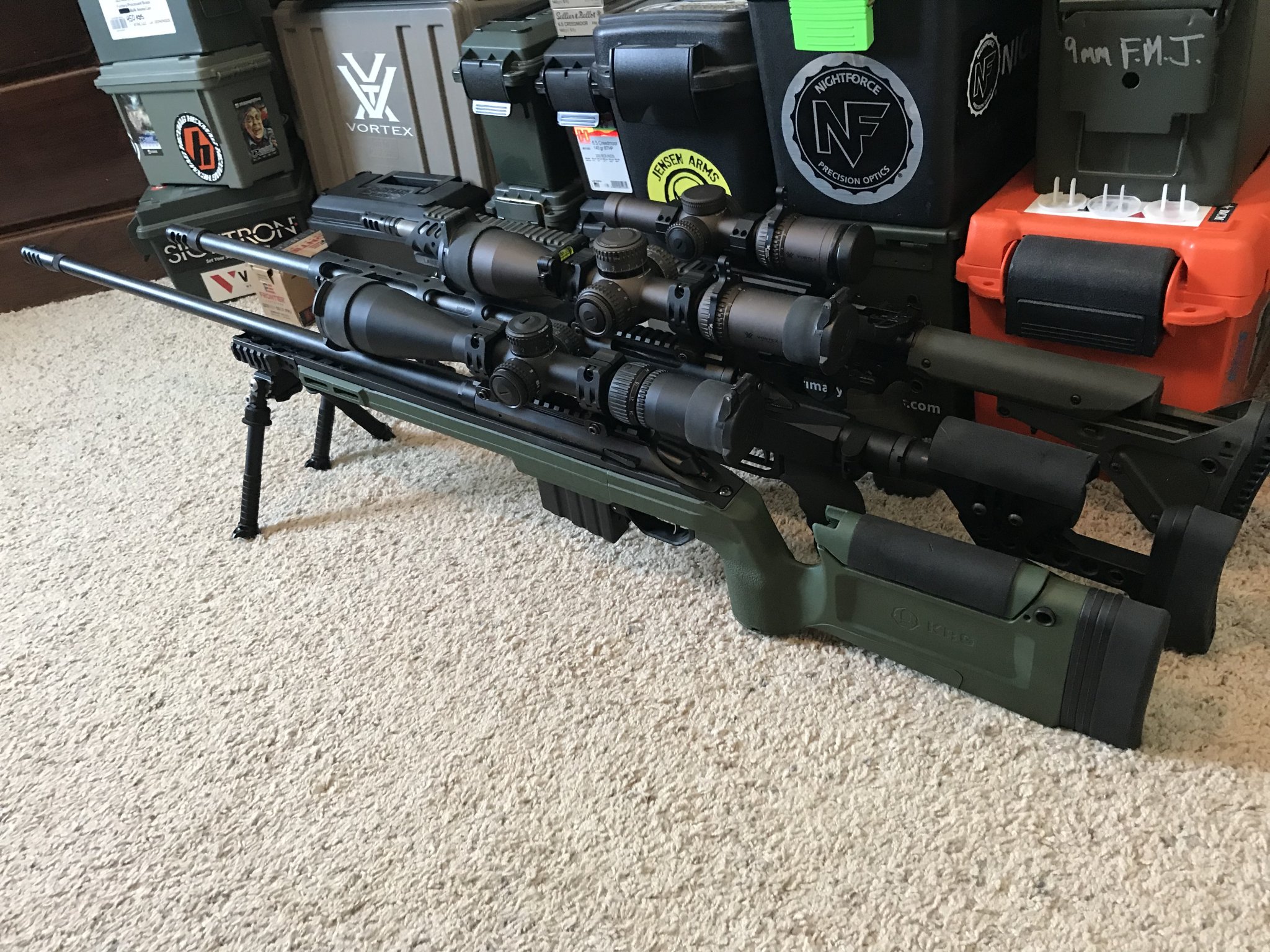

My goal was to get a rifle I could more easily carry in the woods, up and down the creek banks ... but not give up much in terms of sustained rate of fire ...
At the top, the McCree G-10/REM700/Criterion 308 22 inch at 16 LBS 1.4 OZ
And below the KRG Bravo/REM700/Sendero 308 20 inch at 13 LBS 1.8 OZ
So 3 pounds savings ! And I am happy with this weight savings result. I just put the Bravo rifle together today, have not shot it yet, but that will happen shortly. The barreled action came from a $600 off the shelf REM700 SPS TAC AAC-SD and as of right now the bravo stock is 100% out of the box. I will add the flush cup and a sling shortly, but I think that is it until I can come up with a good reason to add more weight. The Spuhr A-700 NV mount will be added to the spuhr mount once I can get my hands on one. That's another 7 OZ but required for me to make this rifle 100% night capable.

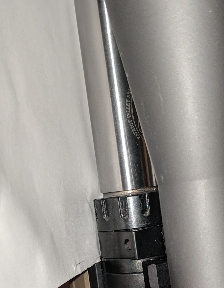

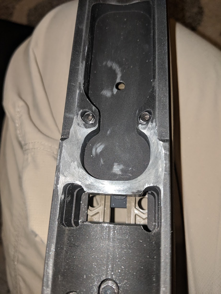

Ok so played around tonight with (gulp) the Dremel and the Bravo chassis, the problem was/is the bravo chassis and the nucleus with a barloc nut are not simpatico (ie lots of contact on nut and aluminum backbone). So after much aluminum flying around in my basement, a nice gash on my index finger, a great idiot mark on the side of the chassis, and some extreme yelling from the wife that I was disturbing family feud... the deed was done. I did this whole project for two reasons number one I wanted to be able to change the barrel without removing the chassis and with the nut touching it complicated things. Number two I had the nucleus/barloc in an MPA chassis and the damn thing shot one hole groups (not an exaggeration), when I shot the same batch of my reloads in the KRG I struggled to get an inch group. Granted I probably had a sh*t day of shooting and it was the native american not the arrow... But I have to blame something.
Here's the pics ps @Massoud you can make it up to me by sending me a spigot mount and possibly a dvd of family feud :)
I will shoot it with a much clearer mind this Friday whilst everyone is shopping and blame it entirely on that damn nut when it returns to one hole.
View attachment 6973280View attachment 6973281
And yes I am damn salty as hell that I can see threads on my PVA barrel with the Barloc nut.
How much did you end up removing? I’m about to do the same build just with an origins action. I’m not sure if I want to remove that much material.

This situation exists because the barrel you have is made to work with a BarLoc on an action with a much longer (+0.25") tenon than what you are using it on. We have the option to get a Nucleus barrel for a BarLoc with no barrel nut. There is an easy fix for this situation you have, we have an extended flange nut that will cover the additional threads necessary for the other action. And you can still use it with the BL. If you would like to fix the problem please call us Monday. We have the nuts on the shelf.
I am happy to read that it shot 1 hole though.
Oh I bought this barrel before the Barloc was a thought and it looks perfect with the PVA nut it came with :), I jest when I say seeing the threads is an issue (although I may hit you up on that nut since there is an easy fix). Your barrel is truly the easiest to clean, best shooting 260 barrel I have ever had the pleasure of owning and it just keeps getting better, I really want to get ahold of a 6 Creedmoor from you guys at some point.
Back to the KRG Bravo its really impossible to beat this stock at the price its offered, I am about to get another in Sako Green left handed for myself.
It really wasnt that much material to remove but its going to require a Dremel. I am about to buy an Origin LH and the exact same stock and setup if it was that terrible I certainly wouldnt sign up to do it again lol.
