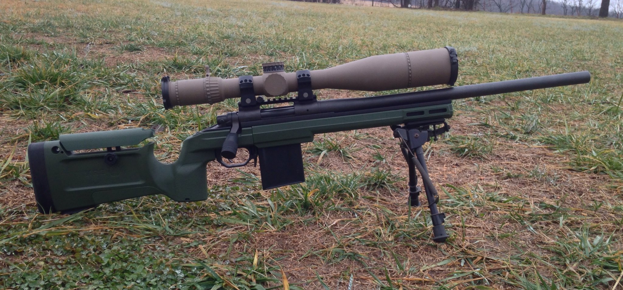

Got mine today, had a couple questions and got a call from KRG and the guy was VERY helpful, ordered from Bison Tactical and they were very helpful and insane fast shipping. FN raining today so I'll have to play tomorrow. Spigot and Harris mount should be here Monday. Might paint the cheek piece and lop spacers to match the scope.

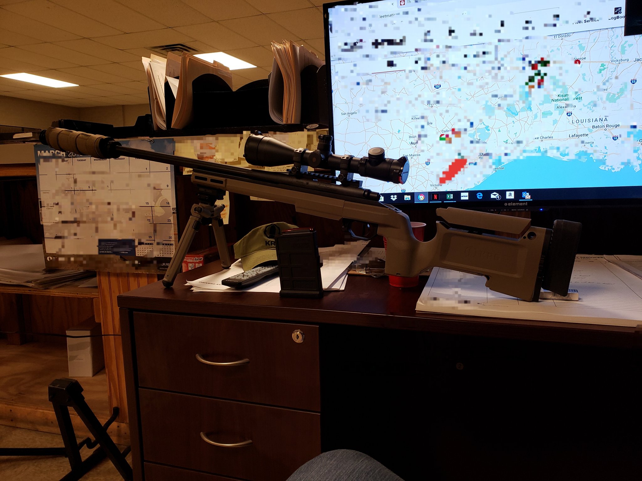

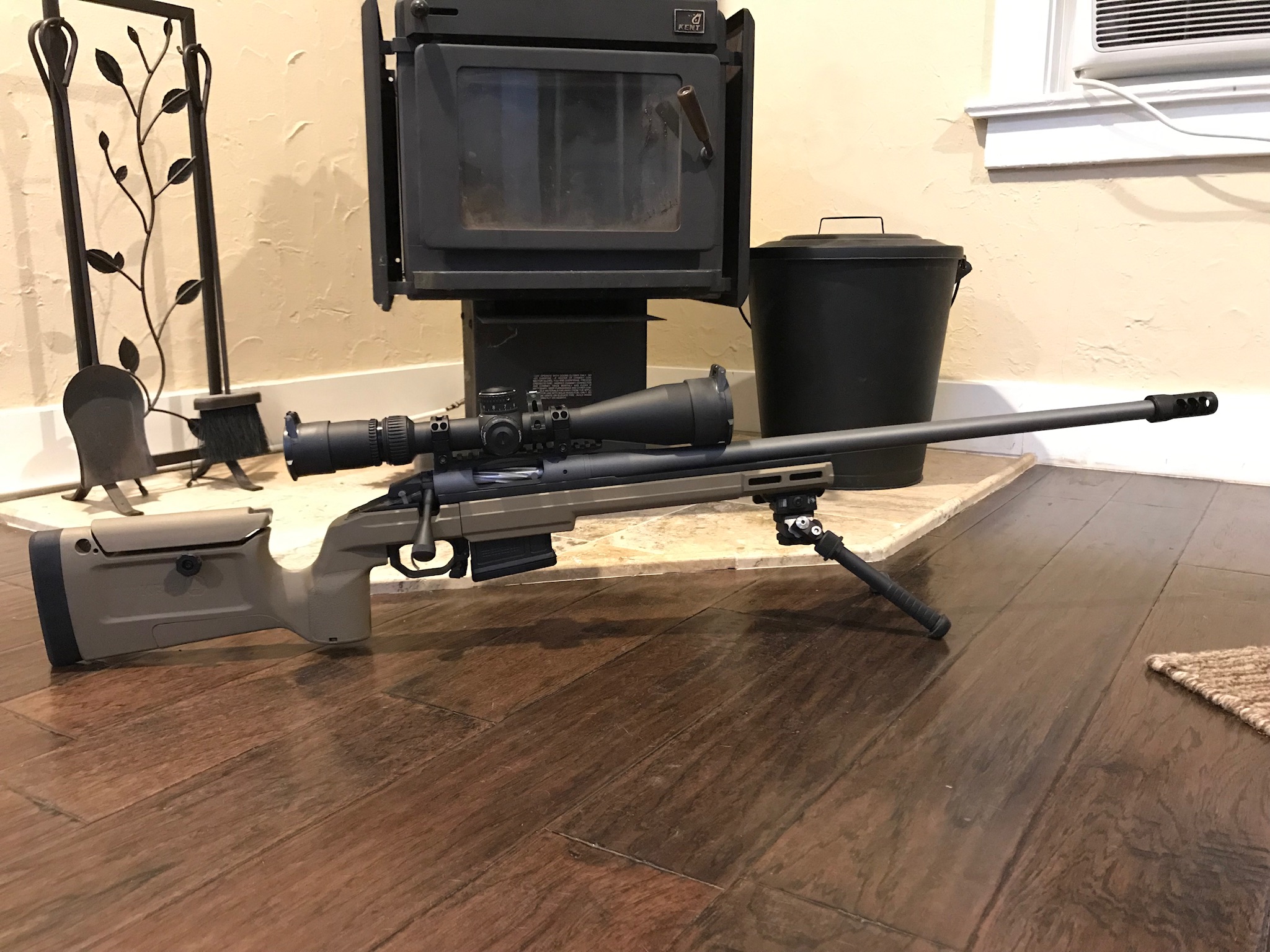

Just received my KRG Bravo in FDE for my Bergara HMR Pro action/barrel. Very simple install follwoing the directions and it looks the business. I was a little bummed that the included MOE L2 rail was polymer since I'm using it for my Altas PSR Bipod. I guess I should have looked a little closer at the included parts list and asked the question. I would have ordered the metal one at the time, had I known.
The stock is solid and the ergo's for neutral grip are excellent. Can't wait to shoot it.
I know this has been discussed previously, but make sure you have the correct extended hex bit if you plan to torque the front action screw to spec. Luckily I have a large tool selection at home, so I had something already.
Hope to have some pictures to share some time this week
Yes, I just placed an order for the metal L2 and the Hook Filler piece. I was also hoping to pick up the spigot filler, but they are out of stock and it doesn't look like any of the KRG online retailers carry this piece.

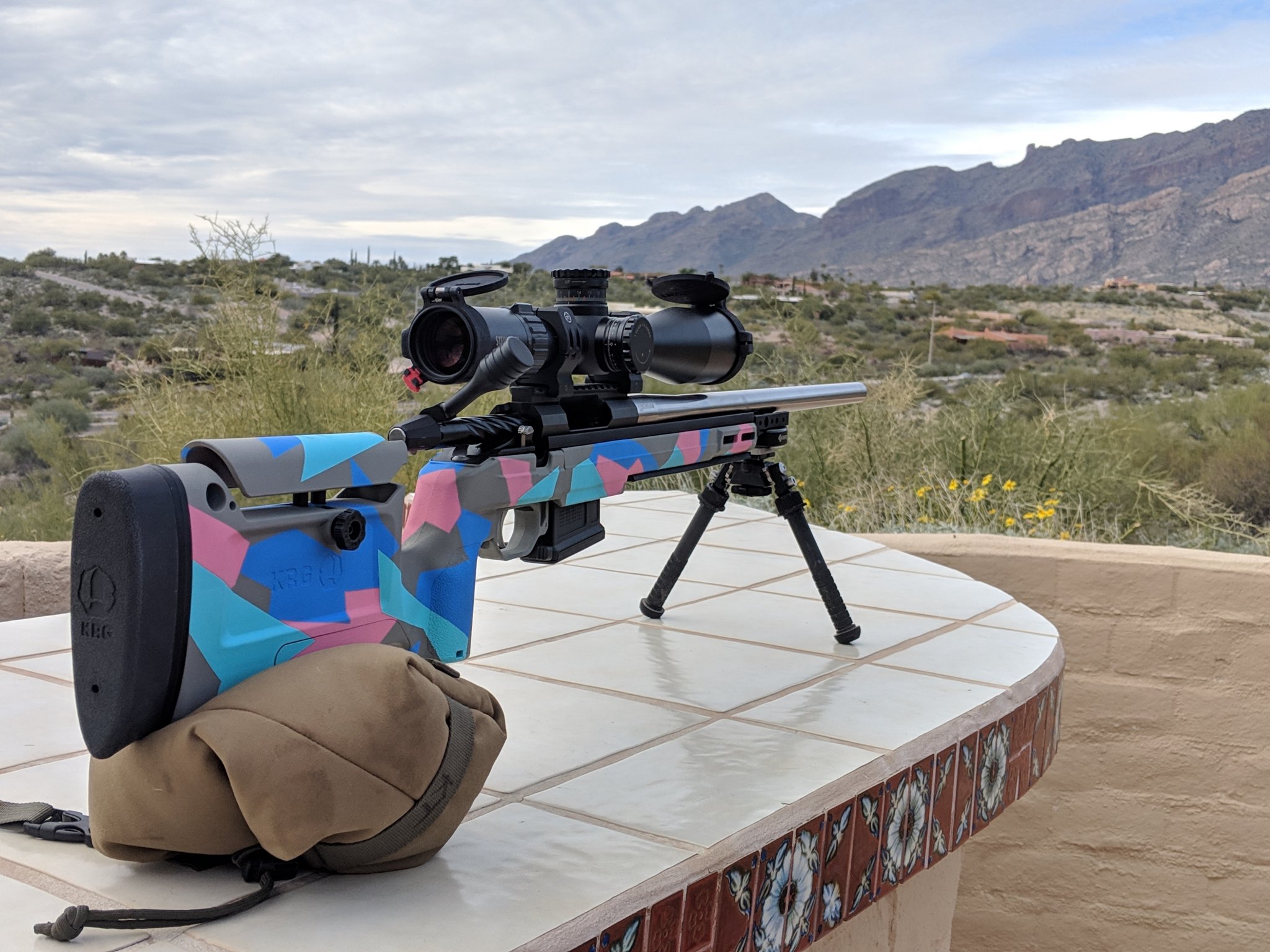

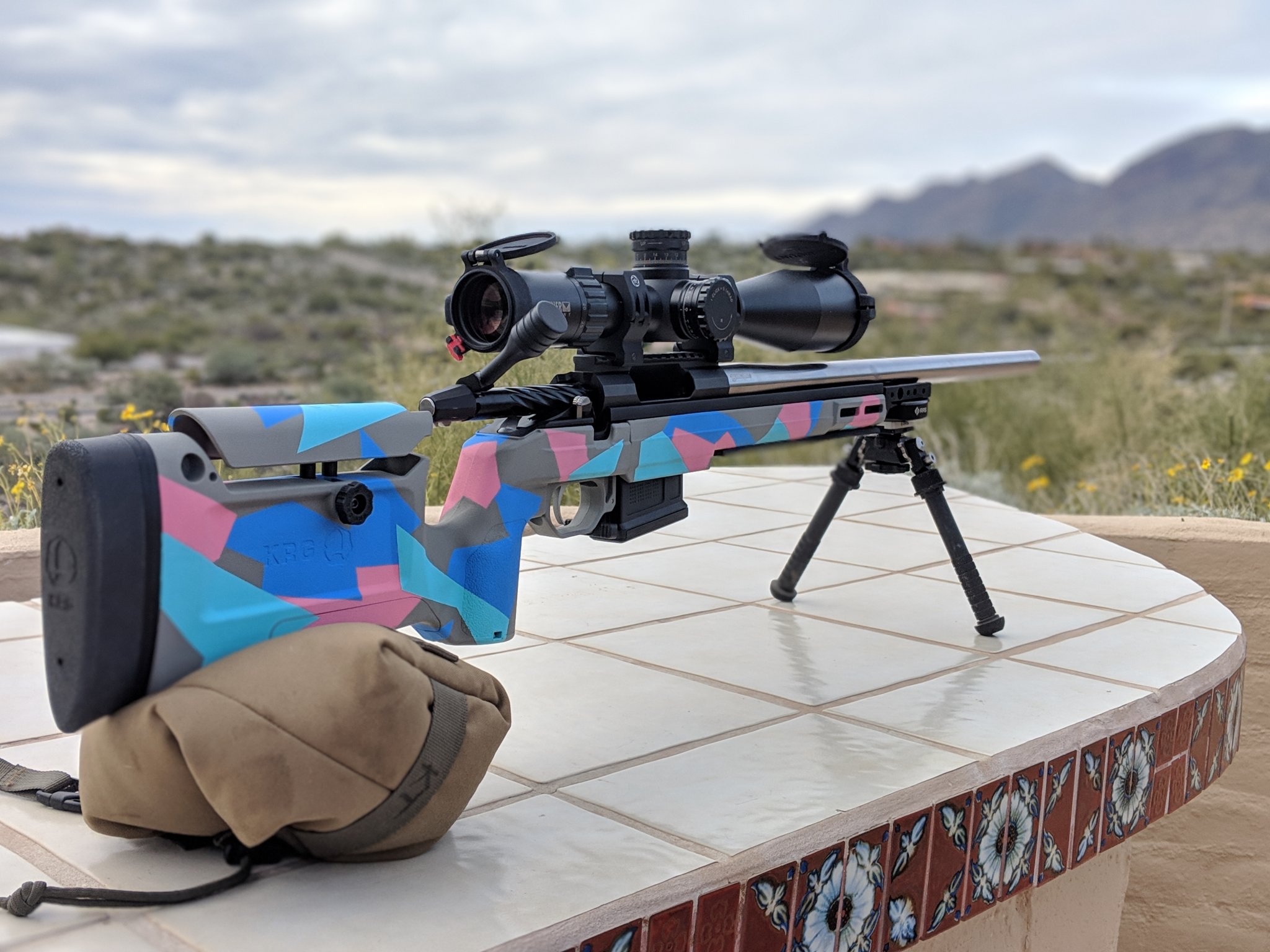

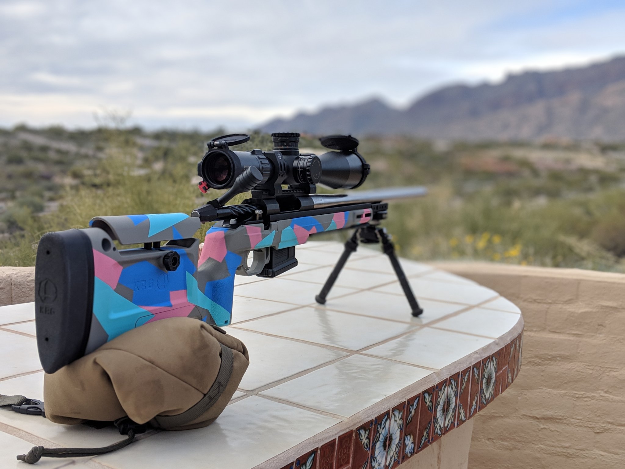

My barreled action is at LRI right now getting some work done. As soon as I get it back, I’ll figure out what to do with it, if anything. I was thinking maybe even just painting the barreled action FDE. Either way, I was after some pretty bold contrast just for fun and there it is. Haha!

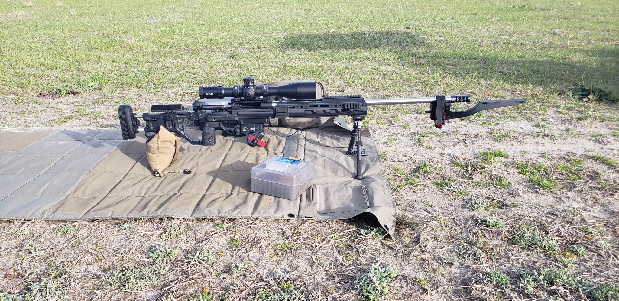

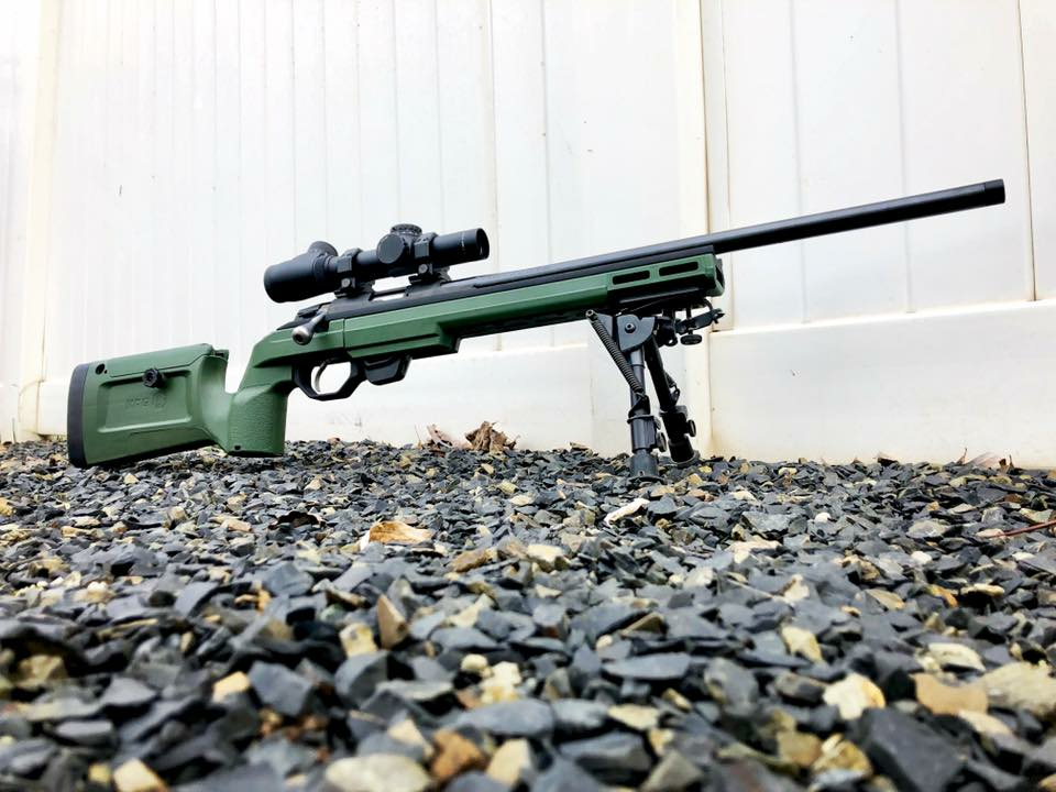

Got mine today, had a couple questions and got a call from KRG and the guy was VERY helpful, ordered from Bison Tactical and they were very helpful and insane fast shipping. FN raining today so I'll have to play tomorrow. Spigot and Harris mount should be here Monday. Might paint the cheek piece and lop spacers to match the scope.View attachment 7002839
20" SPS Tactical? If so, how does the balance feel?
Yes it's a 20" tac. It's a touch rear heavy, even with the spigot and Harris. But overall I really like the stock, best bang for the $ in my opinion. I'm working on a 6 creed with a 24" that will be identical and plan to go with a Bravo for that one later on. Here it is with the spigot and swivel Harris, it changed the feel and looks so much.

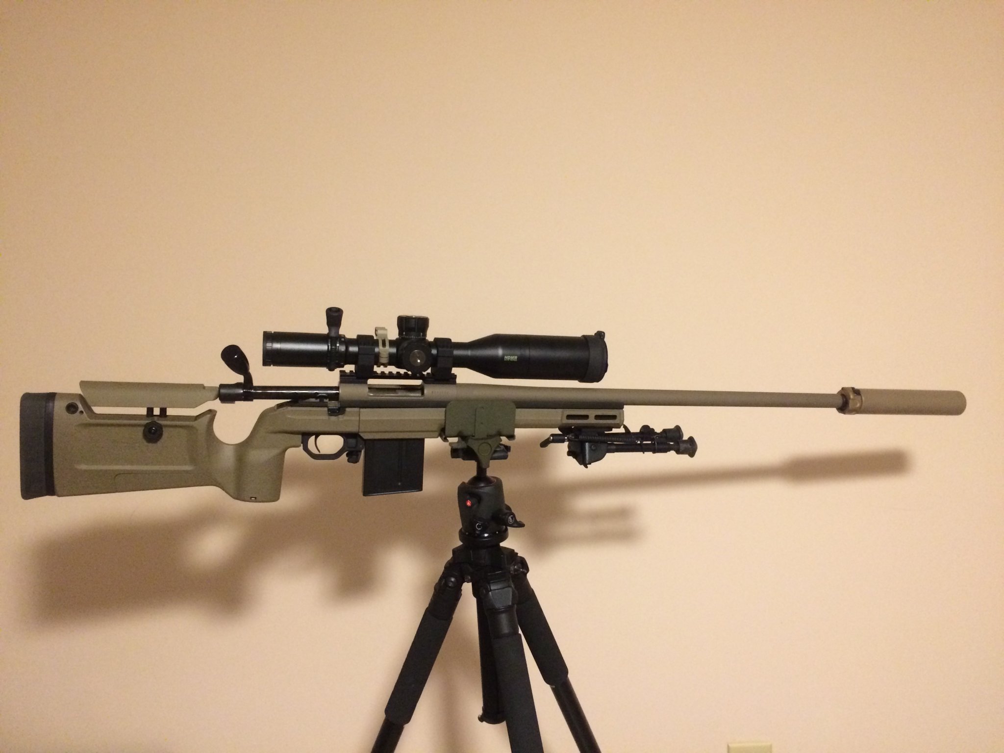

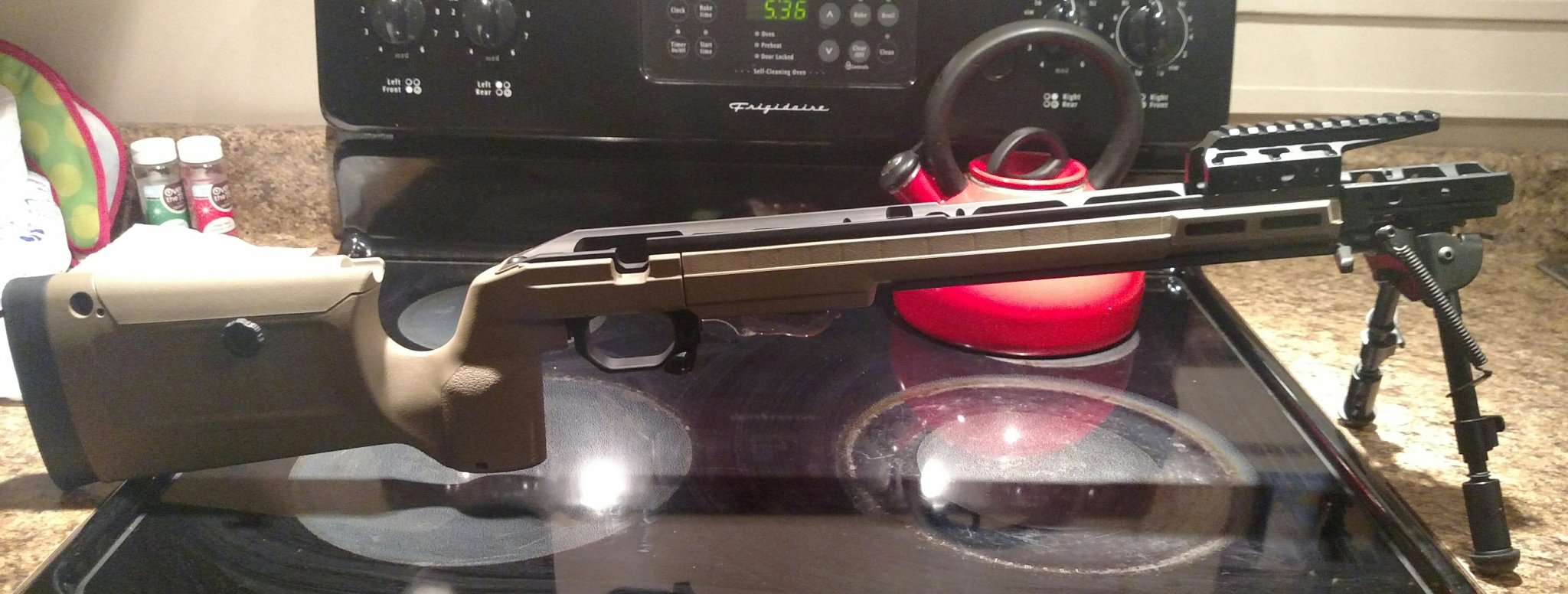

Spent the afternoon getting an INVR to work on a Bravo. PVA's still got my barreled action, but I think the stock is pretty well ready to go. Thanks to Justin for telling me it could be done, I'm real happy with the result.View attachment 6990707
@J-Ham What do you mean by "getting an INVR to work"; doesn't it just bolt on? You have the latest version of the Bravo it appears; has the small step in front of the action. KRG told me it would work on the Bravo.

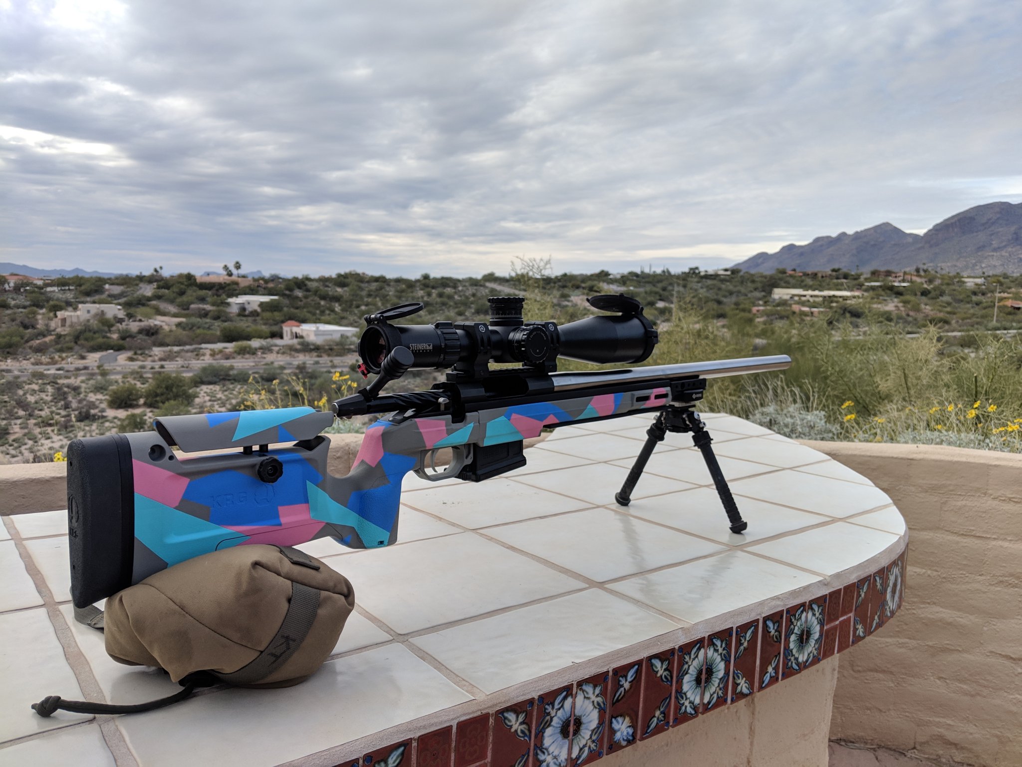

Nice rifle and paint, looks like the old german battleship break up camo. What contour on the barrel?
Thanks,
TM6
Thanks! I love how the paint job turned out, and most importantly, so does the wife!
The barrel is a 24" Heavy Palma. It is a little bit front heavy in this setup. I'm hoping to get some metal butt pad spacers to even the weight out a bit when KRG comes out with some.
Not if you're running a spigot also. And I can't remember what the bottom of the backbone looks like up there... Without the spigot mount for the heads of your screws to shoulder up to, you might want/need to do some work there too.

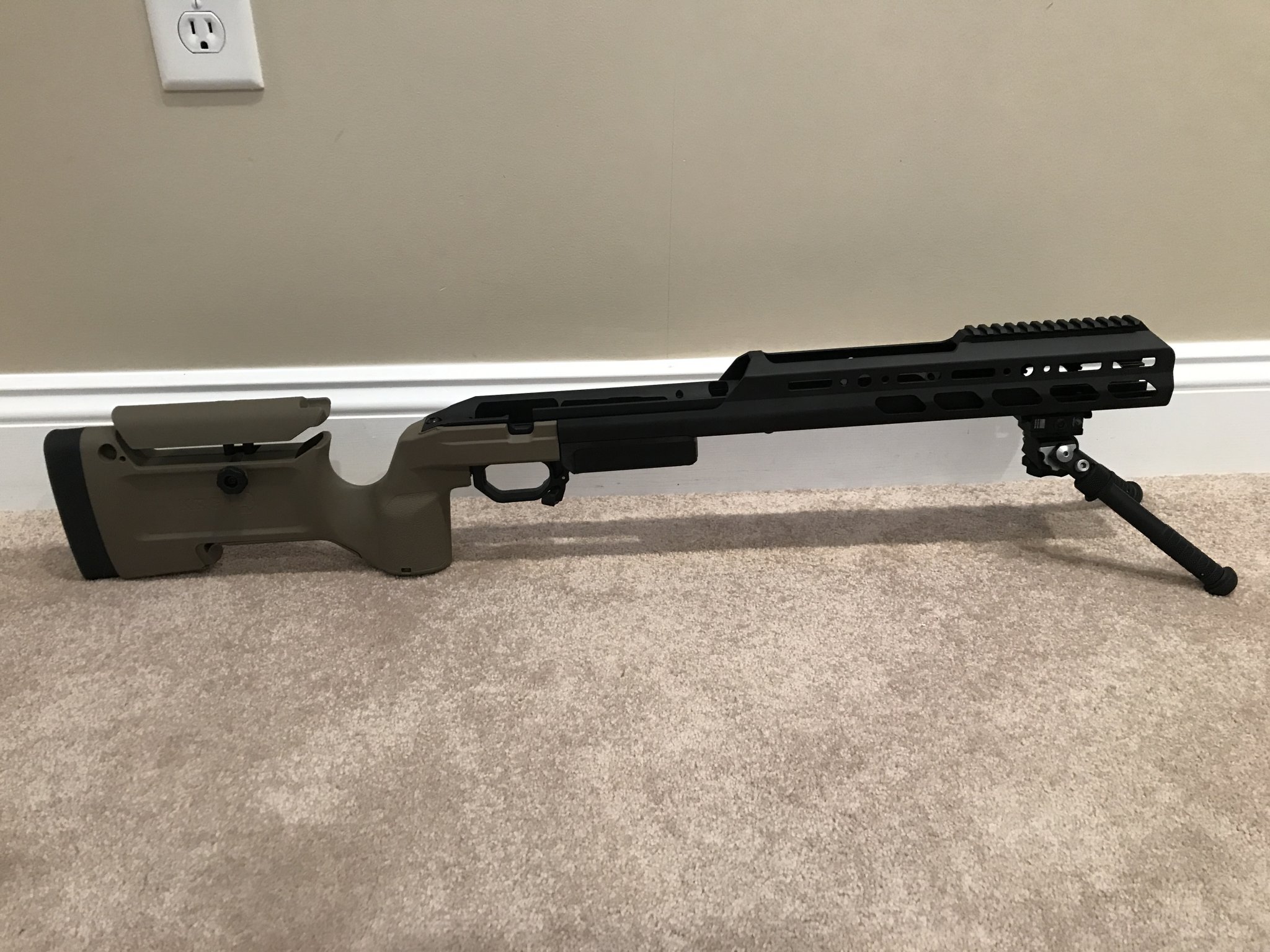

My Bravo came in today, and I just dropped my rem700 5R gen2 in it while things are slow at work. Playing around with the height on the cheek rest and the toolless buttplate. Liking it so far, just need to get better bipod and debating on getting the spigot mount.
