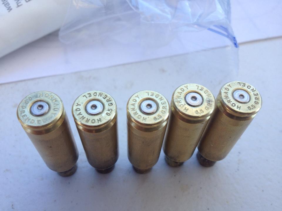

Yeah man, I'm compressing to get 2540 fps out of a 26" with 123's and the primers are cratering a bit. Some poor retard is gonna read shit like that and believe it

Sorry its real when i get to the range next i'll make a video to show it with the primers. I'm getting 2780fps with a 120gr Nosler as well which is better than a SAAMI throat with a 100gr. Thats how bad the double angle throat cripples hunting bullets. I think you've been drunk on Bill Alexanders bath water for to long to see anything near reality.
Here's the velocity measurements for the 120gr Nosler BT string with LEVR loaded to 2.29in. Tightest group was 31.6gr. A SAAMI grendel of course can't load a 120gr Nosler to 2.29 over even close. 2.23in is closer to reality for a SAAMI throat.
31gr 2727fps 2695fps 2673fps 2698fps 2712fps Average 2701fps
31.3gr 2716fps 2778fps 2741fps 2741fps err Average 2744fps
31.6gr 2796fps 2772fps 2779fps 2772fps 2780fps Average 2779.8fps
31.9gr ERR ERR ERR ERR 2773 (wind was blowing the chrony)
32.2gr 2803fps 2798fps 2798fps 2761fps 2814fps Average 2794.8fps
Primers for 31.6gr of LEVER.
Notice the COAL that people with SAAMI chambers are forced to load to and what velocities they are getting. A good example of how the SAAMI chamber forces bullets to deep in the case robbing velocites.

Lever, as in Leverevolution powder?
Impressive numbers for a .264 AR15 but that is a long pipe. Any numbers from a shorter barrel like a 18" or 20"?

Don't fall into believing a word of his bullshit.
We've been through this before with him. He's obviously using his old Liberty 24" with the bullets jammed into the lands.
There's nothing magical about about how a rifle works. It's physics and the physics don't add up here.
He has to be approaching 60ksi to be able to get those velocities.
Don't believe me read on for yourself.

Lol my max measured COAL using the Hornady gauge is 2.310in and this string was loaded to 2.29in so no not to the lands. Getting desperate i see. Next trip to the range i'll fire a string to 2.3in using a PRI mag which allows 2.305in COAL. It would be 60K if it was that shorter compound throat with that double angle crap.
