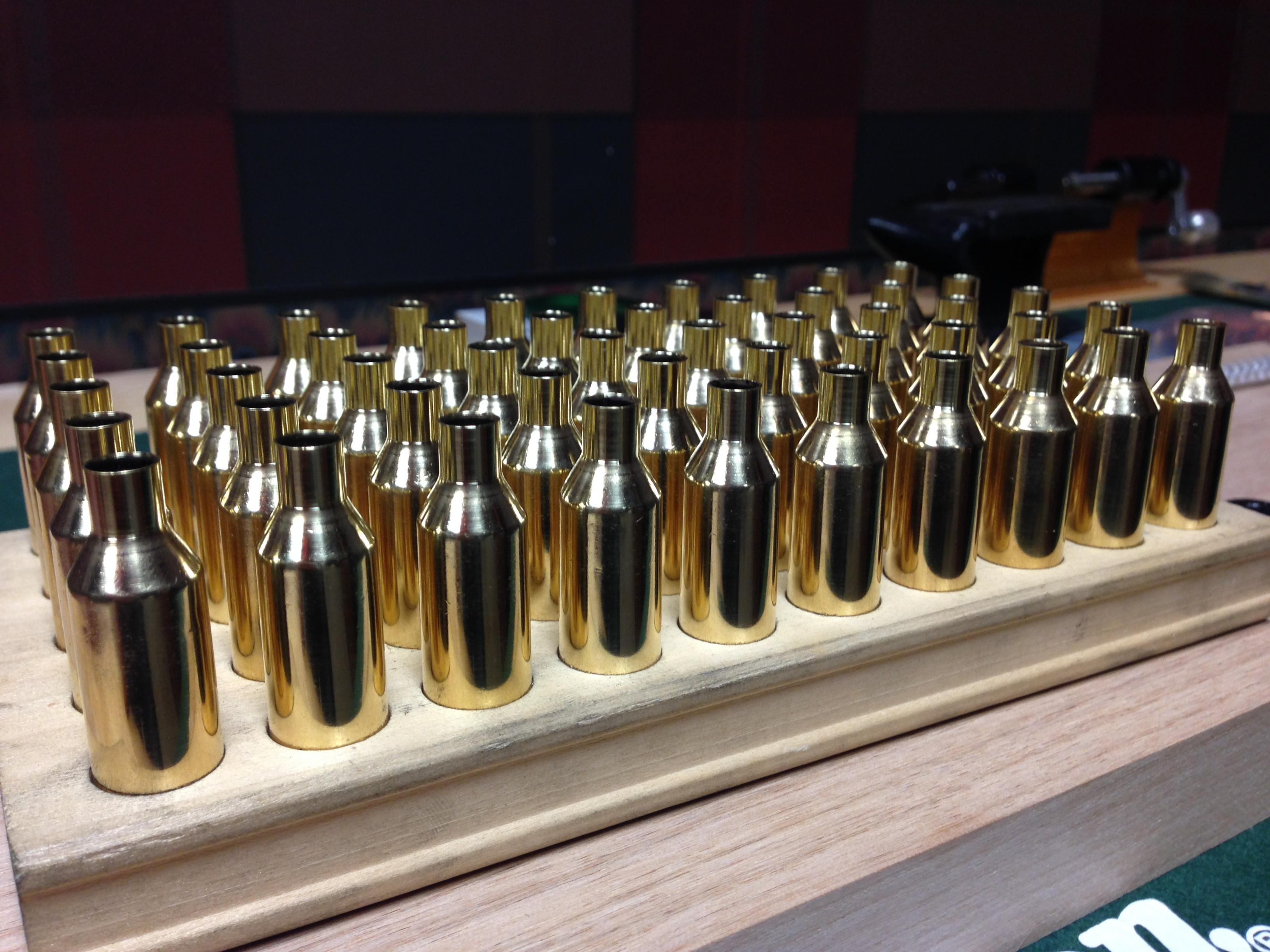

1. GAP Xtreme Hunter #20
2. H-1000, 63 grains
3. Federal 215M
4. New 300 Remington SAUM stepped down with bushings .325 to .315 to .295. Necks turned to .015.
5. Berger 130 gr. VLD Hunting. Sorted by length, base to ogive. Trimmed (Hoover). Tipped (Hoover).
6. Seating depth is .080 jump ogive to jam.
7. Low 3200's. Don't want to say the chrono, cuz I've already read what a loaf of shit it is. But it's what I have.
8. Best, less than 1/2 MOA, 5 shot groups. Worst, not good as I zeroed in on seating depth.
9. Shot nothing but paper and rocks, though my wife nearly shot me when she saw the invoices on rifle/scope/reloading tools and supplies
10. See attached
11. My first time with bushing dies, necking down brass, neck turning, meplat trimming, bullet pointing, sweating component availability, and grinning every time I pull the trigger. Even with the steep learning curve, the guys that developed this cartridge, built the rifle, and shared their knowledge on this forum made the process idiot proof and enjoyable, if expensive. IMG_0796.jpgIMG_0802.jpgIMG_1555.jpgIMG_1519.jpgIMG_1547.jpg

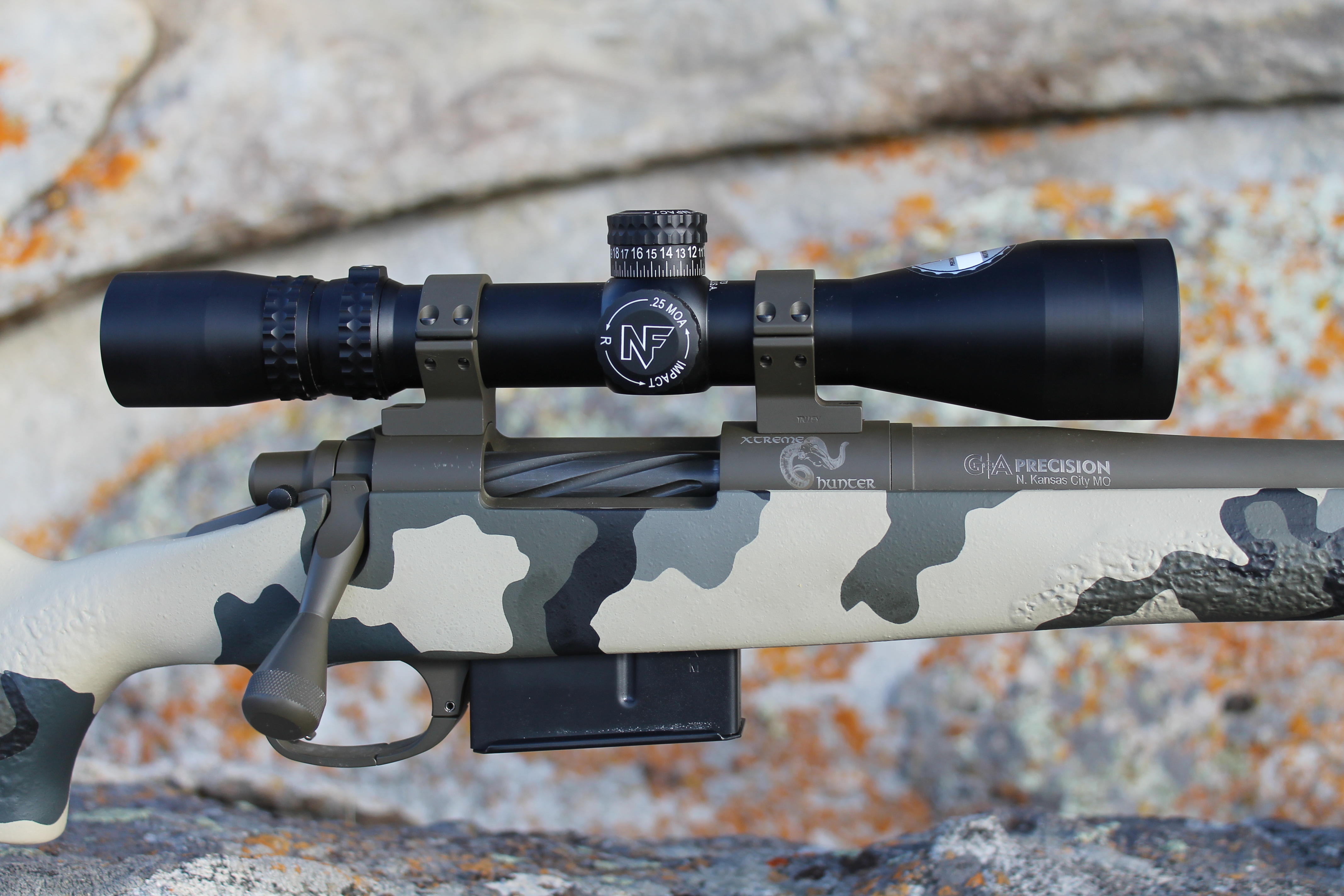

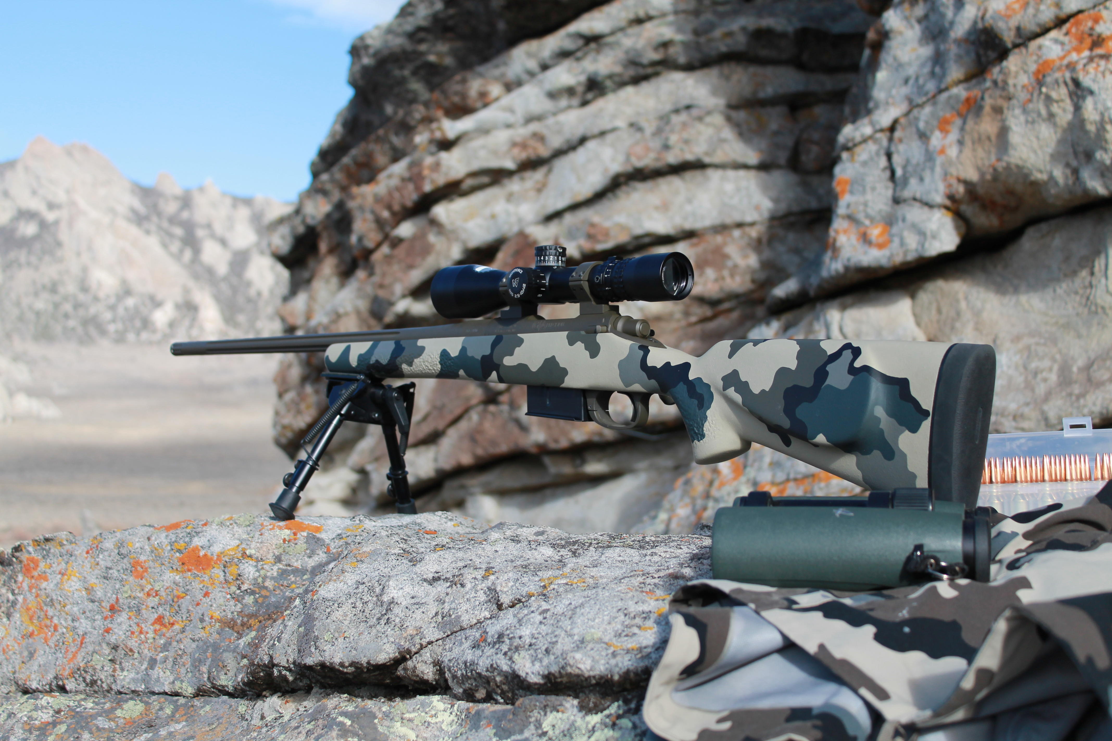

1. Cloud Peak Gunworks built the rifle. Pierce action, spiral fluted Brux bbl at 24" and 8.5 twist. New reamer
2. Ramshot magnum 64.7 grains
3. Fed 215
4. Nosler 300 SAUM brass that I prepped
5. 140 JLK
6. Base to ogive seating depth is 2.238" with comparator zeroed.
7. Velocity 3180 tested w magnetospeed as well as oehler 35
8. Best group was in the mid .2s at 100 and less than .5 moa at 1050
Don't look past Ramshot magnum. It provides great velocity with low ES AND SD. Sorry can't get 1050 video to load

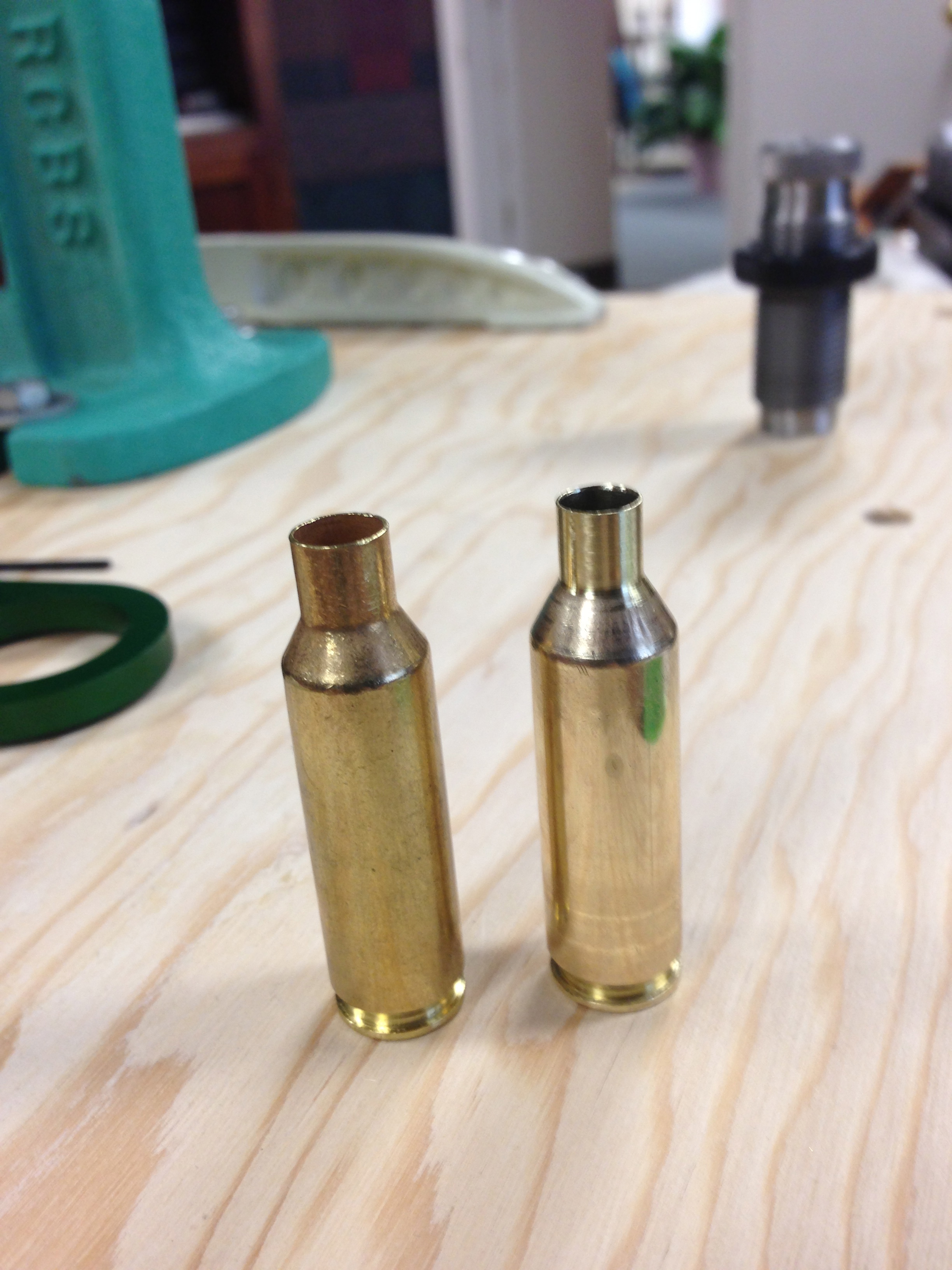

Fireformed brass on left and prepped brass on right.

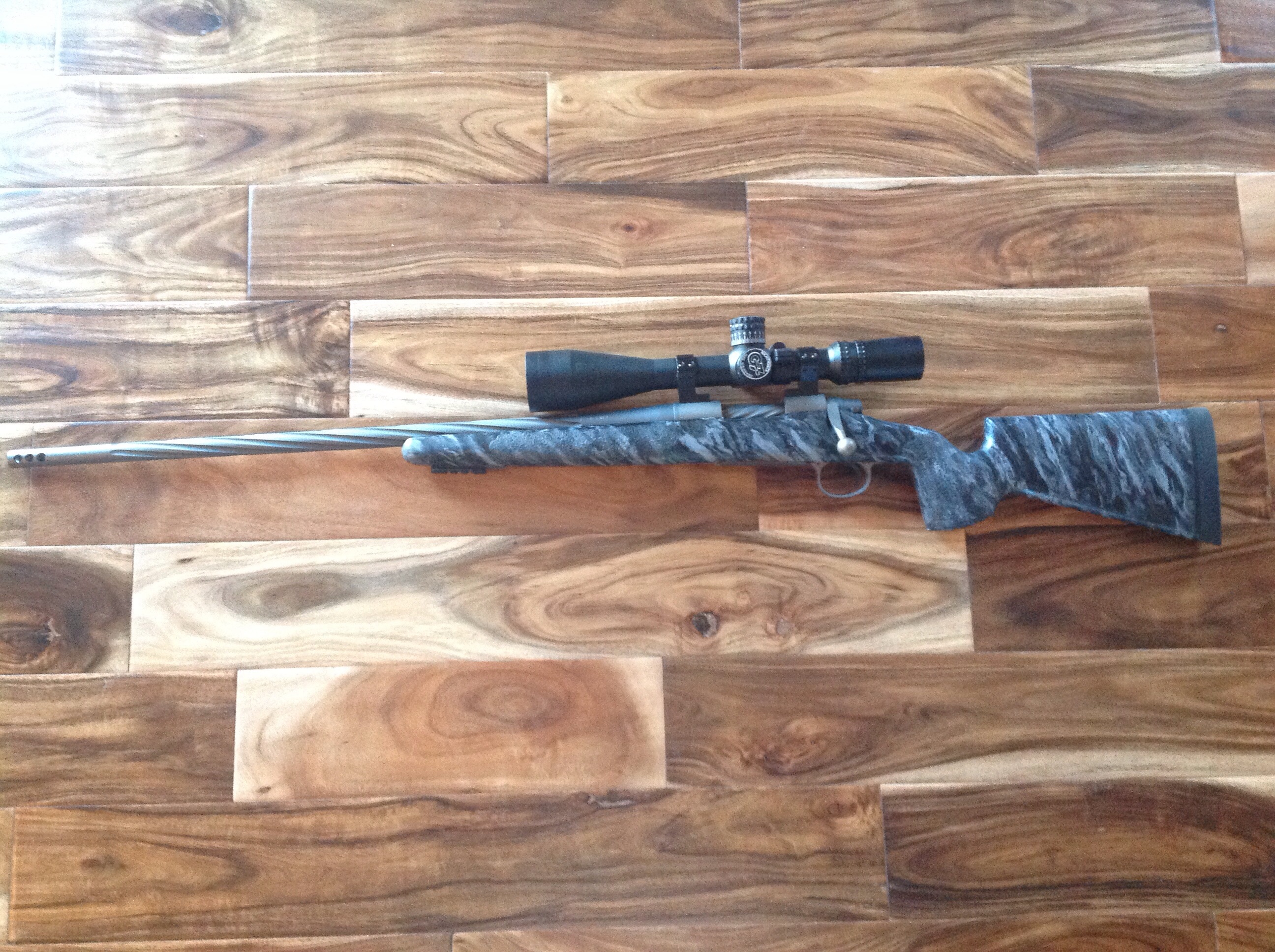

1. Built by Robert Gradous of Gradous Rifles / Stiller Tac 30 action / Jewell trigger / 24" Bartlein #3 contour 1:8.7 twist fluted by kampfeld customs Cerakoted Flat Dark Earth / Vais muzzle brake / McMillan A3 Sporter Edge painted by Todd Jackson of USgunworks / PTG Colt Tactical Stealth DBM / Nightforce .885" UL rings / Nightforce NXS 5.5-22x50 ZS HS MOAR / Atlas Bipod / PTG GAP 6.5 SAUM 4S .2962 NK .081 FB
2. 62.0 gr. of H-1000
3. Federal 215M
4. Norma 7mm SAUM brass self processed with Redding FL 7 SAUM dies .295 & .291 bushings (As per the instructions from Pat's thread) neck turned with a K&M neck turing kit, trimmed to 2.025".
5. Lapua 136 gr. Scenar Lot # P00682302
6. Seated 2.198" @ Ogive (.010" out of lands)
7. 3196 fps. per Magneto Speed chronograph
8. I only shot a few groups with this rifle so far, the best I got out of it so far is .246" for 3 shots at 100 yards during load work up. Will edit post once I get some more trigger time with it.
9. Haven't hunted with this rifle yet, just built it a few days ago.

Processed brass on left, fire formed on right:
Bob.
Did you get any case neck that snap(broke) when resizing after neck turning?
I use the k&m tool like you and turn the shoulder exactly like you also. But my neck broke when i resize them.
Bob.
Did you use an expander? I don't believe you have to use an expander after neck turning. The bushing should be the only thing that resizes the neck.
Are you're sure you're only turning to .015? I can't imagine a neck falling off unless you were turning too deep or too much into the shoulder..
