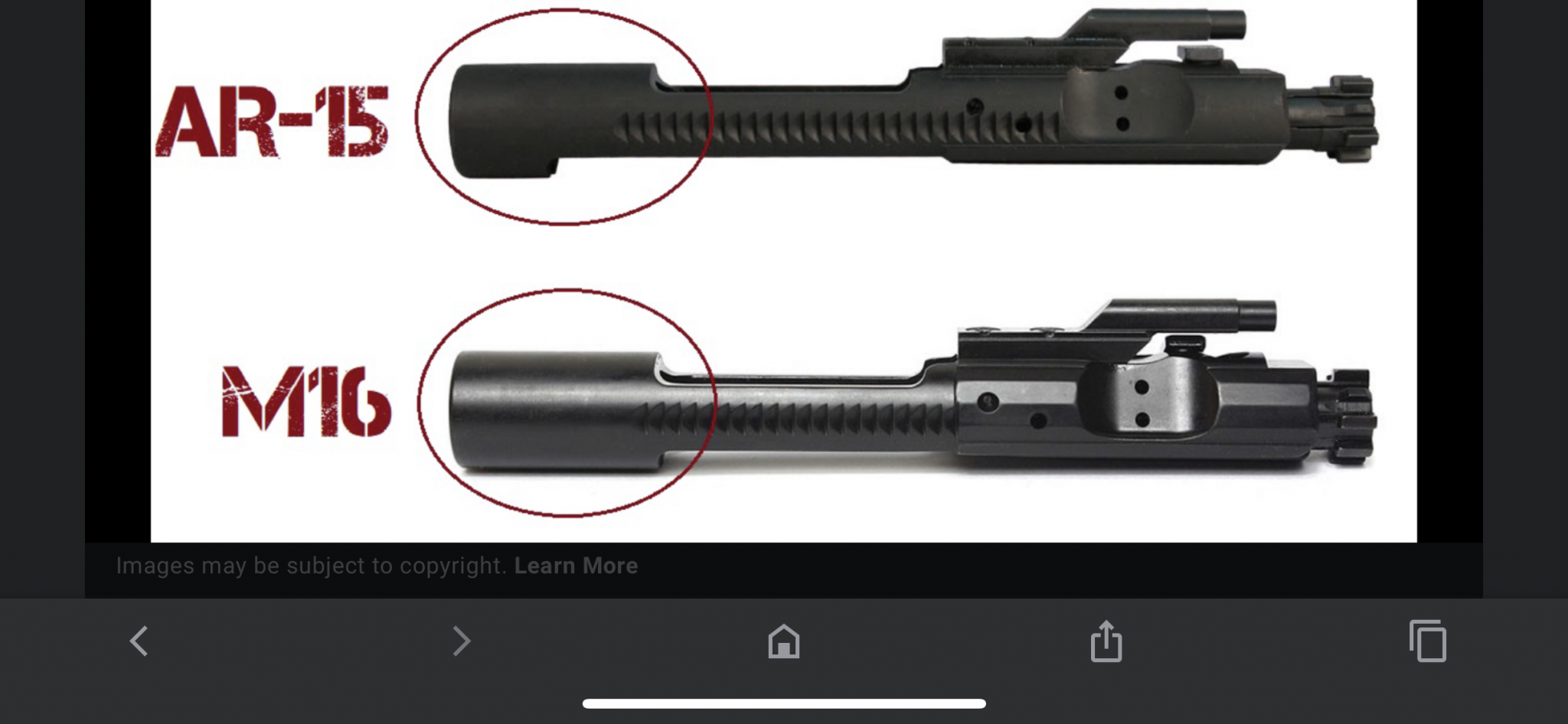

This is what they’re referring to. You can google for the other info between the two. It’s not going to turn a semi into a full auto if that’s what your asking. Just a heavier carrier. Yes they’re legal.

To reiterate what has been said; the carrier is 100% legal, and will not alter your rifle. They are not just heavier; the extra meat retained (as shown in the photo above) is there to work in conjunction with 4 other FA parts.

Bushmaster used to sell their own clipped carrier design, similar to the one you see in the erroneous photo above in post #3 so there was no auto sear trip.
The problem with clipped or shaved carriers is that they don’t have the correct full mass of the carrier design that is engineered to provide reliable extraction and feeding in cold weather. That said, they can still work fine under most conditions but I personally avoid them.
