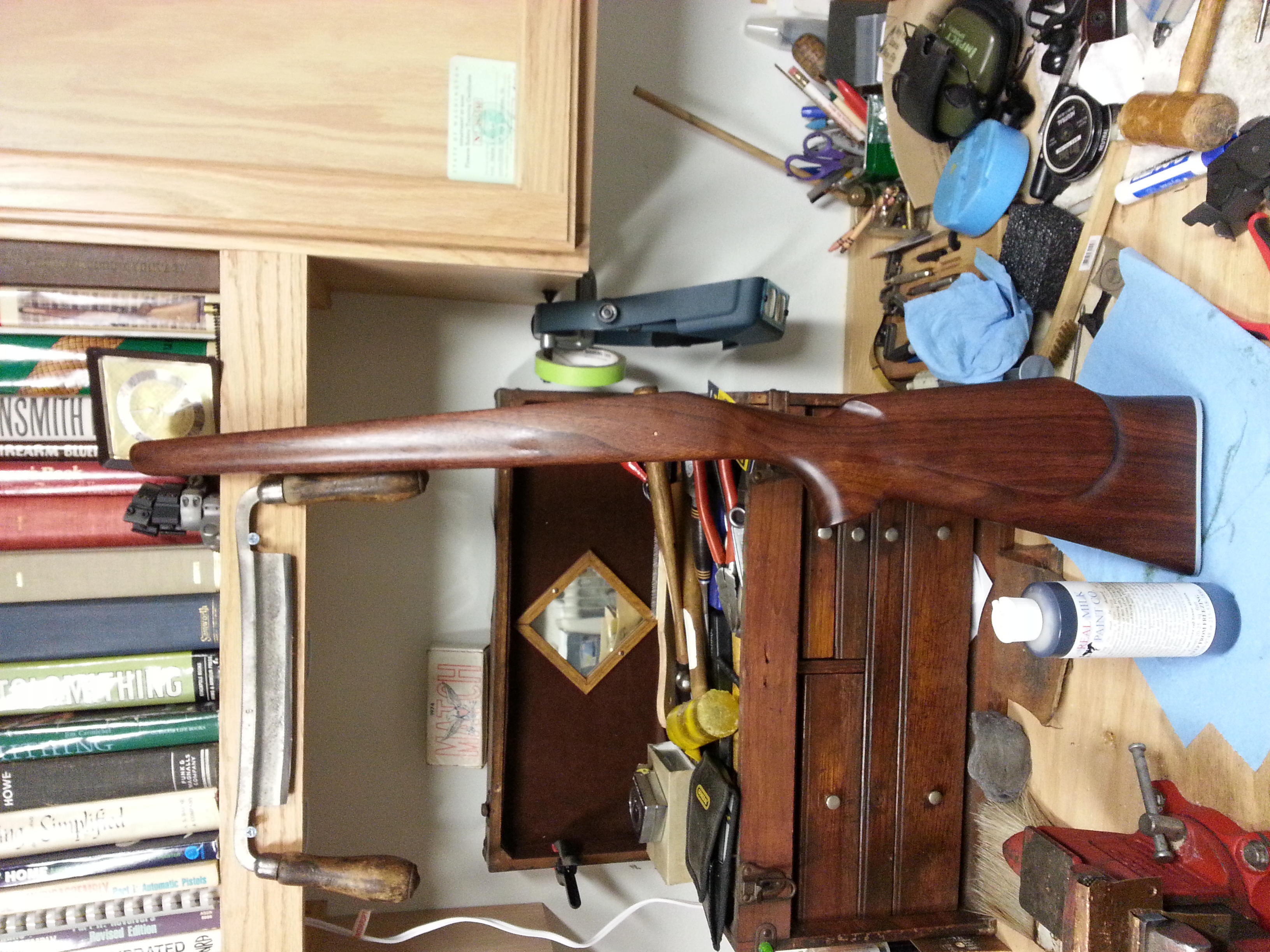

The stock is at about a 98% solution, shape wise. The M40 stock pics with measurements that were posted the other day were exactly what I needed. I am doing the final sanding, down to 220 grit. If the warden gives me any free time today, I MIGHT be close to applying the first coat of finish. Exactly what that finish will be, I haven't yet decided. It will be an oil of some sort, but I am still debating the merits of BLO, Danish Oil, and Teak Oil.
I should be able to get some pics of the scope this afternoon. I also plan on dropping the barreled action off for Parkerizing. Stand by for news.....

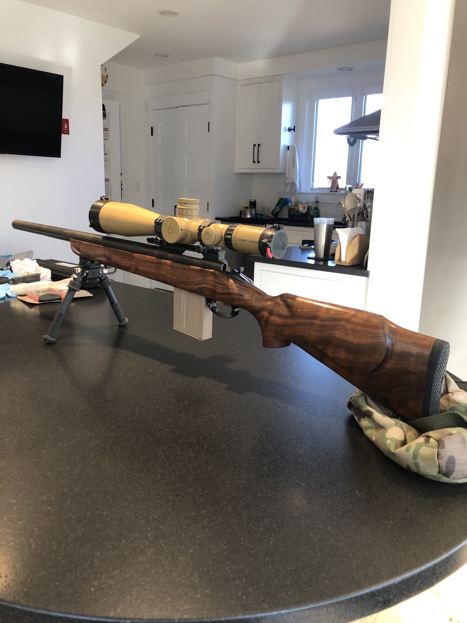

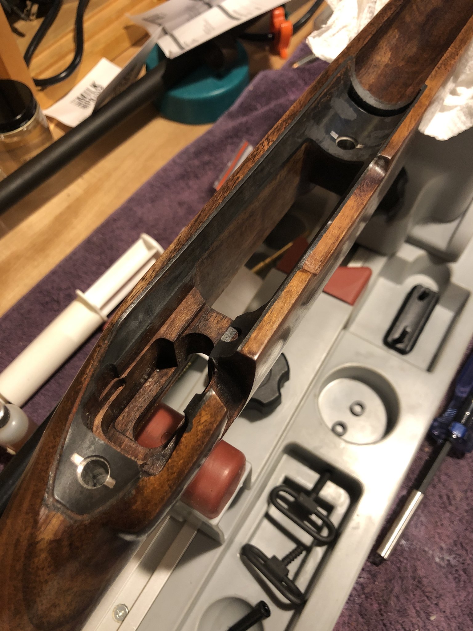

My M40 is of the A1 variety.
This is my current project I have going on
than perhaps upon completion Ill get some more wood and iron in the safe with the original M40.

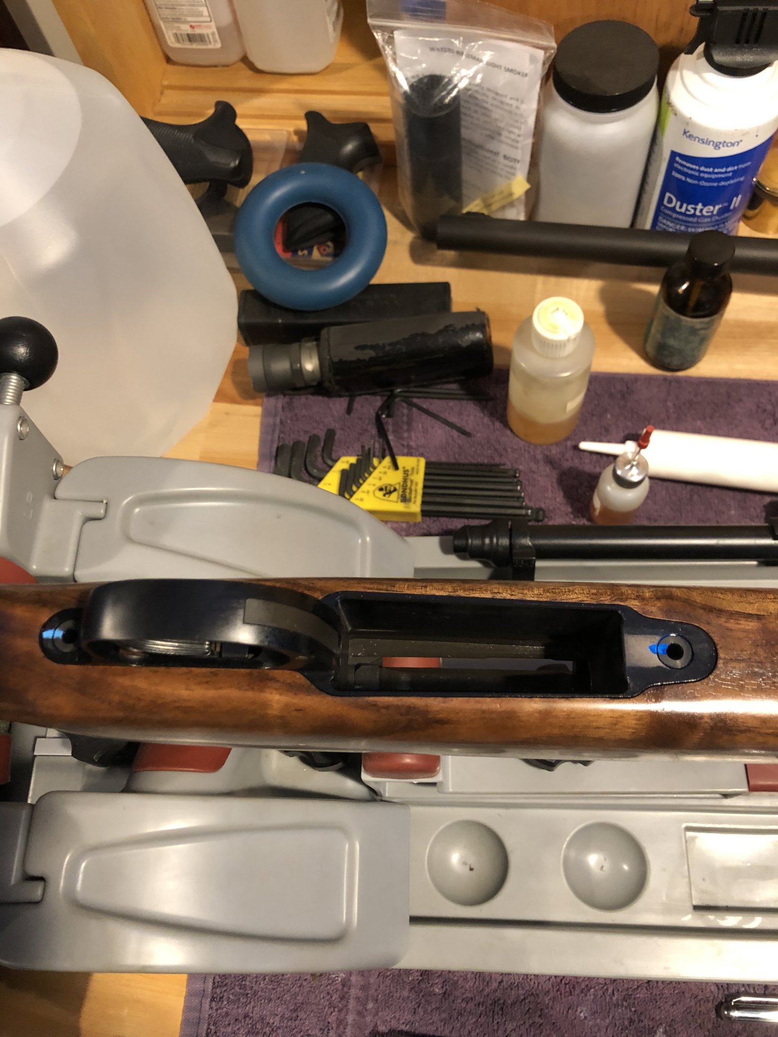

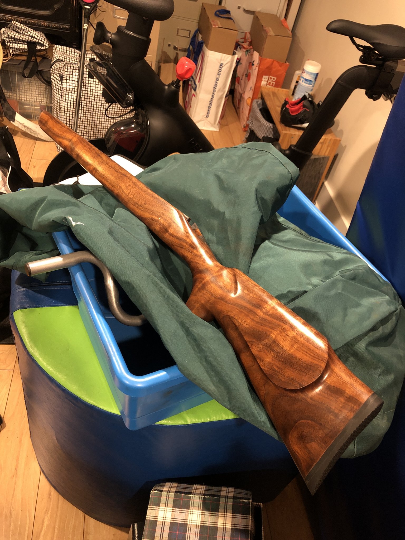

18 hours after the first application of Real Milk Paint Company dark tung oil. I think I am going to like this stuff. And no, I have no idea why the picture rotated when I uploaded it....
I use RMP light TO on my Garand/03. I burnish light coats of oil into the stock and wood takes a deeper, richer finish. Its great stuff.
It will get uber shiny if the coats build but its good protection and you can knock down the shine with use or a synthetic buff pad.
I love the smell of Tung oil.
Damn, that looks real good.

...had me rub oil on that thing unit I was crying about blisters. At the time I didn't understand the point of that exercise. I was only 8 years old. :)
Thats what I do with the RMP tung oil. The heat build up if you are real burnishing by handit will blister you. It really helps to fill the pores of the wood.
Ive seen boned rifles that use a rib bone, toothbrush handle or whatever smooth object to burnish the wood and those come out nice also. Not wanting to ruin 70 year old wood has kept me from trying it.
Mossyrock. Looking good, looking good. Having those original measurements provided by 'rlm8541' does make a difference, especially through the forearm.
Don't let it sit too long. The carbon all collects on the bottom. Stir that shit up. I mixed mine with 1/2 and 1/2 with BLO to thin it out a bit.
It's also a GREAT oil for case hardening/darkening steel parts. It's chock full o' carbon. Did I say that?
RMP Dark Raw applied with 0000 steel wool.
