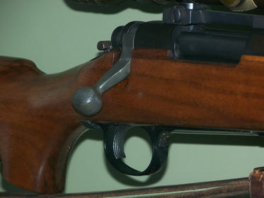

The difference(s) lie on the right side of the receiver. The rear wall of the ejection port should be relieved (notched back,) a feature which allows the shooter's thumb easier access for loading cartridges.
Nice machine work from other thread. I can't tell from the camera angle but the left vertical clip slot should be standing a little proud of the ejection port on the horizontal stock line. Is it too deep in the stock?

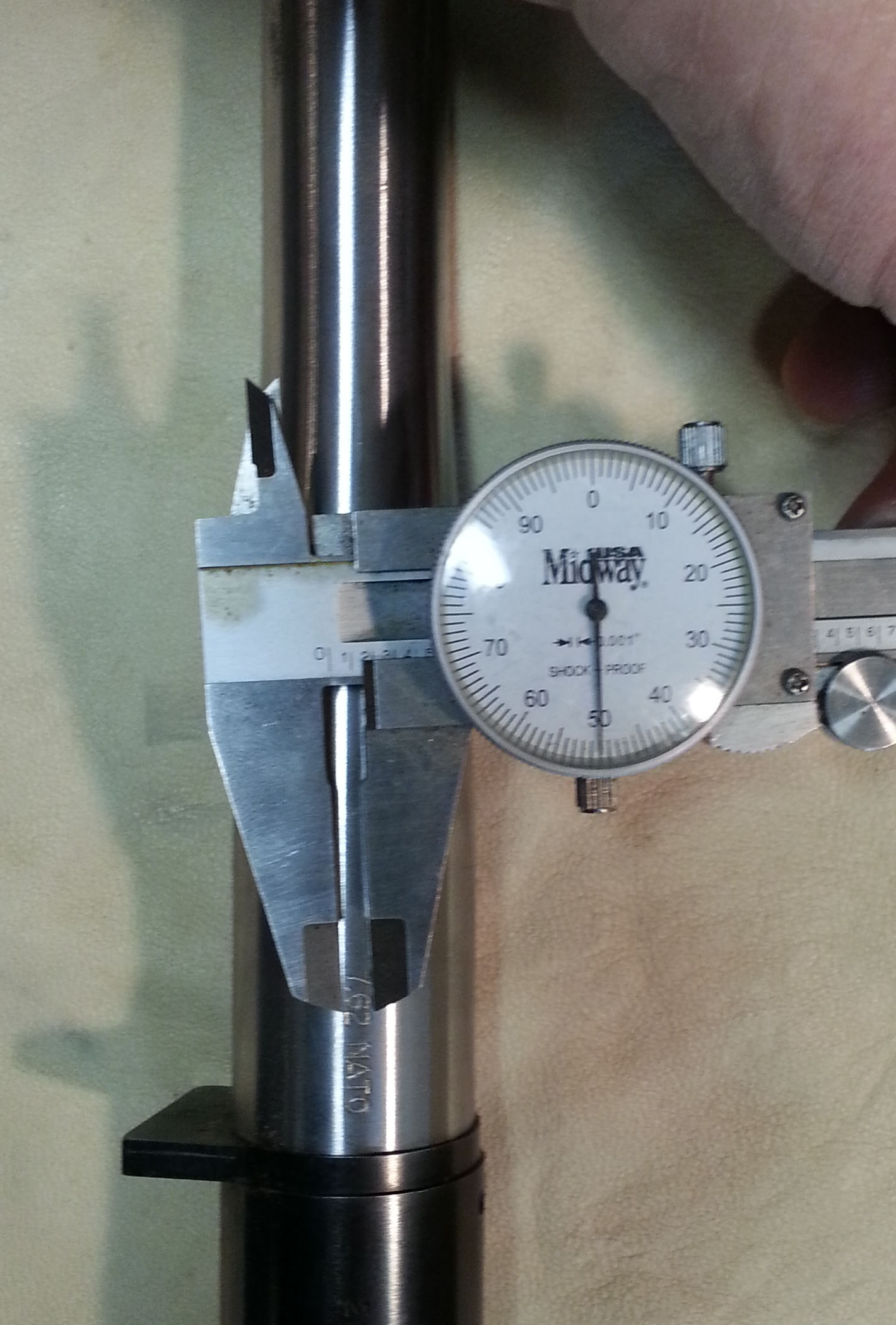

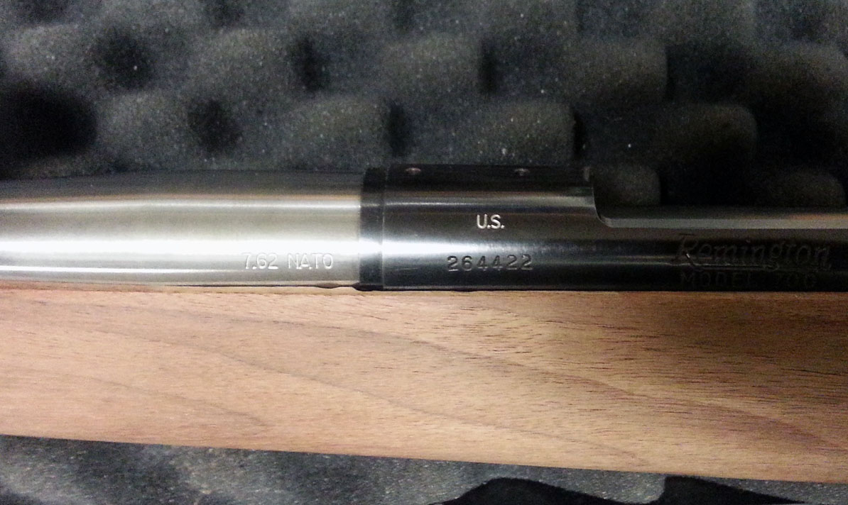

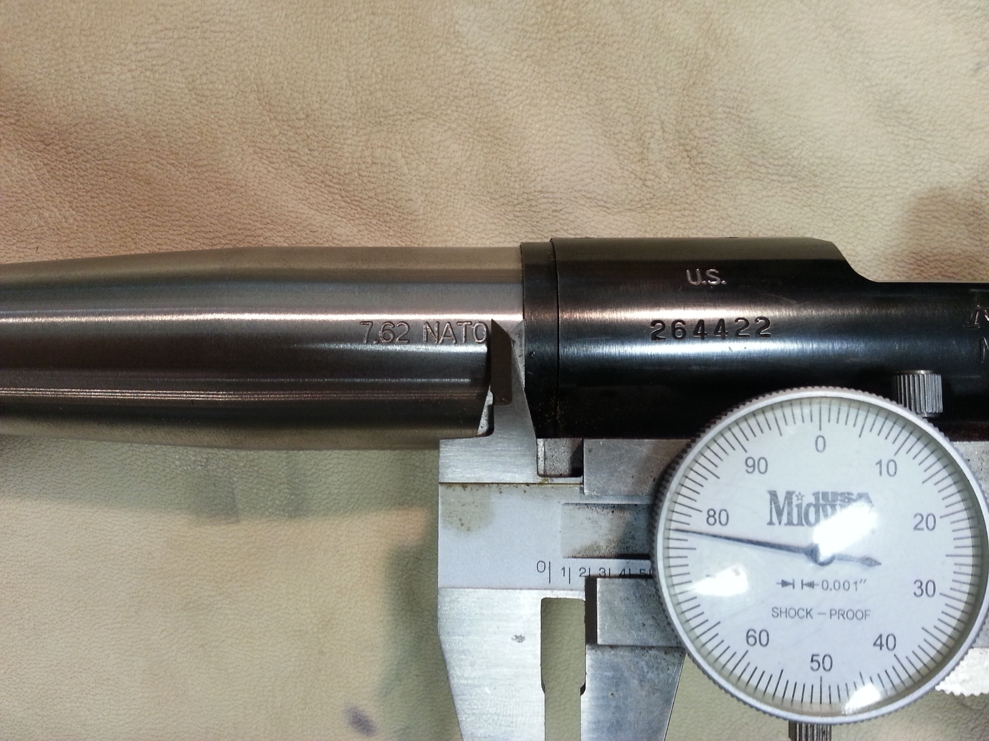

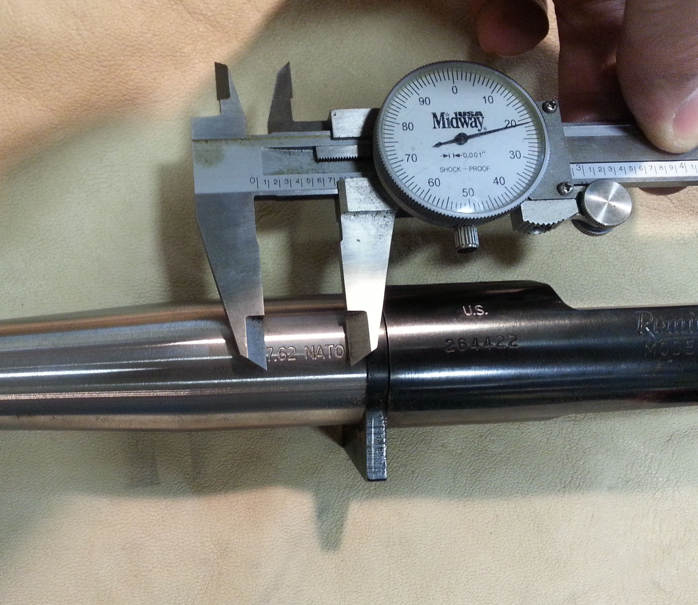

Mossyrock's 7.62 NATO barrel stamp...
Mossyrock, On another note, please share, some details on your 7.62 NATO barrel stamping... letter height? - length of stamp?? - distance from nearest edge of recoil lug???
I revisited the clip slot thread and the machinist does explain the difference. He really had no other choice and he explains why. The photos create an illusion that it is sitting too deep in the stock because I'm looking for that little hump on the vertical line and it is not there. The vertical line goes straight down to the horizontal line on the wood stock.
http://www.snipershide.com/shooting/sniper-hide-gunsmithing/265275-clip-slotting-m700.html
Mossyrock's 7.62 NATO barrel stamp... AMENDED Part II The Findings, a/k/a The Measurements
NOTE: Amended below and in Post #1210 / Pg. 25 - Disregard dial caliper readings for height and length, in photos.
Length: 0.715 inches - Distance from nearest recoil lug edge: 0.177 inches - Height: 0.141 inches
Mossyrock,
Now, there's an incremental difference when measuring something (i.e., Letter/Number Height) over a 'curve.'
Methodology: If you take a piece of copy paper and lay it over the stamp and use a pencil to shade the paper, revealing the a number/letter (any with a well defined top and bottom termination) and then lay the paper flat...
Question: What does the number/letter measure now?
My question arises from the fact that if your vendor is using a pantograph engraver, the size letter/number he selects will dictate the actual appearance and outcome. There won't be any do-overs.
Mossyrock, your stamping/engraving looks 'righteous' to me. Thanks for sharing this detail with all of us.

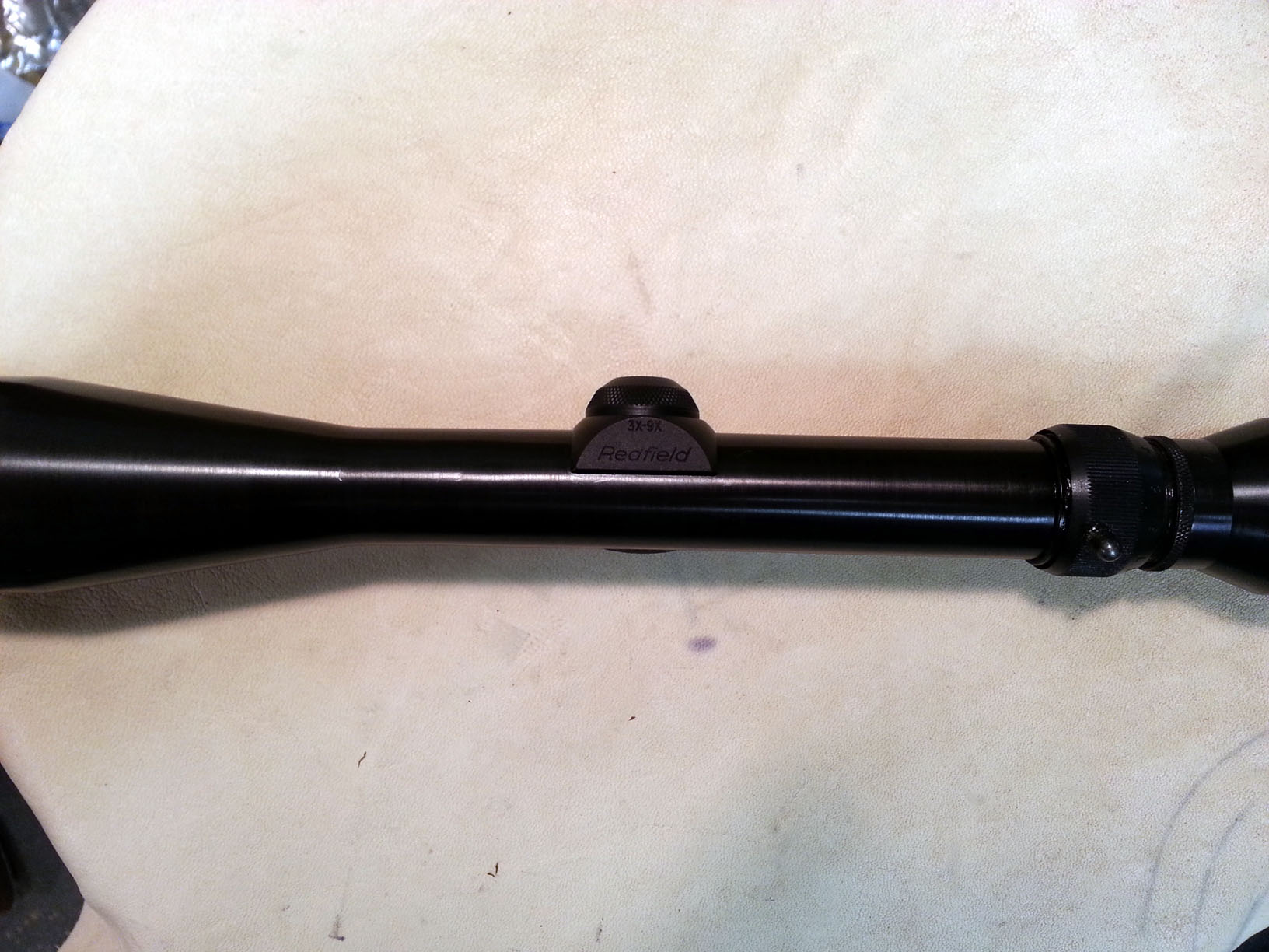

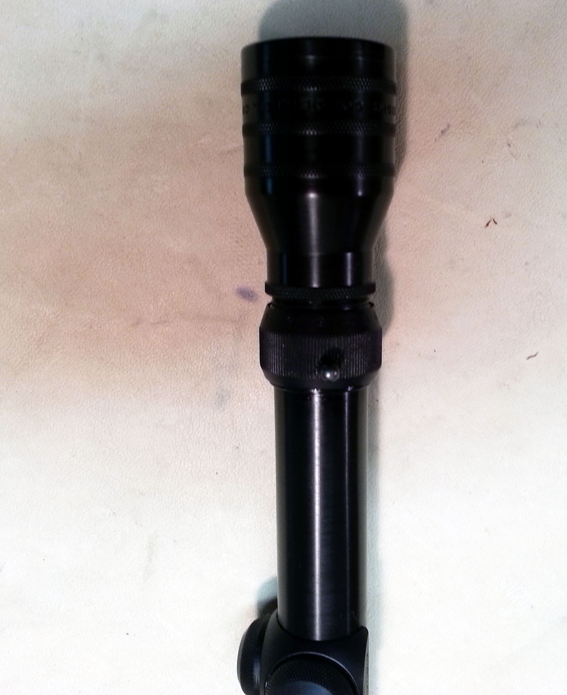

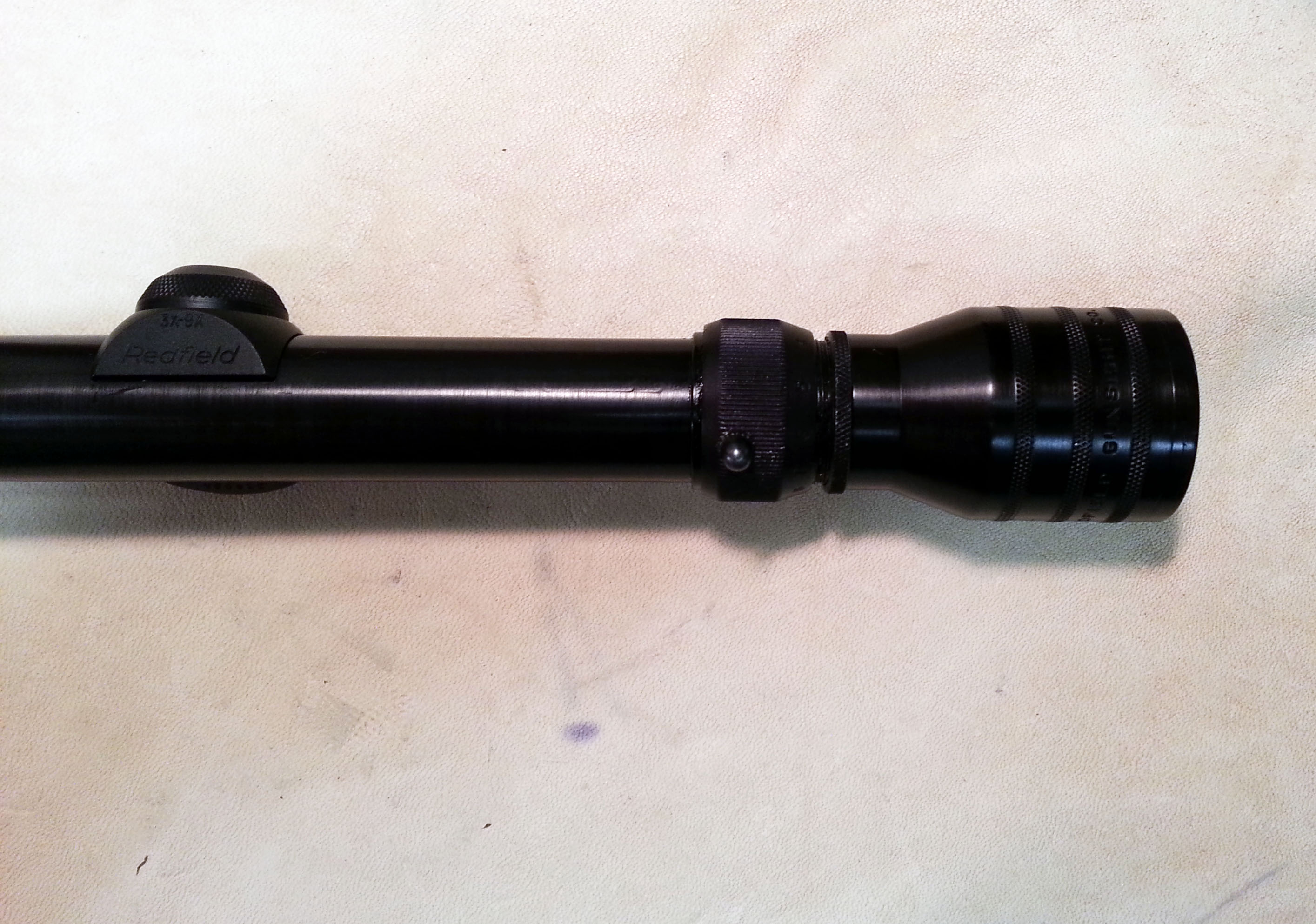

So....have you ever wondered what a brand new, freshly hatched, matte-finished, second generation Redfield Accu-Range would look like? Send your scope to Tokiwartooth and find out. :p
Did you get it? PM'ed you on m14forum.com. Let me know.
For the record, they are "satin" finish. The AR TEL is more matte finish. Replaced your zoom ring, turret base, zoom thumb screw, turret caps with spares I had. Used the ocular assembly and glass from the other scope you sent.
Yup. Just replied. Great job! That was the last piece of the puzzle. Now if I would just get off my butt and finish the stock work, I could put this rifle together! :)

Mossyrock's 7.62 NATO barrel stamp... Part III The Findings, a/k/a The REAL Measurements
Mossyrock,
I'm going to submit your name to the Pope. I don't know what he'll do with it, but it can't hurt. Who knows, maybe a holiday... if you don't mess it up?
Mr. Bolt_Trash, at your request:
.141" high, .715" long
Letter / Number Height: 0.141 inches
Stamping Length: 0.715 inches
Distance from front of recoil lug: 0.177 inches (no change)

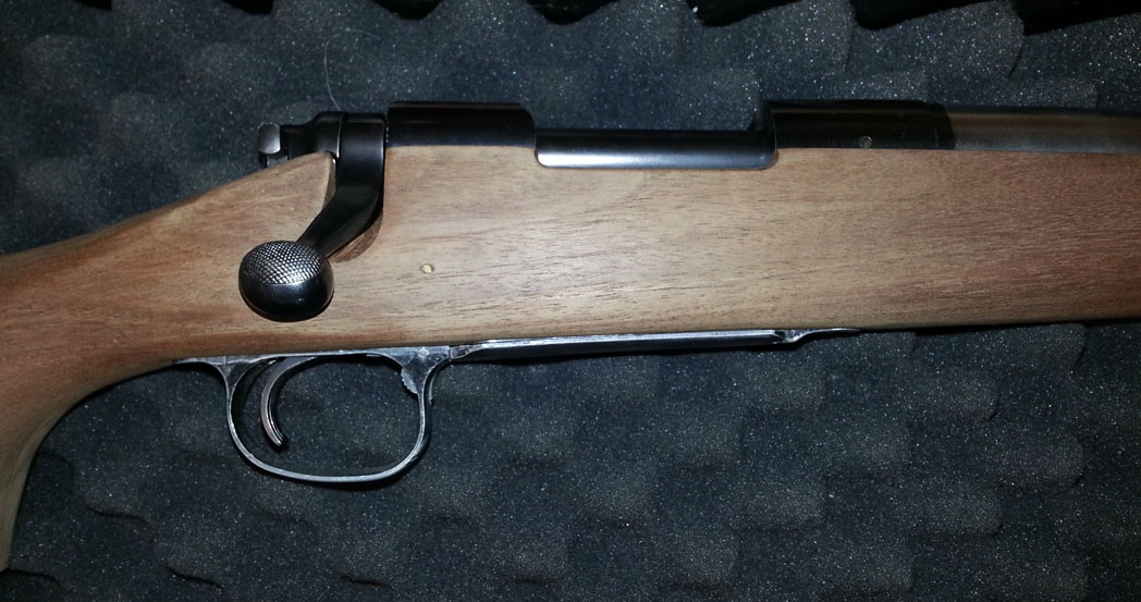

The stock is at about a 98% solution, shape wise. The M40 stock pics with measurements that were posted the other day were exactly what I needed. I am doing the final sanding, down to 220 grit. If the warden gives me any free time today, I MIGHT be close to applying the first coat of finish. Exactly what that finish will be, I haven't yet decided. It will be an oil of some sort, but I am still debating the merits of BLO, Danish Oil, and Teak Oil.
I should be able to get some pics of the scope this afternoon. I also plan on dropping the barreled action off for Parkerizing. Stand by for news.....
