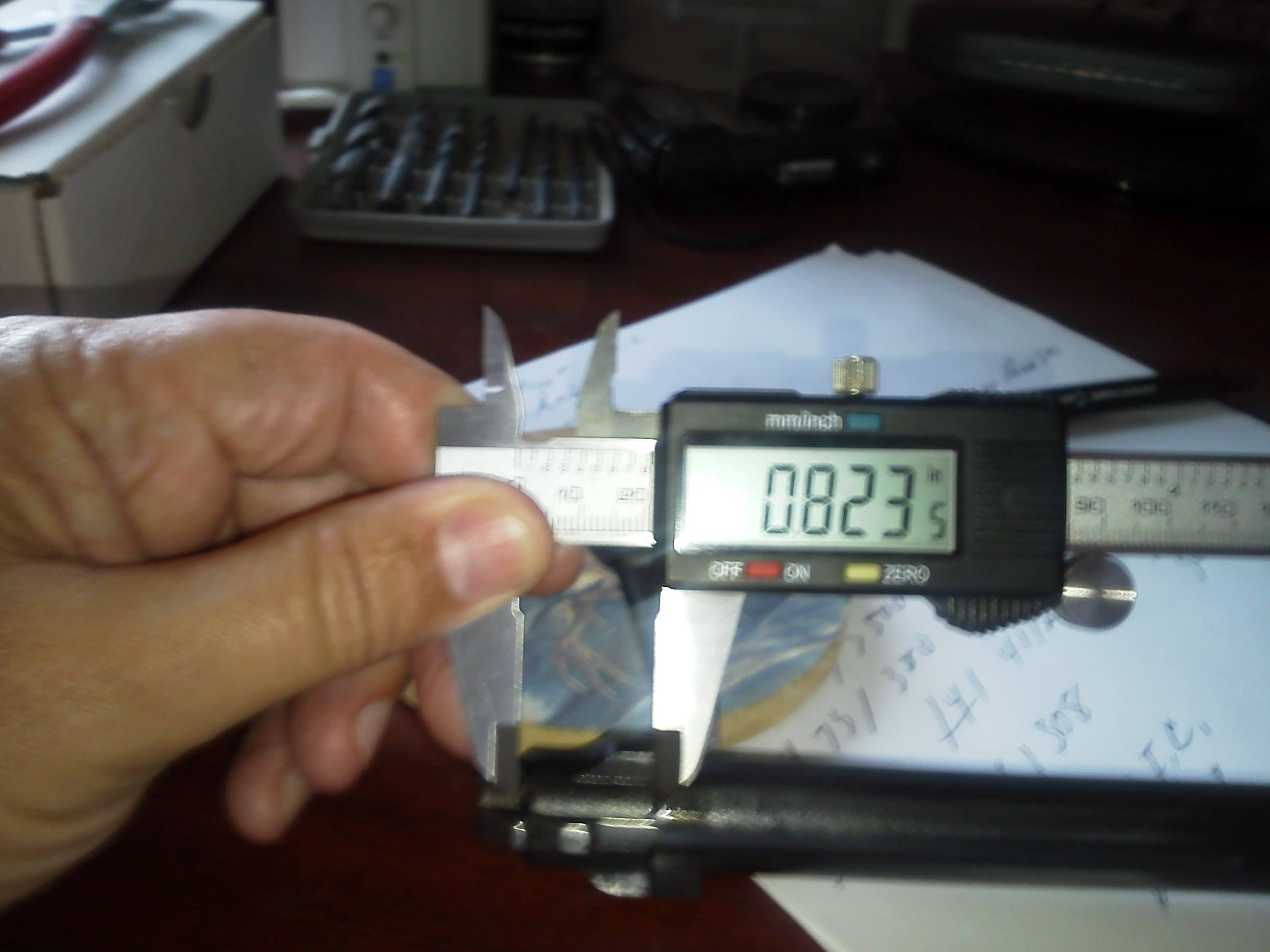

Gents, I need a measurement from an early model 700/M40 bolt shroud. I need either the overall length of the shroud when removed from the bolt, or the distance from where it contacts the rear of the bolt to the end of the shroud. Thanks!!
There's almost every measurement that you could want, on the M40, on this forum, but you'll not find it sitting, conveniently, in one place. The genesis of this topic (and your question) started on Post #509, was elaborated on in Post #709, was pursued in Post #724 and answered in Post #729.
The answer, derived from a Remington SSA model is 0.850 inches. To further confuse you with variations found in these early parts, as Remington transitioned from the M722 (short action) to the early M700, I recently measured the short bolt shroud on a pure 'stock' M722 and it was 0.815 inches.
07/03/2014 CORRECTION: REMEASURED THE M722 BOLT SHROUD AND IT IS 0.823 INCHES
The parts are interchangeable, so, depending on the amount of patience you have, locating and using an original early bolt shroud, resolves the issue completely and let's you sleep at night.

Well, crap.... Did Remington ever have a safety recall on those short shrouds? The reason I ask is that I have a seven-digit serial number 700 with the longer, modern bolt shroud. Nothing that can't be solved in ten minutes on a lathe, but I shouldn't HAVE to.
Here you go! Actual pics of my 1966 6-digit Rem 700. Correct for a M40 build. Its 0.823", 21.02mm.
Final questions... mine is on the bench

That's just great- Another M40 Conundrum!! 0.850" - .0815" and 0.823" Thank goodness my gunsmith has an original, so I won't be torturing myself with this detail.
CORRECTION 07/30/2014: SEE POST #1070_ M722 BOLT SHROUD IS 0.823 INCHES
That got my interest. Measuring from the same way as Mesca I get the the same thing on the SSA .823. Way back I posted .850.

the M40 is a 40x. .823"
