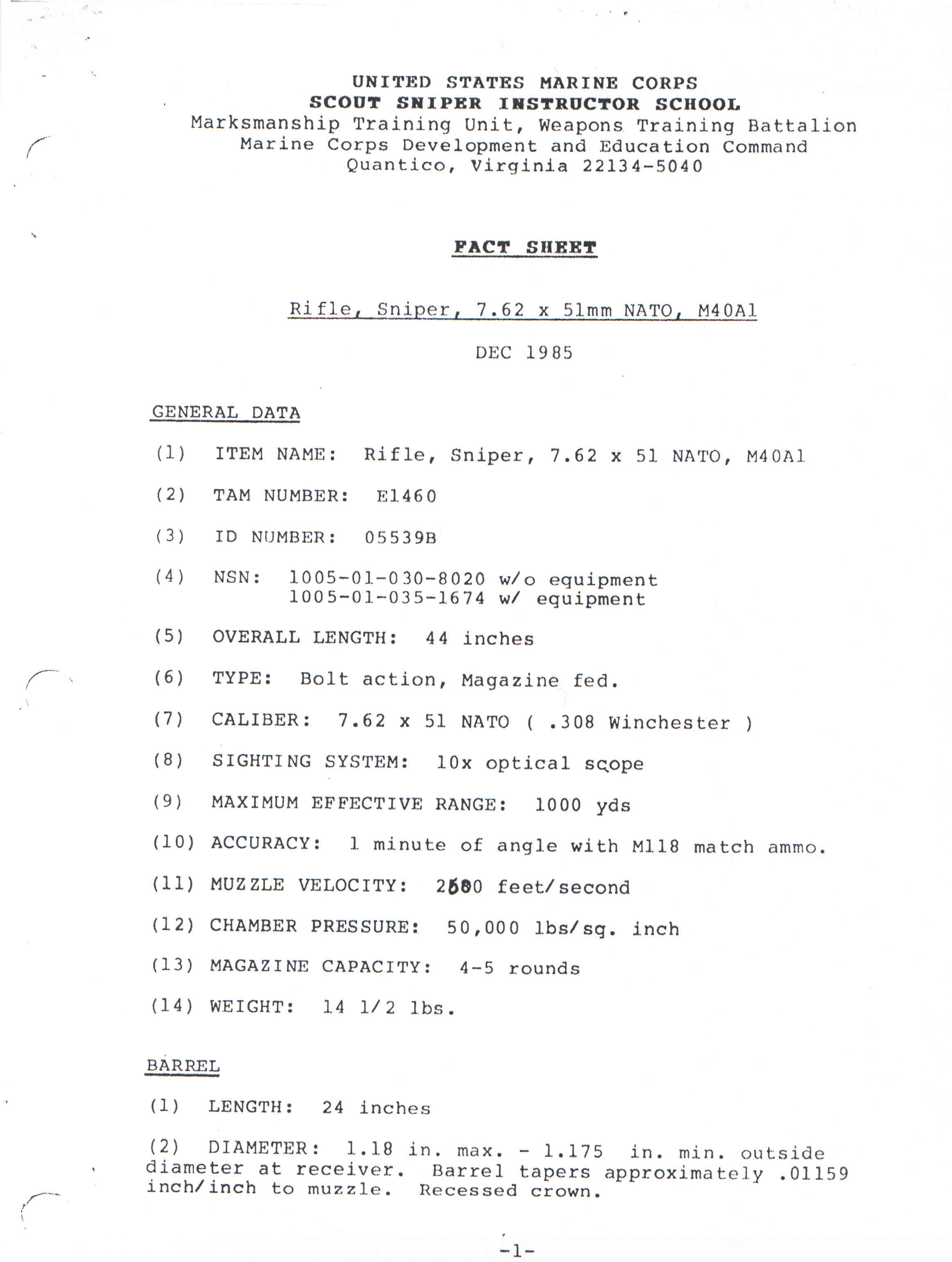

Here are the actual specs from the USMC on the M40A1
I have been following the M40A1 forum for some time now. I thought the forum members would like the spec from the horses mouth so to say. Here are the actual specs from the USMC on the M40A1 to clear up any questions. Many years ago in the early/Mid 80's Gale McMillan with Bill Atkinson and Tom Sr. of H-S Precision ( Bill was still involved for a short time after he sold Atkinson Gun Company to H-S) build my M40A1. My rifle is featured in Death from Afar : The History of USMC Sniping Vol. IV by Norman A. Chandler.
I hope this clears up any questions.
Enjoy !
Outstanding! That's quite a contribution to this thread. Thank you, Sir. I always have admired your rig in that book, and have to confess a little jealousy, too, in someone having one of those scopes so early. It seems maybe John Unertl was also in on your build? Welcome to the forum!
Yes, John was a part of this build as you correctly point out.. The 10X sniper on my rifle is exactly the same scope that the USMC use on the M40’s. The only difference was the markings. USMC Sniper vs. 10X Sniper. The USMC marked Unertl scope was not available to anyone but the USMC period. If someone had one marked USMC they have that scope under very questionable circumstances. The 10X sniper was only sold to government agencies like FBI ect. From what John told me I had the only one in civilian hands at that point in time. To say the least there are VERY few in civilian hands to date.
