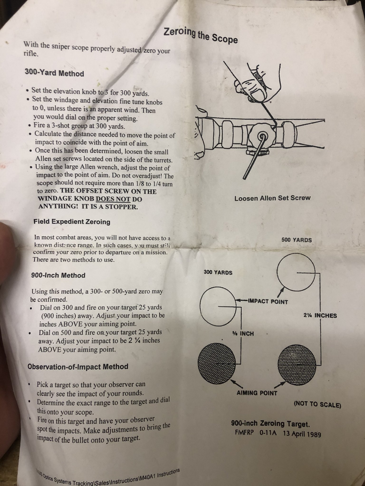

My uso and unertl are countersunk, also instructions say to zero at 300 yards if I’m not mistaken.
Steve is correct. Zero at 300 and that will be be solved.

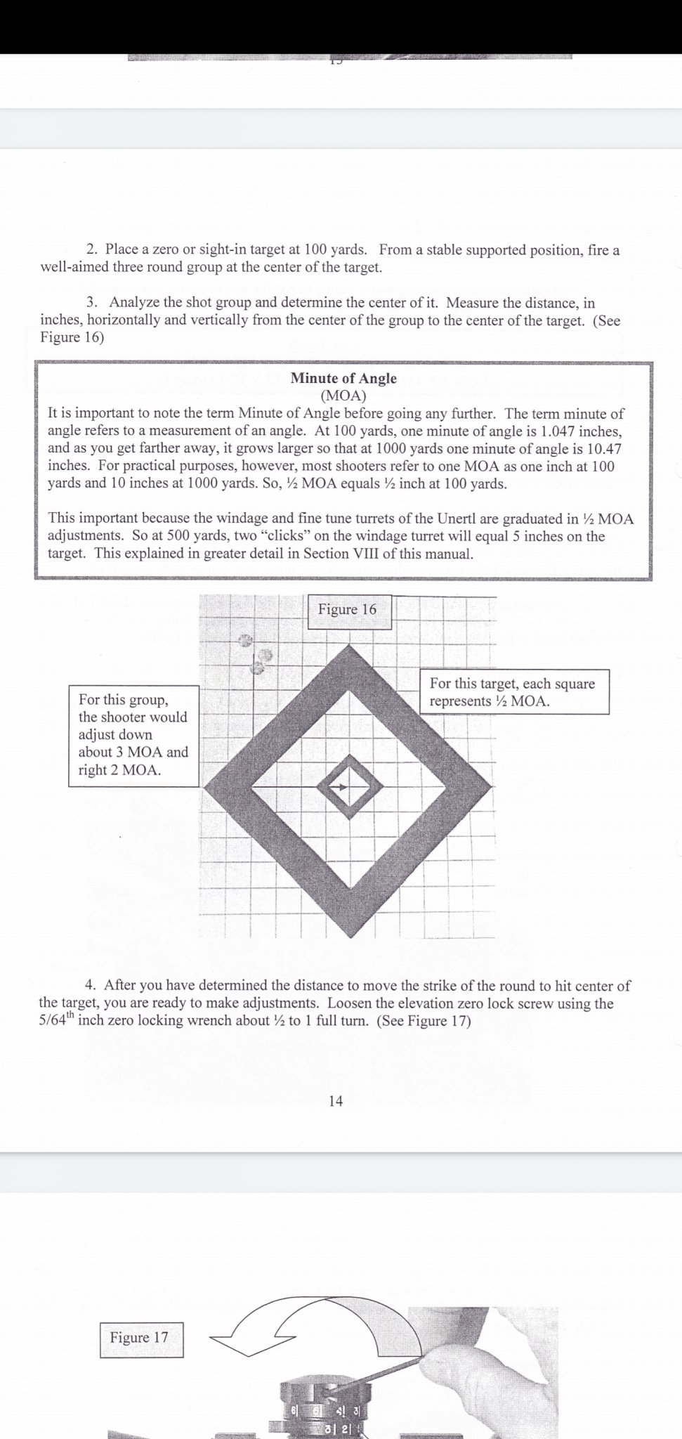

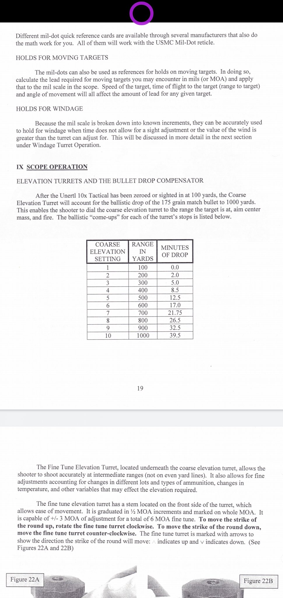

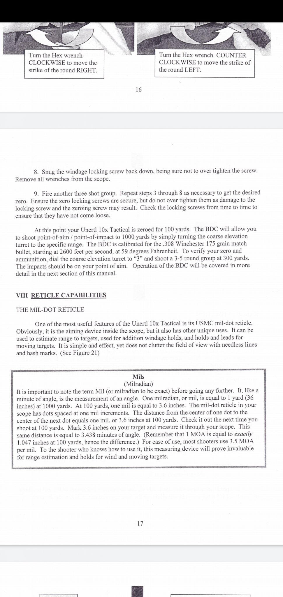

Im curious to know... whats with the 300 yard zero? What instructions call for that? I read the Unertl manual yesterday and sure as shit, it calls for a 100 yard zero.

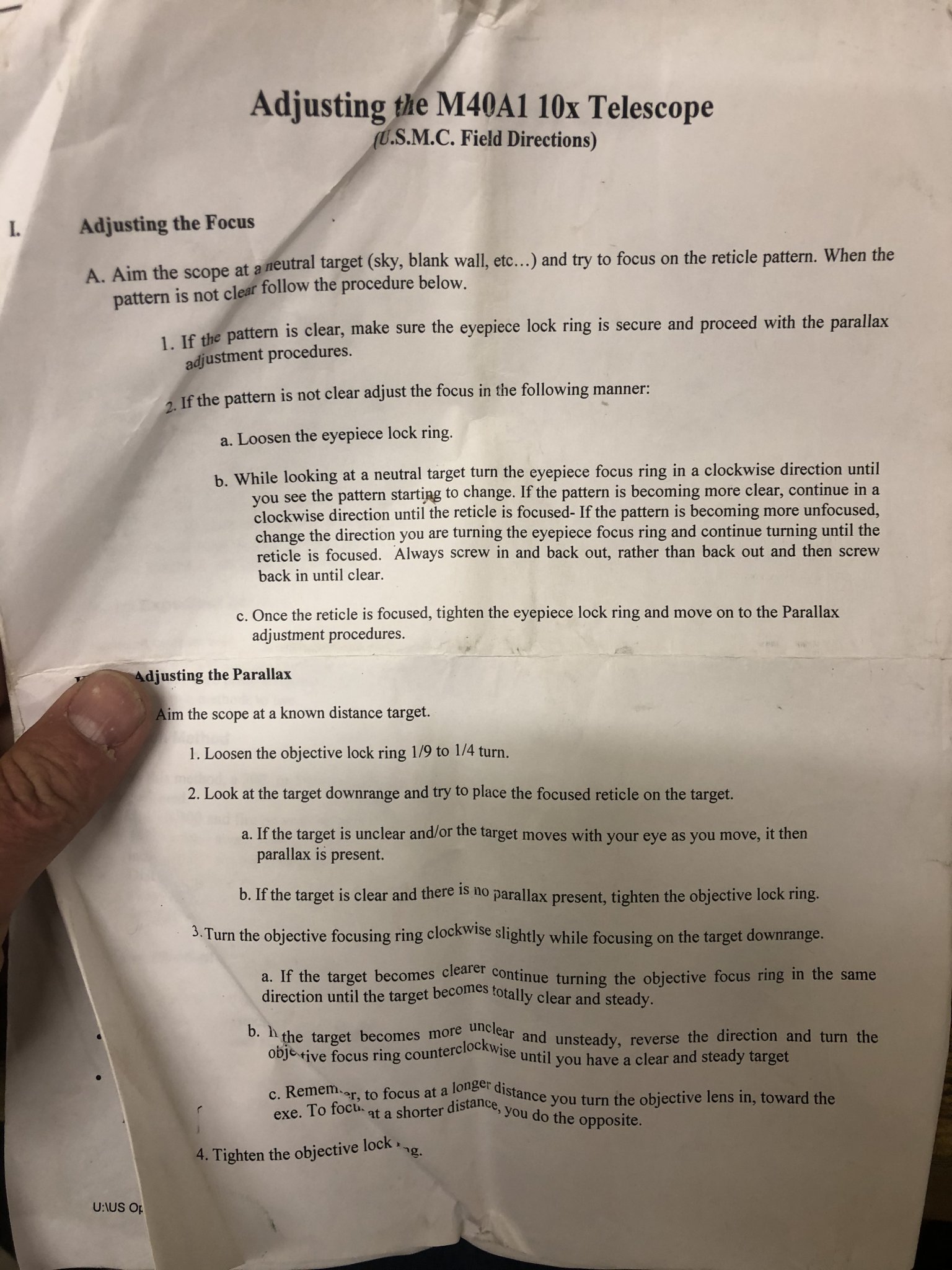

I’ll get my manual that came with the scope and send you a pic. Mine showed, 300 yard zero, 900 inch method, and observation method. This was from USO on the last batch of scopes they built. I’ll find it when I get home this afternoon and post a picture. Some other members here may be able to chime in.
Honestly hope I’m wrong on the 300 yard zero, sure as hell would be easier to zero at 100!
From the Unertl manual,
These were the instructions sent with my mst100 from USO. So I guess I was under the impression it had to be zeroed at 300 for everything to work correctly, I hadn’t seen the Unertl manual before. Glad to see it.
View attachment 7312629View attachment 7312630 These were the instructions sent with my mst100 from USO. So I guess I was under the impression it had to be zeroed at 300 for everything to work correctly, I hadn’t seen the Unertl manual before. Glad to see it.
The download link for the Unertl is in here a page or two back. It looks alot more thorough than the USO manual.
Reactions: Stevo86
