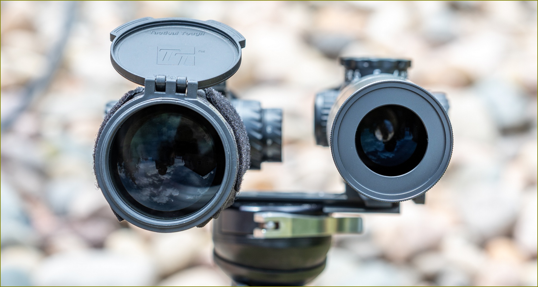

    In the images above you can quickly see that the Tangent Theta dwarfs the March 4.5-28 by a considerable margin, this is where that Japanese innovation comes into play, in fact, the March is .2 inches shorter than the ZCO 4-20 which is the champion from the ultra short battle I did back in 2019 –

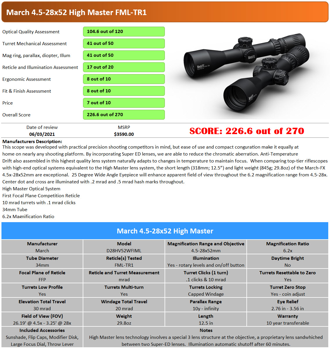

    SPECS
    The below specs are provided by the manufacturers which provides a good baseline for what these scopes offer. March is highlighted in yellow as it is new for 2021. Highlighted in red is a potential drawback and in green is a potential benefit.
    As mentioned previously, one of the most notable differences comes in size, the Tangent represents the traditional “long” scope design while the March represents the newer trend of “short” scope designs and is over 4 inches shorter than the Tangent. But other areas of note are:
    • Weight: The Tangent is over 10oz heavier
    • Field of view (FOV): March uses a 25° wide angle eyepiece offering greater FOV throughout the magnification range
    • Close focus distance: Tangent has a typical 50m while March offers down to 10 yards

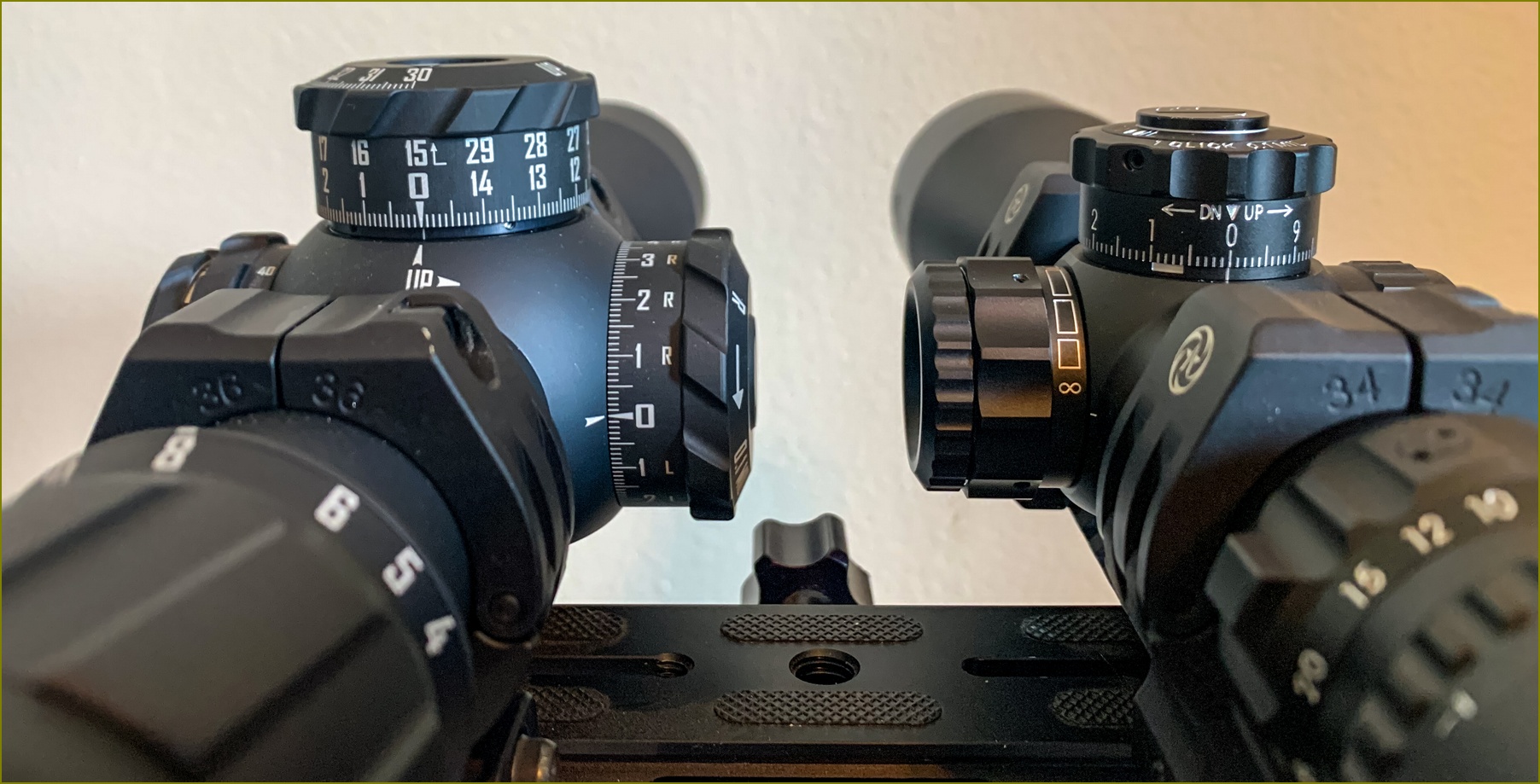

    TURRETS
    This review does not cover the accuracy of each scope but covers the functionality – since any manufacturer is capable of producing a lemon it’s always a good idea to test your scope to ensure its mechanical accuracy.
    Tangent Theta
    I have never considered myself a turret purest, having had many other scopes by numerous manufacturers over the years I could never quite understand what the “fuss” was all about with regard to turret feel. My general rule is – can it get me where I want to go quickly? If the turret can do that and is repeatable then it is a win in my book. That being said, I have experienced some somewhat lackluster turrets that leave much to be desired, so I assume we all have a threshold we are willing to accept. All that being said, if turret feel is your game, then Tangent Theta owns it – very distinct, no play whatsoever and a nice clunk between each .1 mrad gives you a sense of confidence anytime you spin the elevation or windage. Keep in mind these are 15 mrad per rev, and sometimes the spacing can be too tight, but TT decided to give you something more akin to a Ferrari stick shift to grab onto – it is meaty and with a diameter that allows for refined spacing throughout the 15 mrad of travel for each rev. Another unique feature is the toolless zero, something else that is unmatched in the industry. Have you ever found yourself at the range and forgot that tiny little hex wrench? What usually follows is #@&^%#$. With the Tangent you simply use your fingers to loosen the top plate of either elevation or windage and then you pull up slightly and spin to wherever zero is, push back down and tighten the top plate, that’s it, no hex wrenches needed. The Zero stop is always .5 mrad under 0 so this is automatically set wherever you set zero. Something I wish every manufacturer would introduce and if you don’t have that feature then do what Kahles did and stick a magnetic hex wrench inside the illumination battery cover so you have easy access in the field. My one and only complaint is that for such a massive turret housing, TT opted to put little tiny numbers, for young eyes this may not be a big deal, but ZCO got this one right with their large numbers and bold lines, something I wish TT and others would offer.
    March 4.5-28x52 High Master turrets
    Having reviewed the March 5-42x56 HM last year I fell in love with those turrets, not just for their unique locking mechanism but for the superb feel that is one of the closest to Tangent Theta I have felt to date. I was really hoping that March was going to offer the same locking turrets on the new 4.5-28x52 but unfortunately that is not the case (currently). That being said, these are still nice turrets with very little play and nice clicks. One unique thing March has done is offer a cleverly designed turret shroud that has a larger diameter and larger numbering than the turret on the scope itself, not only are the numbers easier to read, but the larger diameter is almost TT size giving a better feel to the turret in general. Another clever feature that March has had for a number of years is the 0-Set (or Zero Stop) which is “almost” toolless – if you have a coin or a key in your pocket you should be able to turn the 0-Set to define your zero stop after you have reset zero which does take a 1.5mm hex key. While it’s not toolless, and it’s not like Kahles with the key hidden in the illumination cover, March does give you a little key chain sized hex tool that doesn’t take up too much room on the key chain. The windage does come capped; however, it does have a nice feel so those who prefer to dial for wind can simply remove the cover to have a nice exposed windage turret that is still big enough to grab and spin even if gloved.
    Below shows the optional large elevation shroud with larger numbers.
    Turret Mechanical Assessment criteria (rating 1-10 with 1 being worst and 10 being best):
    Turret Click Spacing – Advantage March: March – 10 | Tangent Theta – 9
    This is more or less a personal preference, but my hand feels better with wider spacing. Tangent Theta is the best I have felt from a 15 mil per rev turret while the Nightforce has one of the best 12 mil turrets in the ATACR series and the Schmidt DT II+ aligns with the ATACR as some of the best 120 click per rev turrets, but the March with it’s 10 mrad per rev spacing is still very good indeed.
    Turret Click Feel – Advantage Tangent Theta: March – 8 | Tangent Theta – 10
    This can be very subjective, but I am drawn to more distinct click sounds with very little play between marks, the Tangent has very distinct clicks with no play, the March is less distinct but also has no discernible play.
    Turret Alignment – Advantage Tangent Theta: March – 7 | Tangent Theta – 10
    Both Tangent Theta and March turrets aligned perfectly through my testing running the turret out to the extreme and back. Because of March’s translatable design, it does rise pretty high above the center mark which gives a slight perception you are off mark if your eye is not perfectly centered, but with the larger turret shroud may be even more difficult for some to verify alignment. I much prefer the non-translatable design of the Tangent Theta.
    Turret Reset Zero and Zero Stop – Advantage Tangent Theta: March – 7 | Tangent Theta – 10

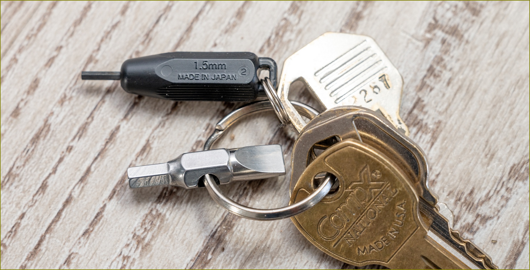

    In order to reset zero on the March you have to loosen the side hex bolts on the turret housing, then spin the turret to align zero and re-tighten, this is typical of most long range scopes today and is only bested by the toolless design of the Tangent Theta turrets. March offers the coin/key adjustable zero stop mechanism; however, some may find an issue as this feature does not always stop below zero at the same spot – depending on how much effort you give it you may stop short or overtravel from where you intended to set the actual stop. Tangent is always fixed at .5 mrad below zero and that is something you can count on every single time which has its advantages for night shooters and those who prefer to count up after hitting the stop vs. visual recognition.
    Turret Locking Mechanism – Tie: March – NA | Tangent Theta – NA
    Neither of these scopes offer a locking mechanism so I am not going to rank them for that. The March does offer a capped windage which some shooters prefer. No one who owns a Tangent has ever said it has been bumped out of position in competition, YMMV.
    Total Travel Adjustment – Advantage March: March – 9 | Tangent Theta – 8
    March offers a total of 30 mrad of elevation travel while Tangent has 28mrad. On the windage side the March offers over double that of the TT with 20 mrad of travel vs. Tangent’s 6 mrad.
    Overall Turret Mechanical Assessment – Advantage Tangent Theta: March – 41 | Tangent Theta – 47 (50 points possible)
    No surprise here, the Tangent Theta is simply the best of the best with regard to feel and function. March has a slight advantage with a bit more travel and the larger numbers on the dial. Does the March provide a Theta like experience, no it does not, but take Tangent Theta out of the picture and the March turrets are well equipped against the rest of the competition.

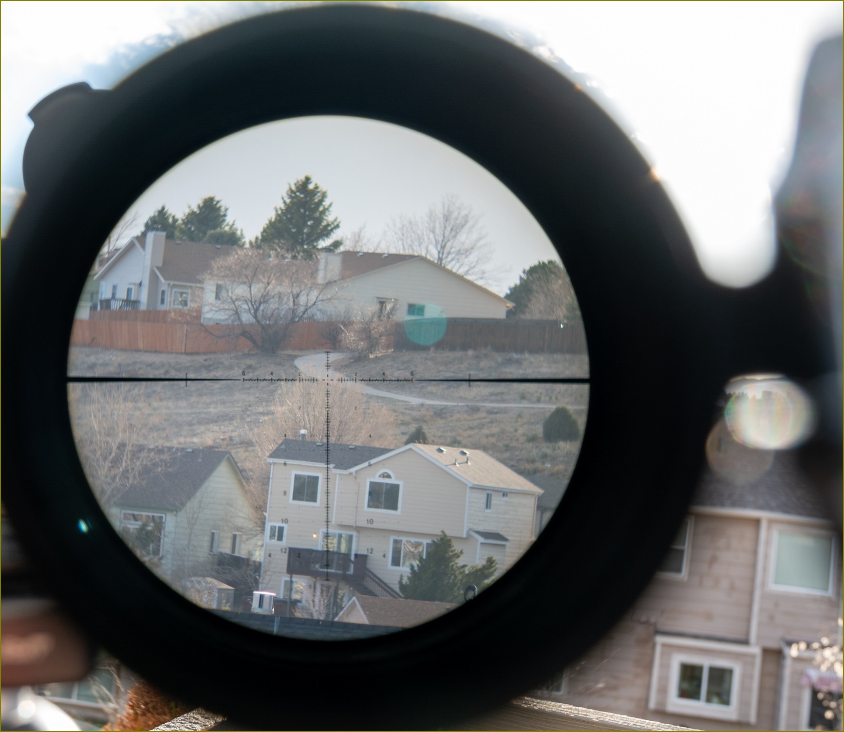

    Field of View (FOV) – Advantage March: March – 10 | Tangent Theta – 8
    The new March 4.5-28x52 High Master with its 25° eyepiece has enormous FOV for a long range scope. Many shooters often mistake low magnification for being able to “see” more; however, this is not always the case. For example, while the March has a low magnification of 4.5x, it actually has greater FOV (29.1’) than the ZCO 4-20x50 does at its lowest magnification of 4x (28’), so in reality, even though the March has a higher magnification at its lowest setting you can actually “see” more. For an older design, the Tangent Theta has very impressive FOV numbers and has been one of the best scopes in that category. Neither of these scopes showed any significant tunneling at low magnification. Outside of the specs which offer FOV numbers at the low and high magnification settings, keep in mind that FOV is not always a linear value so extrapolating actual values can be difficult. A couple years ago I began to measure the mrad value once I could detect it and for many long range scopes this is usually around 15x. The following numbers are from center so to get the full FOV value just multiply x2:
    MagMarch 4.5-28Tangent Theta 5-25
    5xNA33 mrad
    10xNA20.5 mrad
    15x15 mrad14 mrad
    20x11.2 mrad10.6 mrad
    25x9.2 mrad8.4 mrad

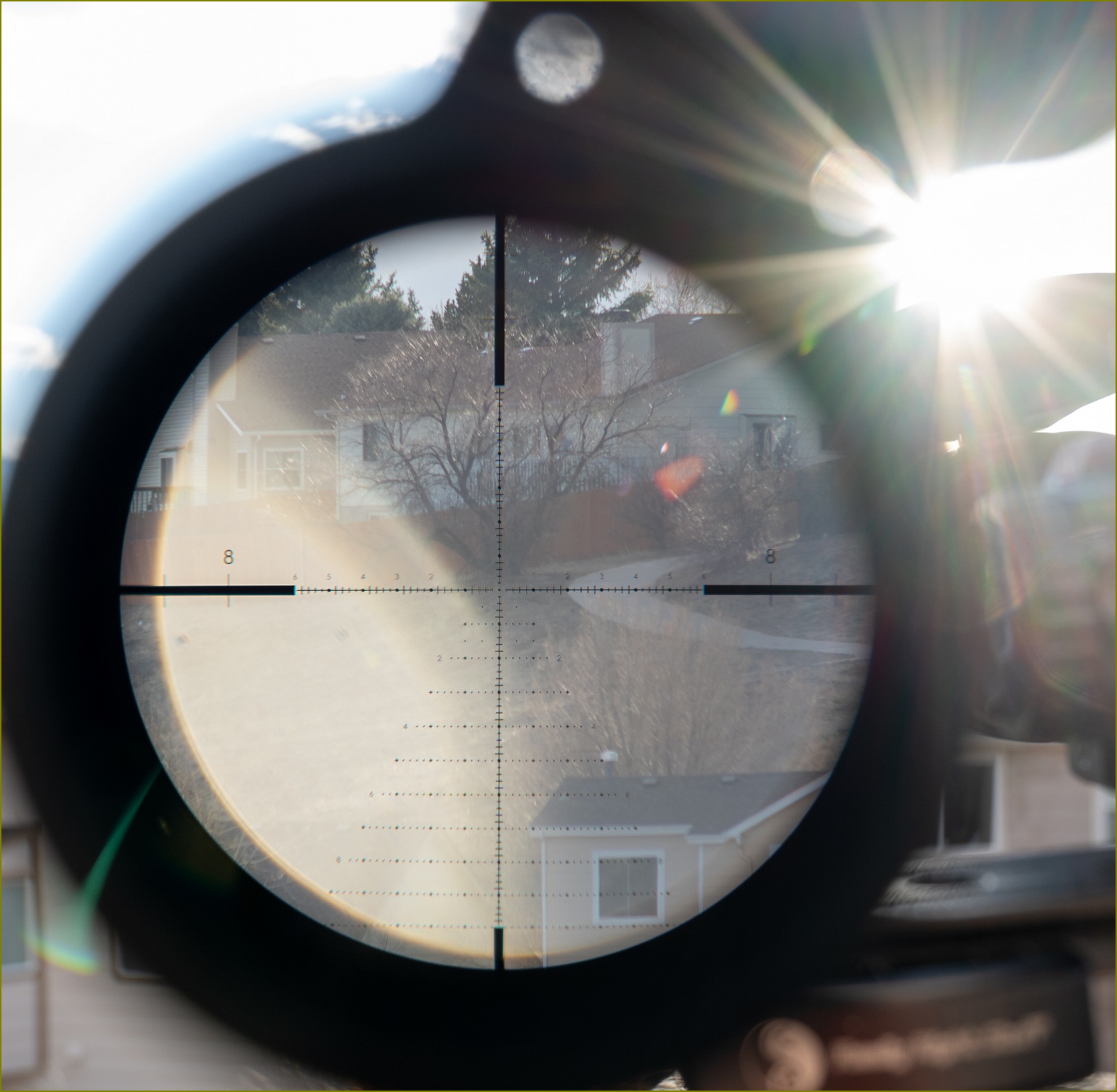

    One of the most important choices one can make in a long range scope today is the reticle, this is, after all, what you will see every single time you bring the scope to your eye so it’s important to make sure that it fits the needs or your shooting style. That being said, reticle selection or preference is extremely subjective and saying Brand X reticle is “the best” is like saying “Brand X vanilla ice cream is the best” – we all have different tastes, and the good news is that there are many options available to the long range community. With this in mind, my ratings below should be taken with a grain of salt because they are based on MY preference, but I will explain what I like and why, which should help you understand if it might be something you would like or not like even though I may have a differing opinion.
    Reticle & Illumination Assessment criteria (rating 1-10 with 1 being worst and 10 being best):
    Reticle Usability – Tie: March – 10 | Tangent Theta – 10
    The reticle in the March is their new FML-TR1, which is a superb design created by none other than the Dark Lord of Optics himself. The reticle provided in the Tangent Theta is their Gen 3XR design. Both are a newer .2 mil hash design with dots in the Christmas tree, which I prefer, because they do not obscure the image as much as the solid lines of some other tree designs. One of the interesting features of the FML-TR1 is that the Christmas tree dots virtually disappear when you’re not using them, they blend into the background. The Gen 3XR also does a decent job at this but not to the level of the TR1. A feature shared in both designs are the larger center dot, in a trend by many manufacturers to make the tiniest center dot possible, I find myself constantly searching for this dot, especially on dark backgrounds, but that does not happen with the FML-TR1 and Gen 3XR which both use a .075 mrad dot. The FML-TR1 adds a .075 mrad center cross to complement the dot, this cross is .2 mrad wide and is spaced .2 mrad from the center dot and main stadia making it very easy to measure without clutter, the Gen 3XR has large dots every full mrad mark in both horizontal and vertical stadia. When I first saw the specs for the reticle, I was worried the center would be too thick, but it is ideal in my book offering the perfect balance and allowing it to be usable even at low magnification.
    Illumination Color and Brightness – Advantage March: March – 7 | Tangent Theta – 6
    Both scopes offer red illumination as the only option. Tangent Theta has lackluster performance when it comes to brightness, but sufficient for low light engagements. March has improved on previous performance but still does not deliver a daylight bright illumination out of their 6-setting module, although it too is sufficient for low light situations. I would say the March is ever so slightly brighter than the TT illumination. March did not exhibit illumination bleed while the Tangent Theta’s illumination did show slight bleed on full power but not enough to be distracting.
    Overall Reticle & Illumination Assessment – Advantage March: March – 17 | Tangent Theta – 16 (20 points possible)

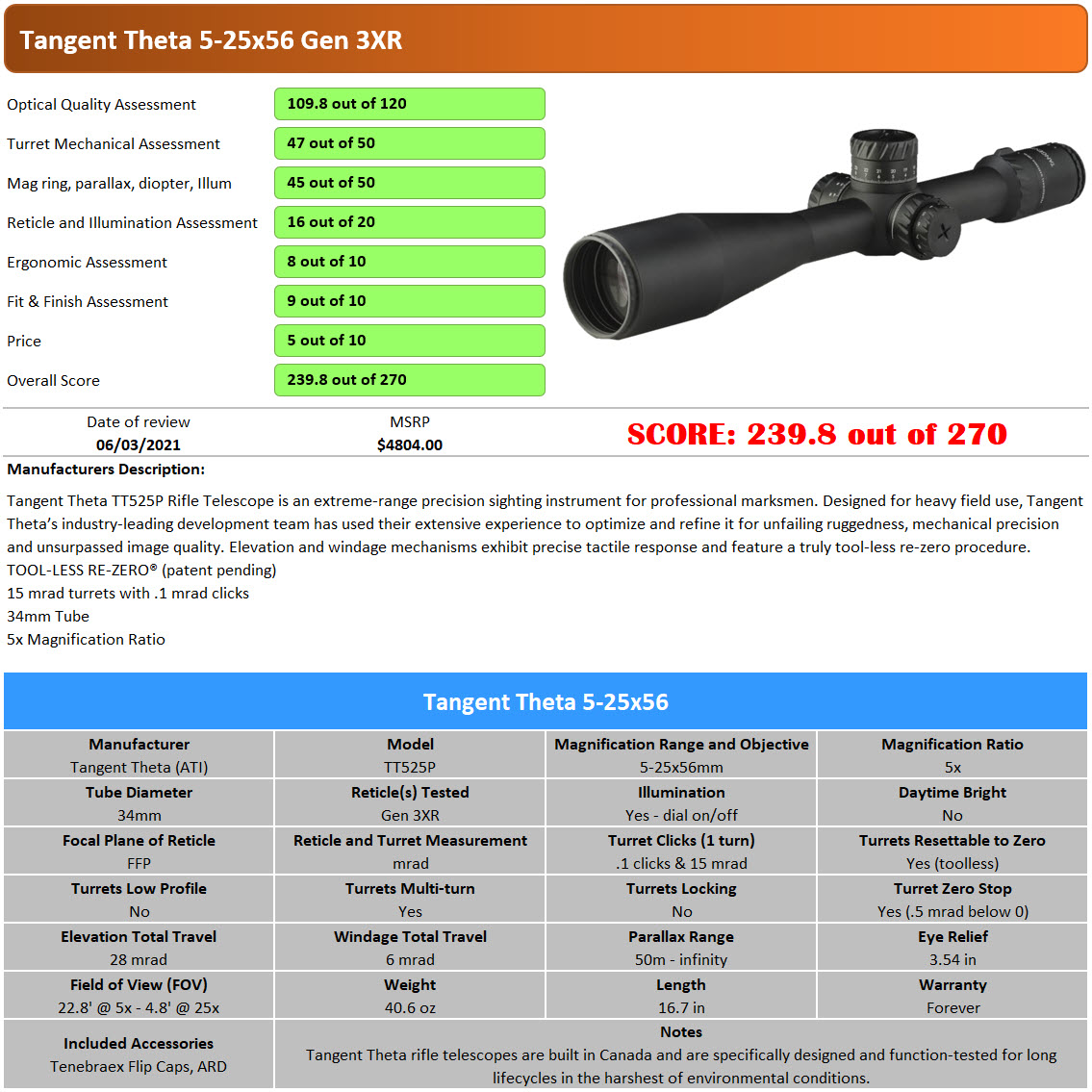

    Final Score – Advantage Tangent Theta: March – 226.6 | Tangent Theta – 239.8 (out of 270 possible points)
    It should come as no surprise that Tangent Theta takes the blue ribbon in this competition, but the March has proven to be a confident runner up. This was kind of an “unfair” comparison to begin with as we are comparing one of the best scopes on the market today to a new comer that is designed to push the limits of what can be done in a short body design. The final results are very close and I could easily see any one shooter choosing one scope over the other. At the end of the day the March has so much going for it: less expensive, shorter, lighter, more ergonomic with very nice turrets, High Master glass with amazing color/contrast with an industry leading FOV (for its magnification range). The Tangent Theta bests the March in several areas including overall resolution, edge to edge sharpness, overall fit and finish, eyebox and DOF. If the features of the Tangent Theta suit your fancy more than March you won’t find an argument from me, but I highly recommend you give the March a chance especially if you're looking for a scope that packs so much into a shorter/lighter design, I think you will be pleasantly surprised and at over $1200 less, your wallet will be thanking you as well.

    Score Cards for the above review:

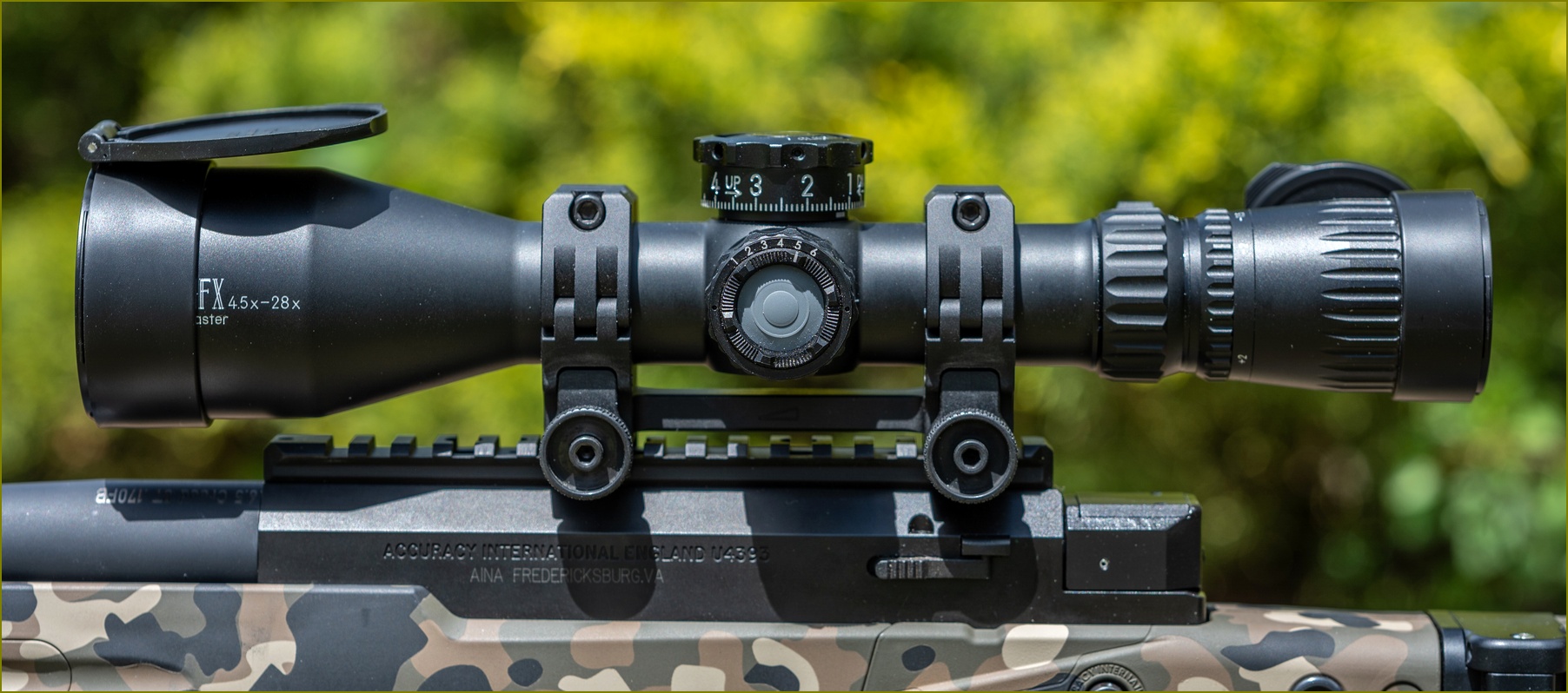

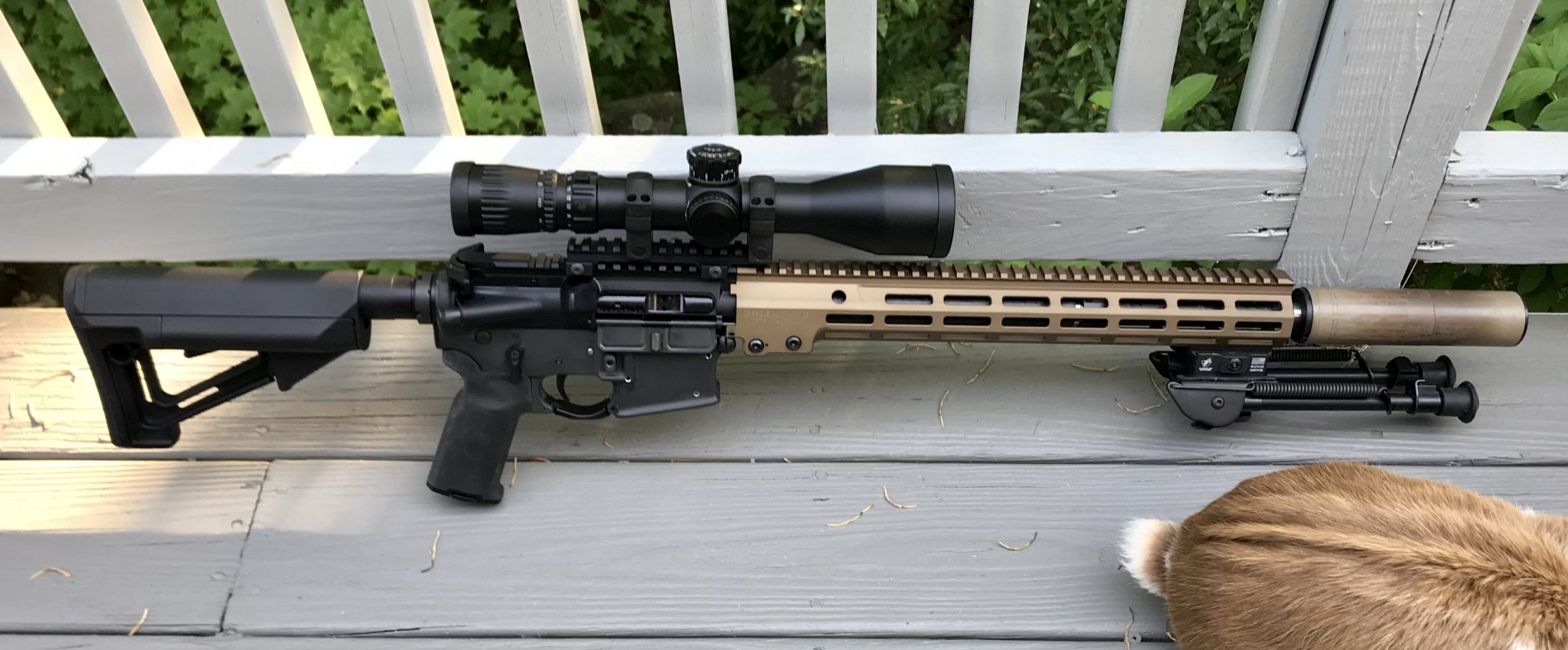

    Here are a few more images I would like to share.
    Of interest is the fact that even with the sunshade attached the March is still shorter than the Tangent Theta.
    ZCO really has the best printed turrets in the business - so easy to read!

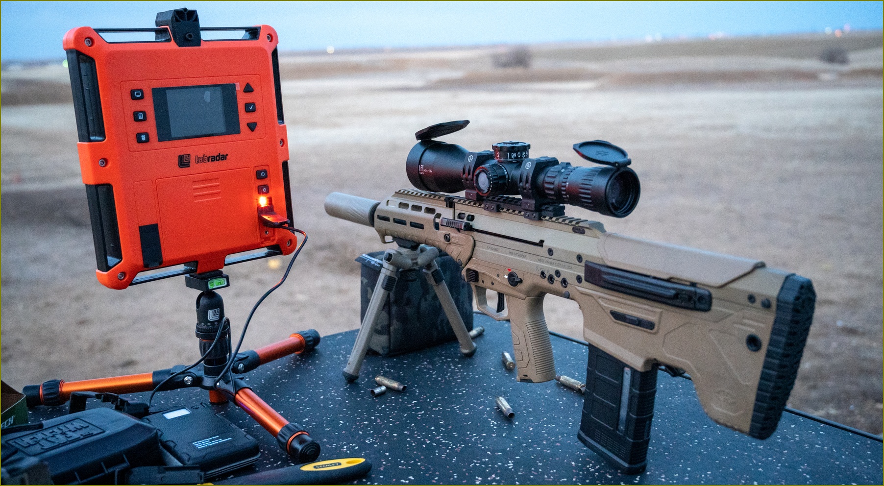

    The March is even at home on my extremely short DT MDRx

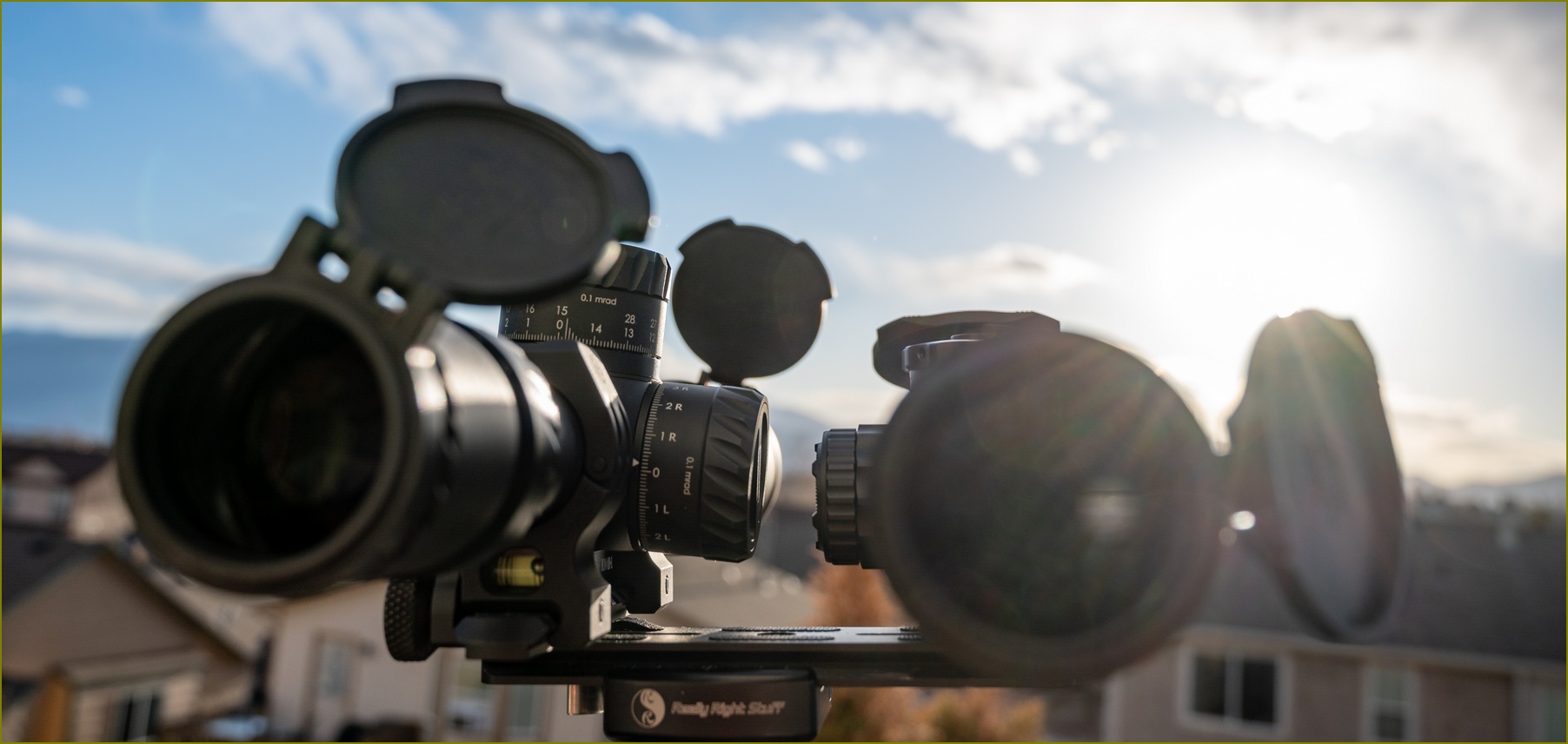

    March does a surprisingly good job with flare when direct sunlight is hitting the front objective... TT, well not so good. NOTE: DO NOT USE THE BELOW IMAGES TO MAKE IQ EVALUATIONS, THIS IS ONLY TO SHOW HOW THE SCOPE HANDLED FLARE.

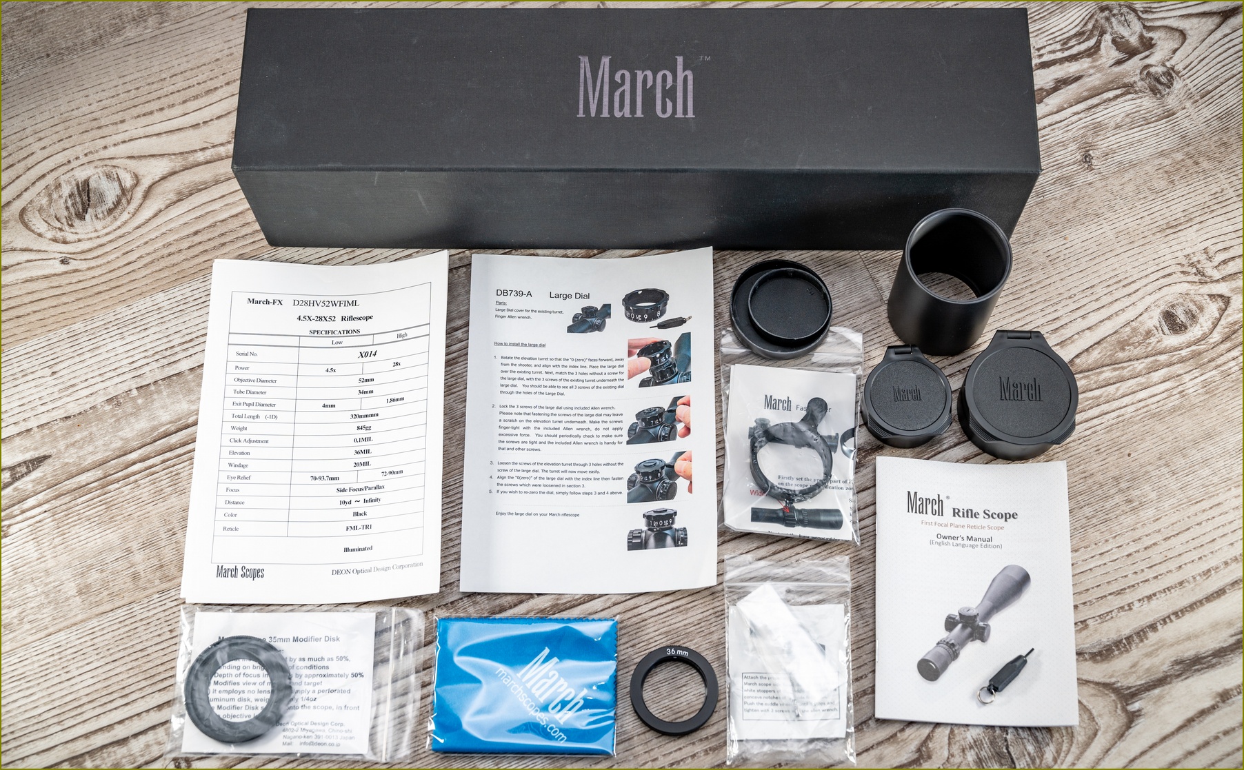

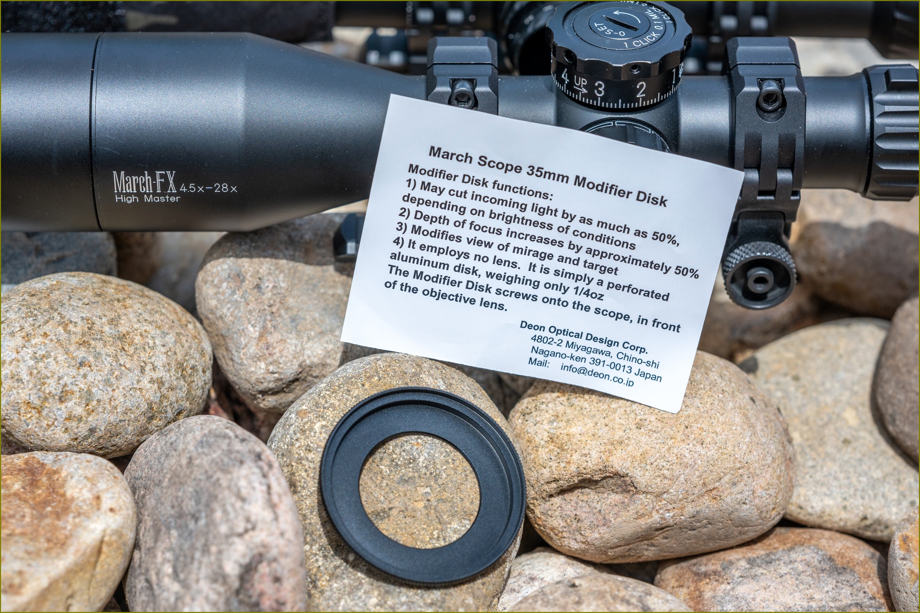

    March also offers this clever aperture disk which they call a modifier disk. I did use it for some testing and found that it did seem to make DOF and parallax a bit more forgiving and brightness is not affected during well lit conditions.
    Below is with the modifier attached on the front of the sunshade. (Yes, the cap can still fit over the disk)
    March's accessories are impressive compared to many manufacturer's offerings

    I’m wondering if I should add a section under optical evaluation for Flare when directed at the sun. Is that important to a lot of shooters or do you simply use a shade or ARD to rectify?
    Shooting in the morning is a great way to start a day! That is also when lens flare is at it's worst. The little details like that will help to go along way when deciding on which scope to buy. Especially for morning target shooters and hunters. I'm quite surprised at the difference between the two, I thought TT would fare just as well. I wonder how the ZCO's and S&B's compare with the flare?

    You are comparing a 56mm objective to a 52mm objective. Yes, I did see where you pointed that out a few times, but I think it’s extremely important to keep that in mind when we talk about resolution. All else being “equal” a larger objective will provide for more resolution; it’s the nature of the optic beast. So I was very impressed that even with its smaller objective lens the March-FX was very close to the TT.
    In your pictures, you show the March-FX with its lens caps installed and opened, but for some obscure reason you do not show the caps in the locked-open position. I think that’s a neat feature of the March lens caps and you don’t show that to good effect. For those who do not know, when you flip open the March caps, you can press them against the tube in the open position and they will lock in place and stay close to the tube and very flat. I like that better than having them flop around.
    Regarding the FOV of the March-FX, you compare it to HD. I don’t think that quite does it justice. I think a more fair comparison would be to watching a movie in IMAX; you just get to see so much more of the movie. Every time I look through these March wide angle eyepieces, I am still in awe of the huge FOV. When I go back to a regular scope, it’s like looking through a tunnel, the wide angle eyepieces do spoil you.
    Speaking of FOV, when you compare the edge-to-edge IQ of the TT to the one from the March-FX, do you take into account the increased FOV of the March? In other words, did the same area visible through the TT have as good an IQ in the March? Understanding that the extended FOV area would have reduced IQ.
    When I was doing comparisons of these WA eyepieces with normal eyepieces such as those on my March-X 10-60X56, it did seem to me that the coverage area shared by both normal and WA eyepieces were "similar" but there was a definite IQ degradation in the extended area for the short bodied March scopes. There was no such degradation in the full-bodied March Genesis 6-60X56 with the wide angle eyepiece.
    However, that said, I think you did an excellent job presenting the FOV differences between the two scopes.
    I do not understand why you used NA in the 5X and 10X magnification for the March-FX 4.5-28X56. I guess I should read the prior paragraph a few more times.

    I also noticed that you had the sunshade on the March in many (most?) of the pictures. That gives rise to some issues. First, it negates the benefit of the small size of the March compared to the big TT. Second, it gave an unfair advantage to the March when dealing with the direct sunlight hitting the front objective, if the TT did not have a sunshade attached. Since you always show the March-FX with the attached sunshade and the TT without, I’m guessing it had the sunshade on for that part of the test and the TT did not.
    I’m here to tell you that when the Sun is close to your field of view, a sunshade is like a little round candy with a whole in the middle; a lifesaver. A few years back, I was shooting a late afternoon match at the Nationals in Lodi. The range is oriented east to west. You guessed it, the sun was just a few degrees off the riflescope line of sight. I had to place a poncho over my head to hide from the Sun. My scope had its sunshade on and it was doing a great job. I heard others around me bitching about flares in their scopes without sunshades. I was able to aim my spotting scope at the 2 flags I was monitoring and the Kowa has a retractable sunshade built-in. It was sticking out that day.
    So, if the March-FX had its sunshade and the TT did not, that’s one thing. However if they both had, or worse, did not have their sunshades, that’s a very different story. It would be nice to know which had the sunshade attached.
    About the accessories that come with the March-FX. You mention the modifier disk and when to use it. It’s essentially an aperture reducer and in photographic terms, it’s one stop; cuts the incoming light in half and increases the DOF.
    You did not mention the middle wheel for the side focus knob. I find that makes a huge difference in adjusting the side focus as it gives greater granular control over the setting. I highly recommend it. Also, for old geezers like me plagued with arthritis in the hands, it makes it easier to adjust the side focus.
    You did mention the fast lever and I have them on my riflescopes. Yes, the March one is made of plastic and thank God for that. If you accidentally hit it (as I have), it simply comes apart and falls without messing up the scope or anything else. You pick up the two pieces and snap them back on the riflescope. I can only imagine what would have happened with a metal lever or one that was screwed into the ring. Yuck.
    Yeah, that little hex key fits very well on a keyring. This way, it’s always with me.
    Yes, the March definitely had an uphill battle here, the key here "all else being equal" but it is not. Think of it like a heavy weight champion going up against a middle weight champion ;)
    Just above the Ergonomics section I show the cap fully open. This picture shows the March cap as flat as it can go
    I did not account for this because for my eyes it is the whole scope experience and that is what I was trying to evaluate. My eye doesn't look at only 80% of the view for example, it looks at the whole view. Oddly enough when looking at typical landscape I did not notice the drop in resolution in the edges nearly as much as when I was using my test target, so field use is actually really good in this area.
    It's because there were no reference markings in the reticle below 15x for me to ascertain how much mrad there was, but I could on the TT so put it there.
    I had to go back and look and you're right; however, I did not use the sunshade for any of the testing as I do not have a sunshade for the TT and wanted to keep it apples to apples.
    Neither had sunshades attached for my testing.

    Thanks for that. Really puts in perspective how incredibly small that optic is compared to others.
    I'm planning on getting the March 1-10 for this build but the rifle the 4.5-28 is meant for is waiting on a Manners stock so wont be in action for a few months so I figured why not put this together and see how it feels. Just looking through the scope and feeling the turrets, it's really, really nice. It could easily live on this rifle without being too big. It would fit an SR25 like a peach. Throw in an Offset RMR or T2 and it would be as close to perfection as one could get. Just my opinion.
    Reactions: Glassaholic
    That’s exactly what I’ve been looking for. An optic for an AR10 I have on order (seems like forever now), planning to run an offset red dot. Dual use for hunting hogs at night and shooting long range steel / occasional PRS type competition.
    Surprisingly not many compact crossover FFP optics out there.
    Was originally considering the Mark 5HD 3.6-18x but lack of reticles and illumination pushed me away. Plus a larger FOV and Objective for low light is desirable.
    That March 1-10x looks impressive on it’s own merit as well. I’d be interested in how it compares to the Vortex. One thing Vortex excels at is daylight bright Illumination, I wonder how the March holds up in that area.
