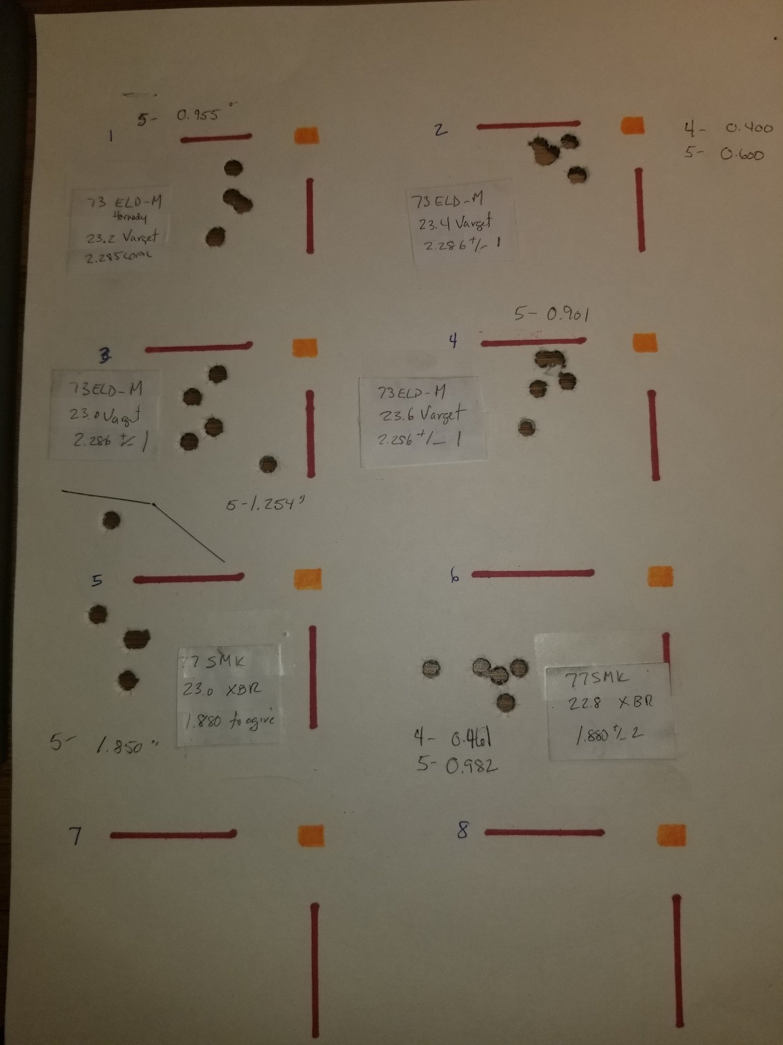

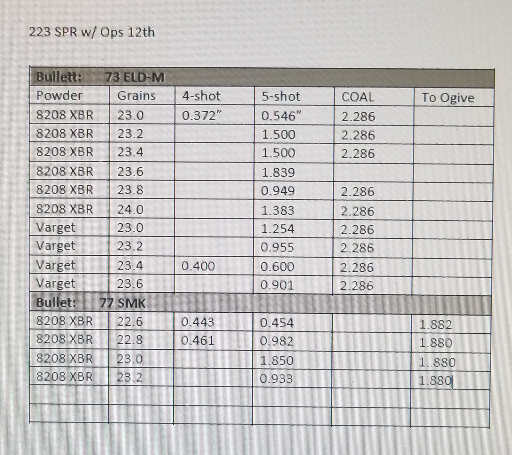

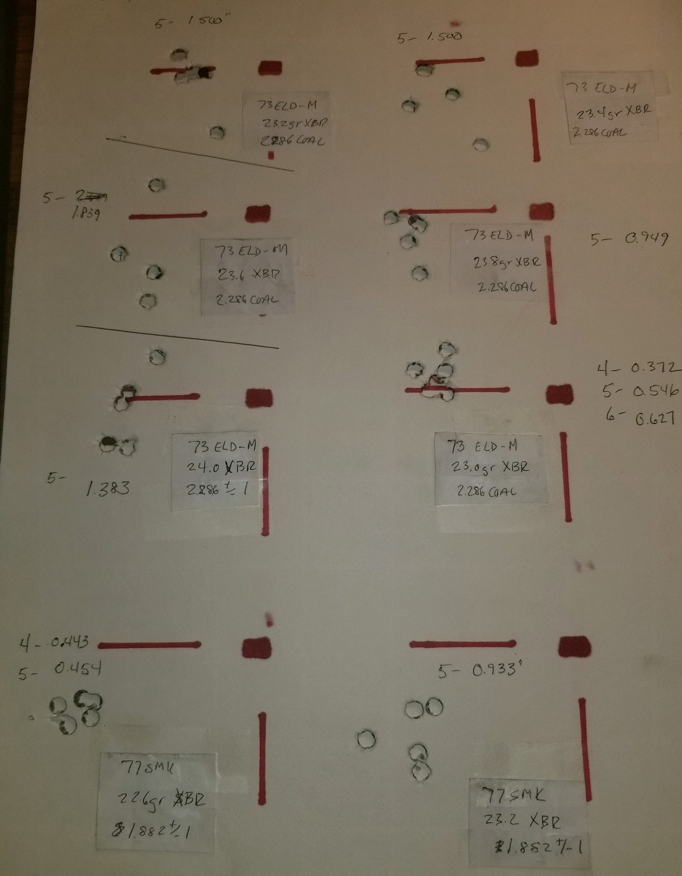

Anyway....I gotta get the actual range and run ladder tests on THIS gas gun to try to maximize its inherent accuracy potential. CUz that's how I form my opinions... from range time, not from computer time.

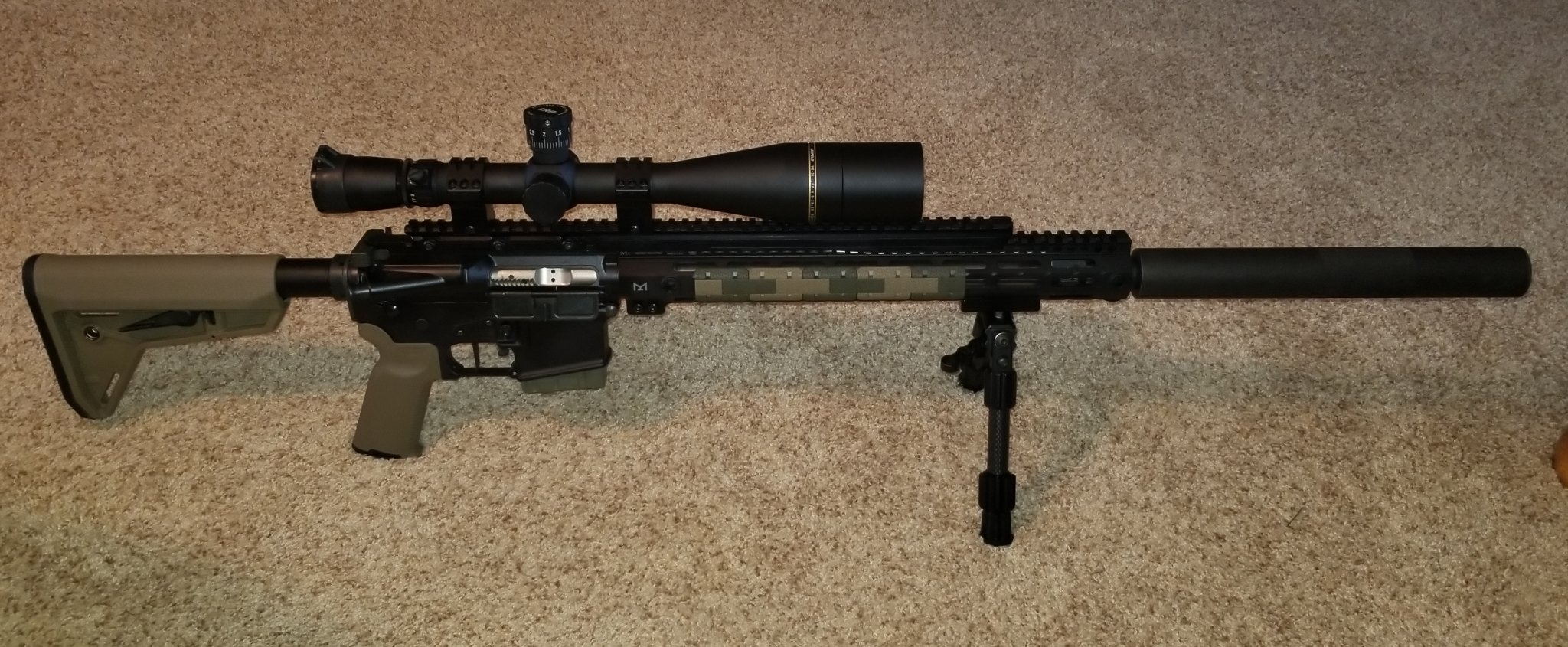

As others mentioned best to ride your scope all on the receiver rather than receiver and handguard.
A solid base will take out any possibility that while flexing your handguard you are doing something funky to your scope alignment.
Is that a MARS rail of sorts on there?
Its a PRI rail. Its standarfd kit for a SPR / DMR.
If you look closely, you see the PRI rail *is* bolted to the upper receiver ONLY, and its "floated" unattached to the handguard. The scope is attached to the rail.
This is my second SPR / DMR build . I did both the same way, with (now - I'll psot pics of todays range session later. basicaly thre differnt loads in the 0.400 - 0.600 range ) good results.

RANGE UPDATE:
My 3 ladder tests revealed three separate loads in the 0.400 - 0.600" range, as follows:
77 SMK / 22.6gr XBR.... 5 shot: 0.454"
73 ELD-M / 23.0 XBR....5 shot: 0.546"
73 ELD-m / 23.4 Varget... 5 shot: 0.600"
In this case, I'll attribute it to hand loader error (i.e. me :) ) - not doing expansive enuf ladder tests, and not using 73 - 77 gr boolits, opting for too light, 68-70 gr.
But I gotta go 5 x 5 test all this, to find repeatable groups and eliminate lucky groups.

I know similar rail was used on Mk12 Mod 0.
Didnt see that set up until I expanded the pic.

My point is I was QUITE sure I was NOT the cause of the groups opening up from 0.500" to 1.500 and larger. And my range time today confirms that. Next I'm gonna go "super confrm" it with 5 x 5's.

I would still move the rings so there both on the reciever. I know the forend is bolted to it but bolts can stretch/loosen under recoil over time, if your loading the forend with a Bipod or barricade you always run the risk of twisting the forend etc. Two parts on a rifle will have different reactions to heat as well. One moves this way while the other goes that way etc
Do what you want but a scope mounted to the reciever only runs less of a risk of having issues down the road.
