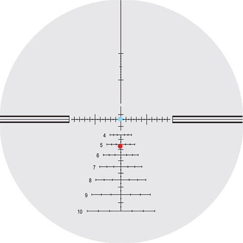

I can barely stand it anymore.
blue is your POA
Red is your POI
You can either hold at the Red dot (POI becomes next POA) for an instant solution, or you can dial 5.2 MILS, MOA what ever your turrets are (as long as they match the reticle of course). Correct call would be come up 5.2 . How in the hell did you sight in your rifle?
Wind works the same way, hold or dial
