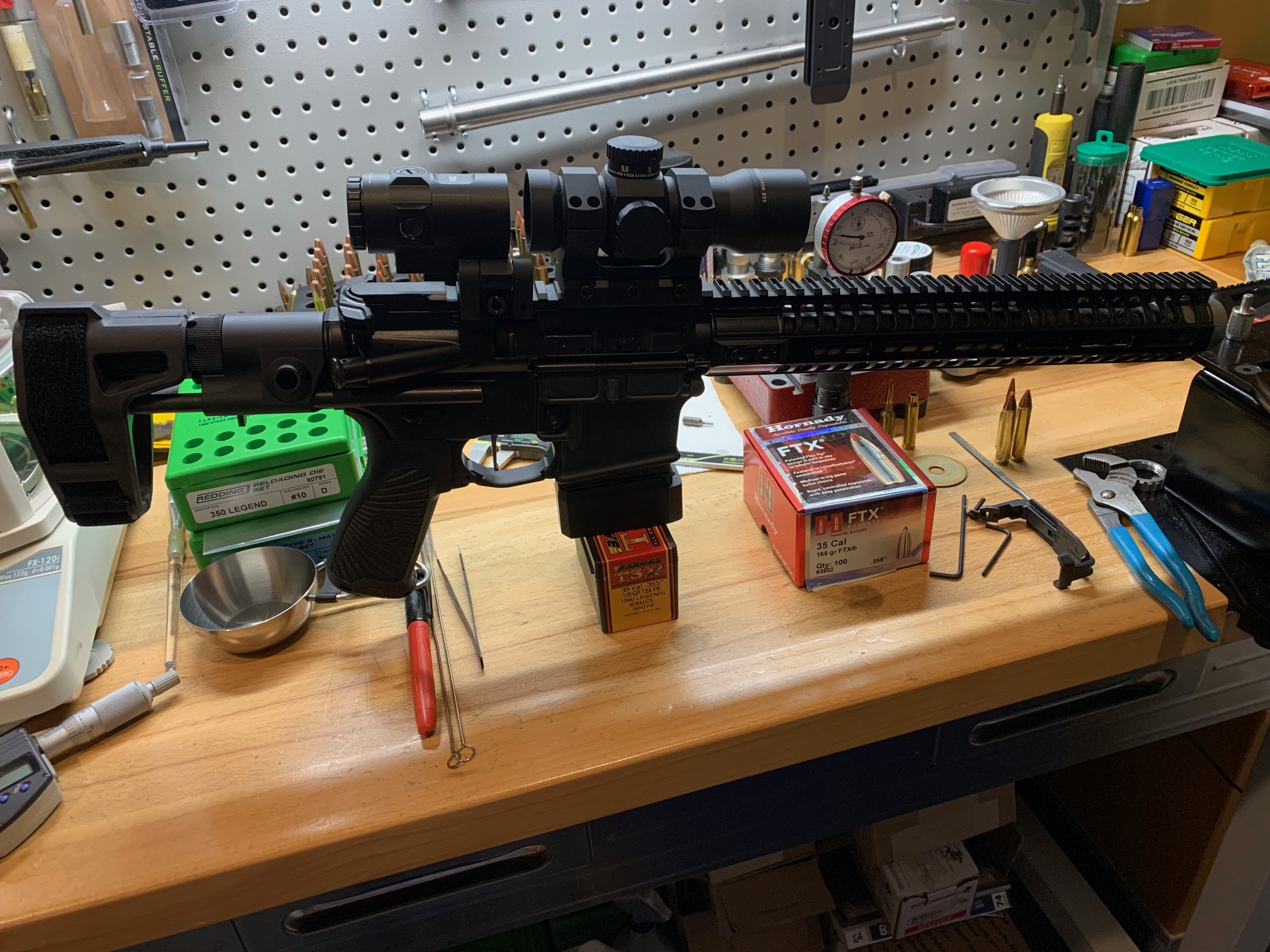

    You'd need about a 10" barrel to build a 45 Rapter AR 10 pistol. That's going to kick out some impressive fire balls.

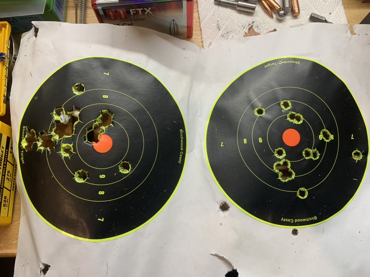

    I went 11" braced 350L, so I may get screwed yet again by ATF. It should die a quick death in court, but this shit is getting old. My compliance tank is about empty.
    25-1/2" OAL as it sits.
    Factory Hornady 165 FTX gives me 2140fps from the 11" barrel.
    Actually just loaded some ladders of 165 FTX & 170 Barnes TSX to shoot tomorrow.
    Giving SBR-SOCOM powder a try.
    I'm expecting the Barnes to expand pretty well. Might shoot an old MSC catalog to see how it does.
    Also FYI you can buy the Barnes 170TSX as factory loaded ammo now I believe.
    Win brass weighs 101gr. Top load is 28.9gr compressed with the Barnes @2.265
    Hornady brass weighs 95gr. Top load is 29.2 compressed with barnes @2.265

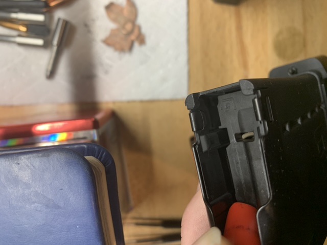

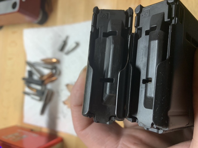

    That is fantastic velocity from an 11" barrel. How have you gotten the FTX to feed reliably? What barrel are you running?
    I believe part of the loading for the 350 is that it headspaces off the brass so OAL is critical (I haven't reloaded pistols at all so this is new to me). Would love to hear how the FTX and TSX loads do for you with that powder.

    The barrel is an X-Caliber SS 6 groove built to my spec. 11”, 16T, heavy contour .875 gas block, Carbine length gas, 5/8x24 threads.
    For feeding I blended the M4 ramps in the extension. It still doesn’t like blunt rounded bullets like what comes in the Browning range ammo. I also modified a 300BO mag by cutting the ribs in the front of mag on the sides. Notched the front of mag a little lower. Top pic is milled side rib and notched front.
    Shortened the feed lips to let the case release sooner.
    This is the first straight wall I’ve loaded for since 41 mag 25 years ago. It does head space off case mouth. All the cases for these loads measured within saami spec 1.697 - 1.705. I have new starline that I haven’t used yet. The Redding dies are nice. I very lightly expanded. Area 419 funnel with 338 bushing fits perfect.
    Seater has a built in taper crimp that I set so you cannot see it, but it measures exact same to .0005 smaller than factory neck diameter.
    Today I ran 6 rounds of factory Hornady 165FTX across the magneto speed for control. Barrel sped up a little.
    6 x = 2187 avg 19.9 SD
    SBR-Socom powder worked well for this.
    165 FTX loaded 2.265
    28.5 x 5 = 2146 SD 7.7
    29.5 x 5 = 2195 SD 7.0
    No pressure signs, brass looked good. Fed 20 rounds perfect
    Max load is listed at 30.4
    Barnes 170 TSX loaded 2.265
    28.2 x 5 = 2111 SD 4.7
    29.2 x 5 = 2159 SD 7.3
    This is under max load but was compressed. The Barnes solids are about .055 longer that the FTX’s. I have a 350L ASC mag that will allow 2.305 OAL. Might try them. No pressure on these loads.
    The 170’s didn’t feed perfect. I think this was mainly mag related. At 2.265 these big hollow points were dragging the front of the mag a little. The pointy plastic tips on the FTX didn’t drag as bad.

    Target on left is FTX, Right is 170 TSX. Groups included 1 full grain powder spread & 2 different brass types. Red dot with 3x magnifier set rail on a bag. Shot steel at 150 & 200.

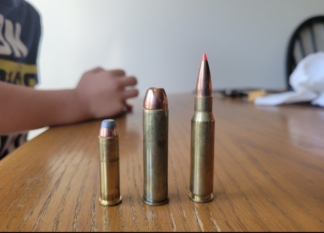

    Xframe in 460s&w. I've printed 4" groups on steel out to two hundred with the factory 200gr ftx load. Admittedly haven't done it to an animal yet though. Missed a pig at 110 yards. Thought he was farther. Sent it just over his back.
    And what was that about pistols and low charge weights? I can't remember for sure but iirc I loaded 45.0gr of H110 under a 240gr xtp lit by a Winchester large rifle primer.
    In the pic is a 357 magnum, the 460s&w and a 308.
    To the OP I say 45 raptor. Pretty much the same thing as the 460s&w and they really pick up some steam in a longer tube. Friend of mine built a single shot 460s&w on a 700 action for a friend of his in a state with weird cartridge rules and in an 18" barrel the factory 200gr ftx load went from 2100fps in the 8⅜" xframe to 2900 in the bolt gun!

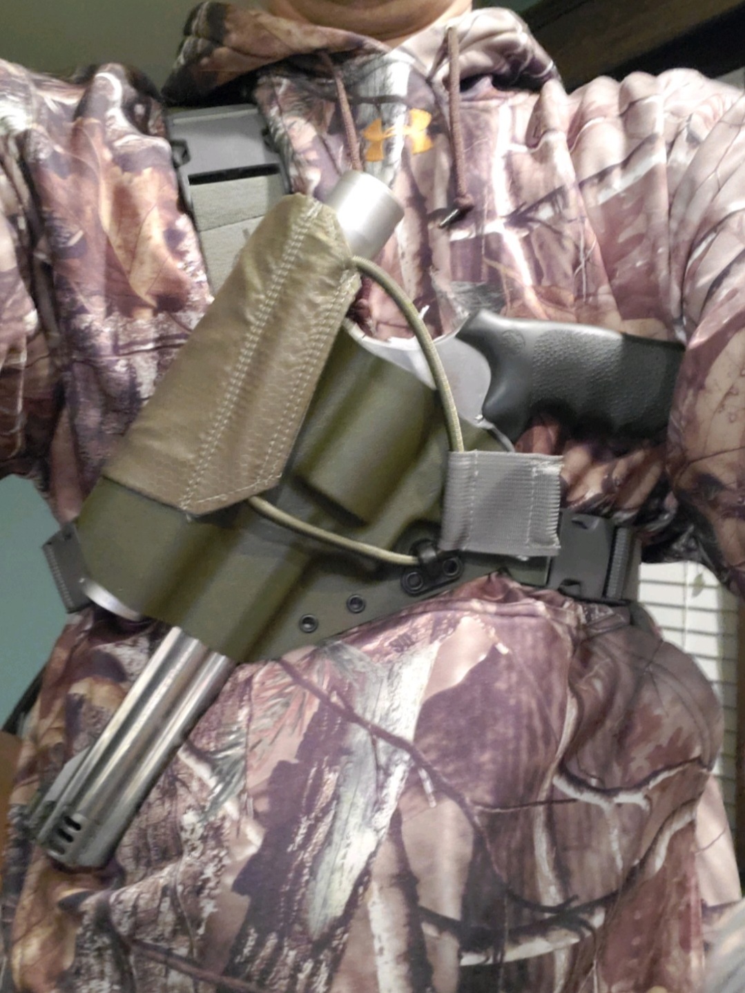

    You got an appendix carry rig for that hog leg? Cuz, it’s not exactly what I’d call a daily carry pistol. But, if you’re strapped with that every day, more power to you.

    Na no appendix rig for that one lol. I tried a shoulder holster originally but it still tried to drag the ground. Keeping the weight centered is the key. I did know a guy that carried a 50ae desert eagle for his daily at one time though.
