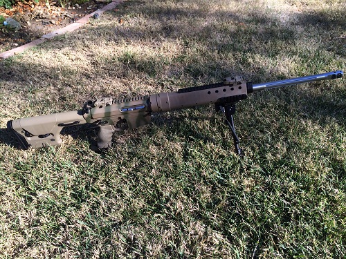

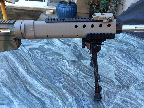

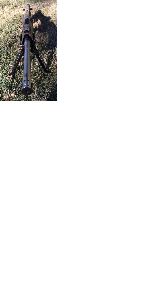

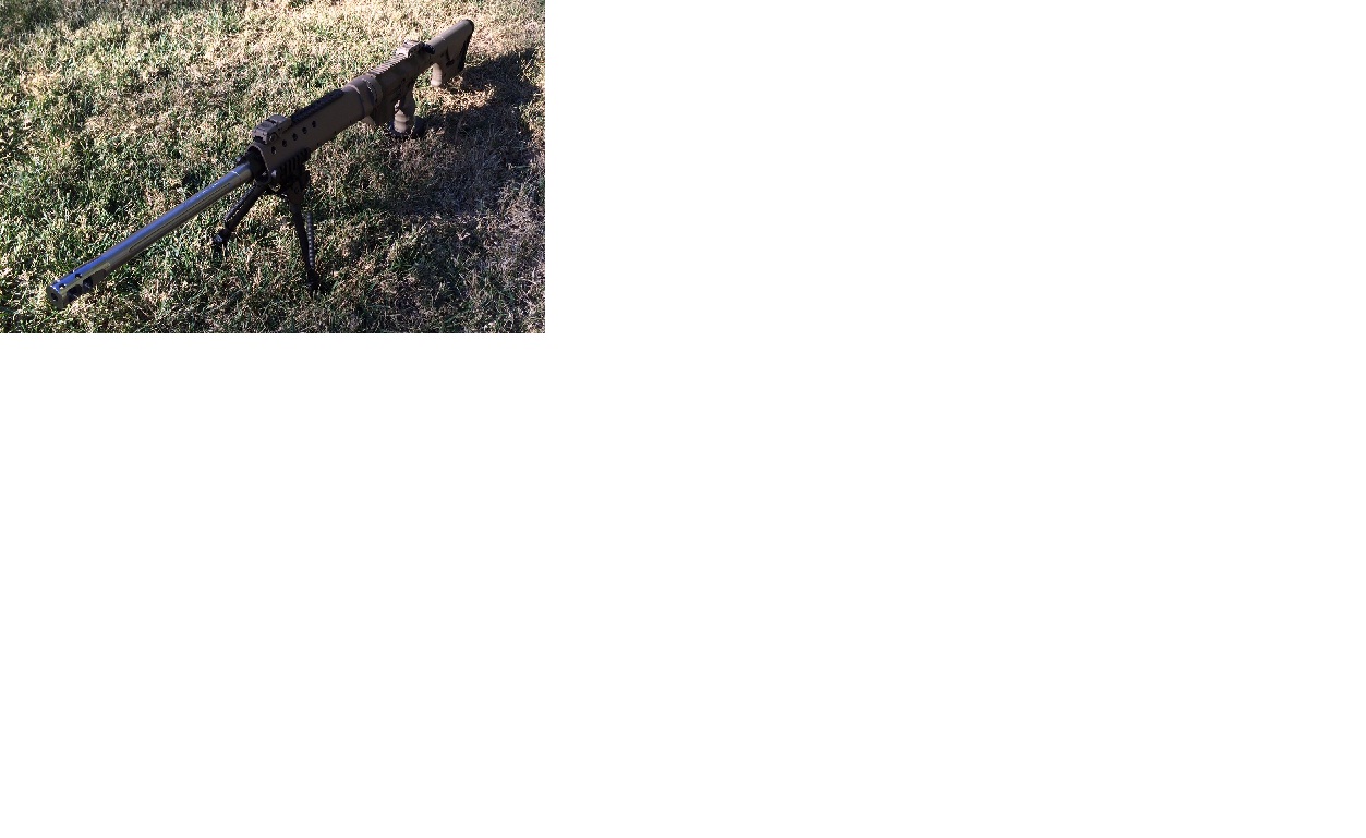

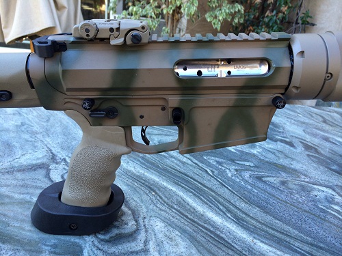

Here is my new .308 Tack Driver, still waiting on my glass to get in (Nightforce ATACR 5x25). Just started break in procedures recommended by Lilja. With LMOS and adjustable gas has less push than any of my other guns.
Quentin Defense QD8 upper
Lilja 24" Fluted 1/11, 3 groove
JP Comp Bennie Cooley Standard Profile
Rainier Arms Raptor
PRI Low Profile Adjustable
JP Low Mass Carrier
JP Enhanced Bolt
PRI Delta Forearm - Rifle Length
Harris Bipod 9-13 LM-S and LT 706 QD swival mount
Tactical Machine TM-10 7075-T6 Billet Aluminum
Timney 4lb single stage
MAGPUL PRS
JPSCS-10 Buffer and Spring
ERGO AR Large Frame with Palm Shelf

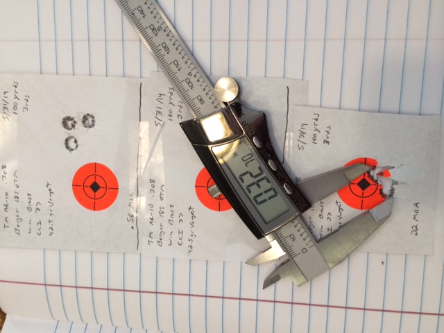

Well the build is complete and the scope is on and I have done load development for it. Today I shot pretty well, with .32MOA being my best.Shot groups.JPG
I'm shooting 185 Berger OTM with 42.5gr Varget.
