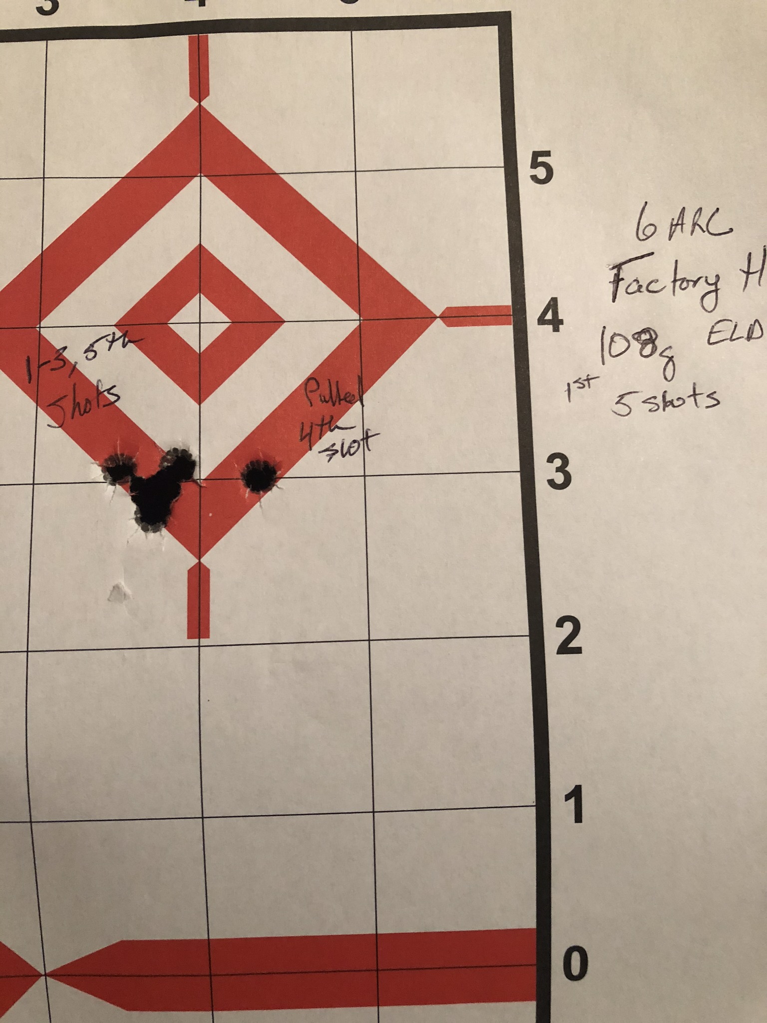

Found a way to leave work early yesterday and ran out to the range before dark to try the factory 108’s in my 22” Craddock Rock Creek barrel.
It shot the ELD’s very well. I need practice as I hammered the trigger and pulled shot #4 in the 5 shot group. But I love the 4 shot group!
It was about 50 deg. and they averaged 2690 on the Magneto. SD of 8.1. Min 2680 Max 2698. I have now run 60 rounds total through it.
Rushed over to the 1000 yard range and worked out to 600 confirming dope before it got dark.

Great news, I'm glad to hear it's off to a good start for you! I agree, I should have listened to forum advice and started there myself. I've run a half dozen powders now and ended up on LVR myself. I'll be working on loads soon, just waiting on a few new parts so the rifles are static before I put a bunch of time into it. I've got a bunch of once-fired brass that's annealed/FL resized/expander-mandrel ID neck sized/trimmed/chamfered/debured/neck-turned/primer pockets uniformed/flash holes reamed and ready to go. It got the full precision rifle treatment, so it better not let me down. I'm cheating and cranked my TT diamond down to 1.5lbs, so it's all on the rifle build/barrel/myself at this point.
If you already are printing 5-shot .47MOA groups on a fresh load with no workup, that's impressive! Go find your mid-point powder weight node, then tinker with seating depth, and finally do a final powder charge tune, and it sounds like you'll have a heck of a shooter. Hope I luck into a 1/2 MOA group to start!
Yeah, I'd say that is full match prep! I rotated some Hornady brass back into my available stash before going to the range today. It was brass last used in original barrel and the shoulders needed to be pushed back a couple of thousandths. The brass had already been annealed and sized so, I took the expander ball out of the die and just pushed the shoulders back. I trimmed before loading. I did notice that when seating the bullets there was that distinctive increase in pressure required as if pushing past a donut. I think I am going to neck turn as well. That was 6mm ARC brass from the factory with 4 firings on it--not converted Grendel brass.
Your rifles are perfect. Let go of your OCD and go shoot them! Your data is going to be valuable.
