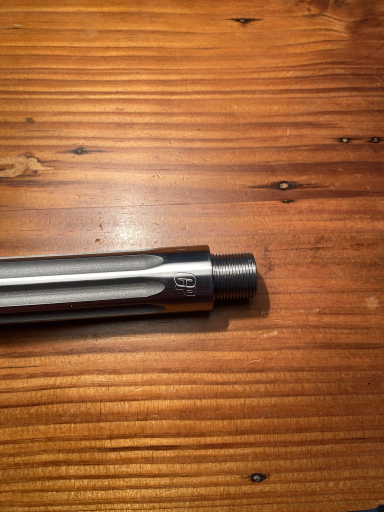

This thread has been very informative. I’ll say I love the rifle. Built mine with a Ballistic Advantage 18” rifle gas. Extremely accurate to 100 with Hornady match. Shot a doe at about 75 yards last night with the ELD-M and I’m pleased with performance. Now if the dies would get here I’m all set to start reloading it.

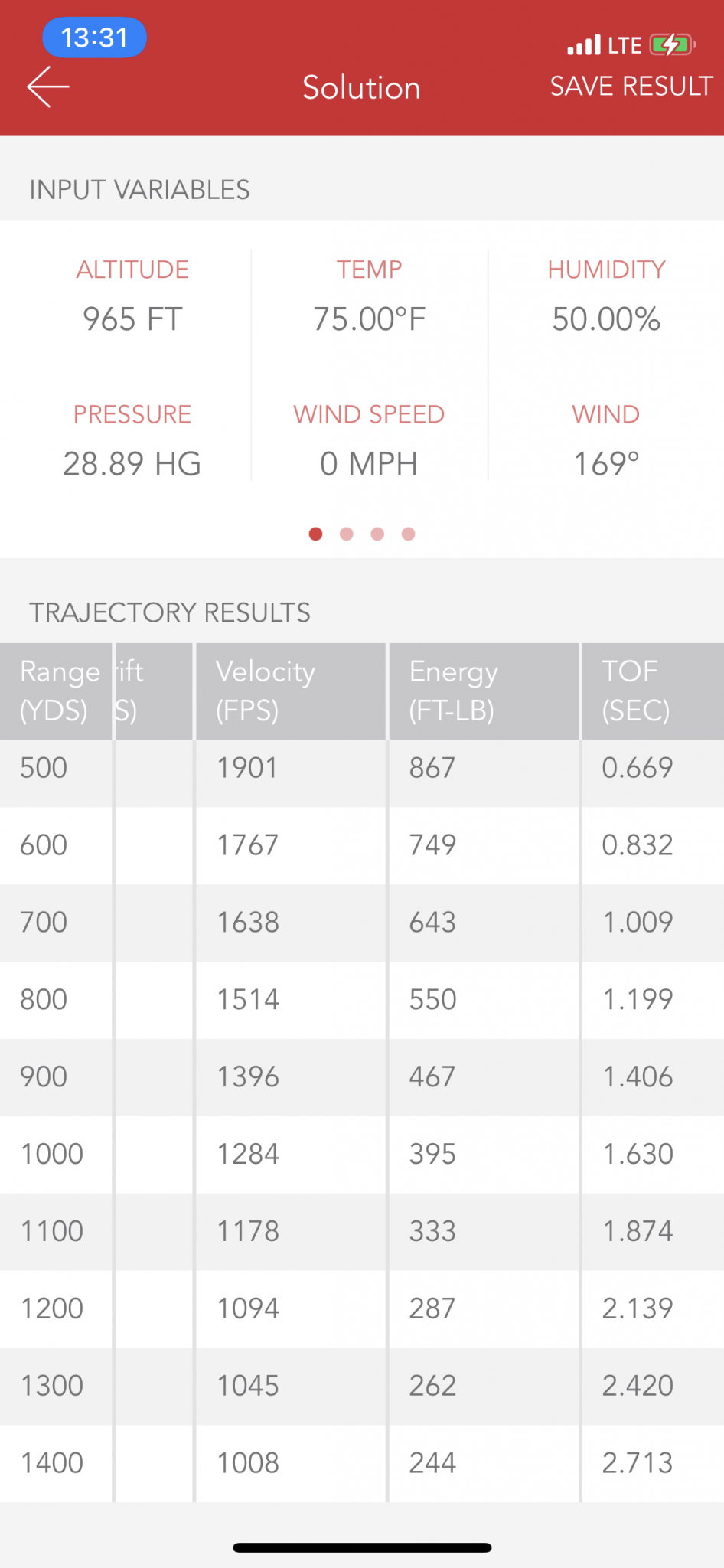

Assuming a 16” barrel and factory 108 ELD-M’s, I put a 2500fps MV into the Shooter App, but I just don’t believe the results I’m seeing. A 108 ELDM @2500fps with a 3500DA shows it is supersonic out to 1230yards? Have I messed up my inputs somewhere or is that a realistic expectation?

Use the Hornady 4DOF calculator, in 4DOF mode. I get 2643fps from a 18” Bartlein with 108 ELD-M with the factory ammunition. 1200fps is the “safe” spot, below that and depending on conditions you may encounter weirdness. Just do a table every 100yds with velocity and see what you want.
Reactions: George Mac
Sorry, on the road, so a mobile shot. This is with an 18” barrel. Are you not using 4DOF? I highly suggest it over shooter app, especially with Hornady bullets with radar derived drag models.

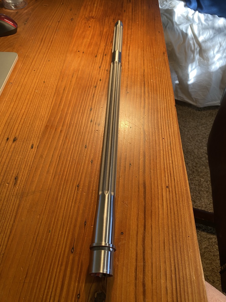

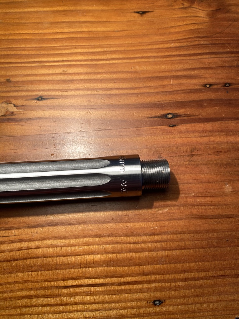

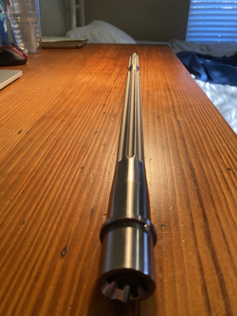

Awesome! I also purchased a 18" BA barrel! hopefully mine will also shoot well! What sort of MV are you getting with the 108ELDM? Also are you using an adjustable gas block? If so which one? Thanks!
Question wasn't directed at me, but the Aero Precision gas block looks nice and is also reasonably priced.

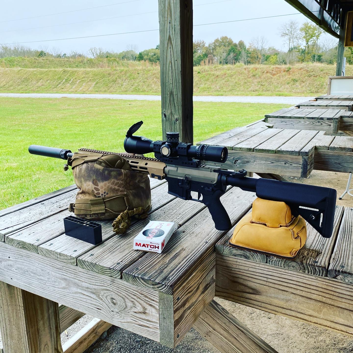

A work of art

Didn’t know GAP was doing a 6mm ARC AR-15. Way cool.
GAP knows how to build a super-accurate gas gun. There are things that they’ve known how to do dating way back that really fine-tune a gas gun’s accuracy and reliability.
I don’t recall any malfunctions with the .308 or .260 Rem gassers they’ve built for me, with one exception.
I had a weird incident where .260 Rem bounces brass off the ejection port door before it could open fast enough, and go back into the port.
Chris Kyle said he had the same issue with the SR-25 Mk.11 Mod 0. I think a stronger ejection port door would fix that on the large frame guns, but very few people see it because they are normally shooting with an open port door.
I sent them DPMS receivers, BCG, small parts, rifle RET, BCM CH, JP Handguard, basically everything but the barrel, and they hooked my builds up before there was a GAP-10.

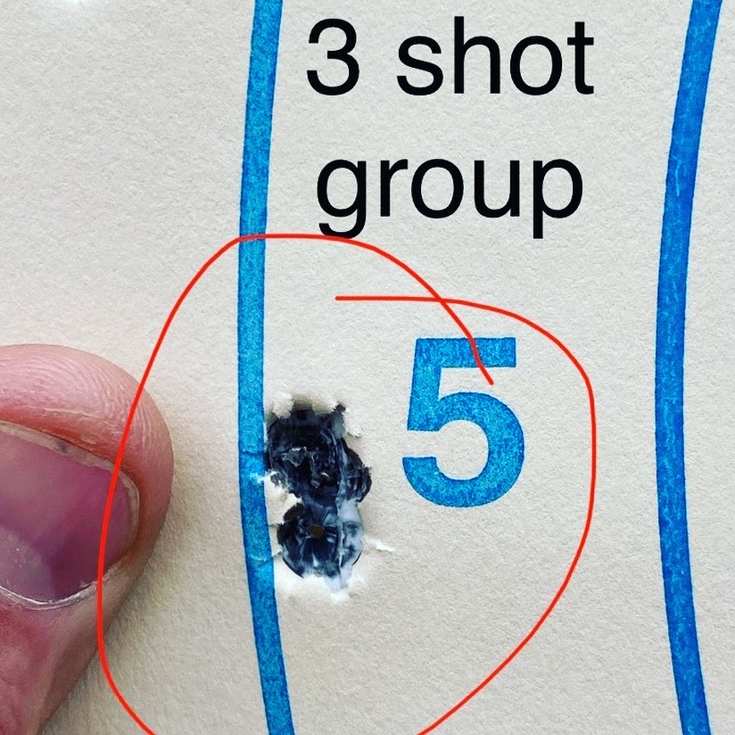

Just a three shot group, but it proved to hold close on a subsequent ladder test then ran out to 500 ringing 12 down to 4 inch plates with each. Proof carbon fiber 18inch barrel, vltor billet upper, adjustable gas block, geissele rail, surefire rc2 762 can, factory hornady ammo. Had planned to reload with cfe but looks like I’ll be getting some leverevolution now too.

According to Shooters Calculator these loads are super sonic past 1300yrds with a 16" barrel. It shows that even factory 108s are good past 1200yrds. Am I missing something?

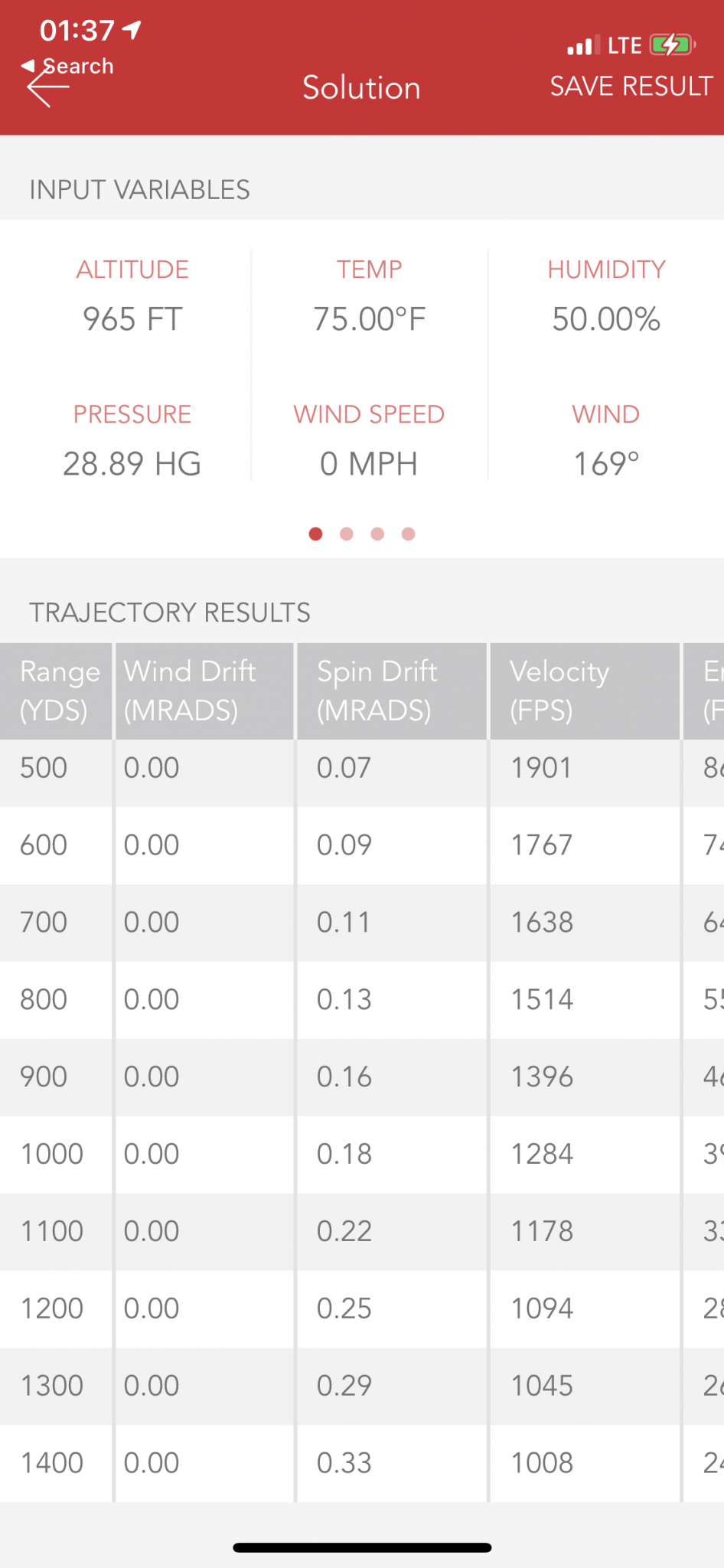

Yes, an accurate calculation. Here’s calculations on my 18” with my Labradar measured velocity with factory 108 ELD-M:
You can see somewhere between 1000 and 1100 yards it drops below 1200FPS which is where all the funky things start to happen to bullets as they cross the transonic boundary. Also, keep in mind this is just for the conditions I measured locally, you want some headroom for various environments.
Also, try 4DOF or Applied Ballistics, they really are the best ballistic calculators. I’ve always had spot on results from them when trued to my rifles and loads; not so much on the others. The above is using a drag curve determined via radar, not a simple BC which has been proven to not be consistent across multiple velocities. G1 is awful, and G7 isn’t the answer either.
