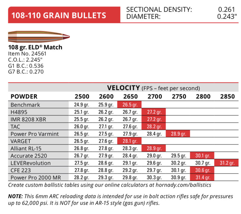

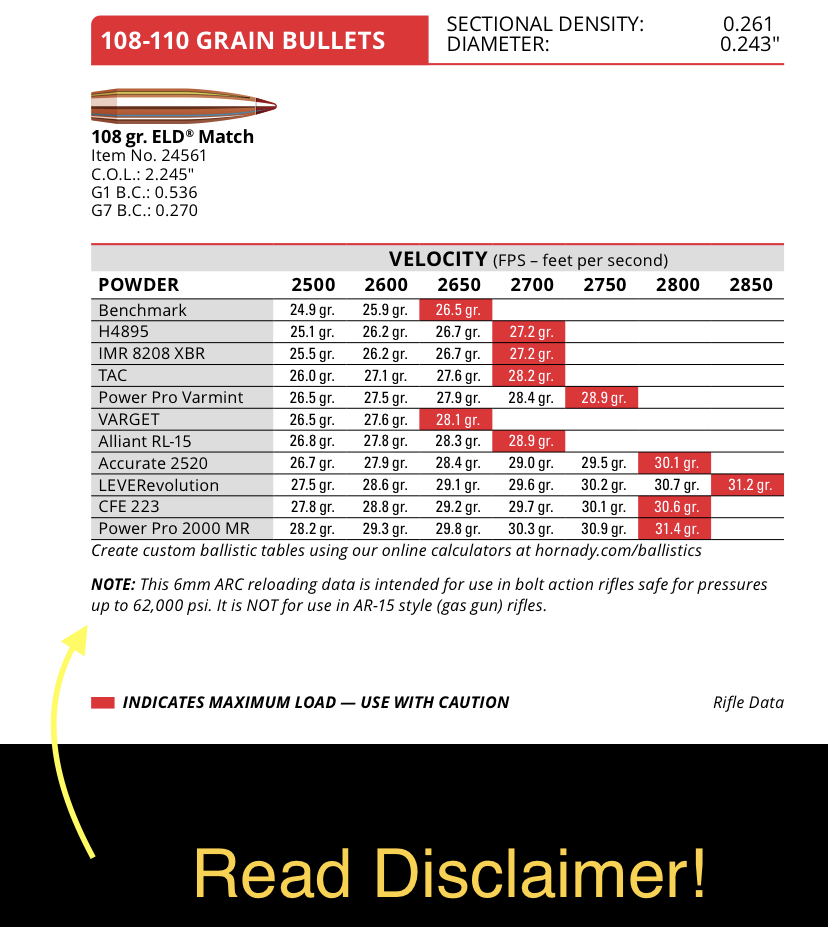

There was a subsequent load data sheet that Hornady published specific to the gas gun, attached. I am seeing 2730 FPS out of my 21.75" barrel using 29.4 grains of LEVERevolution behind the 108 ELD-M. This is not destroying brass and 3/10ths of a grain under the max book load. I have no need to push it, but 2800 might be possible with a slightly longer barrel and a few more tenths...

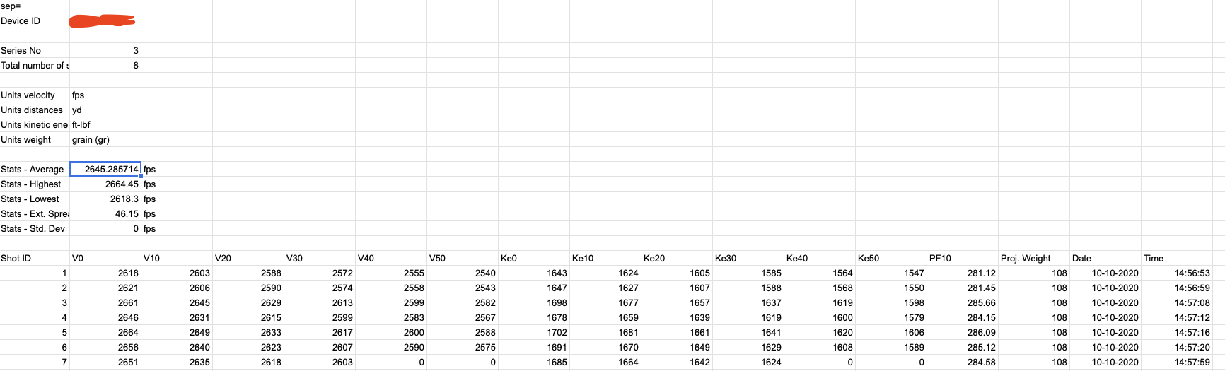

This is from an 18" barreled AR15, factory 108 ELD-M, measured by a LabRadar. It was the first few shots on a brand new barrel, so there's a good amount of variance, but you can see the MVs. Here's a direct CSV export of the data (calculations from the LR itself):
I'll grab velocity data on reloads later, but the load data has been fairly accurate for me. I am keeping things at gas-gun pressures, however. I'm sure performance would be even better at 62kpsi. Again, this is an 18" barrel, in an AR15.

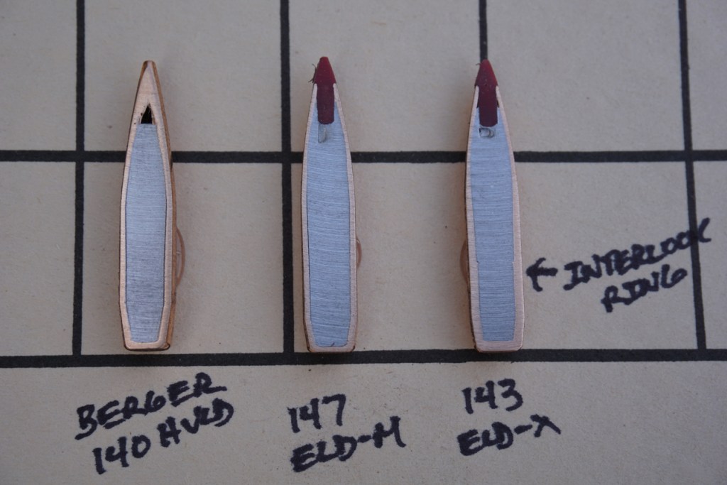

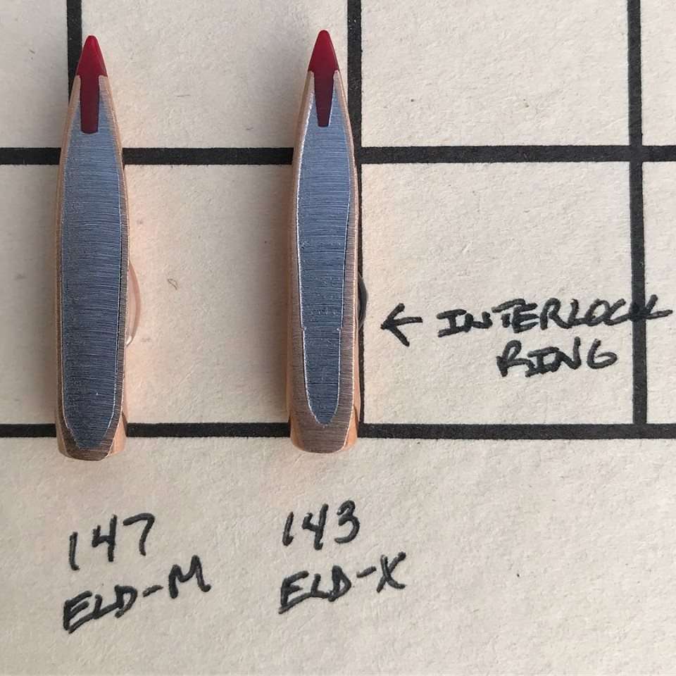

Here's a bisection of 143/147 ELD-X and ELD-M from another forum which shows why there's a difference in performance:
Another:
Clear bisection of the ELD-X:
If you're looking for an exit for a better blood trail, there's likely a better chance you'll get it with the ELD-X.
Thanks for the insight on the ELD-M v ELD-X. It. looks like the main difference is the interlock on the -X and tapered jacket to retain weight and boost penetration. Right???

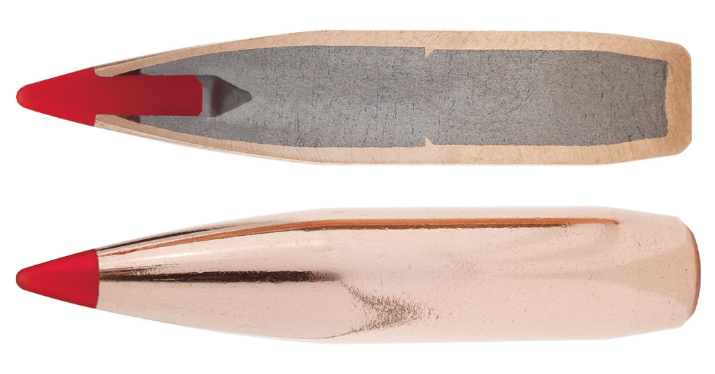

As far as terminal performance it's almost identical to the 103 ELD-X. From what I gathered the TAP round won't be available commercially (outside of LE/Mil) any time soon, if ever.
For those looking to consistently shoot medium/big game, the 103 ELD-X is a great option. The 108 will do it if you don't hit serious bone. Kind of the same story as 140/147 vs. 143. The ELD-X is better at holding together and penetrating. The ELD-M's are heavy varmint bullets. Slip them into the vitals and it's devastating. Hit any serious bone and it's a mess.

The tapered jacket is the significant difference with the ELDX. From my own testing of the ELDX and Interlock bullets in a few different calibers, I’m not convinced the interlock ring actually does much, if anything, but the tapered jacket goes a long way to limiting expansion. It’s possible the lead core may be a harder alloy too, some manufacturers do that but I’m not sure about the ELDX in particular. That can also have a big effect.

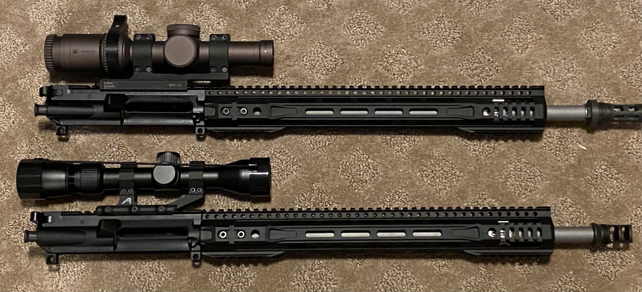

Got my upper and my fathers upper built, BCGs showed up so headed to the range tomorrow.
I love my Razor 1-6, but may end up selling it and picking up a NX8 2.5-20 for it to do some more precision work and possibly shoot some local PRS style matches. For now it should be a heck of a coyote setup View attachment 7523439
What handguard are you using on those? I have an Odin Works 18" on the way, but I still need to pick up a handguard and find a Grendel bolt in stock.

Parallax Tactical 15.5” FFSSR. Got them at B Kings Firearms. I’ve used them on a lot of build and really like them, especially at their price point. I’m not sure you can buy them anywhere else anymore.

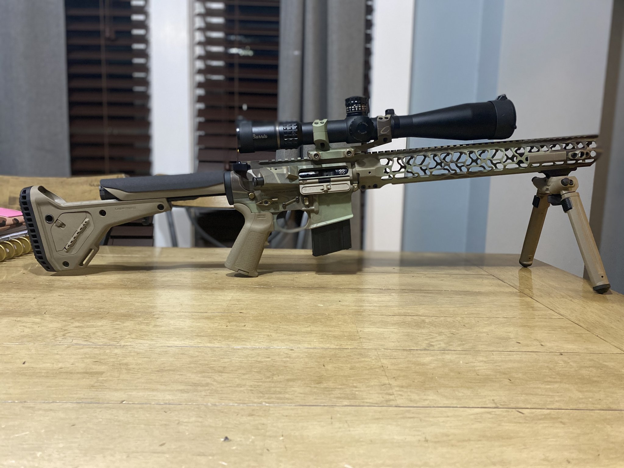

Here is my ARC build will have the barrel in a few days. Any suggestions on a muzzle brake that is thread for a suppressor? Was thinking about the lantec dragon asr.
