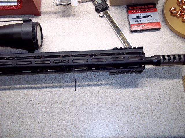

On that barrel, looking at the shoulder and crown, it looks like the machinist didn’t properly center the barrel before cutting. I’d be asking for a new barrel if I were you, I’d be worried about the threading being concentric to the bore.

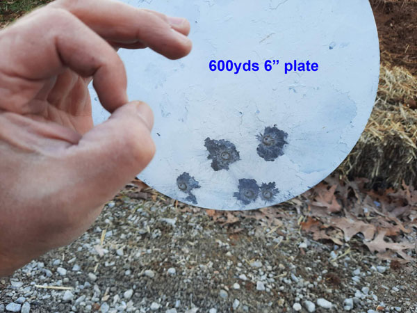

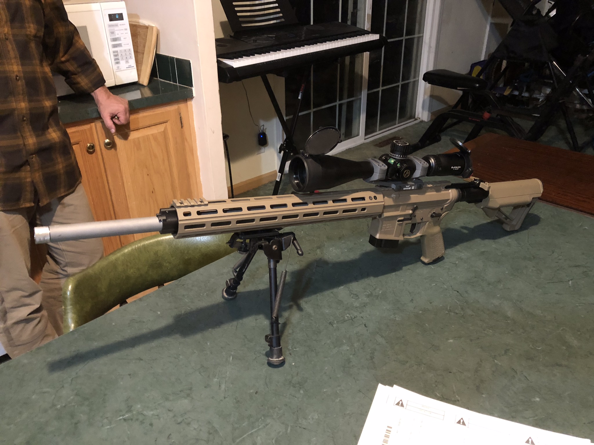

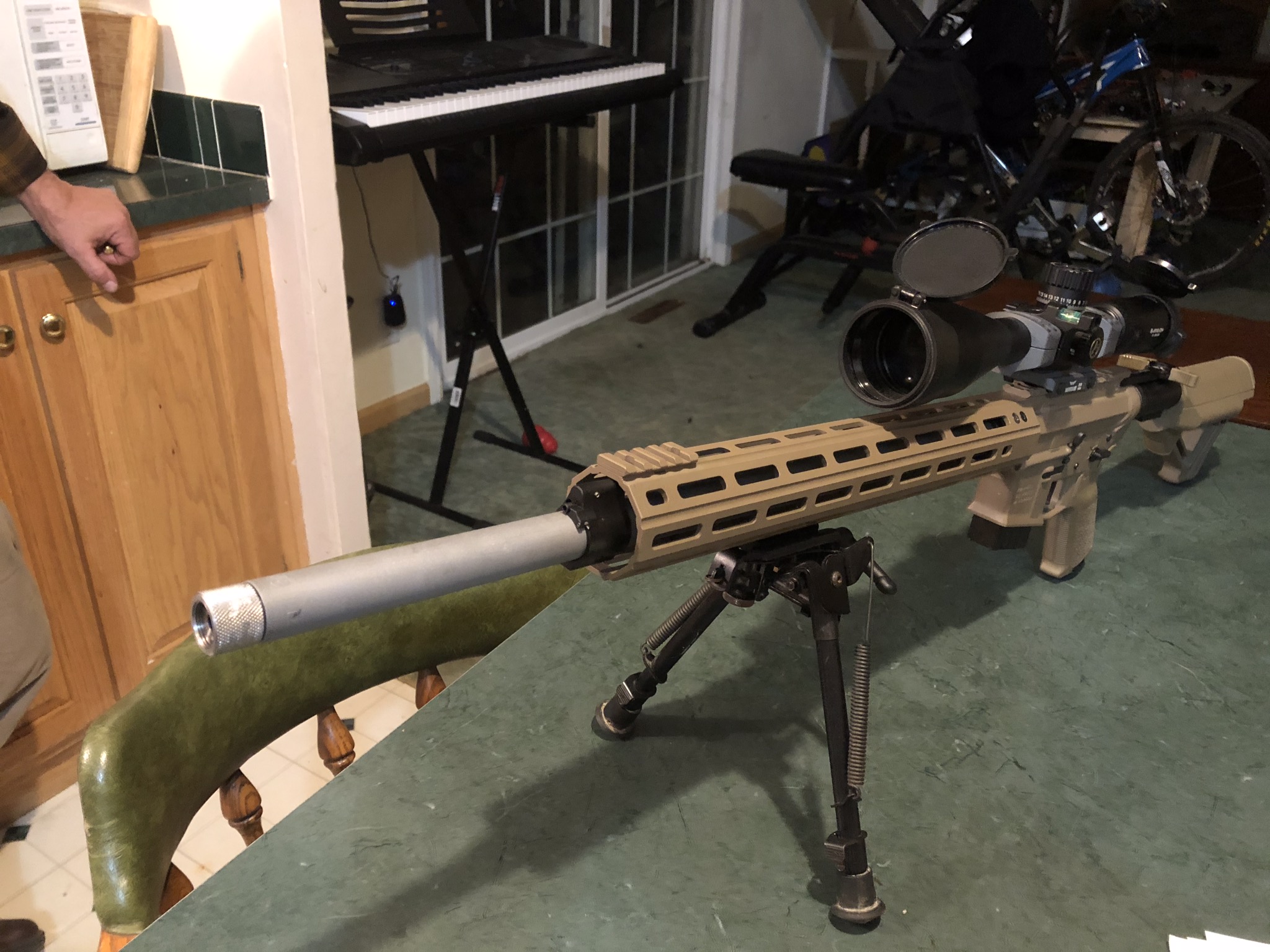

Due to basically every barrel maker being out of stock or having incredible lead times, I went with a BA 18" from Brownells. Geissele gas block that came with the Mk4 rail I put on it. Rifle Gas, with an H2 Buffer. ASC Grendel Mags.
Shot it for the first time this weekend. Ejecting right at 330/4 oclock. Barrel didn't shoot so well to start, but settled in after a couple strings. 1 malfunction with the mags (I have 4 and used all of them), so pretty good overall.
I'm going to have to go back again to really get a feel for the accuracy, one of the rings on my Larue mount cracked and I'm thinking some of the spread on my later groups was related to that.
Did manage to get two good 5 round groups, each under an inch at 100, so I'll take it for an inexpensive barrel and factory ammo.
I was shooting the Hornady Match 108gr.
Pretty neat little round.
I put new rings one when I got home, and I'll report back once I can get back out to the range.

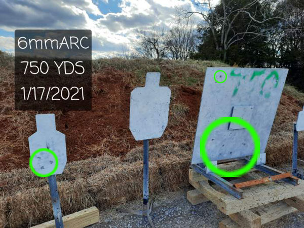

Some results...I was using the 4x and BDC to get to 1k. I was able to get a couple other hits on the sighing plate, but spotting became an issue so I stuck with 600/750. At 12x I'm holding the last circle, and at 750 I'm holding the point of the bottom post about 6" above the top of the target.
Notice my sighing shot on the big plate, then when I spotted hits on the bottom of it I just skipped the normal sized silhouette and went directly to the smaller one and got 3/4 hits. The swingers at 600 were also pretty fun, I feel sure I could go 1 swinger smaller.

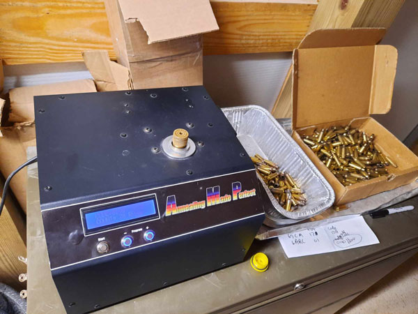

I got to try some annealing with the AMP which was cool.

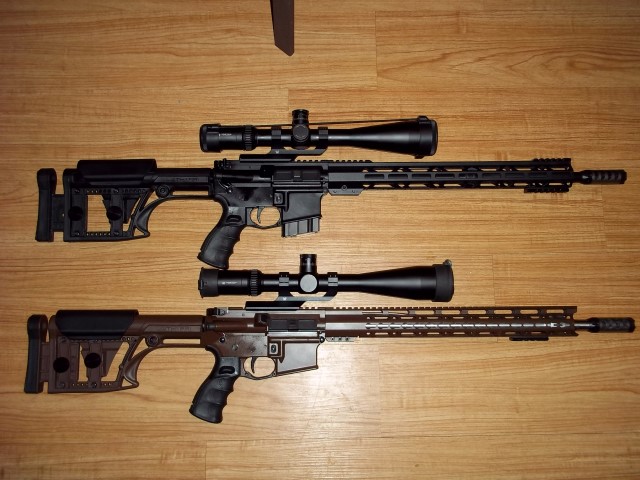

My other two barrels are Faxon 18" and 20", these two are standard rifle length gas port and neither of them had any issues. I will add that the Odin barreled rifle is by far the softest shooting by a huge margin. They all have the same muzzle device, the Odin Atlas. And the Odin barreled gun stays much cleaner shooting the same amount of ammo through it. The Leverevolution powder is not the cleanest burning powder, but it is my go to after using many other powders. A friend of mine has a BA barrel and of all the 6ARC's I shot the Odin barrel is the most accurate, prints consistent .3 MOA @ 100 yards with my hand loads.
I can't speak as to if carbine has a problem, I have three 6Arc rifles and they all have rifle length Buffer systems.

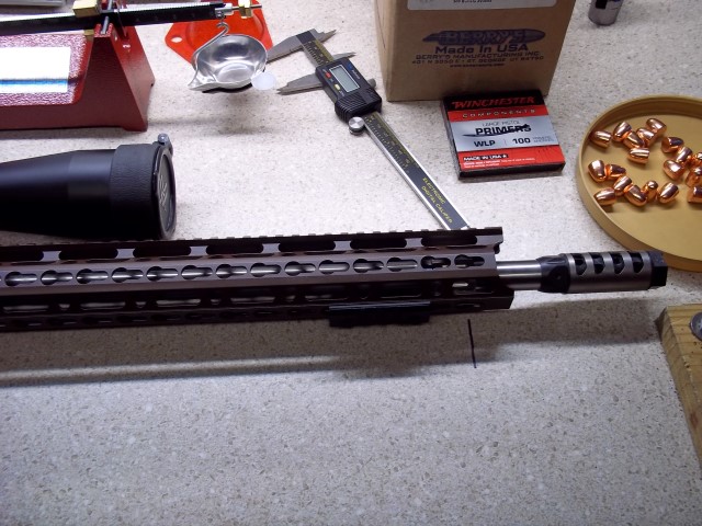

Luckily I was able to find some Hornady Match and Black 6 ARC ammo for my new project so I measured several from each box with my micrometer. The loaded necks varied from 0.2695 to 0.2705. I guess the Hornady brass isn't very uniform. Glad I was able to get some new Lapua 6.5 Grendel brass to form ARC brass.

What handguard length are y'all using with the +2 gas system? Will a 15"-15.5" cover at least the tube and part of the block or is longer necessary? I'd love to see pics of the handguard setups people are running with these +2 barrels.
15" will cover about half of the gas block on a +2. There's no rule that says the block must be covered, it's mostly aesthetic preference unless you really plan on using that end of your rifle to drive fence posts.

Here are pictures of my two 18" barrel rifles, both of them have a 16.5" handguards. The line on the workbench is the front edge of the gas block. The Faxon barrel rifle is a standard rifle gas and the Odin is plus +2".
Reactions: Gtscotty
