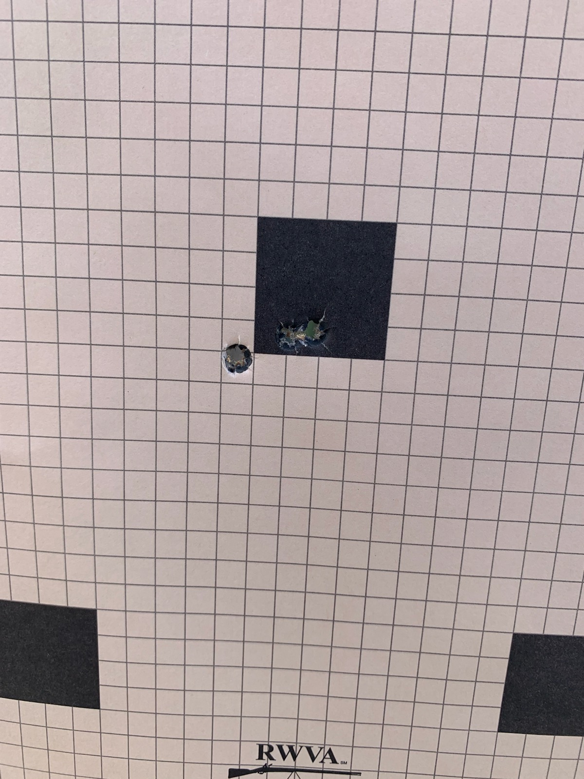

first couple of shots out of my 6ARC. when the barrel gets broken in it ought to do a little better

posted a pic of the first three rounds of my 18 in proof barrel a few post back

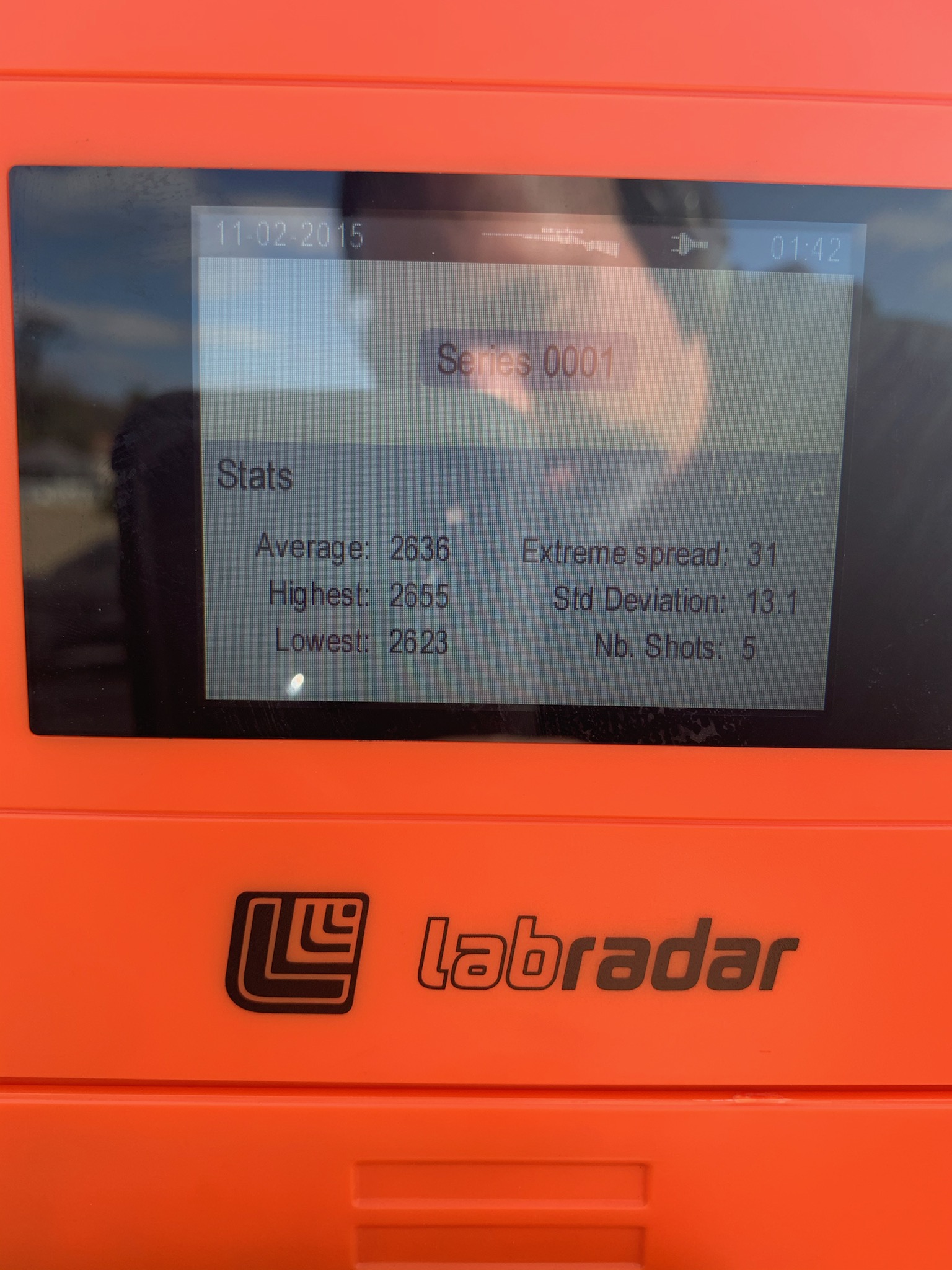

Check my older posts in this thread, I have posted Labradar data from my 10.5” 6ARC a few times with factory 108.
