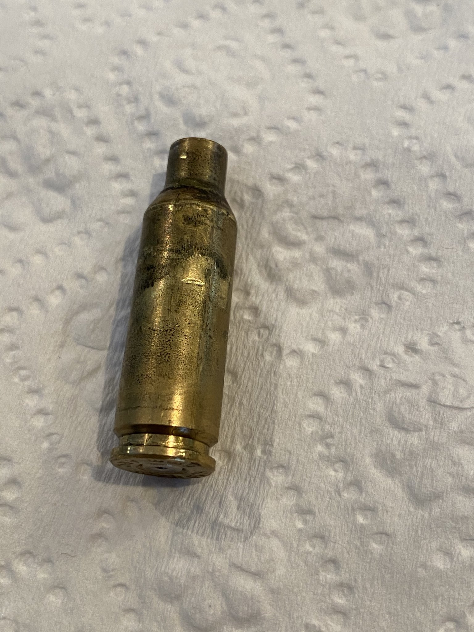

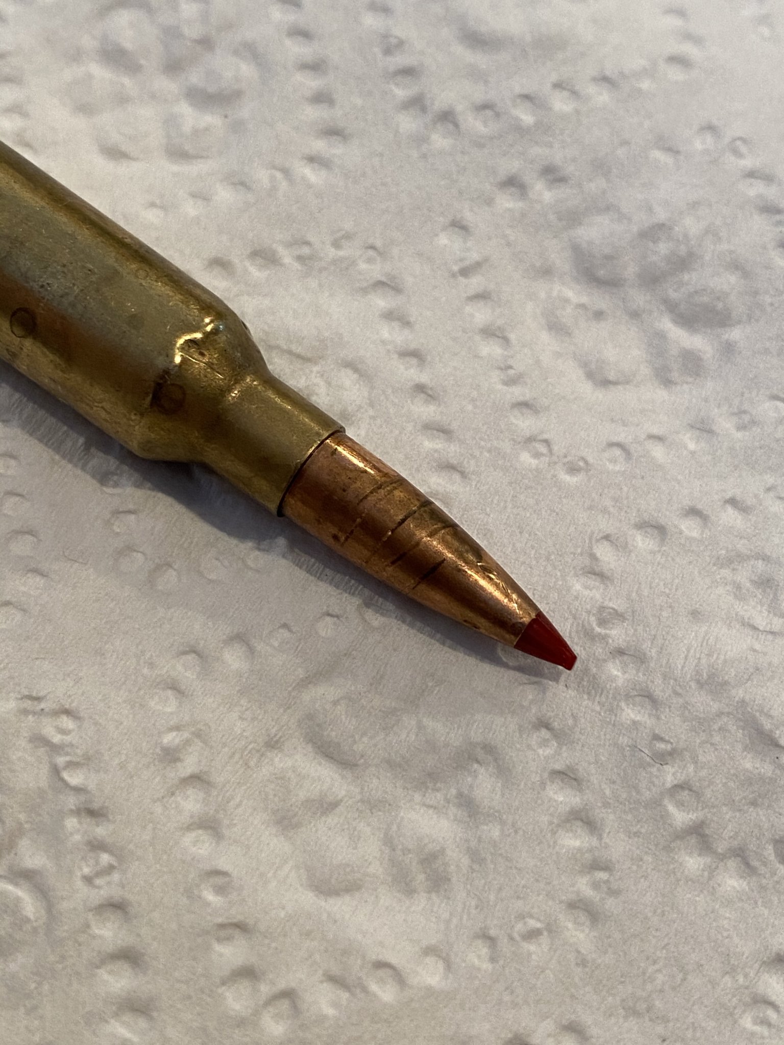

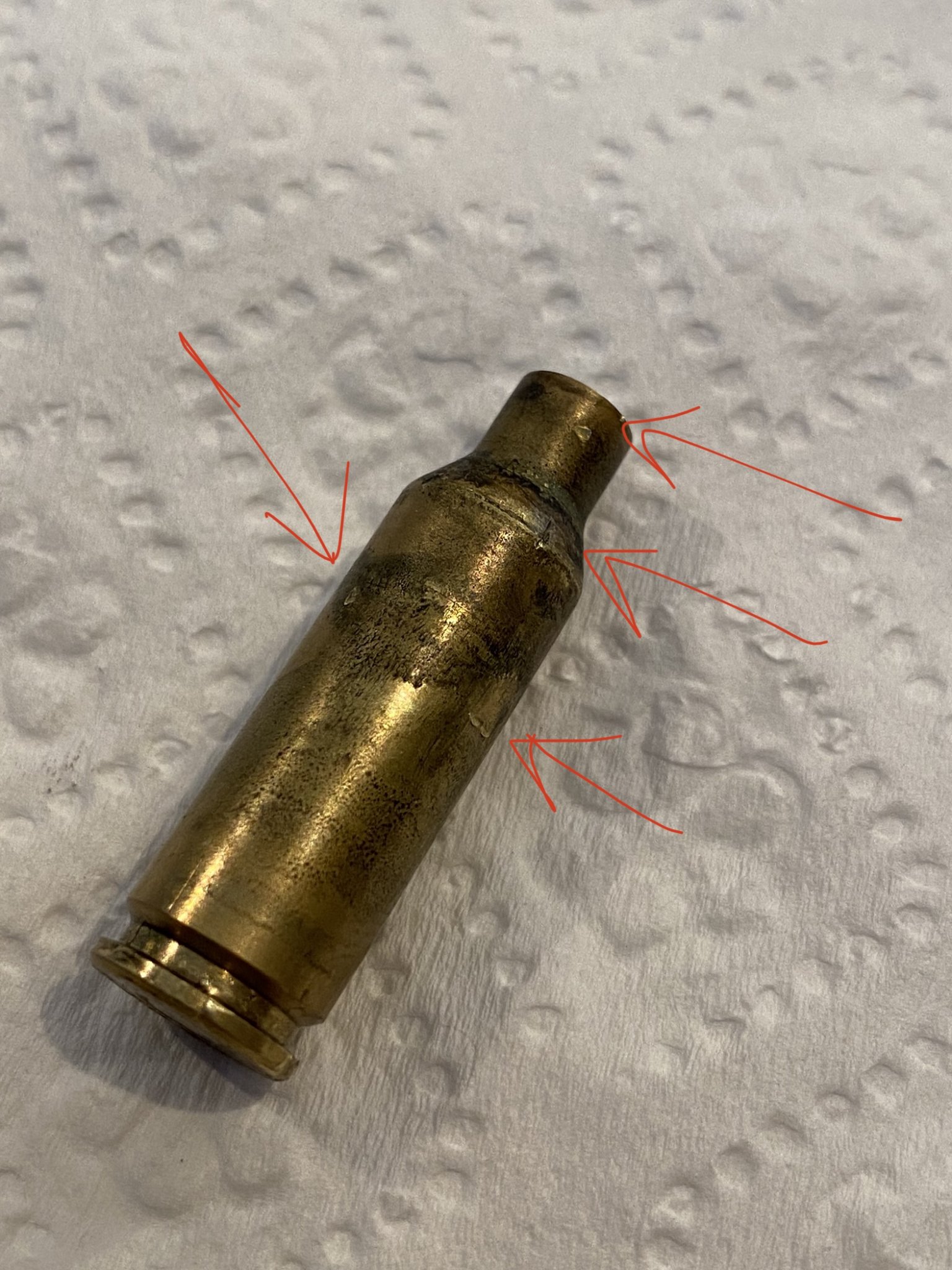

Yeah, running and AB and have it set for 3:30 ejection. Brass is getting damaged when cycling the CH manually as well as after firing, leading me to believe it is chamber and/or barrel extension related. I'll post pics after my lunch.
Still no pics but that mostly sounds like just some sharp edges on the barrel extension lugs, which is pretty common and really easy to fix. You can see the edges that need to be smoothed if you extract the round slowly; just rub those edges with some emery cloth or strip of sandpaper to break the sharp edge, and make sure to clean up the grit afterwards. It’d take you longer to box it up to ship back than to just fix it.
Also FYI the 3:30 ejection pattern isn’t necessarily ideal for non-223 cases; ejection pattern changes with different case shapes so it’s better to tune based on last round bolt lock than ejection direction.

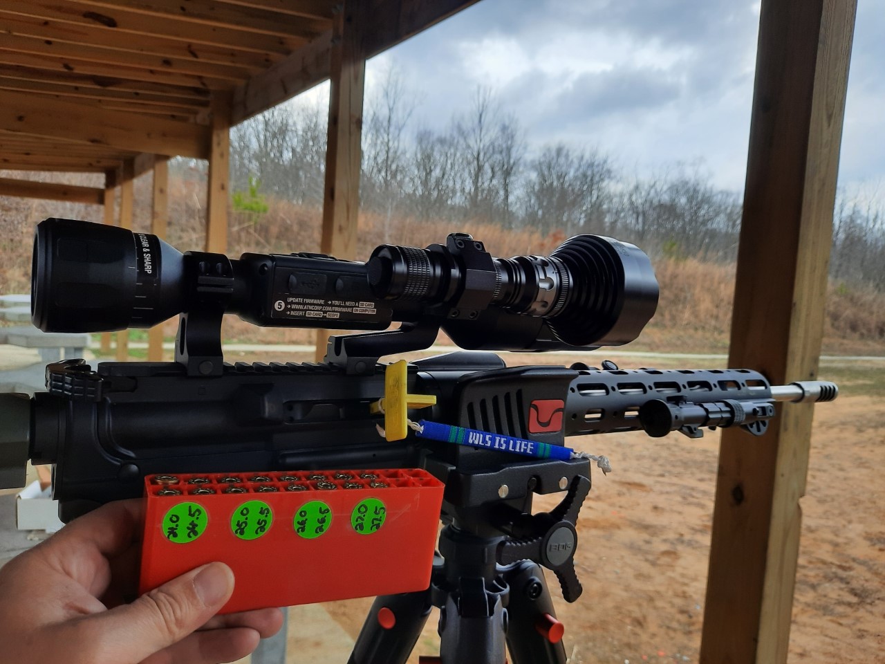

Got an ATN 4k 5-20 test mounted on top of the 6ARC. The night vision stuff is pretty cool, my first time using it. There is a BC in it I'm wondering how accurate it is. I'm going to use the One Shot Zero and boresighting to zero before I get to the range.

As for the illuminator, I am working on a mount to put it on the underside of the rail.

You’re getting case head marks because your Varget loads are way higher pressure than the same results with Lever.
It seems that several of you are missing the importance of restricting the gas if you’re using Lever, especially if you’re shooting suppressed. Lever produces a lot more gas and the rifle needs to be tuned accordingly, otherwise it’ll be overgassed with all the issues that causes.
I have an adjustable gas block on it. I set it so it was throwing brass at 3:30. It was doing it with lever and CFE too. Are you saying I am still over gassed??? My load is 29.5 of Varget with an 87gr. Hornady says that is a safe load for pressure. Will cranking down the pressure on my can take away the brass hammering??? Thanks for the reply!!!
Forget the ejection direction, it’s not a 223. Adjust it based on last round bolt hold open, plus a little more (1/8-1/4 turn) for reliability. If you add a suppressor it’s definitely going to be over gassed unless it’s tuned with the suppressor on it.
Also, if the rifle will cycle with Varget, it’ll be over gassed with a full charge of Lever, so no surprise there if it seems dirty. And you’re shooting suppressed which will always be dirty anyway.
But my main point was that if you’re pushing Varget up near Lever velocities, then you’re pushing the pressure pretty high. There’s no getting around that; Lever is significantly faster than Varget at similar pressure.

Look at your ejector pin, does it have a tapper cut or rounded on the edge were it contacts the case head. I had the same problem and the ejector had a sharp edge on it. Basically it was a straight cut with a sharp edge and it was cutting into the case head. After I rounded it off it stopped doing it.
I chucked the pin in a drill and used a small file to re-profile it and then polished it with 1000 and 1500 grit sandpaper. No more swipe marks and no more brass chips in the bolt. I had this problem with all three of my 6 ARC's and they all had the sharp edge on the pin.
Light swipe marks is considered normal in some guns, that is if you run your finger nail over it and it does not catch a burr.
