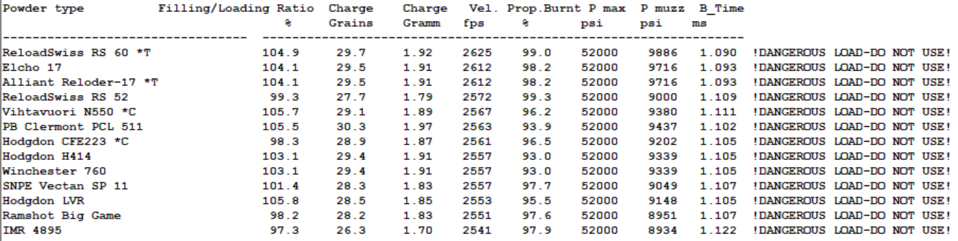

Here's the 103gr ELDx @2.26" out of a 20" tube. 103% is not what I would call "compressing the living crap out of it" just a little crunch.

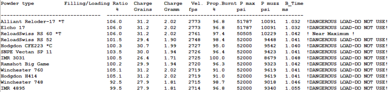

108gr ELD @ 2.26" - Crunchier

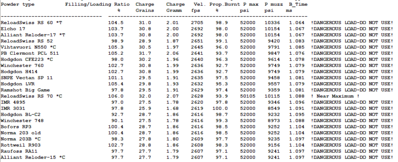

95gr BT @ 2.26" - Crunchiest
QL estimates that some of my crunchier .308 Varget loads have had fill ratios quite a bit higher, if their density numbers for RL17 are accurate all of these should be do-able. I have some left over RL17 from a ways back, I'll certainly be giving it a try once all my parts get here, I was just curious if anyone had taken a crack at it to date.

what is the brass life of this 6mmARC compared to 224V from an AR?
So far I’ve got 5 loads out of a piece of hornady brass. no cracking or signs of failure yet. Loading leveRution powder under 105 Berger’s and I’ve loaded some 108 eld’s. Dirty dirty powder But best velocities. Still tuning but I’ve run up as high as 25.6gr I think. Data is in the shop. I can reply later with approximate data
Looks like you're running really light loads, Hornady's max for 108gr/110gr with LVR is 29.7gr, and Hodgdon's max is 28.2gr. Light loads might be why it is so dirty. I've been looking for LVR for a month or so, but it's long gone around here.
Reactions: PoorFarmer
I am wrong. I shouldn’t have included the data. Im not in front of my info. i tried to recall it but I do know I went beyond hornady‘s max. Also this is from a 24“ bolt gun. Not gas. Uintah Precision complete upper

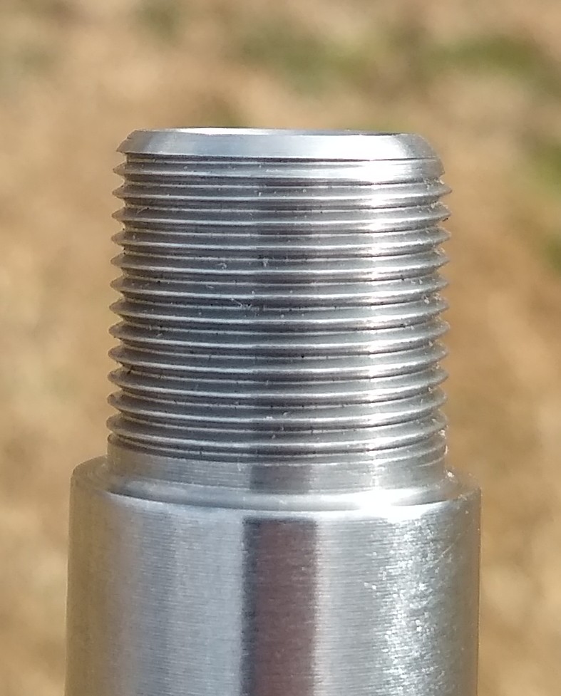

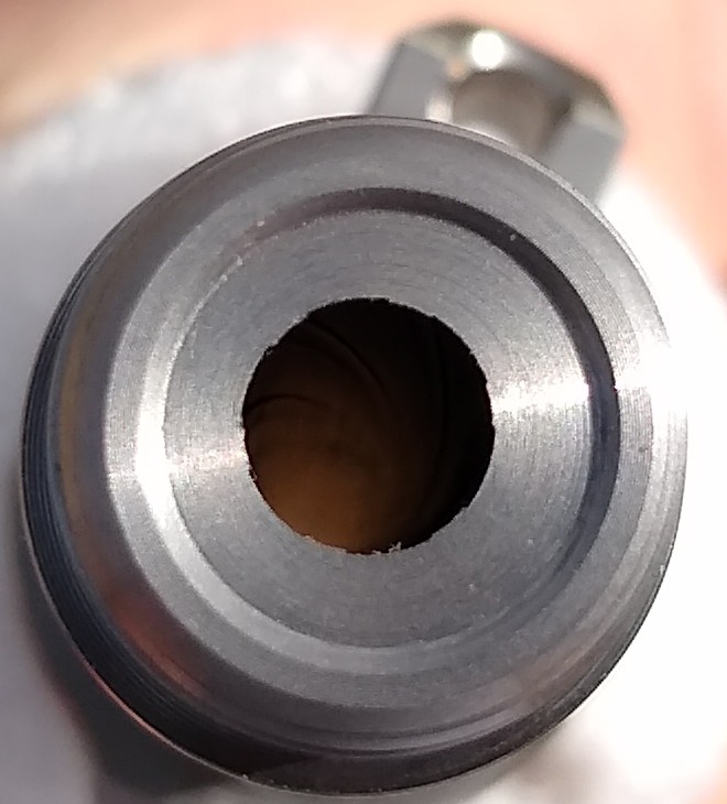

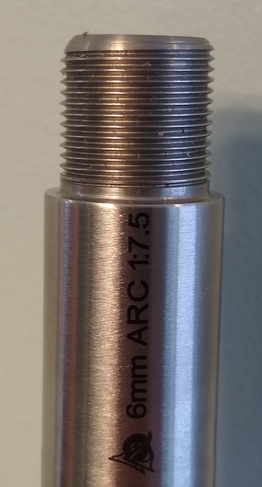

My Odin Works barrel and Aero BCG came in, but the muzzle end of the barrel looks a bit gonzo... There is some kind of unevenely ground area at the muzzle, the bore is noticeably off-center in the crown, and there's no undercut between the threads and the shoulder.
Has anyone elses Odin barrel looked like this? I want to mount up and go shoot, but I think I probably ought to call them up and get it fixed first.... Don't need an extra hole in any of my cans.
Speaking as a machinist who turns his own barrels:
The lack of undercut at the shoulder is normal, that centers a crush washer if you use one. Some barrels have that and some don’t; it just depends on the method used to thread it.
Looks like they cut the crown off-center and also forgot to deburr or chamfer it. Not impressive at all, but maybe it was just a bad one that slipped through in a time when companies are rushing to get stuff out the door. I’d ask them to make it right, if it were mine.
