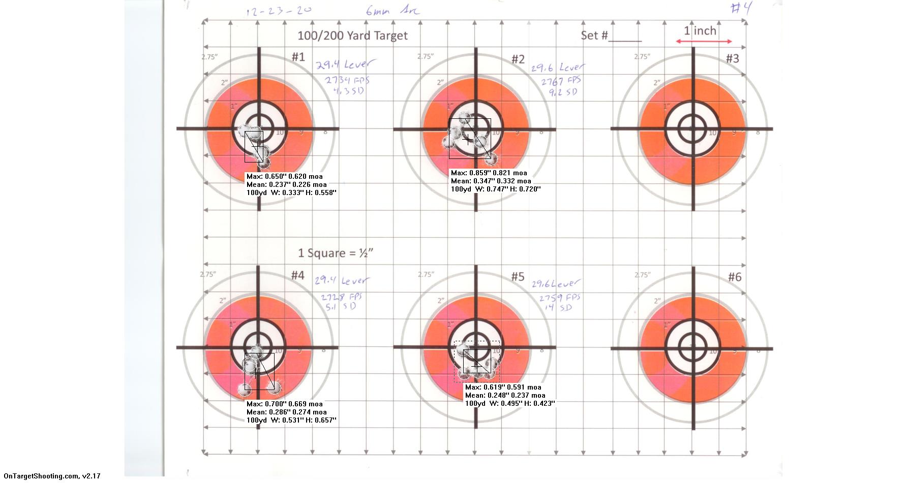

First ladder with LeverEvolution under 108 ELDMs in once fired Hornady brass. 18” Odin barrel. 3 shots each.
Im hoping the 3rd charge of 27.8 wasn’t a fluke with 1 hole. Only 2425fps but I only shoot to 600 here in south LA so I don’t need the speed.SD was only 13 so not great but worth a revisit. #2- 27.6 was .5moa. and same SD. #4-28gr opened to 1” and SD grew with it.
number 11 was not a great group at 7/8”. With 29.4gr. but the ES/SD was 0. 3 shots all 2575. So I’ll revisit that and play with seating depth to see if it will group.
Rifle ran flawlessly with the 108s. I’ll load up 5 of each and run the contenders again in a few days.
Oh and those are 1.5” pasters.
Failure to strip/lock back with 87Vmax at 2600. Only ran 1 group before I had to pick up.
When I got home a reduced power spring was waiting so I’ll throw that in and try the rest of the 87s next trip.

Also - if you’re shooting a ladder test and looking foremost at accuracy instead of vertical position, you’re doing it wrong. The point of a ladder is to find a wide node that puts shots in the same vertical position across a range of powder charges or seating depths. Then tune for accuracy once you find that.
I’m obviously looking for that wide node and the 27.4 seems to be right there albeit slow. The loads .2g above and below landed in the exact same spot. If it’s printing small groups from the outset and also in a node then so much the better. I’ll redo the faster charge of 29.4 loaded up and down .1g and see what it looks like since the first 3 with that had identical speeds of 2575.
You mentioned finding a node that gets good vertical dispersion across a wider range of powder variation and seating depth. I’m going under the assumption that short of a barrel tuner, seating depth is the only way to tune that load once found. So if that 29.4 load turns out to be a good node I’ll run a seating depth test with it. The first load I ran was 10thou off the lands and group wasn’t great. The Factory 108s are loaded 20thou off and seem to do well printing .5-.6 with 5 shot groups and giving me the same speed of 2575.
And while we are in the subject, you mentioned picking other powders than Lever for slower loads. I’m starting from zero with 6ARC and my precision reloading is limited to 6Creed and .223. In other words I’m a babe in the woods when it comes to precision rifle loading and while I’ve done well with it so far, I’ve been relying on those who came before me for my initial data. My knowledge of applicable powders/burn rates etc, for a given caliber, is limited. I’m all ears for another suggestion. Unfortunately the only listed powder I have in the shop is Tac. I have a ton of H335 but that doesn’t cut it for 108s. I have a rudimentary foundation and understanding of the subject but my practical experience is limited. Until last year I’d only loaded for pistol.
Lever performs best at max (best consistency, accuracy, and velocity of course), and that's about the only place it makes sense to use it since you're giving up a fair amount of temp stability compared to some other powders. Here's a shortcut for ya - figure out your max load of Lever, load to that or a few tenths below, and run your seating depth test. I'd run the test over a full .100" spread if you can, sometimes the shorter seating depths are surprising in an AR.
H4895 and Varget give you temp stability if you're happy with lower velocity in your 6mm ARC.
You can fine tune for accuracy by adjusting seating depth or powder charges in smaller increments. I prefer to find a load that shoots accurately across a wide range of powder charges near max, so that leaves finding the optimum seating depth. With Lever it's usually not much of a challenge to zero in on a good load.
Also- I thought you were shooting multiple shots of each charge weight. If it was only one of each, don't put much stock in that. It's worse than just testing with 3 shot groups. I've seen several times where that method puts a few rounds close together like your 27.4gr load above, but going back with multiple rounds of each shows no such node, it was just random dispersion. You really need the average location of multiple samples for that method to be useful, not just a single sample of each.
