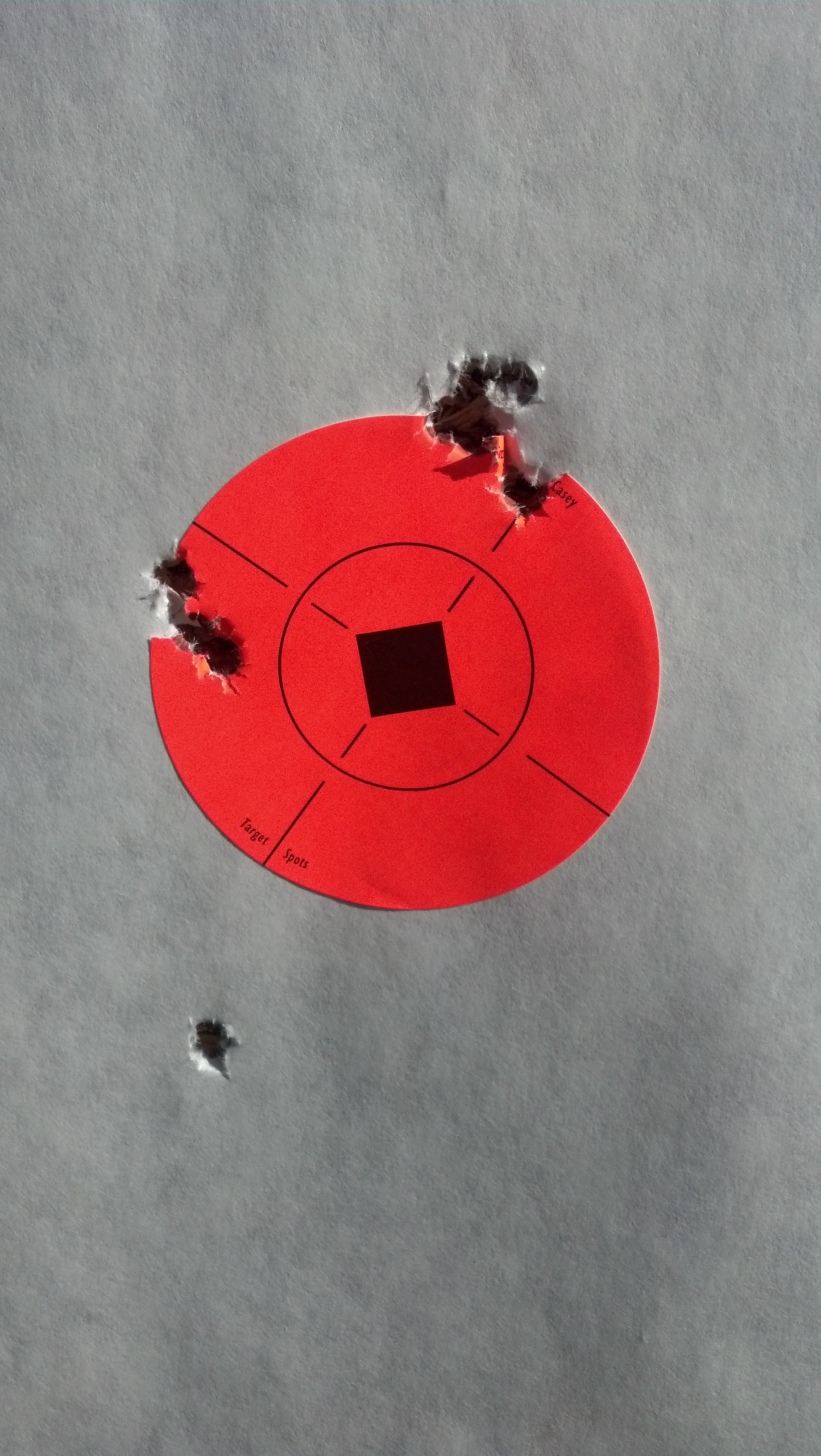

Got my 6.5 back from GAP Friday night. I'd had a saum chambering since 09 but the chamber was cut way to tight and never realized the potential of this caliber. I was loosening primer pockets after 3 firings and at much much milder performance than what GAP is getting with the 4S chamber.
Mounted the scope and loaded 10 rounds to try Friday night. New Remington brass-neck turned-trimmed, F215, 60.0gr H-1000, .005 jump to the lands w/ 140 Berger (unpointed). 1-4 shot group (after bore site correction) 1-5 shot group at 200. I'm a happy camper to say the least. Thanks to all the guys at GAP for such a great job all the way around with this.
Maryland usually has a 2 day doe rifle season in January, definitely looking forward to that. I also plan on taking this for my high country mule deer hunt in Wyoming Oct 2014.
Does anyone have any BC numbers for the pointed & meplat trimmed 140 VLD? Also, what jump/jam are you getting them to group well with? Thanks.

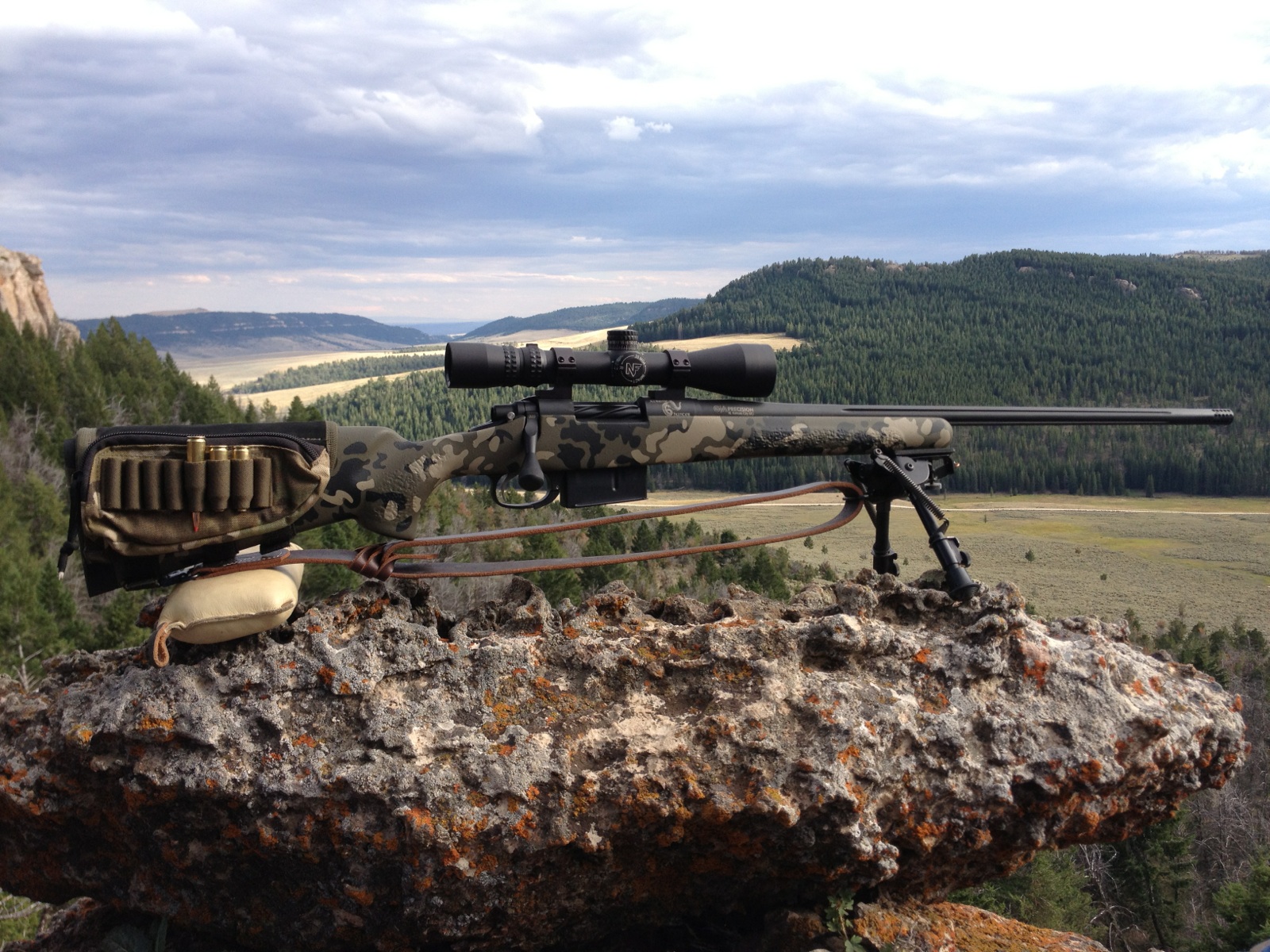

That is GAP camo in a flectarn pattern. The metal is done in black. There are several guys that can do that for you but I would use Custom Gun Coatings. Branden is the owner and he is on this site [MENTION=16310]Short-bus[/MENTION] is his username. He is in Kansas City and can take care of the camo part.
Mino flaws are not going to be noticed in the molded in camo, I have several and they all look great. The rifle pictured is PAINTED.
Yes, but you are talking about a Hunting stock vs a Tactical style stock. Of course they are going to weight different, the shells are completely different. But I am merely putting it into perspective that molded in color vs paint is minuscule differences. And that came directly from Tom.
true, i have not seen the EH available with a molded camo option though as the website says paint only so if he is wanting a molded camo it will come in a heavier stock. my wording that the camo caused the extra weight was bad as i meant to get the molded camo you have (as far as i have seen on the site) to get the heavier stock selections.
thank you. I believe his site is what I looked at. I saw this pattern but with different colors. The flectarn pattern is pretty sweet. The molded Gap camo is sweet also.The hydro dipps are sharp looking to. I'm not sure what the cost difference is but after you brake 4k does it really matter LOL .
What's the base color of this painted stock? If one was ordering the mcs sl stock from manners to try and duplicate this color scheme, what color should be ordered from manners? Earth brown? Coyote tan? Then send it to short bus to paint just the flectarn pattern? Does it even matter what base color is ordered, does Brandon just repaibt the whole thing ?
OD Green. Then stencils are laid over it to do the FDE and black…… I'm kind of guessing but that is how I would do it.
Chevy327... Hydro dip might be a great option for you as well. very durable. Georges X-hunter rifle is dipped (the one on the website)
I have been running a dipped GAP rifle for coyote hunting for over three years and it is tough as nails !
