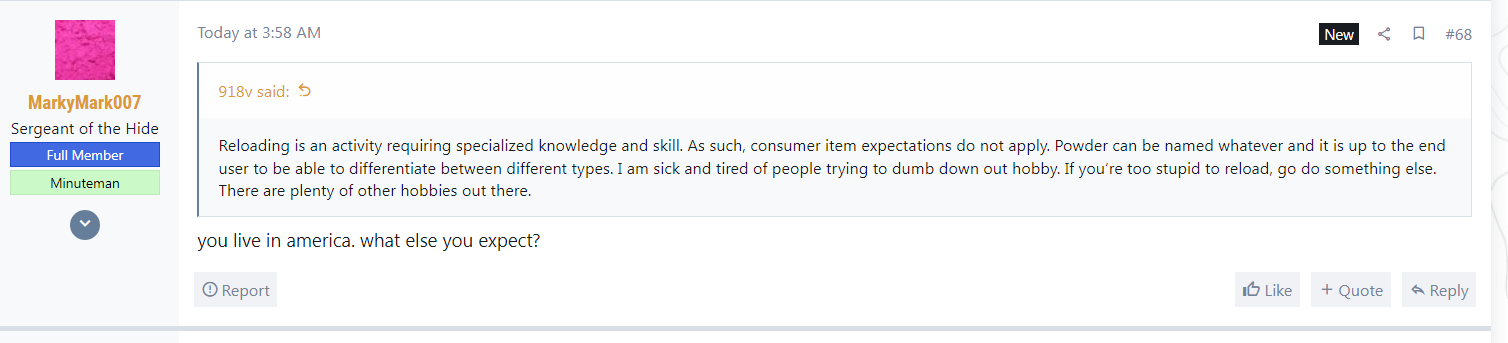

Reloading is an activity requiring specialized knowledge and skill. As such, consumer item expectations do not apply. Powder can be named whatever and it is up to the end user to be able to differentiate between different types. I am sick and tired of people trying to dumb down out hobby. If you’re too stupid to reload, go do something else. There are plenty of other hobbies out there.
you live in america. what else you expect?

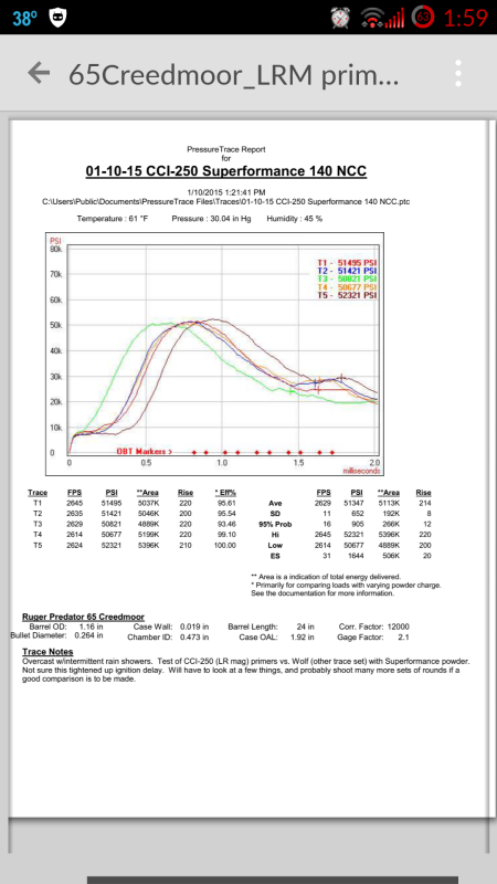

As far as the "sensitivity" bit, that's 99.7% application dependent; and it's actually the primers issue; not the powder. Lots of good work with pressure testing was done by Dr. Denton Bramwell, years ago on this subject.
If someone ever claims to 'know' what their pressures are, or if a powder is "sensitive" in any given application; but they can't show you any actual traces.....
If someone told you they never used a chronograph, but they knew precisely what their velocities were; because they prayed really sincerely and had a staring contest with components. When you got done laughing and stood back up, you'd know how full of chit they were. Same goes for any claim of knowing what a powder is actually doing in any given cartridge. Also remember that burning rates aren't anything remotely like constant, and are mostly estimated anyway.
Norma stated they use the 308 case, a 147gr ball projectile; and a 30-40 something grain charge for their standard cartridge for burning rate testing.... Does anyone in their right mind, actually believe they loaded it with that much bullseye; to see how relatively 'quick' it is?!!?🙄

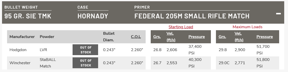

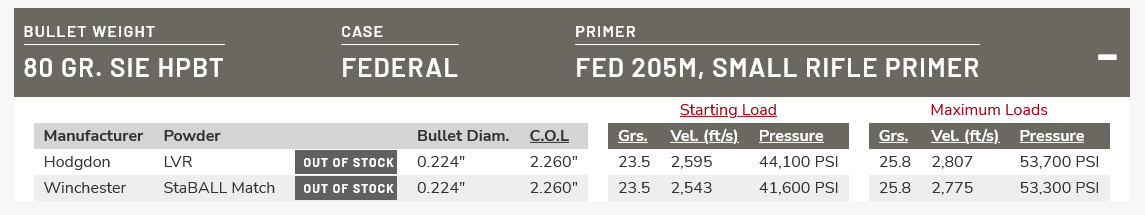

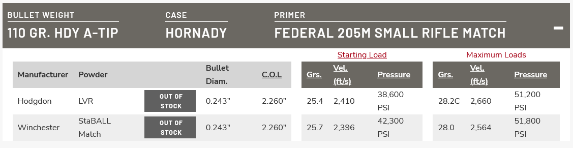

Hodgdon load data looks disappointing for the MATCH in small cases like 6 ARC.
Was really hoping it would get within 50-100fps of Lever.
I'll still give it a try in Valk & ARC.
Looks a little closer in the Valkyrie, but Lever outperforms predictions. Only testing will tell.
View attachment 8041051 View attachment 8041053
Yeah, I had the same hopes and disappointment for the ARC when I saw the new data. Maybe it would still work well in lighter bullets, but honestly LVR outruns it bigly on the end as well.
