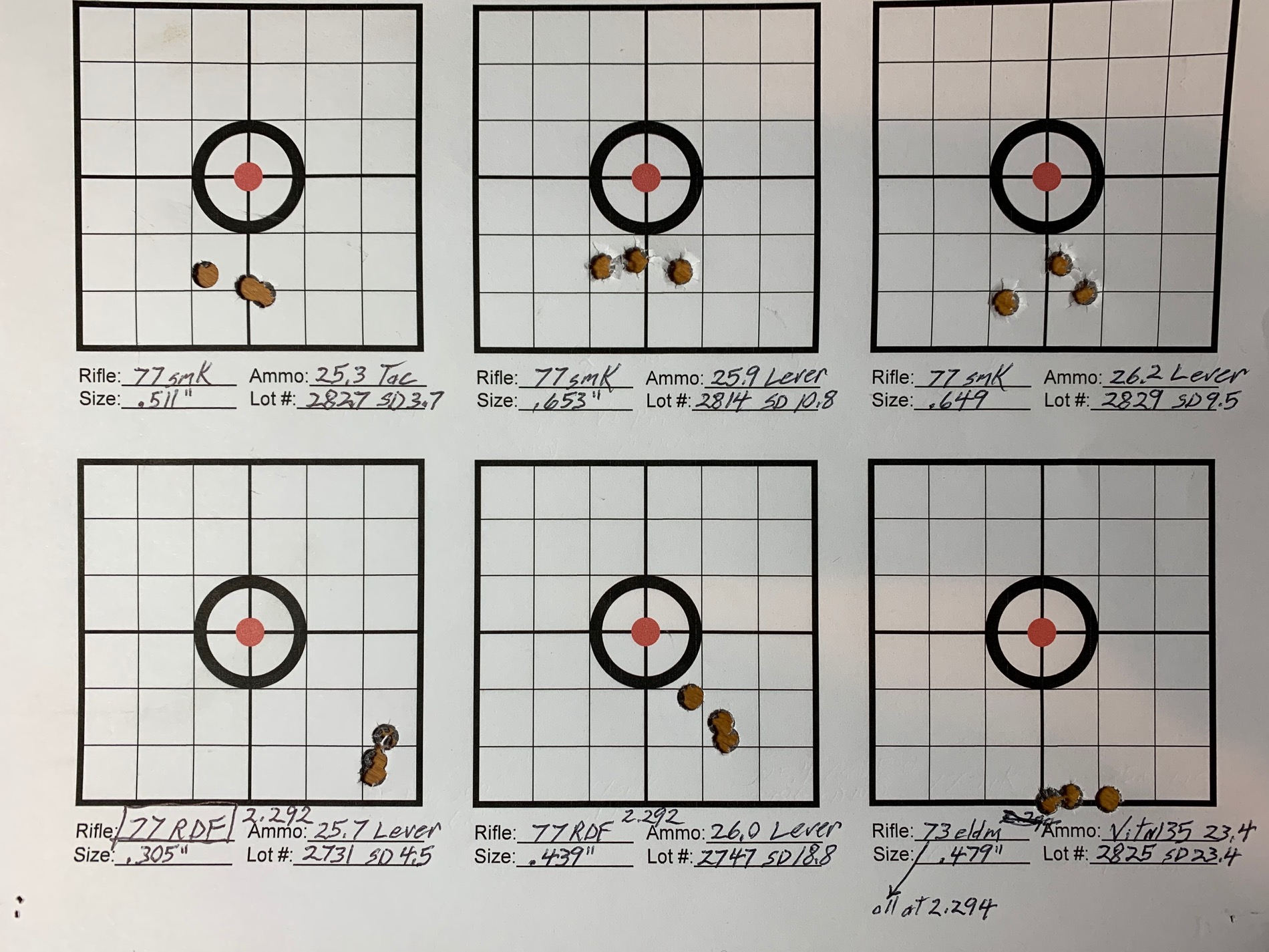

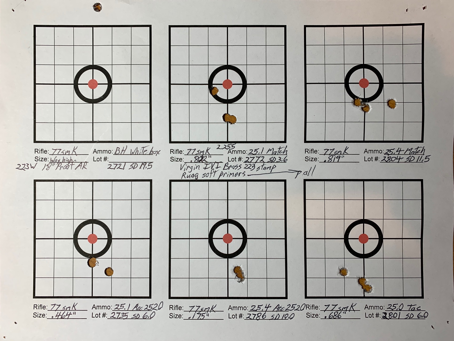

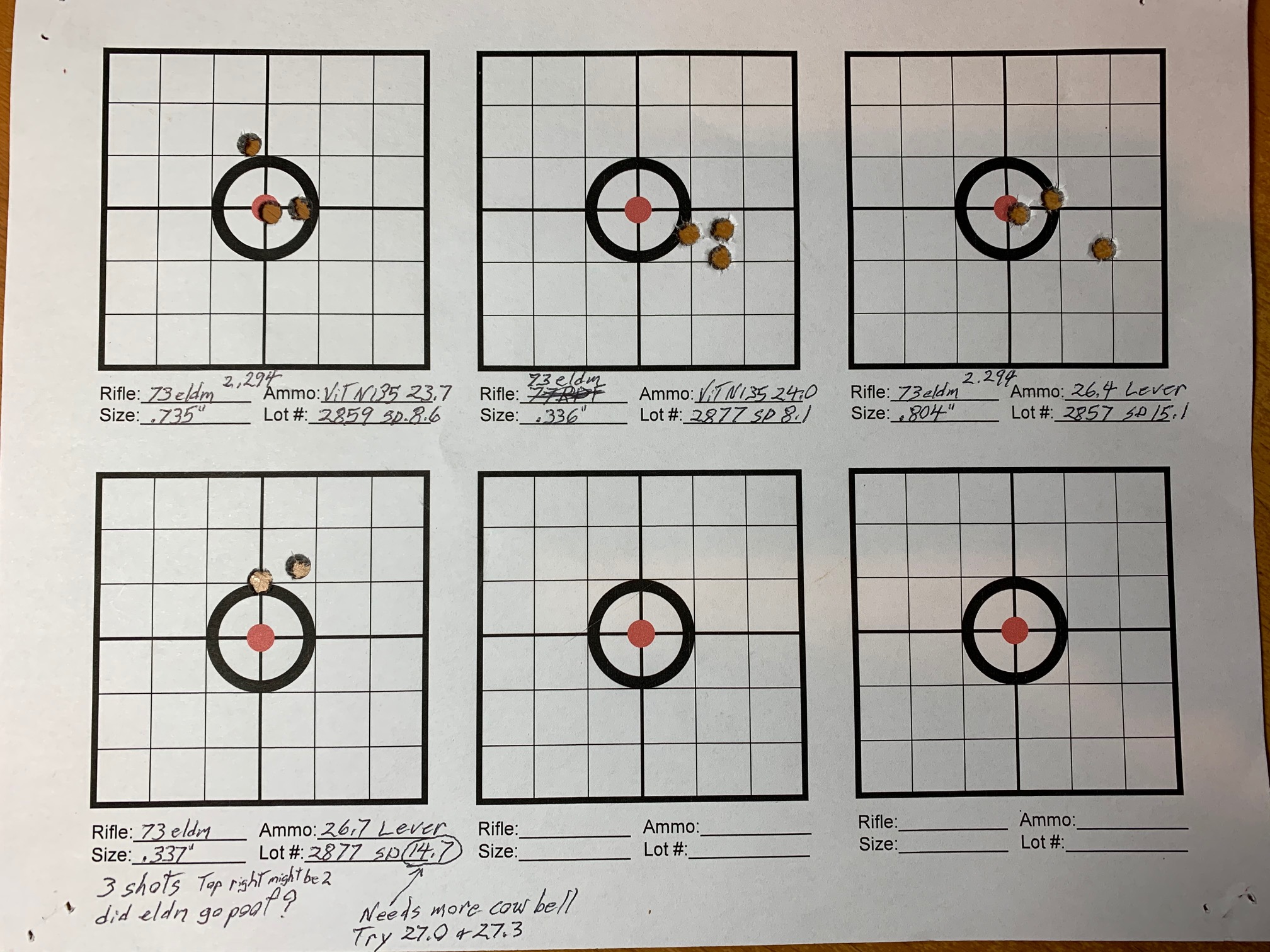

Yeah I agree reading primers isn't reliable. Same for swipes in an AR. All those loads I'd listed were shot from a bolt gun (ARC Nuke). That action has a small tight fitting firing pin & no ejector hole, just the thin slot for the Springfield style blade. I've neve had brass flow into that. Damn thing hides pressure really well. I've never had a hard bolt lift with an ARC action. I try to look at for changes in the radius at the edge of the primers on these. The fact that primer flowed at the pin sent up flags for me about soft primers. We'll see when I repeat the same loads with BR4's or Fed 205AR's.
Just shot the first Staball Match & Lever loads from the 18" AR today. I'd say your spot on with my Lever loads being mild, SD's showed it. Speeds were still good, but I'm going to try 2 more steps with both Lever and match loaded out a little longer.
In the MK262 clone test today the 77smk liked Accurate 2520 & Tac best in my gun. I'm hoping Match acts like Lever and improves with a little higher charge? I want the match to work since it's temp stable. The 77RDF's continue to impress me with Lever. The Valk & this 223W love them. The surprise for me today was the 73eldm. I had low expectations & they shot very well.
I'm just more used to reading pressure in AR's. Got a little to hot with the Vit N135 today and got some ejector indentations + 1 blanked primer. Didn't blow it out just punched it at the pin. That's what Blanked means to me anyway.
AR 223W 8T 18" Proof CF Edit: update 1/28/23
MK 262 Mod 1 clone attempt
Comparison load - Black Hills White box 5.56 Lot #BLH04L061-001 Contract #W911SF-04-D-0007 (brass is WCC 04)
2721 SD 19.5 no group data cause it was way high after scope sight in @50
77SMK no canalure @2.253 Bolt lock
Staball Match
25.1 2772 / 3.6 / .822" No bolt lock on empty
25.4 2804 / 11.5 / .819" No bolt lock, no swipes, no flow
Try 1 x fired with 205AR primer
25.4
25.7
Accurate 2520
25.1 2735 / 6.0 / .464" Bolt lock
25.4 2786 / 10.0 / .175" Bolt lock
TAC
25.0 2801 / 6.0 / .686" Bolt lock
25.3 2827 / 3.7 / .511" Bolt lock
Lever
25.9 2814 / 10.8 / .653" No bolt lock
26.2 2829 / 9.5 / .649" No bolt lock
Try 1 x with 205AR primer
26.5
26.8
77RDF @2.292
Staball Match
25.1 Did not shoot
25.4 Did not shoot
25.7 Did not shoot
Lever
25.7 2731 / 4.5 / .305" opened block 3 clicks & still no lock
26.0 2747 / 18.8 / .439" 2 more clicks = bolt lock. No swipes, no flow.
Try
26.3
26.7
Bonus try
73 ELDM @2.292/1.827
Match
25.6 Did not shoot
25.9 Did not shoot
26.2 Did not shoot
Vit N135
23.4 2825 / 23.4 / .479" bolt lock
23.7 2859 / 8.6 / .735" bolt lock, swipes
24.0 2877 / 8.1 / .336" blanked 1 primer, to hot
Lever
26.4 2857 / 15.1 / .804" bolt lock
26.7 2877 / 14.7 / .337" bolt lock, no primer flow, no swipes
Try
27.0
27.3
Reactions: deepsix++
In a rifle like that then, I'd suggest you're probably just wasting powder at anything below about 27.0gr; I'd be working up from there and finding what the rifle can really do with it. If you can load out to a much longer OAL than an AR, that'll factor in as well.
I noticed you're using the same powder charges with several different powders, but Lever almost always ends up at a heavier charge than everything else for the max (and best) load. Talking about cartridges like this where Lever is a good match of course.
