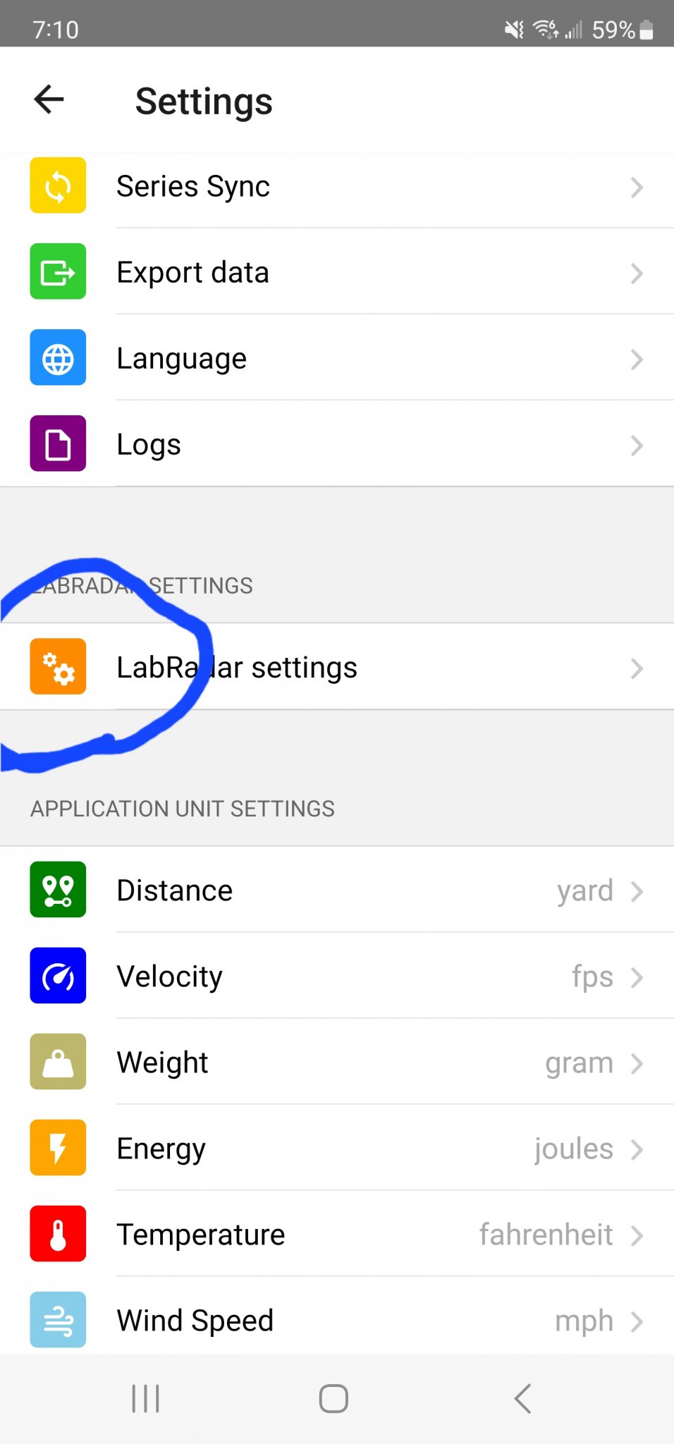

Wanted to update this thread with new findings. Been in communications with the Labradar App folks. They suggested that it’s possibly an issue between the version of iOS and my labradar. Now, I’m not believing it, but I tried it anyways. Updated to the latest and went out today to test it out.

Means you are not connected to the LabRadar. Ensure permissions have been granted to the app and Bluetooth and Location are on.
Under that red bar it should say "Dashboard Settings", tap Settings.
You should then see LabRadar devices as the top item, tap it to view and connect to any powered on LabRadar it sees.
^^^^ this. Dash board button is on bottom left of screen then you see this screen. Tap on labradar devices and then click on your device to connect.
