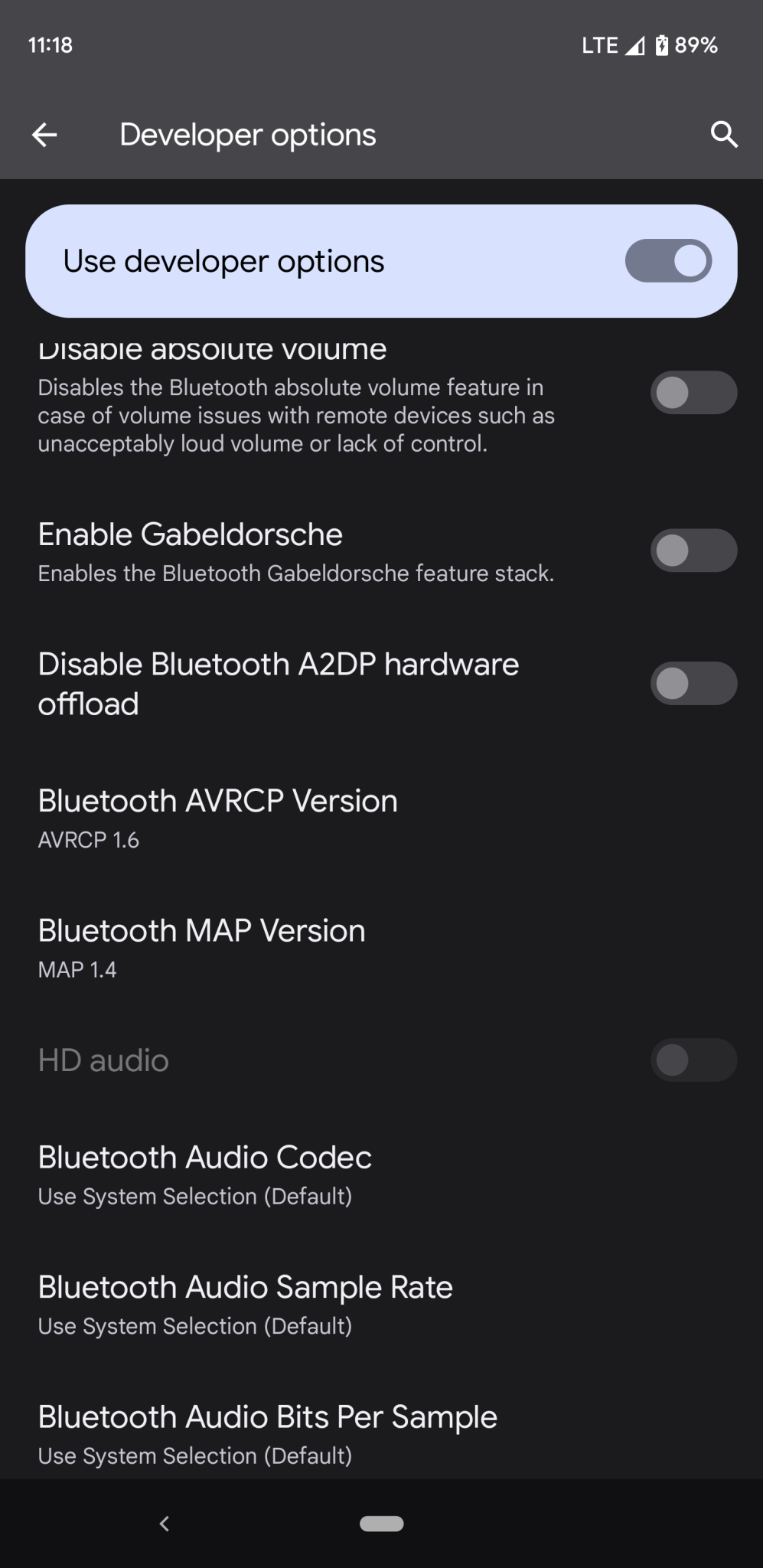

Give this a try.
First thing I did, made sure I had developer access on my device. If you don't, Settings > About phone > scroll down to Build number and tap that repeatedly until you have developer access.
After that, Settings > System > Developer Options > scroll down until you see Bluetooth AVRCP Version - change that to AVRCP 1.6, I also changed Bluetooth MAP Version to 1.4
(The default for me was AVRCP 1.5 and MAP version 1.2, resetting the Wifi/Mobile Data/Bluetooth settings without changing the AVRCP and MAP version did not work.)
Next thing I did, System > Reset options, and I reset settings for wi-fi, mobile data, bluetooth.
Restart phone then attempt to connect.
Reactions: greentick
Even with the new app my S21 and S10 get a connection error. There's no Bluetooth MAP in either system like shown above.
In developer options, look for Enable Gabeldorsche (Enables the Bluetooth Gabeldorsche feature stack) and enable that feature along with AVRCP 1.6. Gabledorsche may auto turn off after phone reboot, if so, enable it again without rebooting.
For those having connection issues, also try it with a freshly formatted SD card or even NO SD card.
