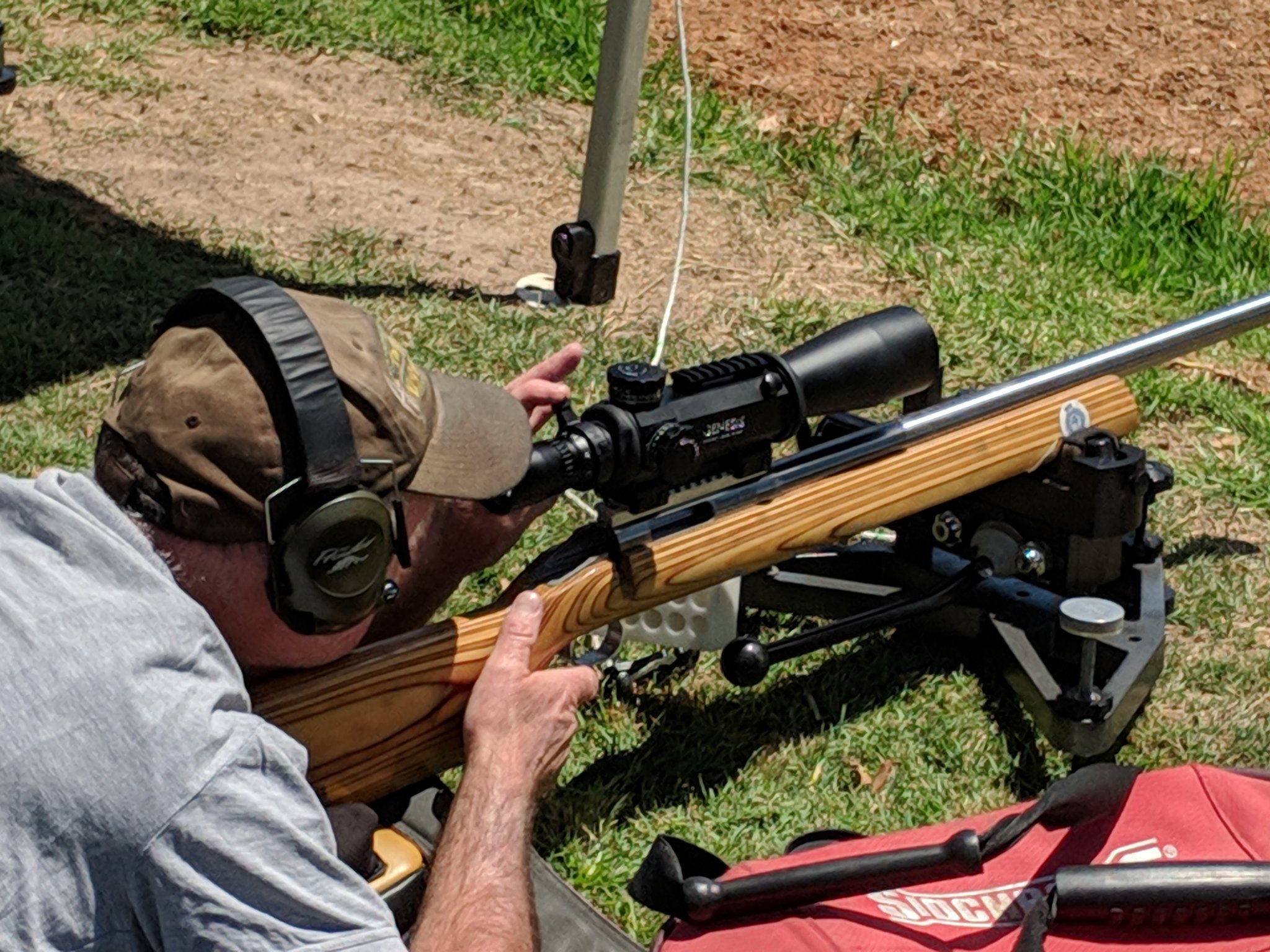

    These things should start shipping shortly. To date there have been 3 prototypes in the wild - one in Australia, the UK and US. I've taken a peek through the one in Australia. It was mounted on a 6BRA F-class gun for viewing purposes only. At 800 metres it still had about 360moa of elevation at its disposal. Glass is the clearest I have looked through and about the only high end optic I haven't looked through is a TT. I believe the lens arrangement is a little more simplified compared to some of the other high-end tactical offerings, mainly due to the construction process being different on this design. March have apparently got 3 new scopes coming this year - two of them I know about. The first one will be a little brother to the Genesis - less magnification, I think 4-40x56 - over 300 moa of adjustment. The second one is a tactical model - I think due to demand from the US market. Mag range again is in the 4-40 range which might be overkill - probably should have gone for a 5-30x56 or something along those lines but I guess we'll see what they have come up with. Wouldn't have a clue if either of these will be at SHOT but it's possible.

    ^^ The two new designs you mentioned will have the same new lens system as the 6-60 Genesis . I agree
    the glass is the best I’ve seen , significantly better than my old favourite Hensoldt . There may be some
    new reticles availiable , which is the only thing I wanted Improved on my existing 5-40 FFP .
