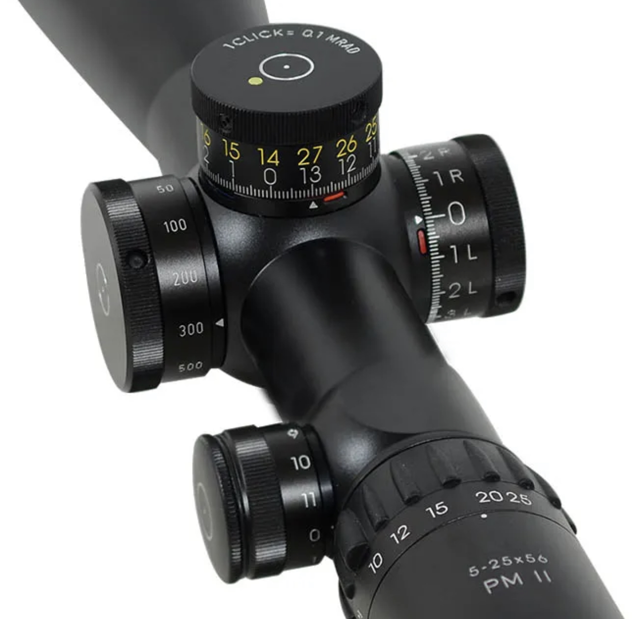

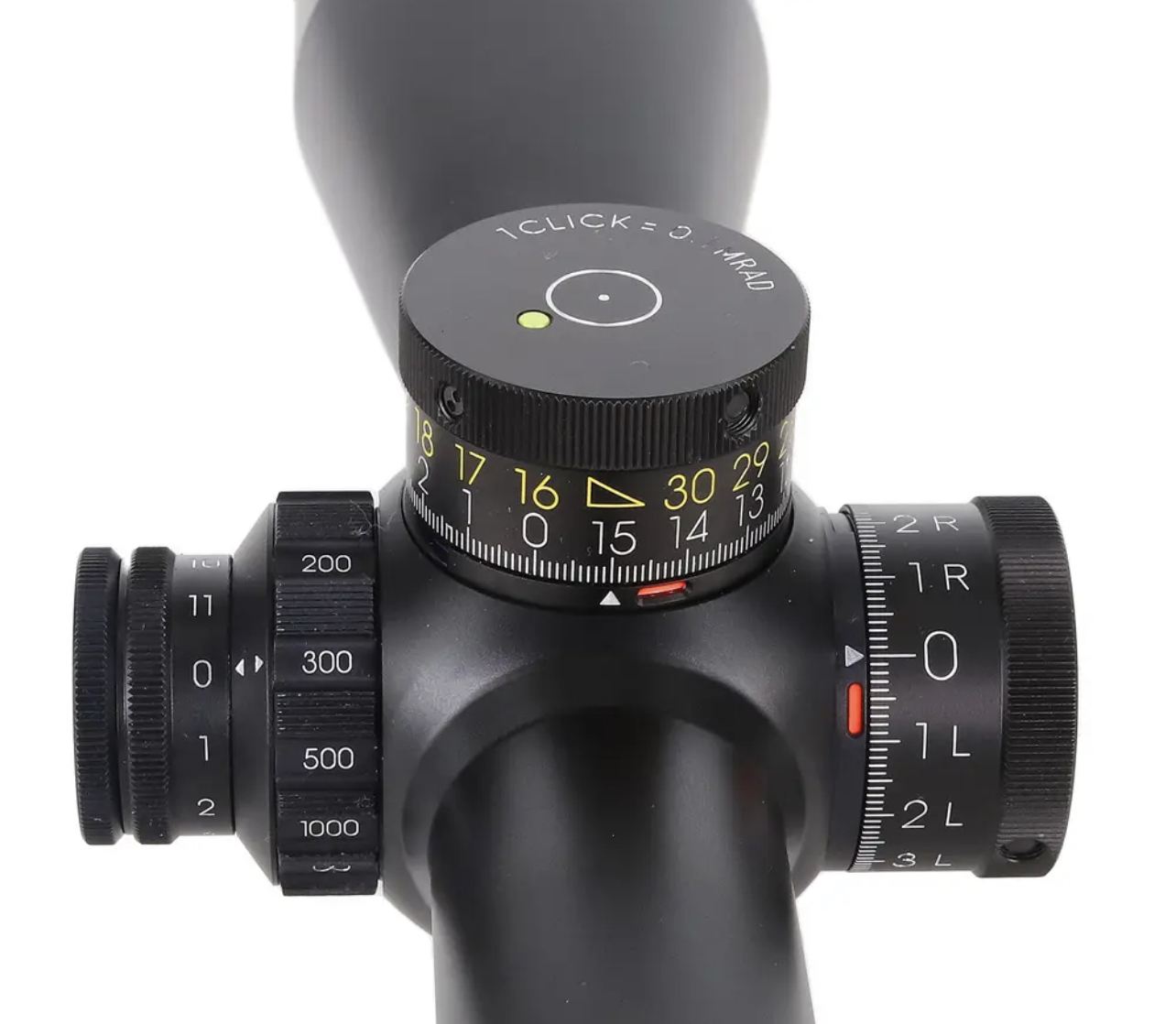

Edit: here’s a pic of the 6-36 DTII+ turrets.
And here’s the same turret on the 5-25:
Both images from Eurooptic.

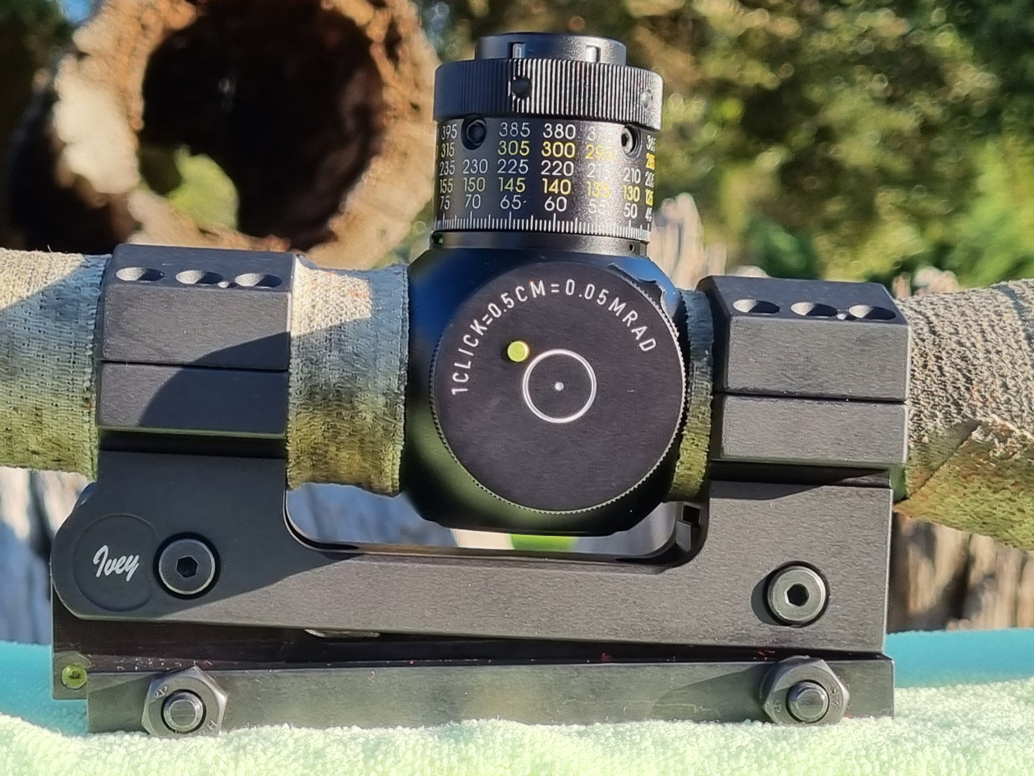

don't forget they also have the 0.05mrad turret, which I believe they call MT II... this thing has something like 39.5mrad of elevation, spaced out in 0.05mrad instead of 0.1mrad. Not sure who needs 0.05mrad clicks, but maybe at the ranges associated with 39.5mrad, 0.05 is a 'big f'ing deal'...

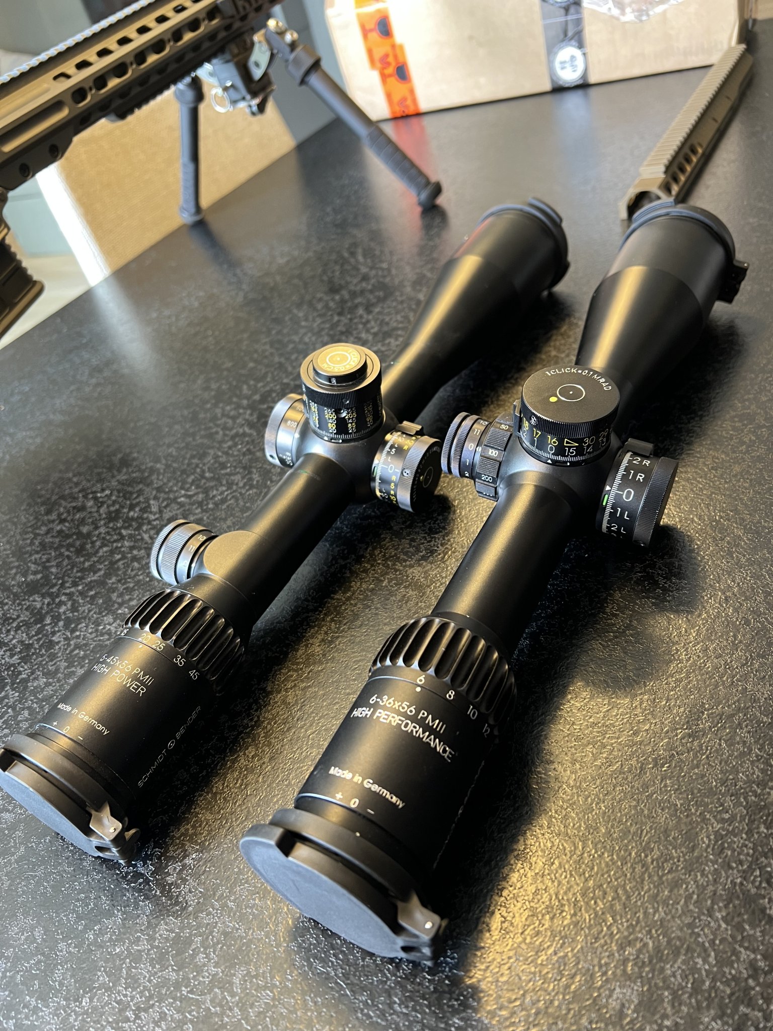

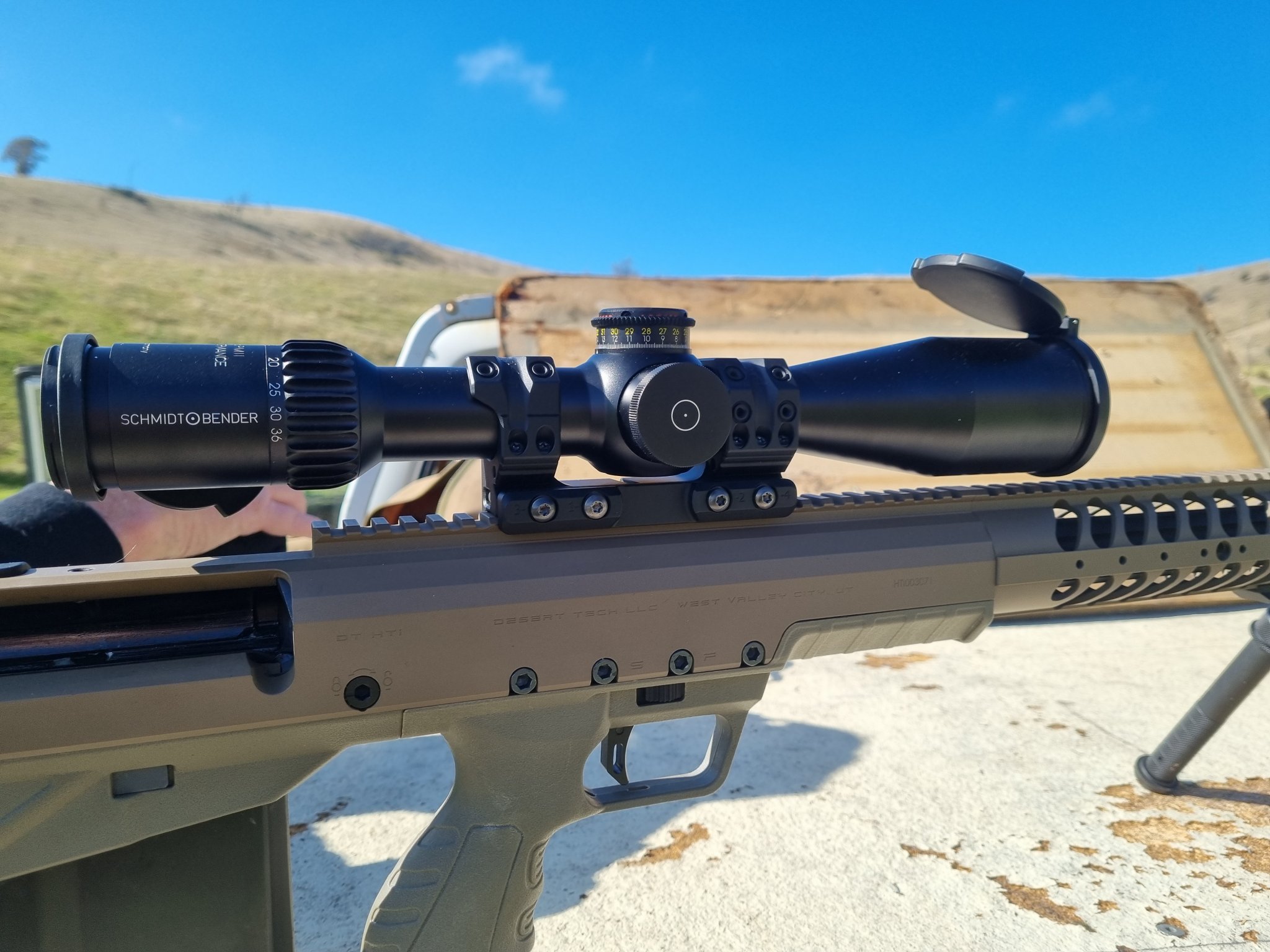

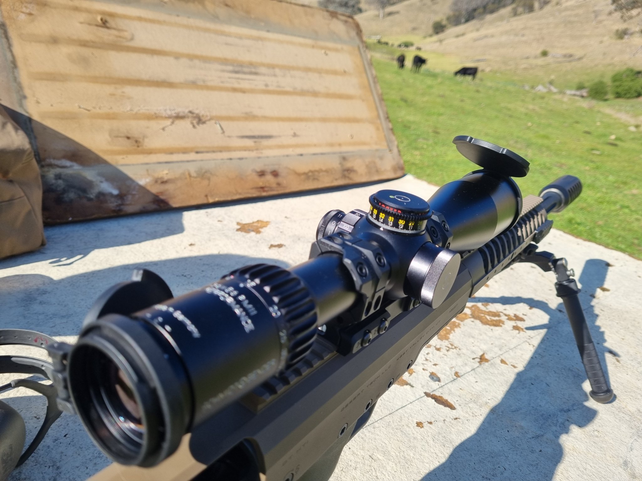

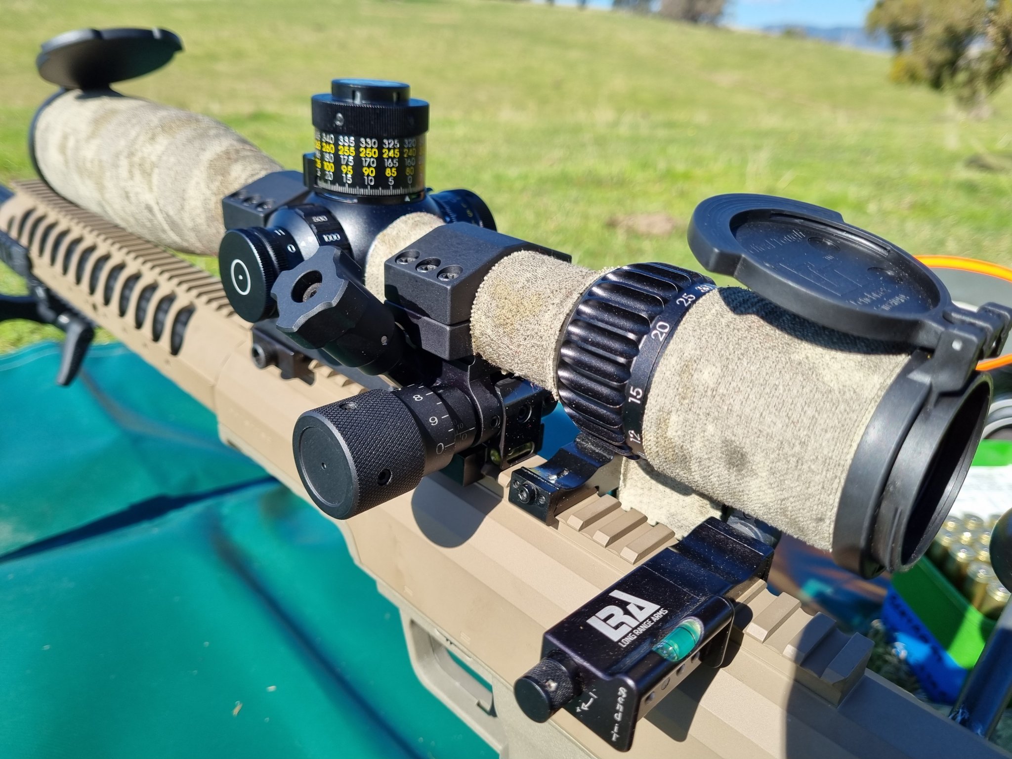

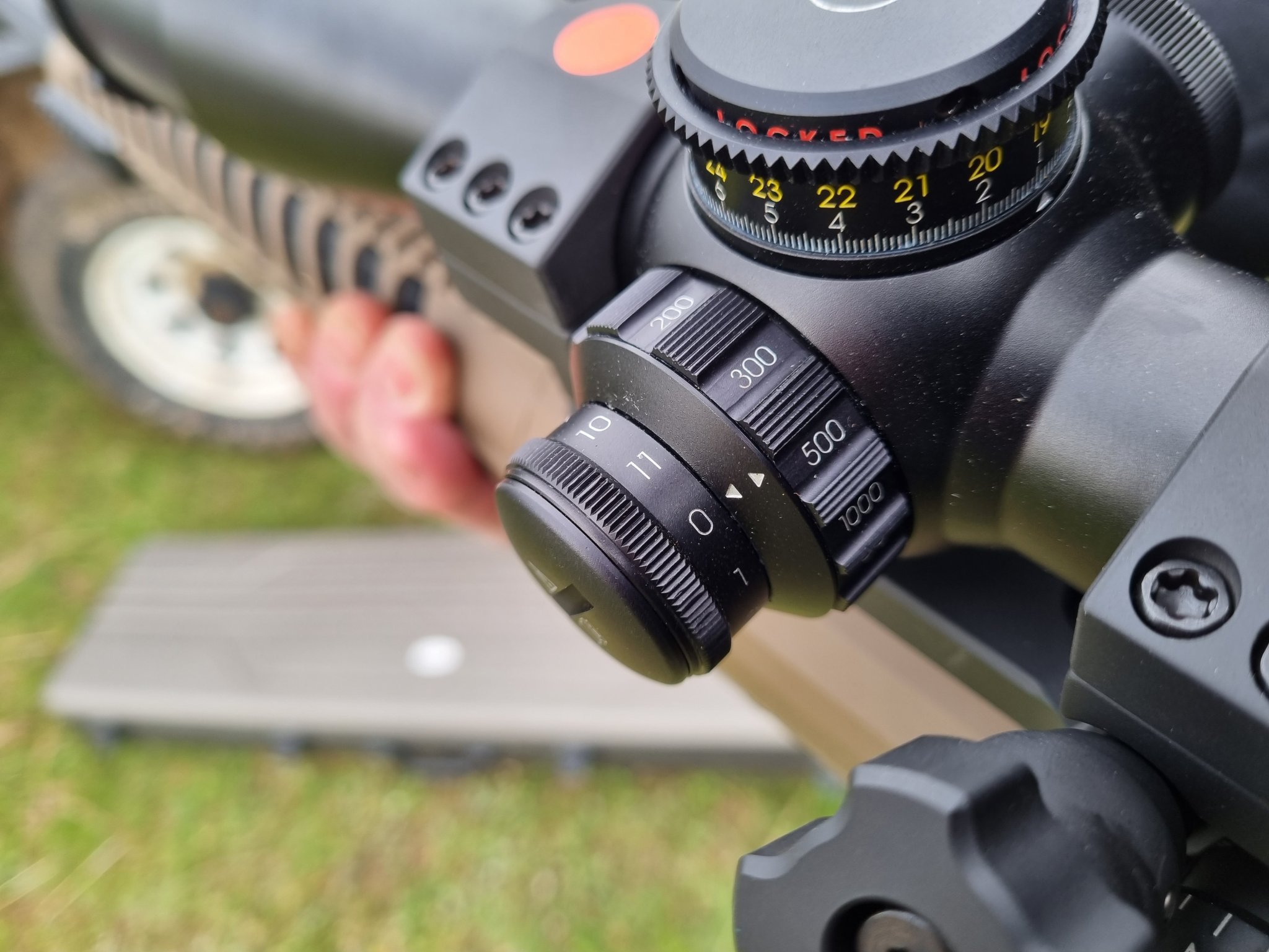

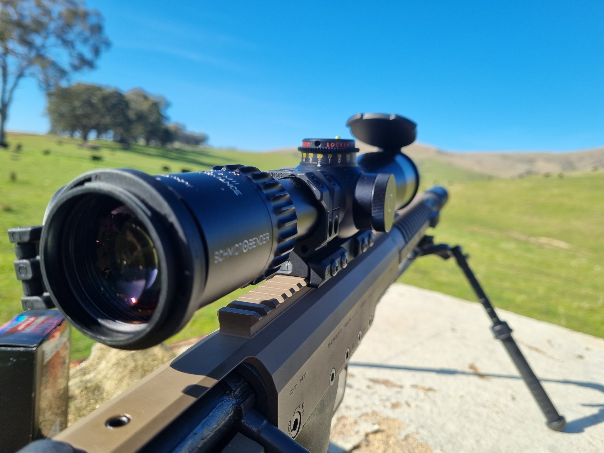

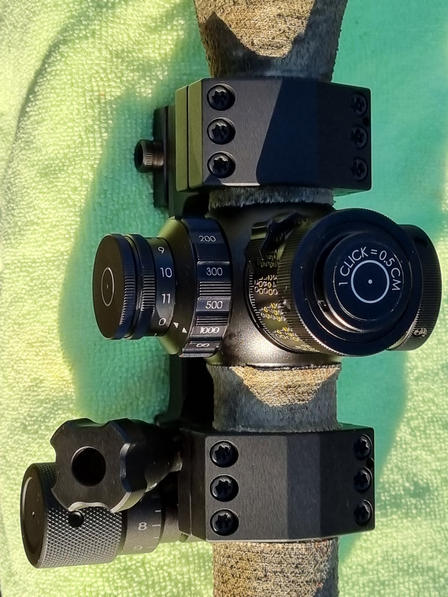

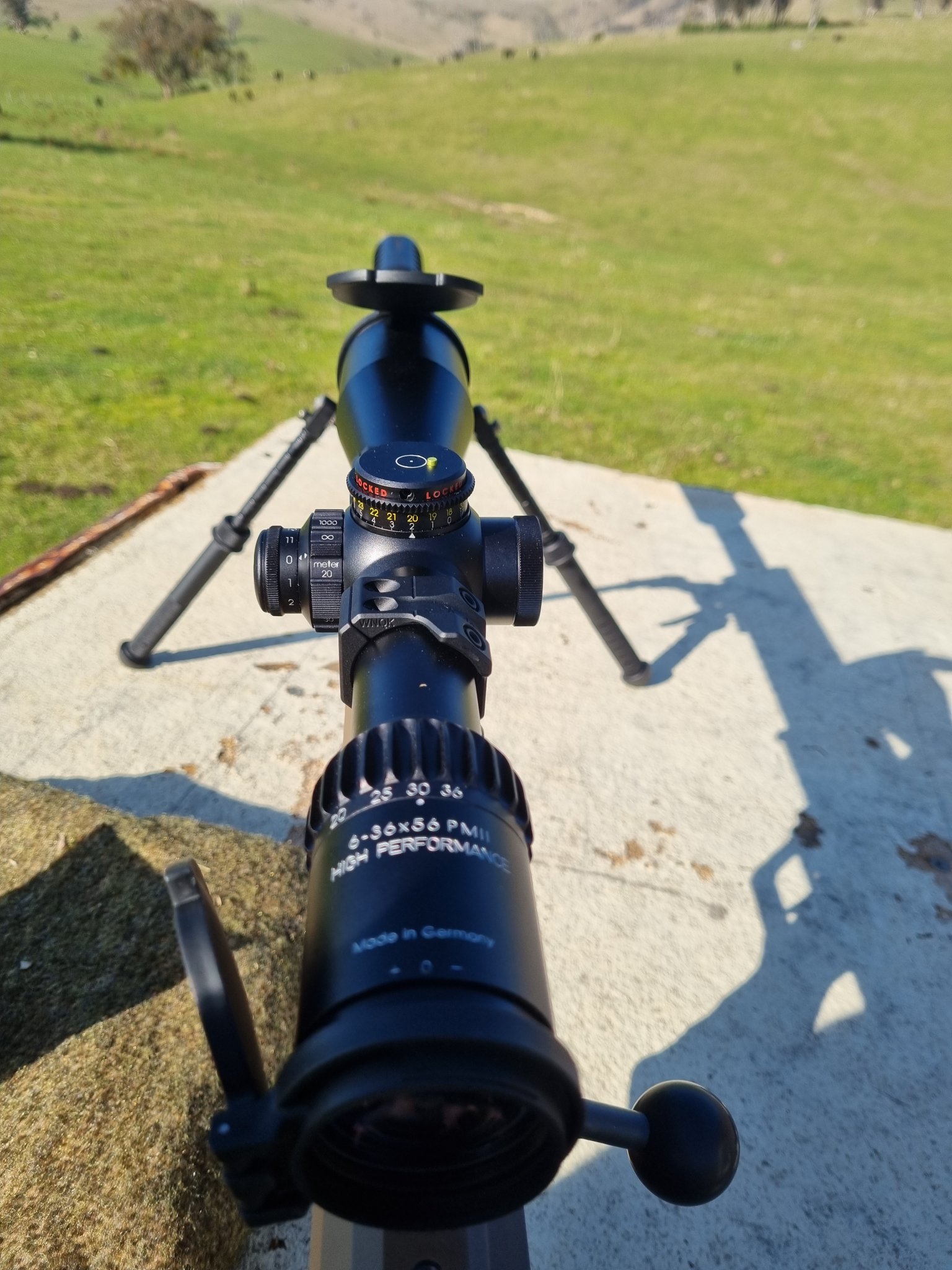

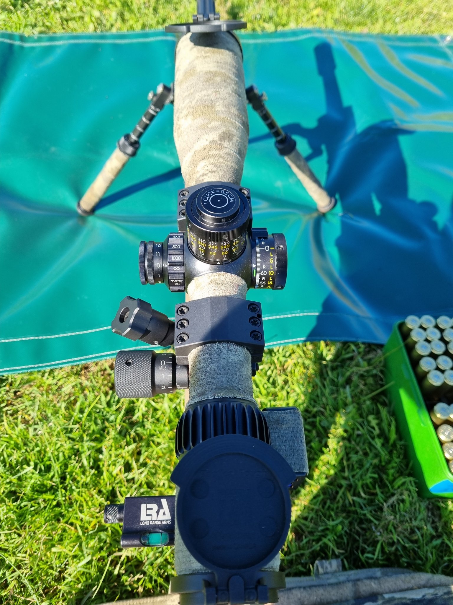

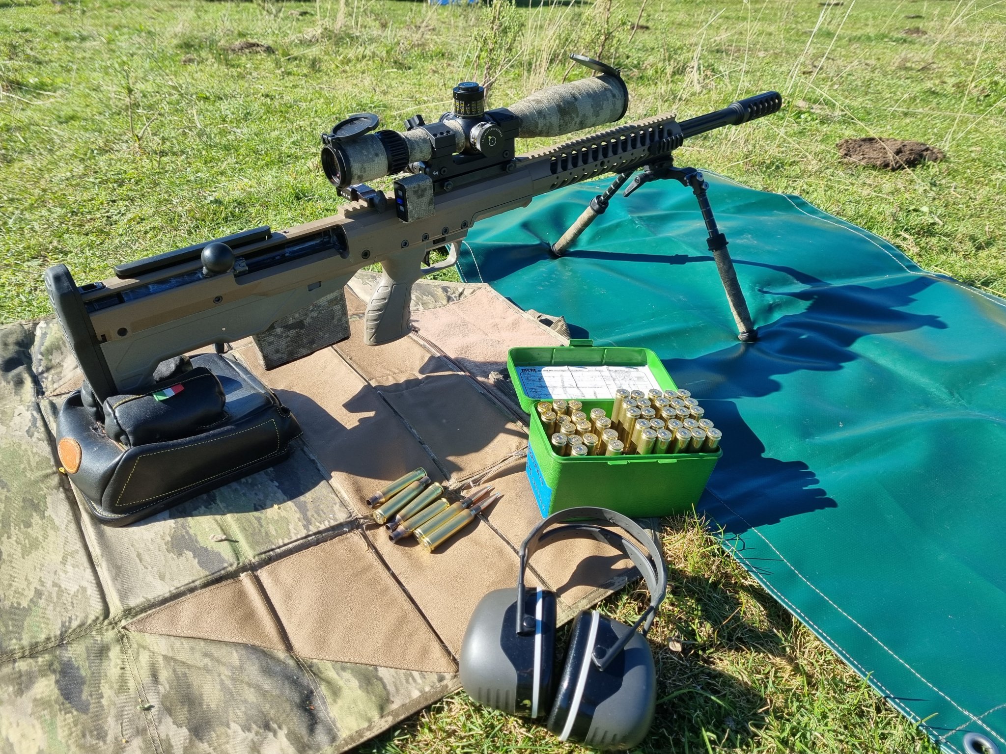

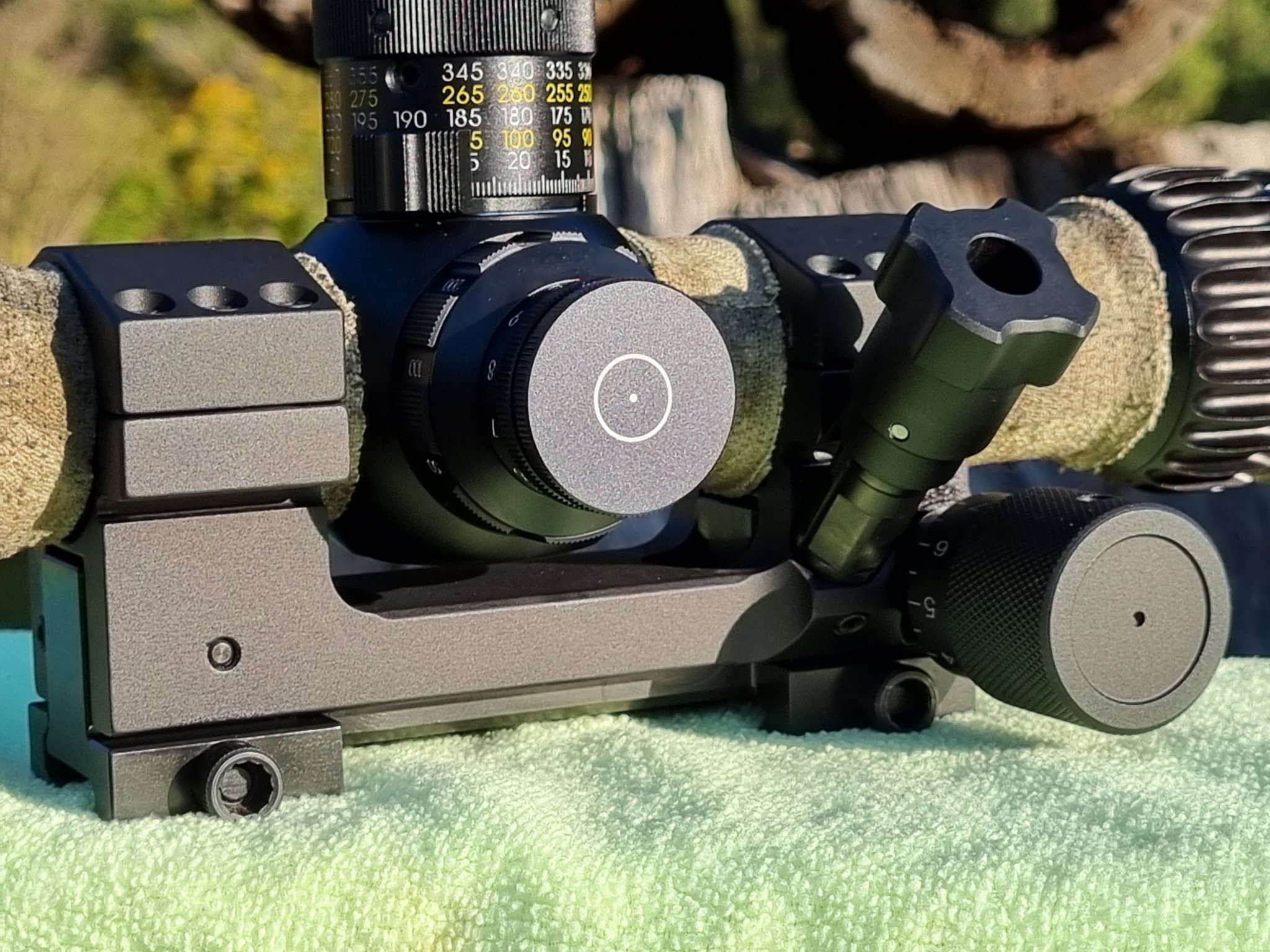

I have 2 off the .05mil MT 39.5mil P5FL ... and 1 of the DT 35mil Gri2D ....The MT turrets are my favourite..
