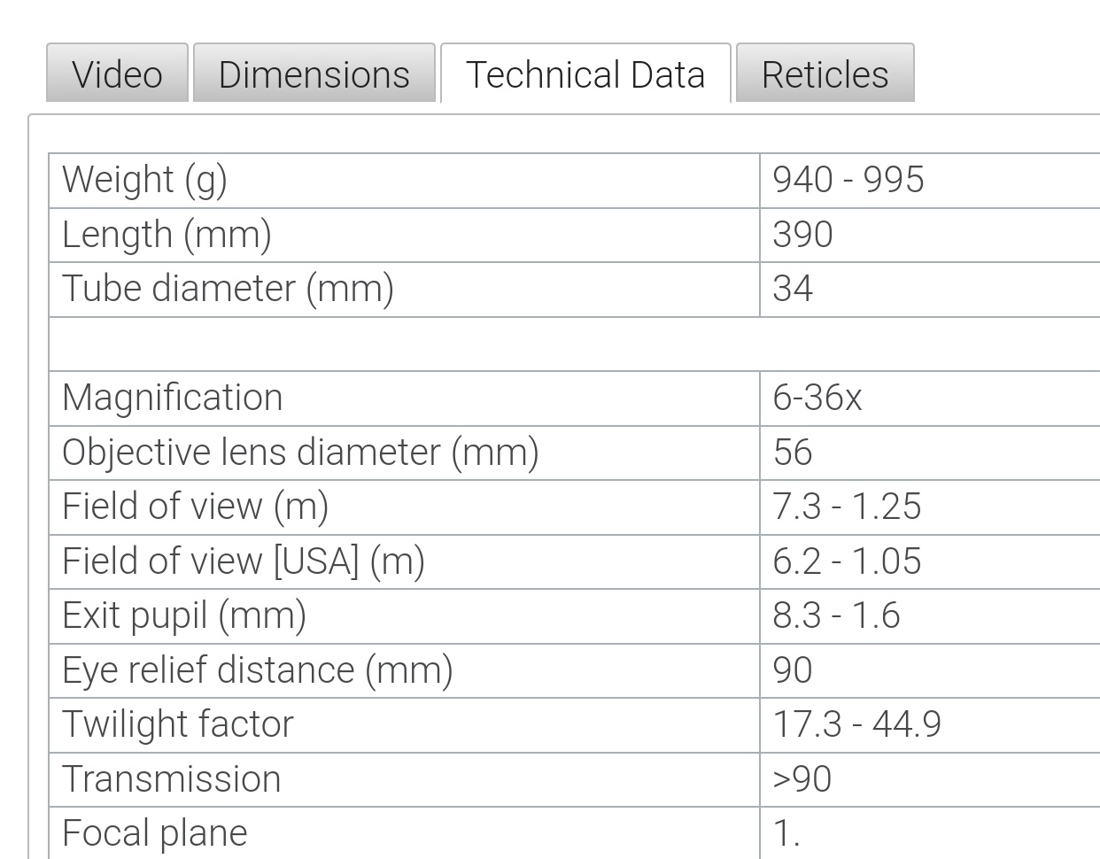

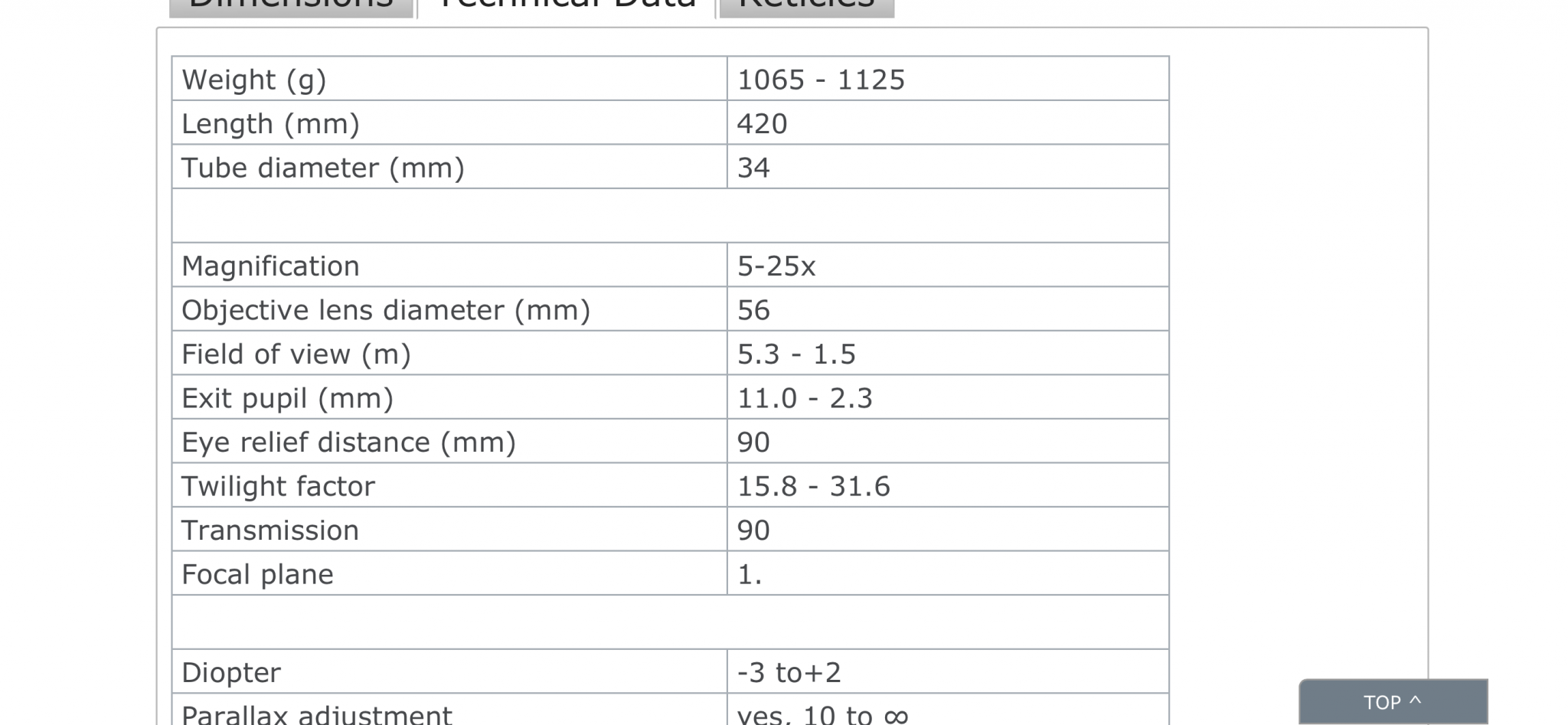

The Euro version.....which we get in Aus....has a different FOV to the US version?
I am trying to confirm with S&B the reason for this. If it is what I think, I will go absolutely "scorched earth" against the culprit.
ILya

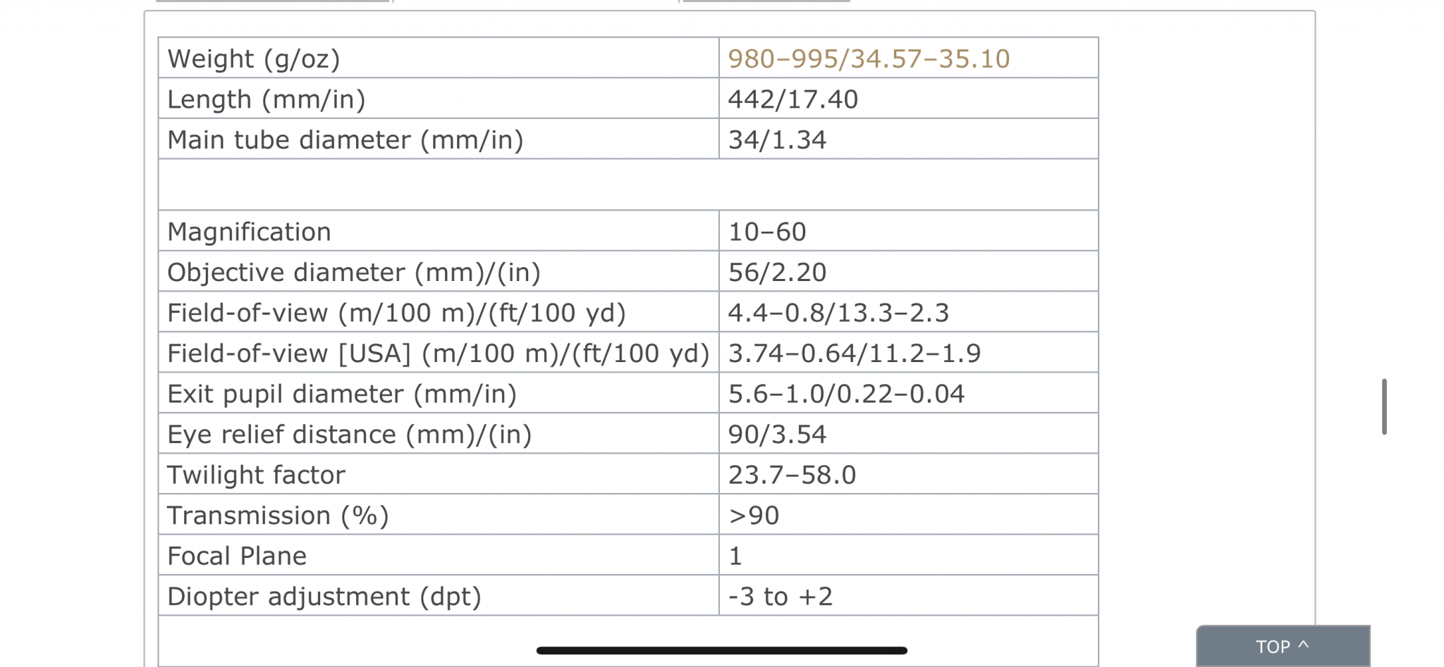

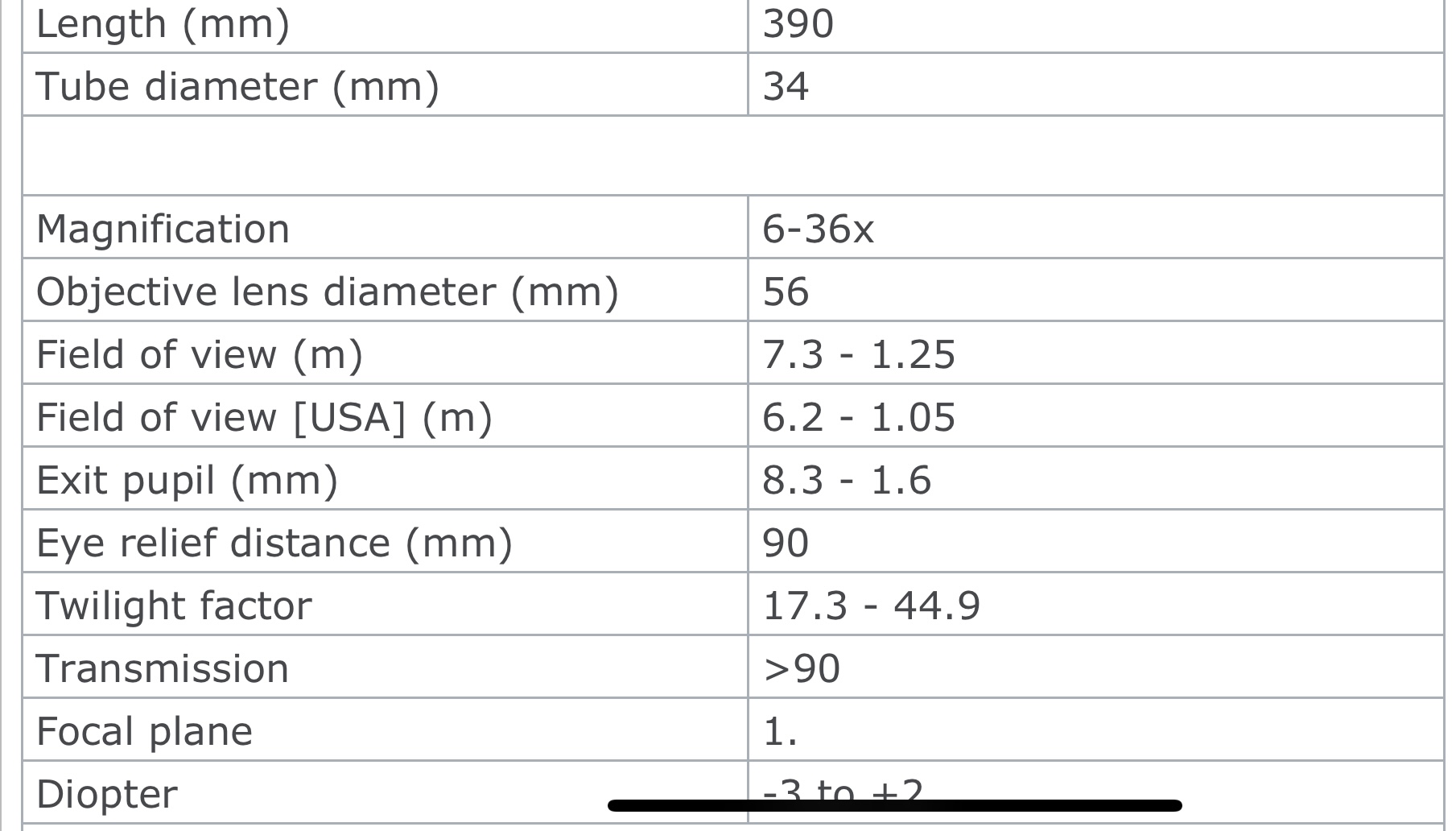

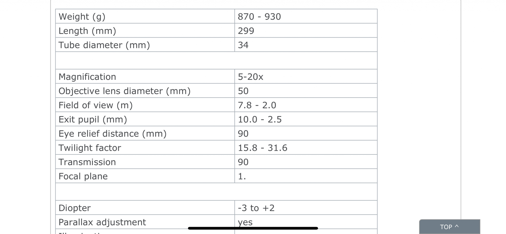

S&B lists a different "usa" field of view number for several models, and I've always wondered about that, because they don't provide enough info to understand the difference in the specs.
Most manufacturers list fov in meters at 100 meters and fov in yards at 100 yards, but the tech specs on S&Bs website list the fov in meters for both the euro and usa specs, so it doesn't appear to simply be providing the fov in yards at 100 yards with a simple unit error on the USA specs.
From the 6-36 tech specs on S&Bs website:

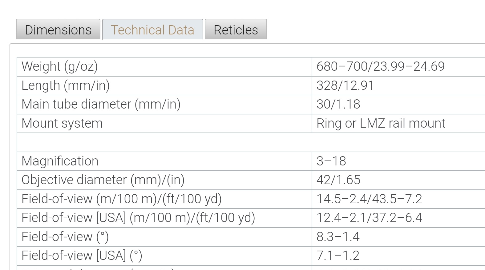

Here's the fov specs on the tech specs for the new 3-18x42 where they provide the fov in degrees as well as meters/100m and feet/100y, but again, the USA specs are different...
Very interested to finally get an explanation about the difference in FOV specs, as it's a pretty significant difference for the USA specs.
about the same for both per the websites.

Am disappoint. Back to the drawing board i guess.
It is an actual FOV difference.
ILya
Why would they do this..?
Unless there is some legal causes that prohibits S&B from selling the EU equivalent in the US it does not make any sense to me..
Developing a product equal or better than the competition, and then offering an inferior version to a big part of its market..
The scope is sold in EU countries for the same or less than the US version, I refuse to believe it is to «save» on the models sold in the US.
Curios to see what S&B offers of information(if any)on this topic, if the reason does not show this being an «out of there hands» decision, the costs to theyre reputation might be..👎🏻
Just goes to show, know what you’re buying and don’t be an early adopter.
Look man, some of us are at that point in life where we have the maturity and patience to raise troubled scopes, have plenty experience with raising our own scopes, and can provide a loving family for them.
ILya
I would like to be a fly on the wall when you go "scorched earth". Interesting you mention "the culprit" as if you know who was responsible for this. The bigger question is why, so will be curious to hear what you find out. Those big FOV numbers were something that initially drew me to the Schmidt 6-36, but if they are crippling the US version of the scope then I agree with others - I'll pass as wide FOV is a big necessity for me.
I hereby dub this brouhaha “FOVgate”.
It’s like a minor version of VW’s dieselgate scandal, only instead of outright lying, the dirty truth is an innocuous line-item on a spreadsheet.
I’m also curious on how this FOV reduction was technically accomplished. And I sense some price reductions on US 6-36 S&B’s in the future lol.

Took a look at S&B website at the newer/updated models, 6-36, 5-20, 5-25 and 10-60.
Only the 6-36 and 10-60 has different FOV numbers specified for the US models, these are completely new designs compared to the other two. Seems like they are designing US specific models of the new scopes🤔
Again, really curios as to why..
Producing two different models of the same scope must be resource demanding and again, makes no sense..
Like asked above, how do they technically alter the FOV on an otherwise identical scope?
