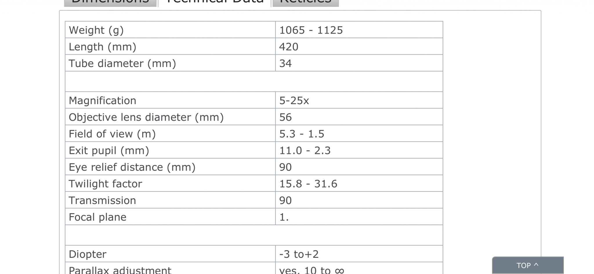

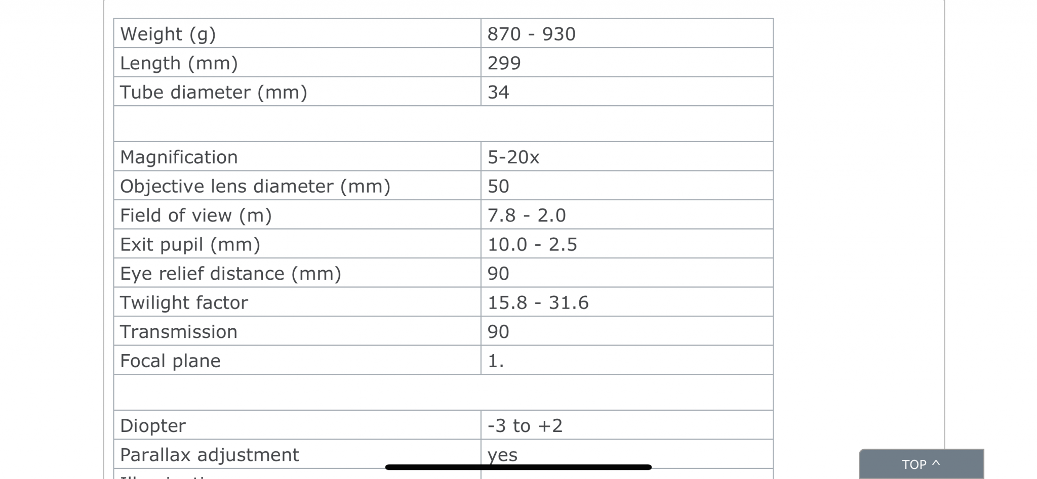

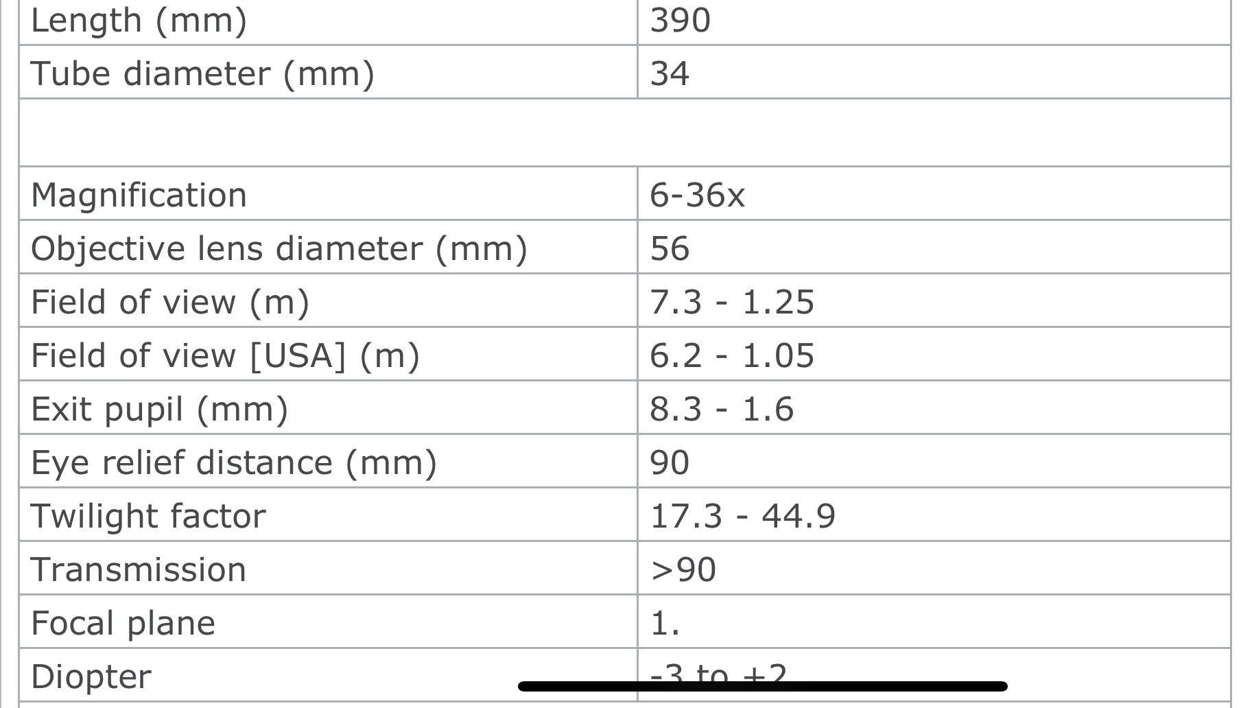

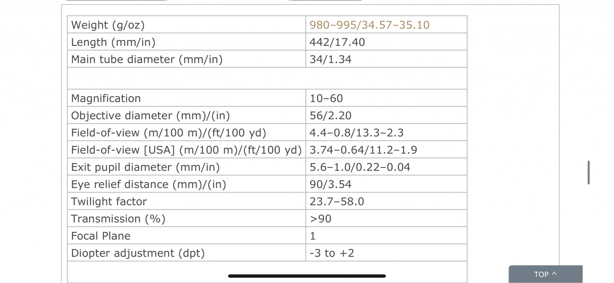

Took a look at S&B website at the newer/updated models, 6-36, 5-20, 5-25 and 10-60.
Only the 6-36 and 10-60 has different FOV numbers specified for the US models, these are completely new designs compared to the other two. Seems like they are designing US specific models of the new scopes🤔
Again, really curios as to why..
Producing two different models of the same scope must be resource demanding and again, makes no sense..
Like asked above, how do they technically alter the FOV on an otherwise identical scope?
View attachment 8191560View attachment 8191561View attachment 8191562View attachment 8191563
Some 3-18x hunting scope that someone mentioned above also has differing US/Euro FOV number as well.
Maybe they just swap out some lens element for a cheaper one lol
Possibly a different eyepiece? Maybe they stole the design from USA and are worried about US Patent laws :LOL: Seriously though, it will be interesting to find out what the official word is on why and how so enough speculating, hopefully we can get some real answers on this soon.
FOV is determined by 2 factors, assuming the image is always in focus:
height of the sensor
and focal length.
per this trig formula:
AFOV = 2 * arctan (height of sensor / 2*focal length) ... yielding a number in degrees or miliradians. Run angle thru trig using 100m or 100yds to find the resulting image dimension. This number is unit-less (not sensistive to metrics vs imperial)
Is the lenght of the US scope different than ROW? Is the eye lens different on the US scope vs ROW?
Additionally, does the US DoD have some F'ed up definition of FOV? Maybe they - US DoD - using some different math function to calculate?
This is very simple optical math - and no way is S&B messing this calculation up... no way could be designing optical systems for 75yrs...
and focal length.
Has to be something weird at play here.
Would be VERY curious to put one of our Aussie/EU 6-36,s up against the "US" version and compare!!

Still wondering why the US version has a lower FOV.
My theory on this is that the larger FOV has some optical degradation around the edges, S&B does not want their glass quality questioned by the US market and so have limited the FOV.
You can actually see that the FOV measurement in degrees is smaller, 4.2 VS 3.56 so there is a technical difference.
This is just my opinion but there is no other differences listed in the specs.
Yeah I bet you’re correct. That’s a nearly 10% loss of FOV. I don’t like either option honestly. Otherwise I’d bet it’s a pretty badass scope.
Or it’s a typo? Hopefully someone from Schmidt can get a clear answer.

I am going to do a livestream tonight at 8PM Mountain and one of the topics I want to cover is the S&B FOV issue.
For what it is worth the FOV on the US version is not narrow. It is just not as wide as in the rest of the world. The FOV is about the same as ZCO on the same configuration and I am beginning to wonder if that is the case for the same reason.
The S&B scope I have here is an exceptionally nice design and I do not think it is S&B's fault that they are forced to throttle the FOV for the US.
I am going to make some educated guesses in the livestream tonight. I'll keep digging in the meantime. If my guesses are incorrect, I will certainly issues a retraction.
