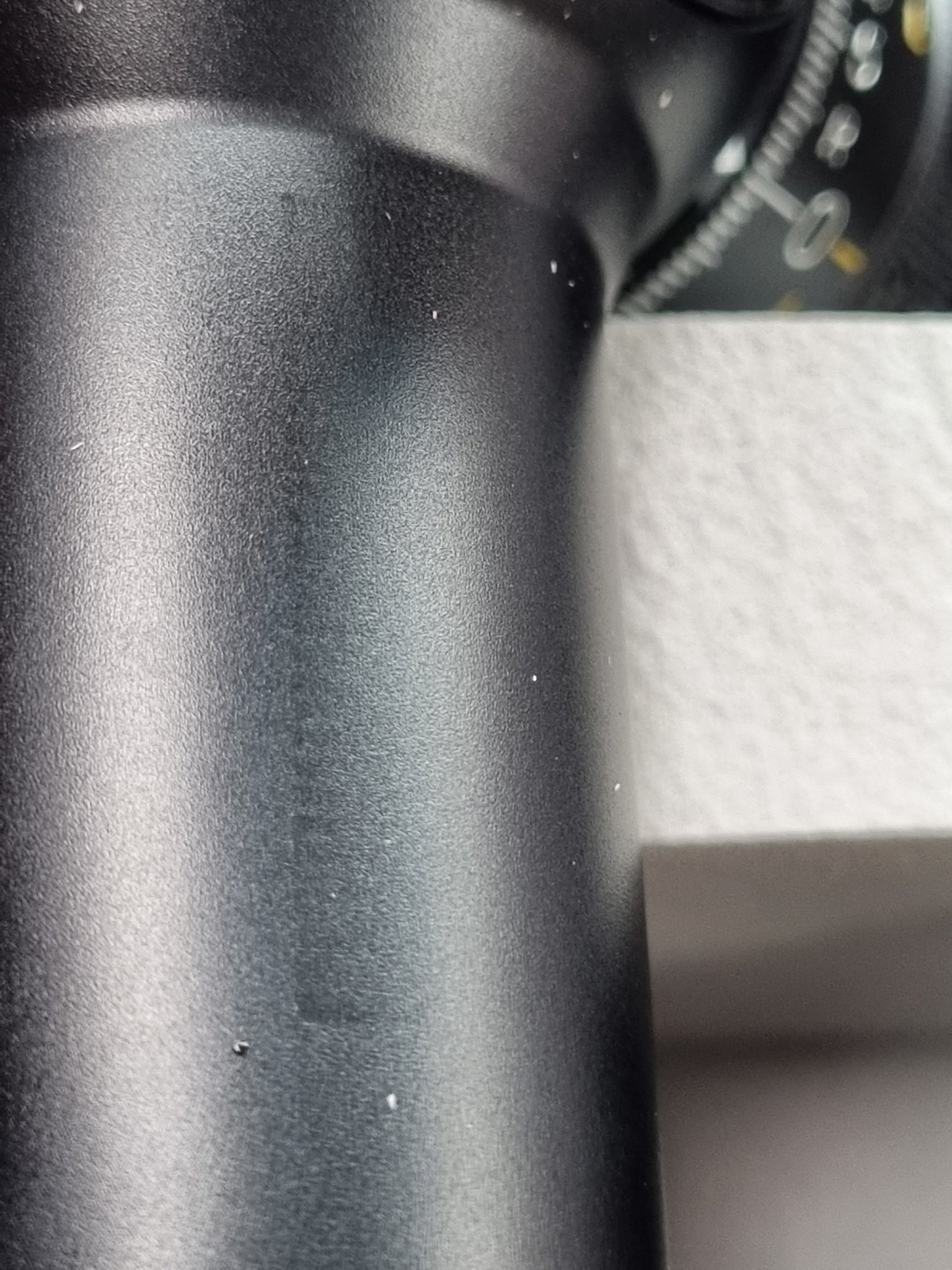

Funny you mention that !!! NEVER in my life have i had scope tube damage. When i unmounted one of the 6-36,s i was shocked to see this..( see pic)
Mount rings were only done up to 15 inch pounds and it has still left a detectable impression!!!! My theory ( not fact) is the NEW series have thinner tubes!!! which if it is the case i am not at all impressed..

I love clear German glass.. have been using it since the late 90s on hunting rifles. I have wrecked a couple lightweight hunting scopes while mountain hunting. It sucks but thank god it was only $400-$500 going in the can at the time., I think I read somewhere that S$B can replace a tube if it’s damaged.

So, that’s a dent and not a finish scuff?
I assume you were using a known good mount that didn’t mess up other scopes.
If that’s a dent and with a known good mount, then…sadness.

That's a mount issue more likely than a scope issue. The type of a mark you are seeing has nothing to do with scope tube wall thickness. You weren't using a Spuhr mount were you?
Reactions: JakeM
Yes Spuhr.....but many others optics have been in that mount without issue ??
I have seen more issues with Spuhr than with all other high end mounts added together. If the tolerances stack up a little, Spuhr is usually the failure point owing to those conical head screws.
