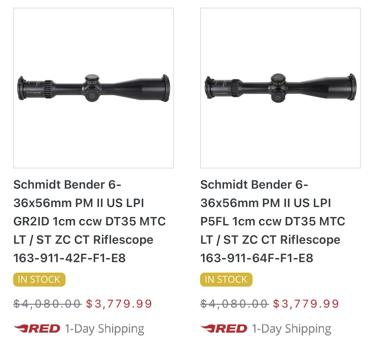

I like the TR2ID, don’t think I’d like the GR2ID because it’s busy on top, but I haven’t looked through one. Are you saying the TR2ID costs more? If so that’s weird because it’s basically the same thing, just less of it.
The TR2ID is about $1k more list price. About $525 actual.
I looked at EO and I see what you are saying, and I do remember mine cost more, but it was because all TR2ID reticles are 2024 models with 2024 pricing (increased at beginning of year). I'm guessing they still have the GR2ID models from 2023 and before that don't have the price increase. Also, they've marked the GR2ID scopes down from list, but not the TR2ID, so there's another reason. I'm guessing that's because they anticipate the TR2ID being more popular. I wonder what the list price is for identical 2024 6x36s with the only difference being TR2ID and GR2ID reticles...I bet they have the same list price now. All guesses, and I'm wrong a lot.
For me, I just couldn't get over the GR2ID. I have a Tremor 3 that is so busy on top of the horizontal that it drives me nuts trying to spot misses. The GR2ID looks worse to me in the drawings. The reason I didn't buy a 6x36 for so long is that I just couldn't stand either of the two reticles. When the TR2ID came out, I was on it like a duck on a June Bug. Pre-ordered and got one of the first ones delivered.
