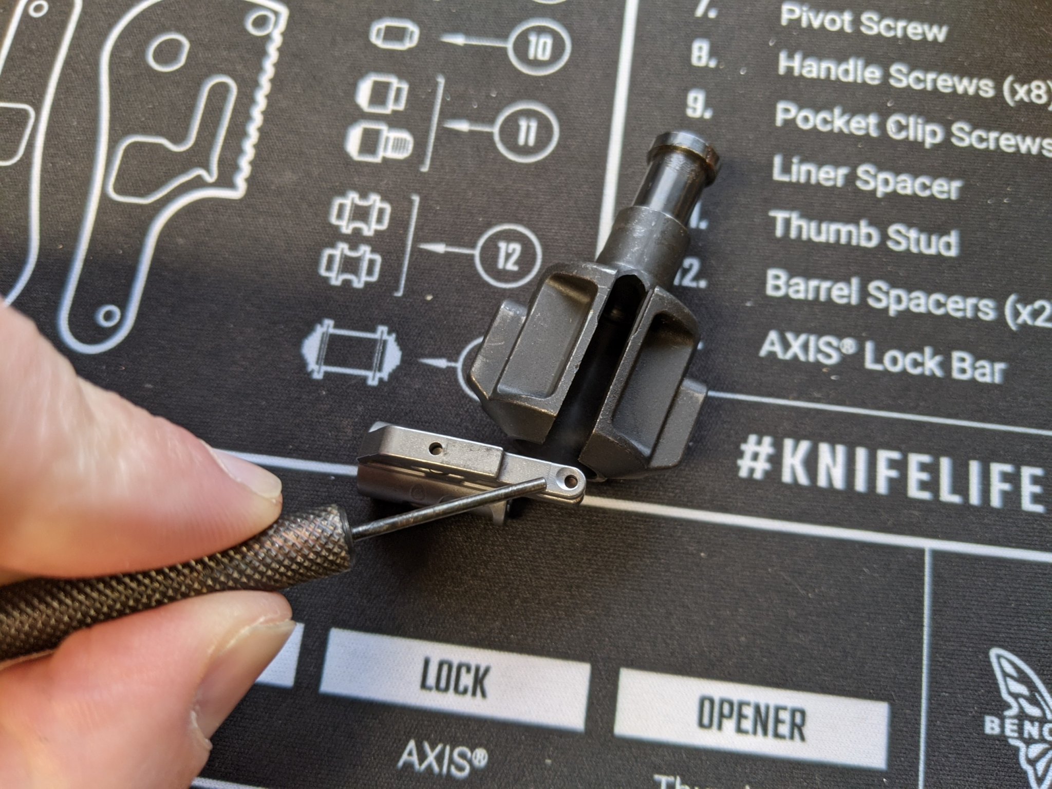

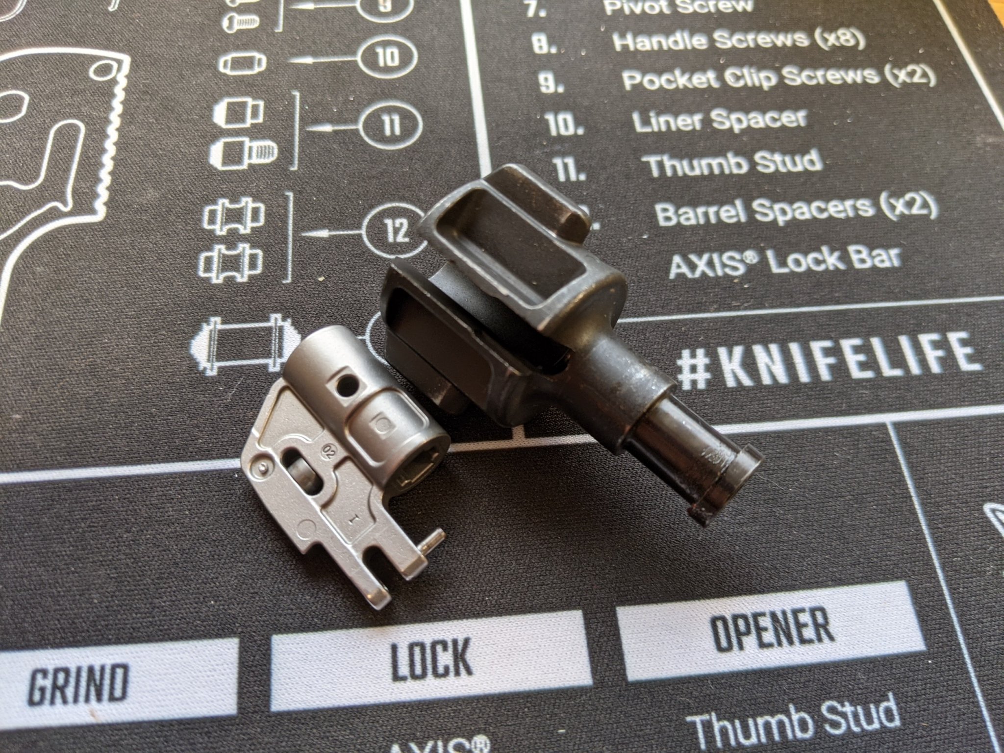

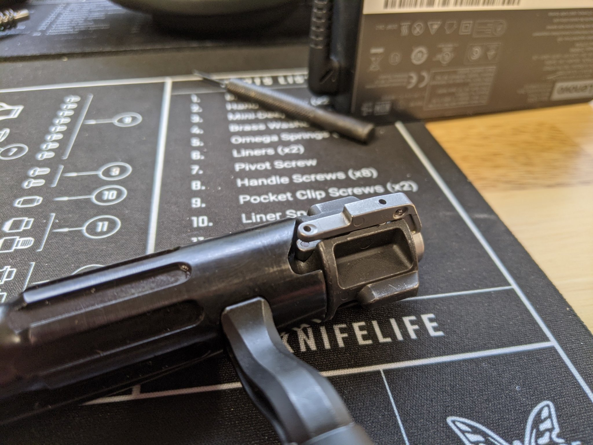

I bought a slightly-used Cross from a Hide member a few weeks ago. The rifle was in like-new condition and fully functional when purchased, so no issues with the seller. I did a quick field strip to verify cleanliness and lubrication, and everything looked great.
This past week, I was dry-firing it during a conference call, and suddenly something felt "off" with the bolt lift. A bit of inspection showed that the cocking piece (to use the classic term) wasn't traveling fully forward upon each pull of the trigger. And then I found this when I pulled the bolt and attempted to drop the cocking piece by twisting the shroud:
The cocking piece has two steel rollers to minimize friction - one at the its tip, and one roughly in its middle. The roller at the tip has left the building, and the pin that is supposed to retain it catches on the shroud and prevents full forward travel of the cocking piece.
The cocking piece has a small peened section that appears to be intended to capture the roller axle pin. Unfortunately, if the feature fails to do its job, that pin can move, potentially bind the cocking piece, and prevent full firing pin travel.
It appears that the other roller and axle pin are captured during assembly of the striker mechanism and has a lower likelihood of moving after assembly (so long as its peened feature is intact; if that feature fails, the pin could potentially prevent bolt travel).
I gotta say that this is an unsatisfactory condition; we've added four pieces to the assembly to reduce bolt lift effort, and the result is a potential loss of primary function. This might be an American rifle, but its German heritage is evident :cautious: (Meanwhile, every mentor I've ever had in my engineering career is snickering at the fact that I've become the grumpy old guy who complains about shit being too complex.)
Anyways, now that I know more about what's going on in the striker assembly, it's no surprise that someone found a way to foul it up with some fine dirt/dust/cement/whatever and create enough drag to delay the firing process. And if indeed we're complicating that problem with parts not staying where they should, then I think we're witnessing the result of multiple root causes. Someone's gonna get beat over the head during the 8D process (assuming that Sig has one - evidence does not support this hypothesis).
If anyone at Sig is reading this, I'll be happy to show up and lead your guys through a full DFMEA at my normal consulting rate, but only if you promise that next time, you'll do the same before the product is launched ;)
