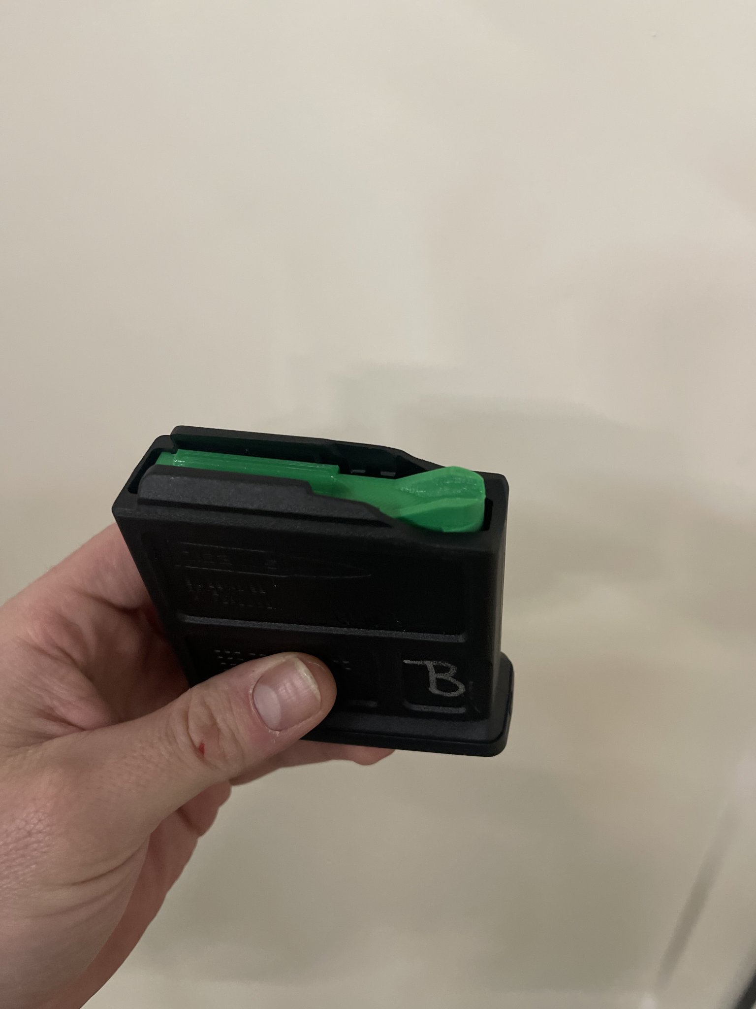

My son and I designed a follower for the cross. I couldn’t stomach the extra cost of the Magpul mag from sig for the extra cost. Now, I have converted some other mags so I can single feed if I have to.
Would you be willing to share the .STL file? I'm going to start printing my own carbon fiber mags at some point this spring.

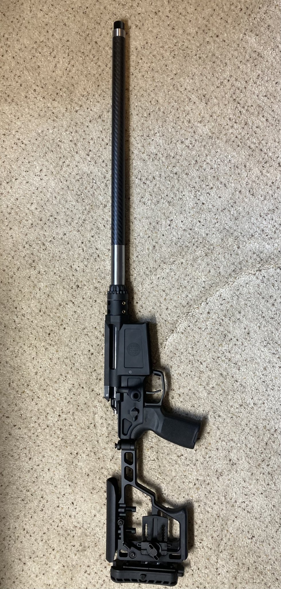

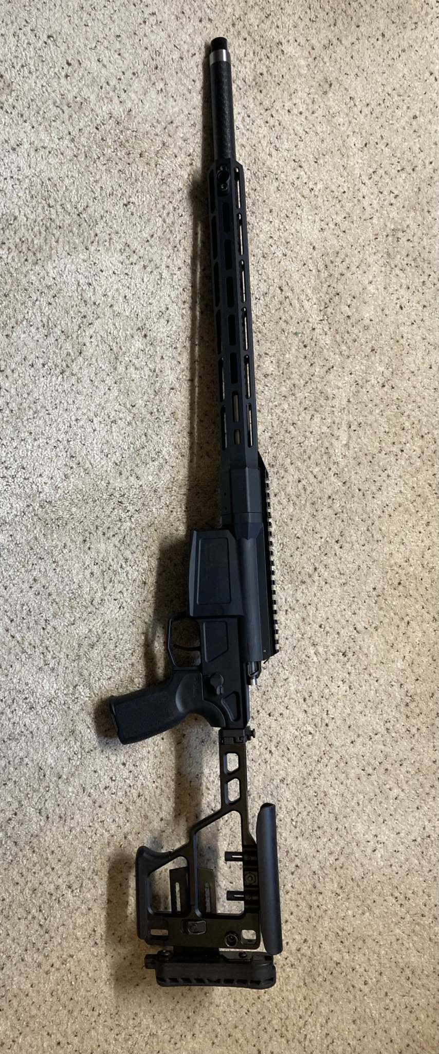

Installed a new barrel today. 24” heavy. Looks weird on a cross but I can’t wait to shoot it.

There was talk earlier they were hard to find or scavage, so just wondering how you sourced it and what wrench used etc.
Apologies if this is dumb Qs !
I know there are people working on making aftermarket ones so they can send out complete barrels but I don't think any have hit the market. Dave Tooley had some OEM ones from Sig when the guns first came out.
I wasn't planning on using my .308 barrel so I had Mile High cannibalize the OEM one when I got mine rebarreled. Adam said it was a piece of cake.

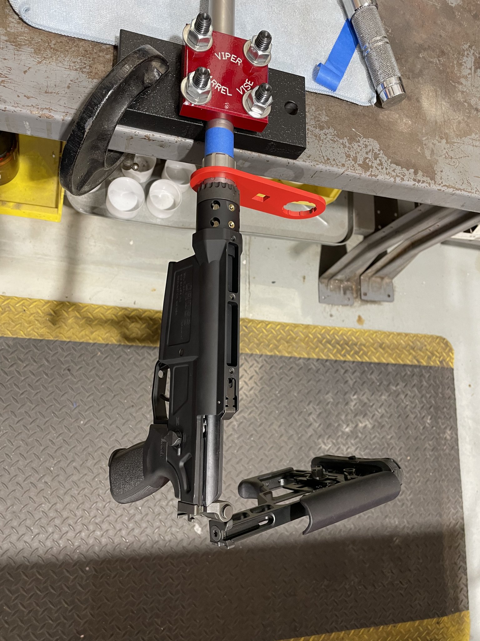

Mine is the original like M4’s. I used a DMPS AR wrench on the extension nut and a 12 point 1-1/6 box end wrench on the barrel nut. I ended up changing the barrel nut to a longer one to install the barrel the way I wanted to.
Like M4 said, it’s very easy if you understand how to headspace a bolt gun.
What does it weigh now? Where did you get the heavy steel barrel?
I don’t have a scale handy but she’s a porker. Especially with the Gen II on it. I’m less concerned with weight than I am length. This way I can fold the stock and it’s not too long for my pack.
The barrel is from International Barrels. This is pretty much a Tikka prefit barrel. The barrel nut I used is also for a Tikka prefit. Tikka and Sig use the same thread size, 1”x16 TPI.

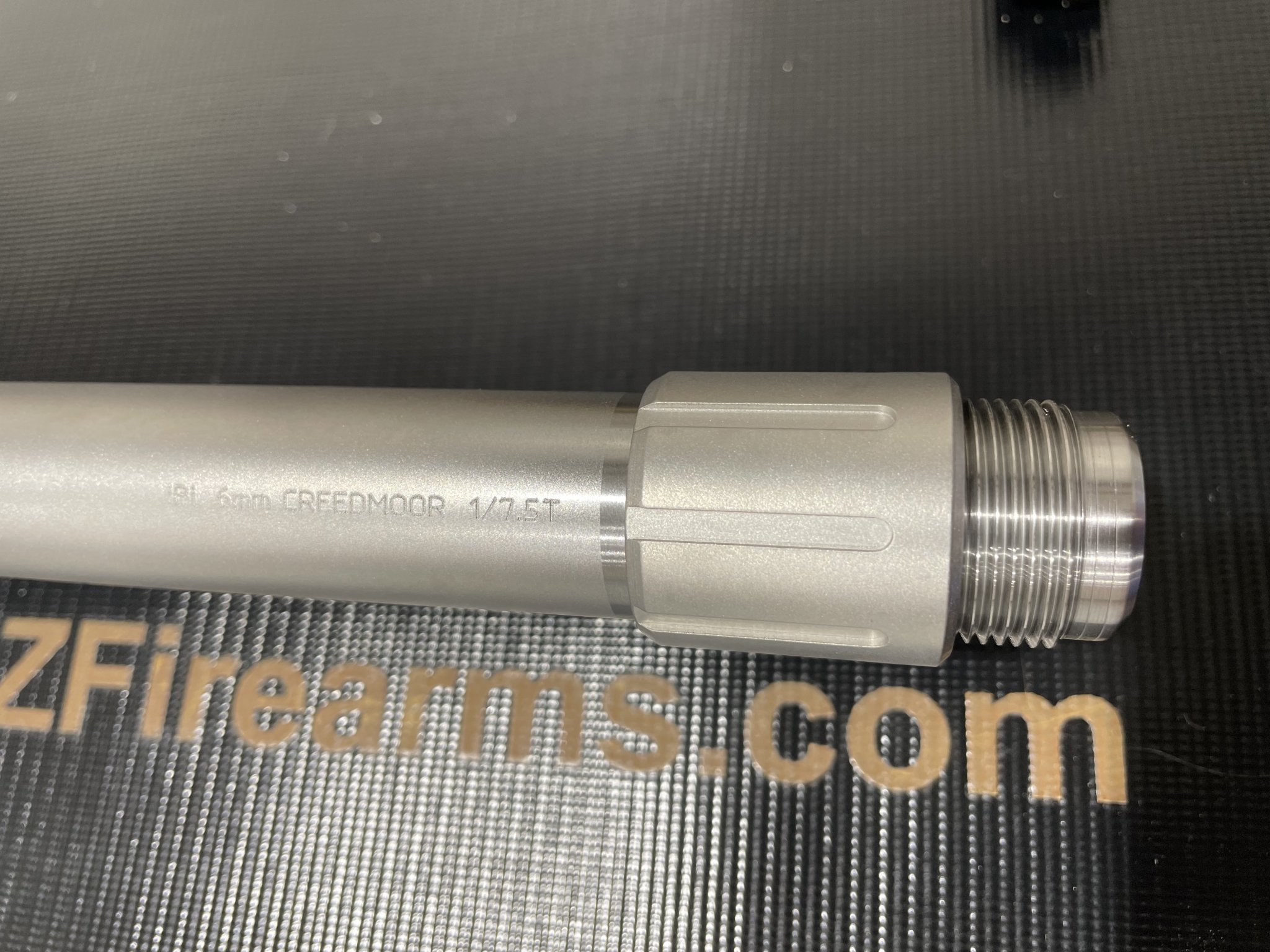

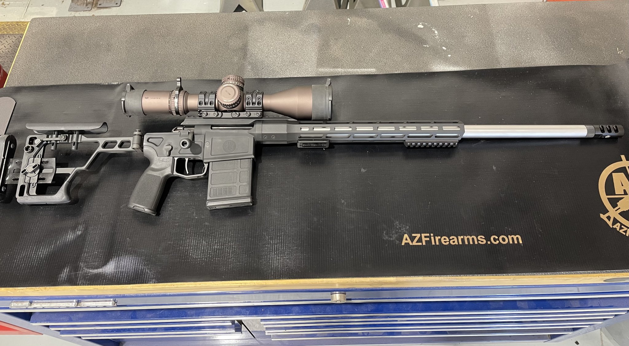

I bought a Sig in .308 last year and I just couldn’t shoot well with over the counter ammo to less than 1” at 100 yards (I am spoiled with my 25-06 and 300wsm I guess) I tried Hornady, Remington, Winchester and PPU. 150gr. 165gr. 180gr.
During Thanksgiving weekend I got notified that IBI from Canada was running a sale on their barrels and I ordered one for the Sig, it’s a carbon 20”.
I had Karl Kampfelt here in Sandpoint ID install it for me.
I need to put the scope back on and can’t wait to try it, will report back.
Will you post the .stl on a site like Thingiverse so those of us with printers can print it? I've been meaning to design a copy of the Sig follower myself, but haven't had time.

Any mag in particular? This one is for the Magpul AICS. I have an mdt and it looks stamped closed so I’m not sure if I can open it up to change out the follower🤷🏻‍♂️ I’ll look at it more though.
AICS style metal mags come apart with the floor plate by sliding the floor plate forward. The follower and spring will come out through the bottom once removed
I'll start working on it. I must have not looked at it too close. it looked like the bottom plate was going to be a pain to remove so I set it aside. I prefer these mags in my other rifles so I'll put it high on my list to dissect.
