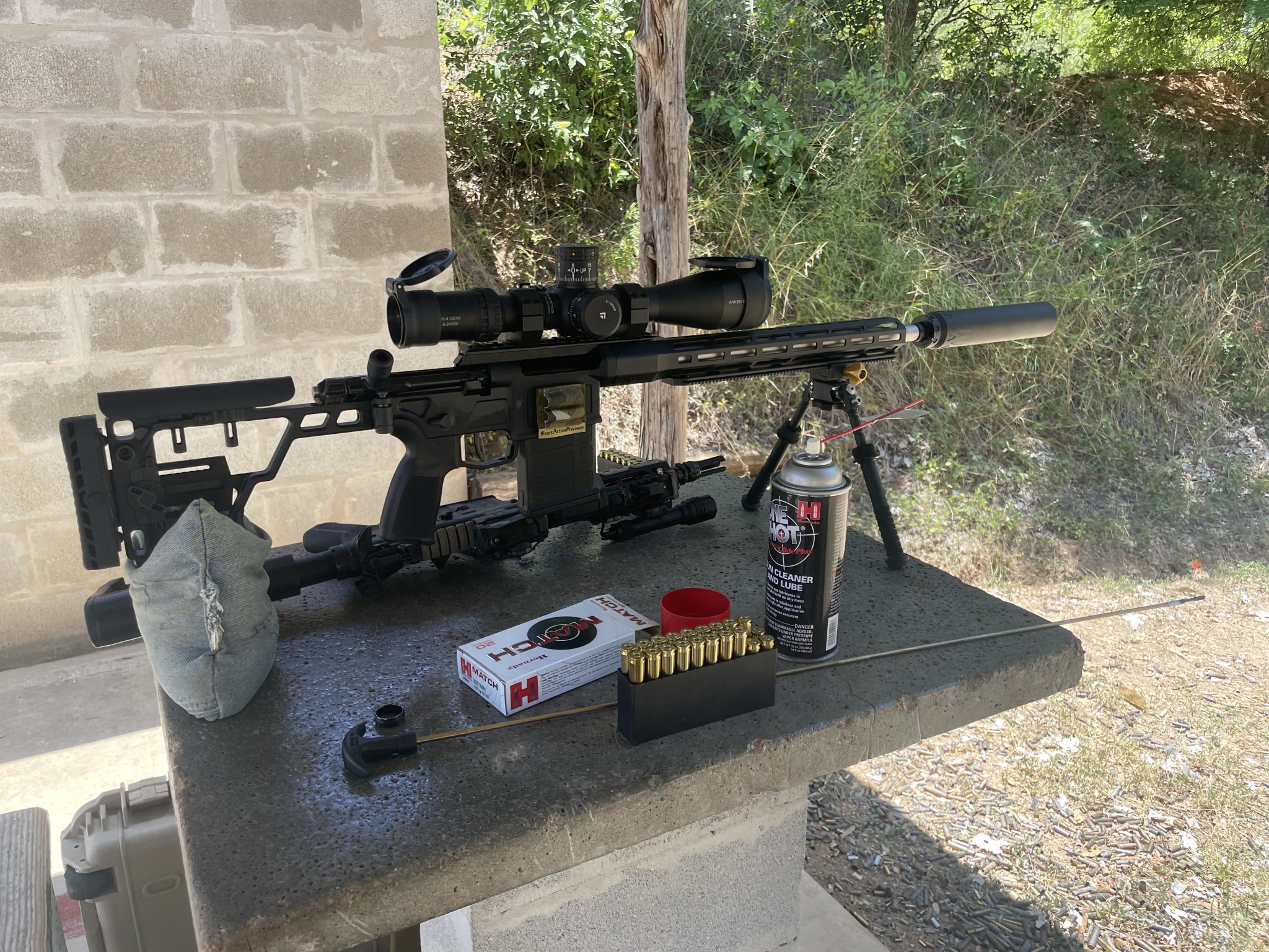

Shot 40 rounds through the Cross and the stock barrel today, bolt head pic below, no cleaning. Was hot as dogs balls in Alabama out there today but enjoyed shooting it none the less. A bit different than the AR10 and this'll take some rethinking on shooting technique. It's brutal compared to the gas gun but I like it! I started to get the hang of it towards the end and will be ordering a few 10 round mags so I'm loading less and shooting more, LOL. Needed a bigger rear bag too. Groups were all over the place and it almost made sighting in the scope pointless. The last 20 started to see the group sizes fall but I'm not there yet. I can now see why adding weight on a chassis gun makes a difference.

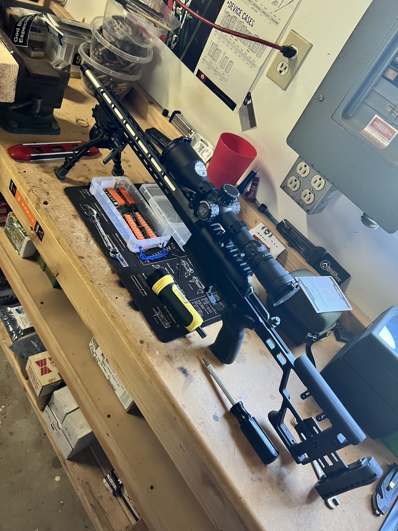

Brief update. I stopped in to check on the rifle as I hadn't heard anything. The gunsmith there said that within half an hour of him calling, both Schnee's and CarbonSix called (lead engineer from CarbonSix) and they're sending an RMA and label to have the barrel shipped back. They most definitely want to look at it and no expense out of my pocket. So excellent customer service! I was really shocked as was the gunsmith. He went over how they set headspace and everyone on the line agreed it was done correctly. The way they cut the chamber (and this is above my pay grade) it should be impossible to overcut. So they want to see the barrel.
So now the not so good. I wanted to swing by and pick up the rifle and shoot it at the range this holiday weekend with the original barrel. I have a brand new Cronus BTR to put on it and I want to see how well I like it. Anyway...he double checks head space and barrel nut torque and shoots two rounds at their indoor range to make sure everything is working perfectly. Brass looks perfect. Handing me the rifle, I go to close the stock and it won't close. Looking at the bolt handle, it's not rotating all the way down as I can see a gap at the base. It's just enough the stock won't lay flat and it hits the handle. Anyone ever experience this? I'm guessing it's a headspace issue but he fired two rounds and the brass looked fine. I have the cases and there don't appear to be any issues. I haven't slapped the comparator on them as I have fired brass I shot pre-barrel swap attempt. I ended up leaving the rifle so they could double check headspace. Any other ideas? They did take the bolt apart while setting headspace but it really only goes back together one way.
Any ideas?
Any ideas?
Issue solved thanks to the Facebook Cross group. The bolt handle was installed upside down. God I hope they caught that prior to taking the barrel off and head spacing the barrel again! I should have caught it too but haven't spent enough time to catch that visually.

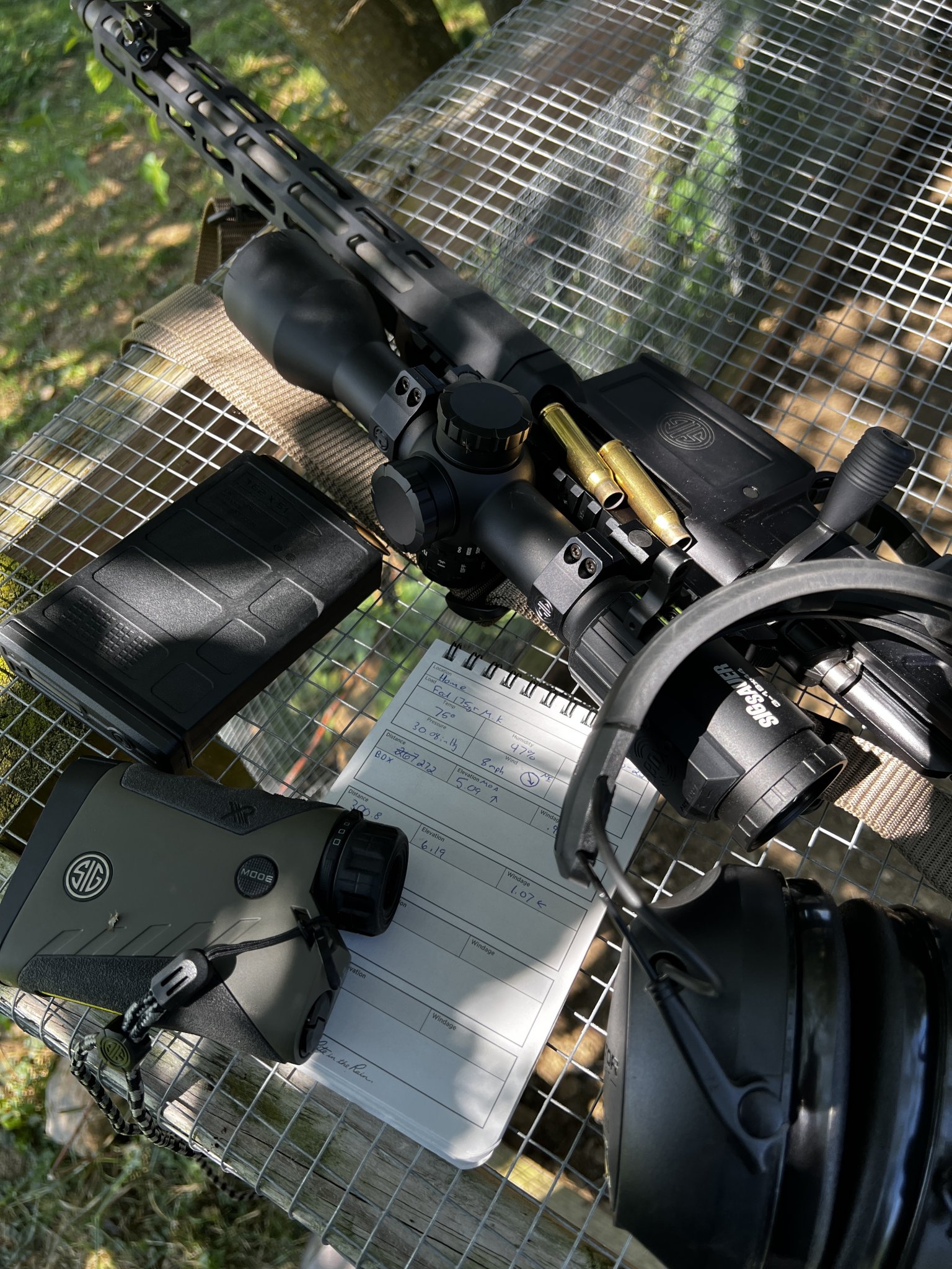

Hope your day went better than mine. Went to get some velocity numbers with the stock barrel and dial in the new scope. Temps hit 105F and it was brutal out there. Short version, the recoil of the 308 was enough to move the scope in the mount despite being torqued correctly and used blue thread locker as well. Ended up chasing my tail for quite a bit as a result.
Using PMC X-Tac to break in the barrel and get chrono numbers before switching over to the CarbonSIX 20" barrel. They state 2800fps but no idea what barrel length they're using to achieve those numbers. Averaged 2676 over 27 shots.
