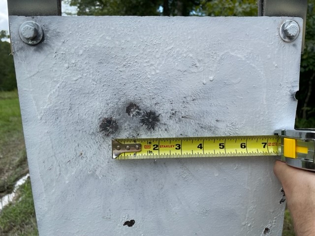

Managed to get back out to the range today to try and mostly finish break-in. Between last weekend and this weekend, I ordered two different types of copper remover, Bore Tech and Sweet's. Sweets seems to work more quickly but I stuck with the Bore Tech as there's no smell.
I now have 75 rounds down the CarbonSix barrel and I've been following their break-in procedure.
Today I finished up 65 rounds of PMC X-TAC and I shot 10 additional rounds of a plinker hand load I have that produces sub-MOA in my gas gun.
Groups were sort of all over the place although my initial four volleys were almost through the same hole. Each time I cleaned, they'd sort of open up again and at this point I was cleaning every 5 rounds, then 10. I started to notice they'd begin to group after one or two down the barrel. So the last strings were 10 shot groups, cleaned after the 1st ten and I then moved on to my hand loads, no cleaning as shots were grouping. I shot without the suppressor for most of the day as I wanted to eliminate any variables. I used the OSS muzzle brake which is extremely effective as the gun likes to jump otherwise. Pretty much remained on target and was very controllable.
Now the hand loads are nothing more than Hornady 150gr. bullets (not even the match, just the cheap ones!) over 4064 in LC brass. I didn't have my scope dialed in for them so I threw on the suppressor. I took five shots to somewhat dial in the scope then moved over to my last clean spot on the target. I have one flyer but it is what it is. I could have likely shot better but given the heat, the mirage through the scope, etc...just glad they're starting to group! I have another 200 rounds of PMC inbound that I'll use to finish break-in and clean the barrel every 25 rounds or so. So the last 30 rounds, no cleaning.

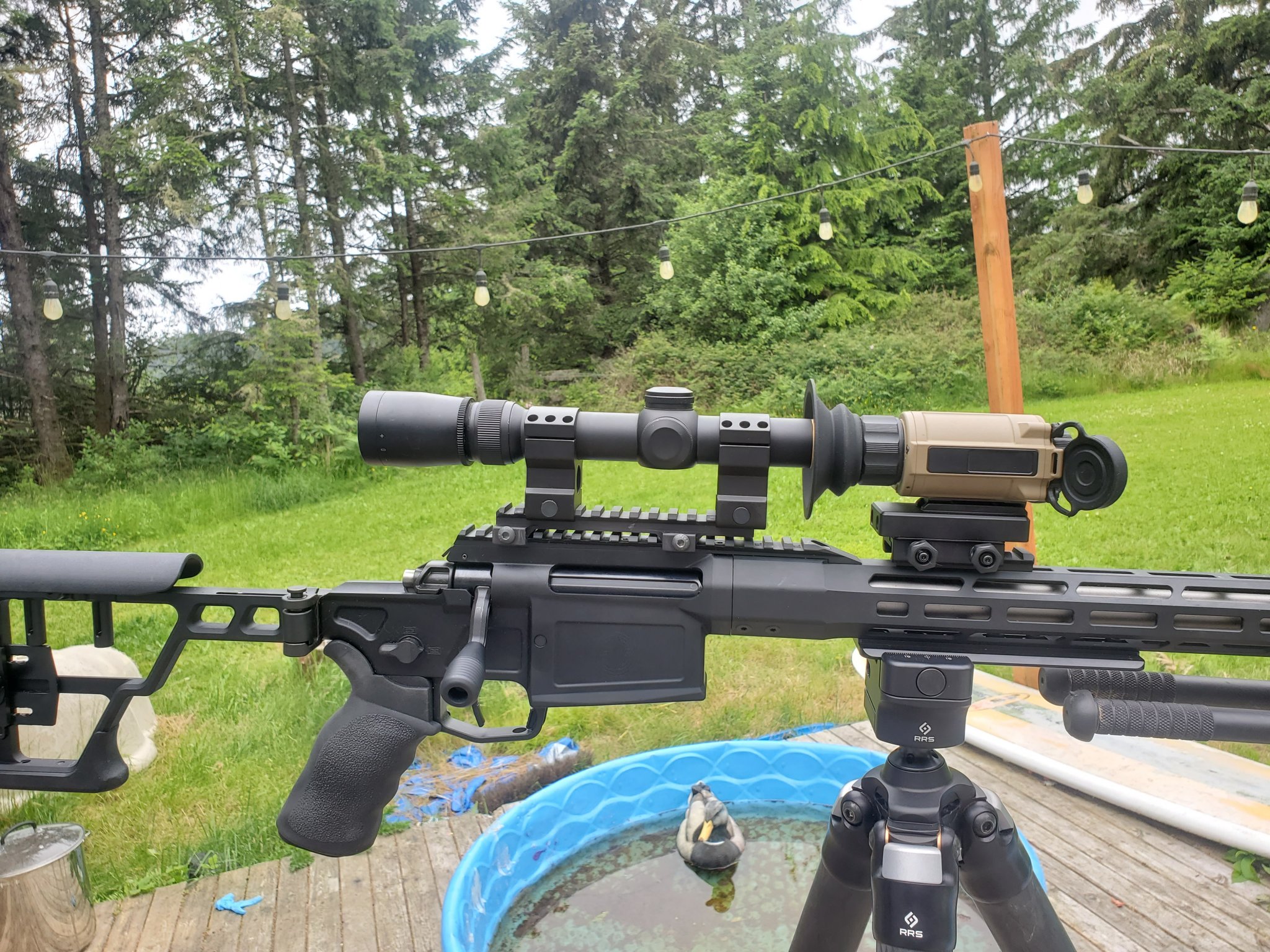

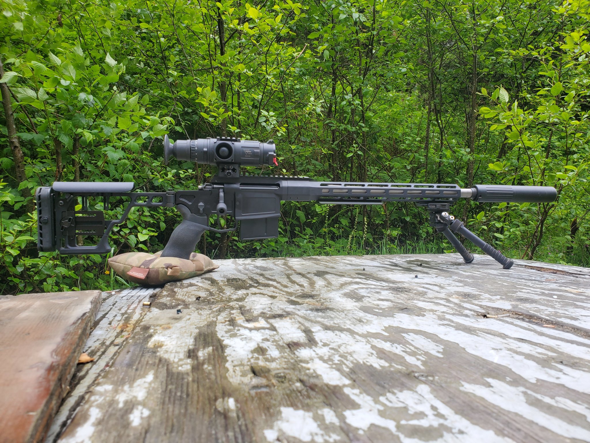

Has anyone run clip on thermals or night vision devices on these? Looks like only way is to use a long mlok rail…seems not the best of ideas?
I've got a Burris clip on. I run my scope pretty low, so to get the thermal as low as possible I'm using a low-profile M-lok picatinny rail from Arisaka. I don't really like the tiny bearing surfaces of M-lok for anything that holds weight and has to deal with recoil, so instead of the standard M-lok nuts I use much larger backing plates for the thermal mount and the bottom pic rail that I use to mount the rifle to a tripod.

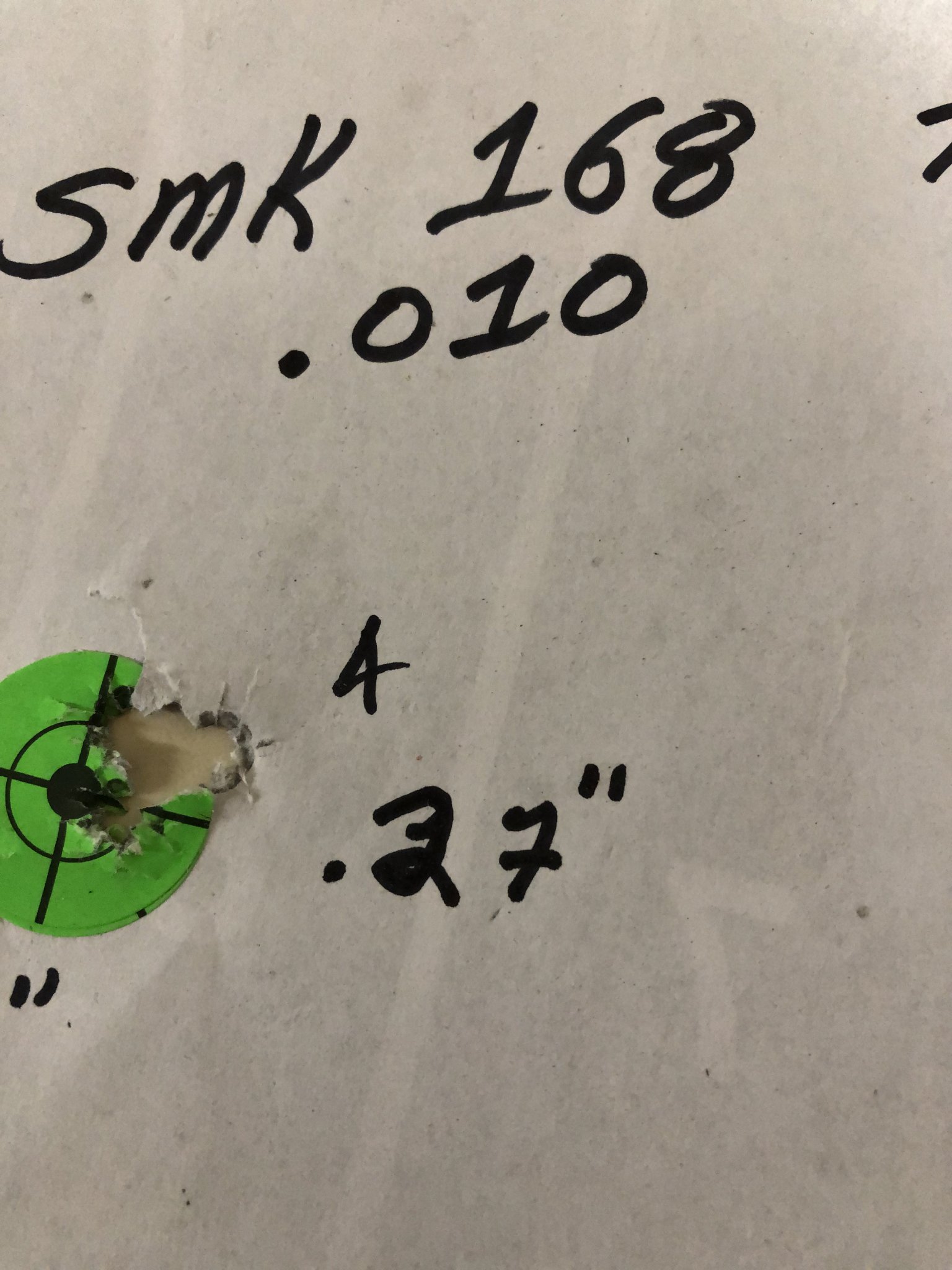

Just for others who may hand load, I measured jump using a few different bullets. Again, this is with the Schee's 20" .308 barrel. I'm not going to list numbers as it'll vary from gun to gun and I'm assuming will also change with head spacing. My gunsmith said it came in on the tight end of things but within specification. On my Hornady comparator, with my calipers, I'm now seeing 1.628" on second firing cases. Conversely, my POF Revolution DI is seeing 1.636".
So here are the bullets where I can get the jump to the lands at an acceptable level (.020 or less) and still be under 2.865 OAL or slightly under.
-Hornady Match 155gr. BTHP #3039
-Hornady Match ELDM 155gr. #30313
-Hornady 180Gr. SST #30702
-Hornady 150Gr. SST #30302
-Sierra 155gr. HPBT "Palma" #2156
*Assuming the 168SMK's would work based on Snafu's post.*
What doesn't work:
-Hornady 200gr. ELD-X, ogive is too far back. I can't get these to group decently less than an MOA in my AR10 either so they don't like a long jump.
I have the Sierra 169 grain HPBT's on the way as well, hopefully those'll work as I purchased a lot of 500. I have a few others I haven't measured yet but will do so when I have time and update this post.
