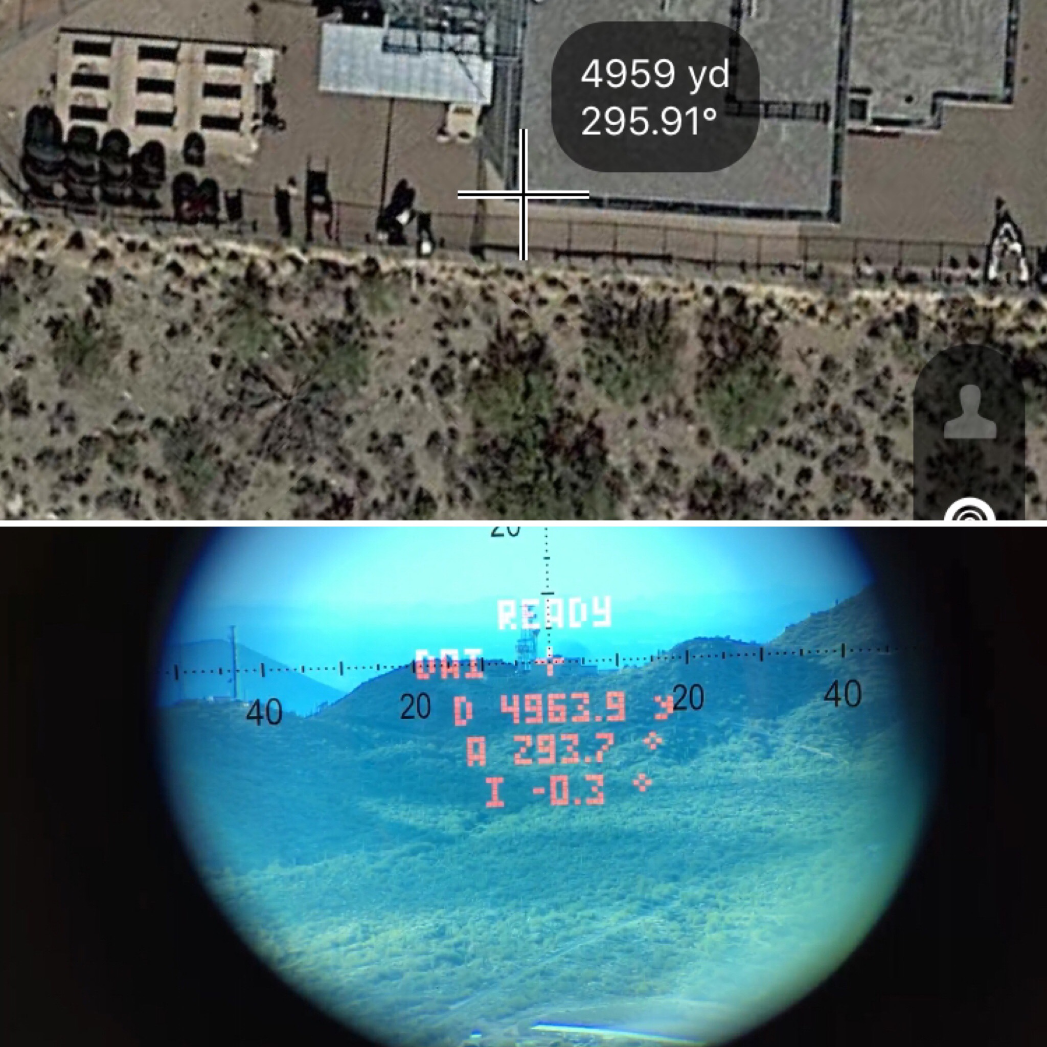

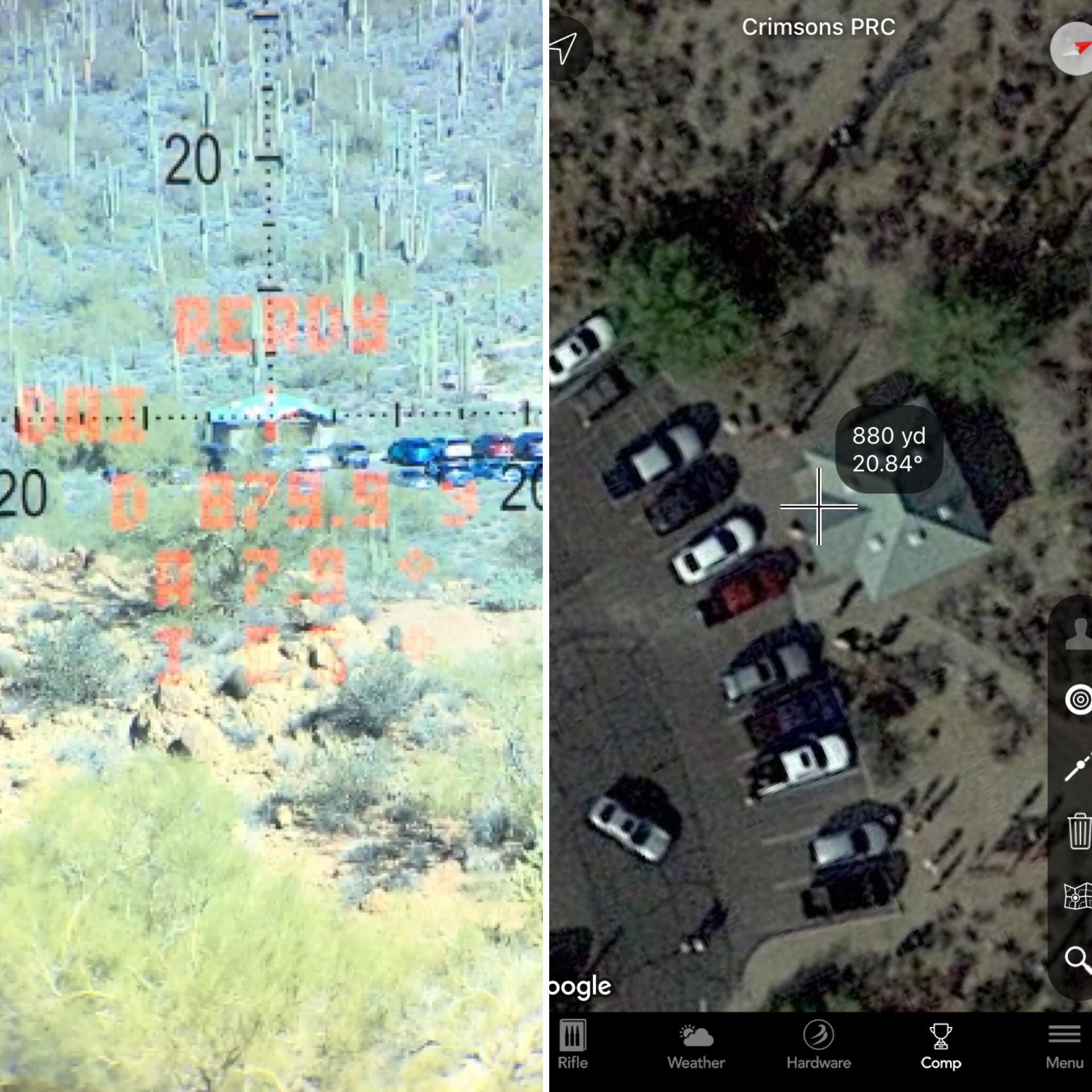

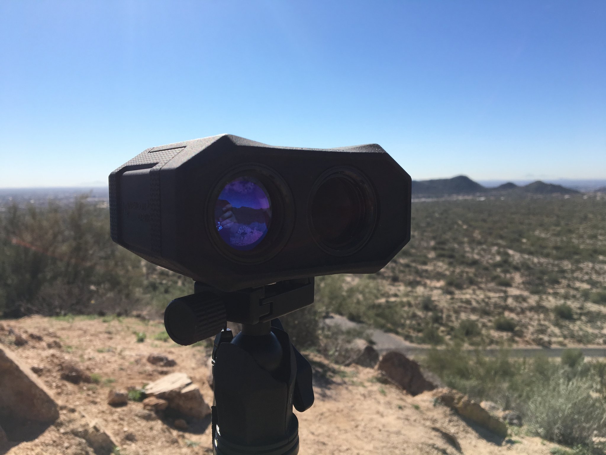

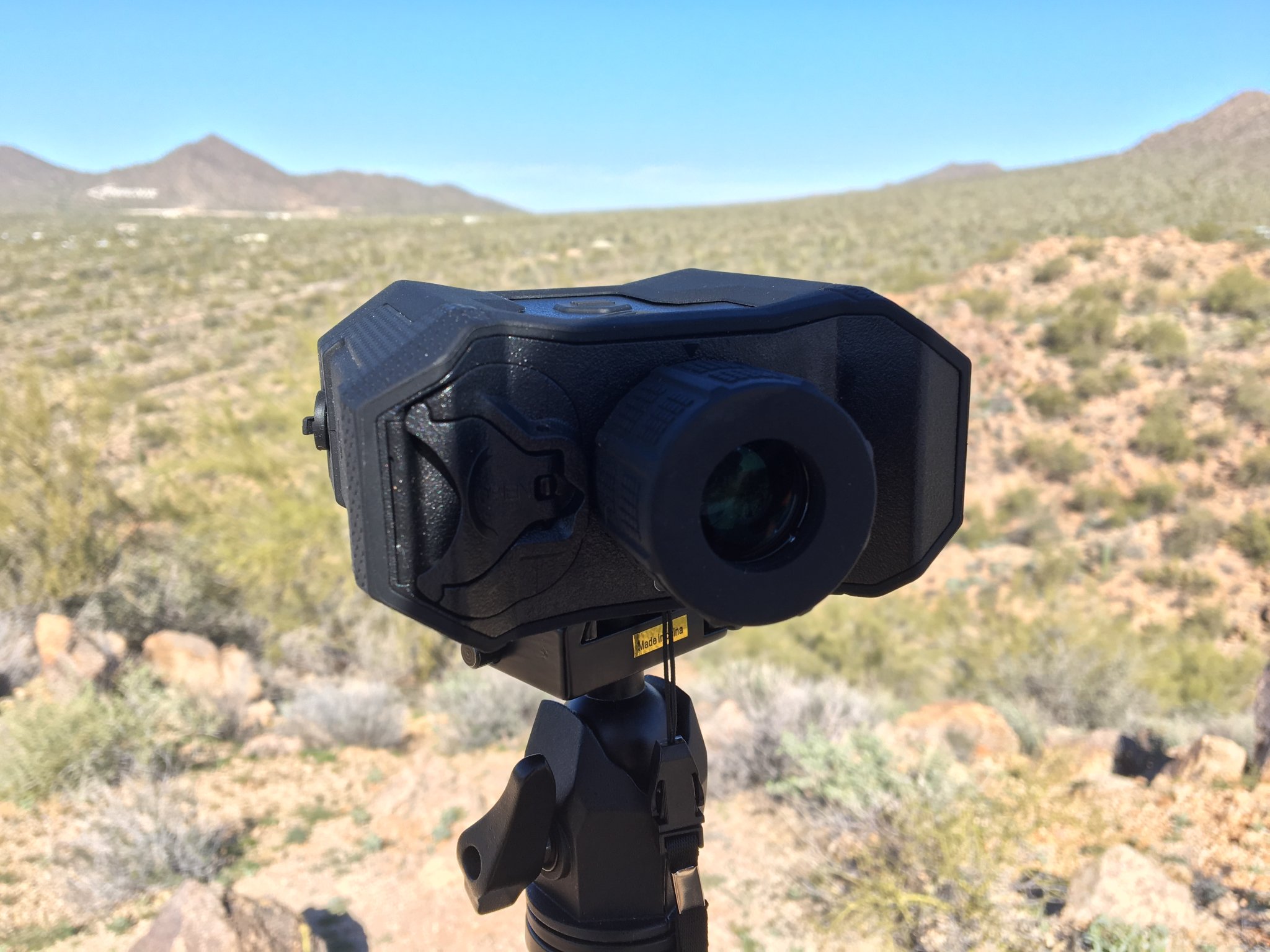

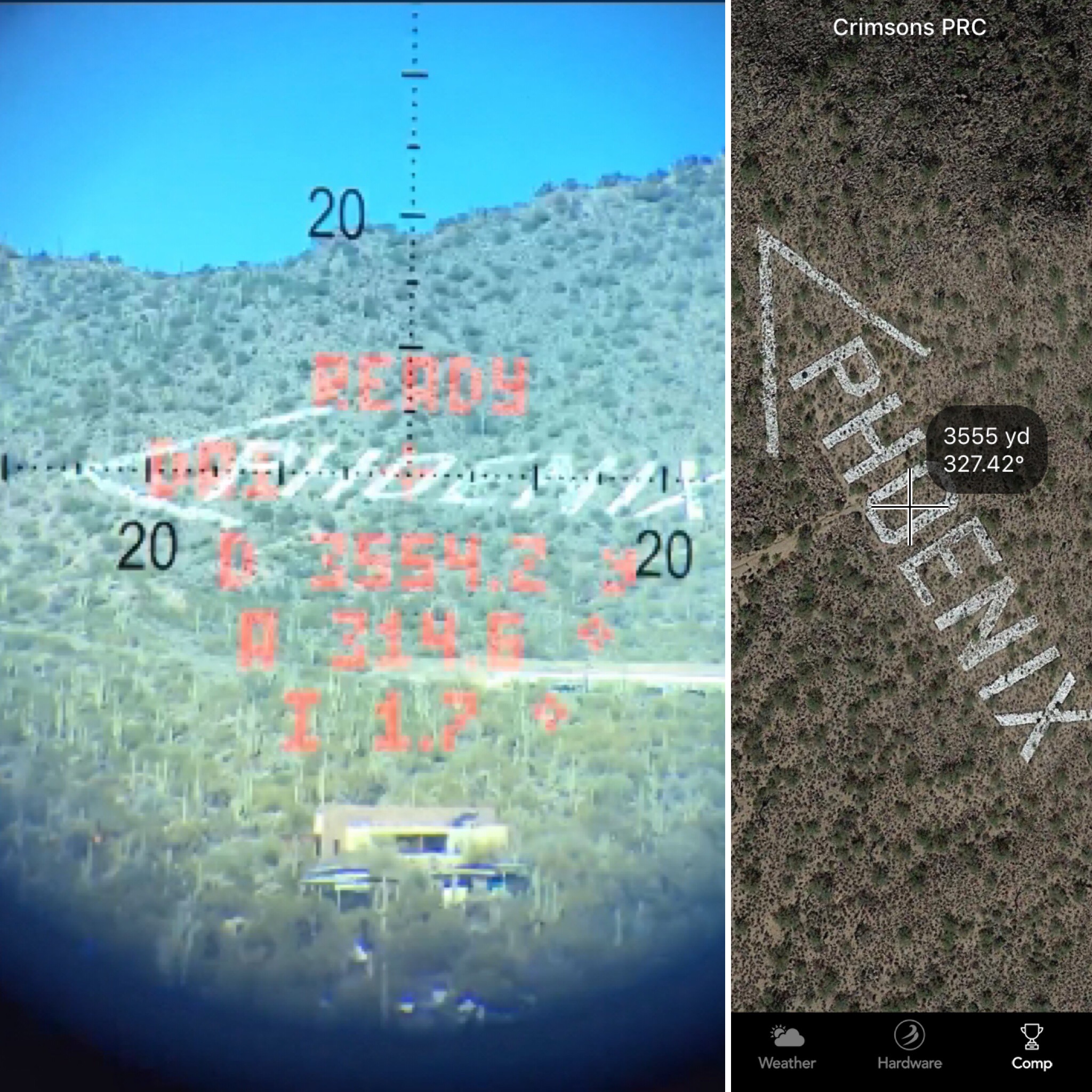

First impressions:
Spent a few hrs or so behind the 35BT model ranging stuff in the bright and sunny Arizona weather. The sun was to my back but working it’s way over head(1100-1300).
Disclaimer: I used a Vortex High Country Tripod so stability wasn’t the greatest.
Overall it has the ranging capability of a PLRF25c but for around half the price.
It has a tighter beam divergence as well.
I need some more time behind it but so far it’s pretty damn awesome.

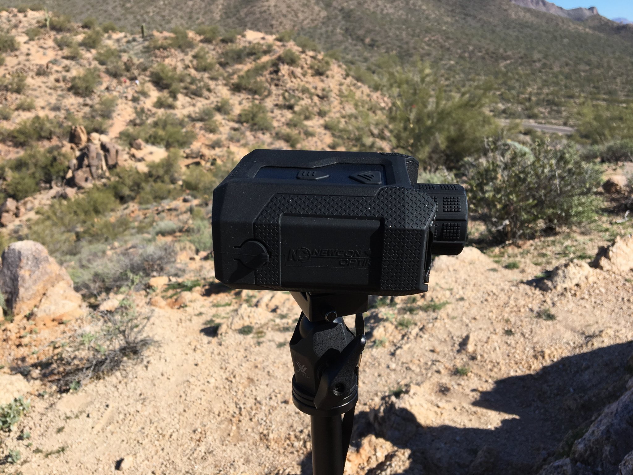

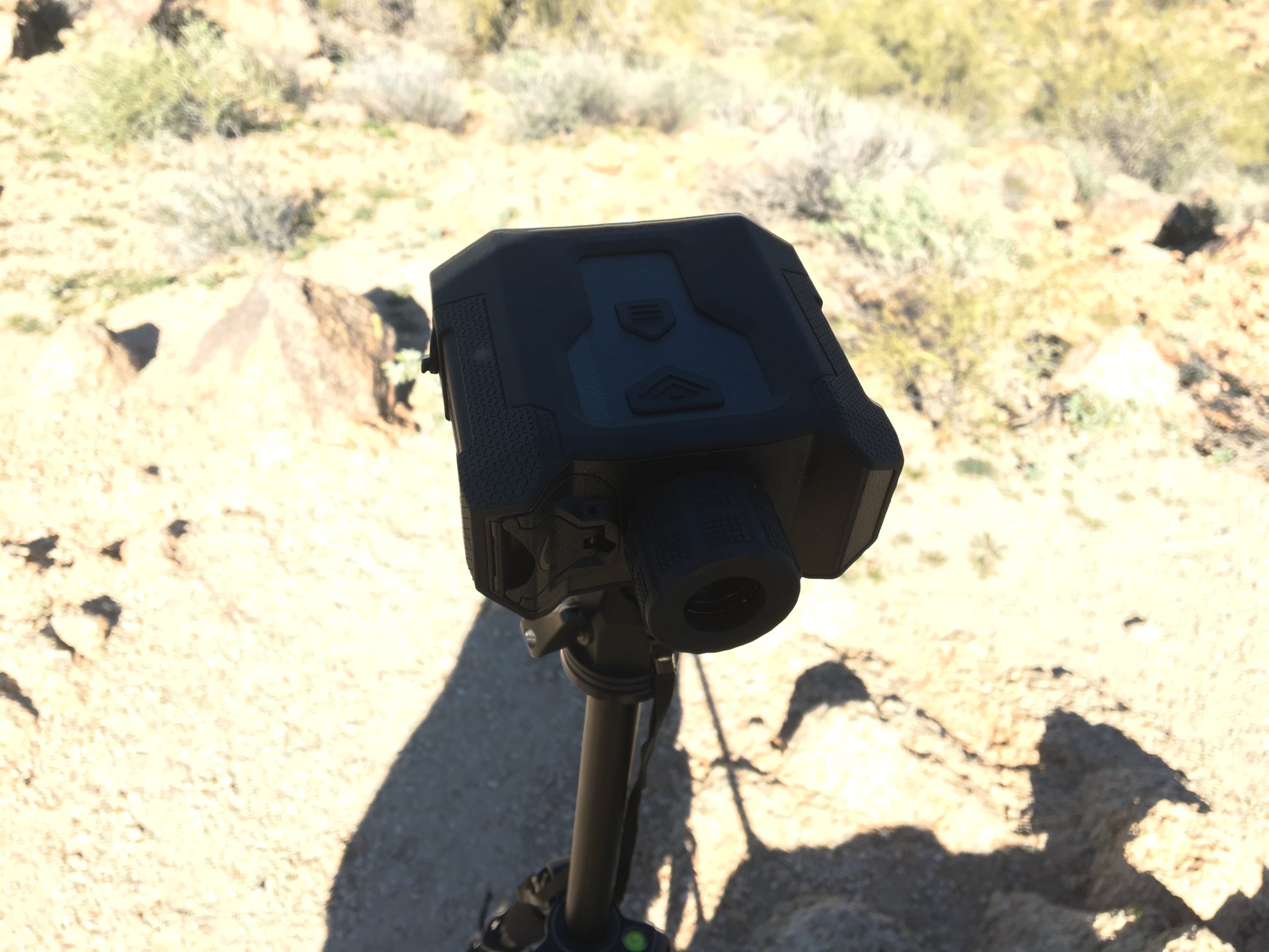

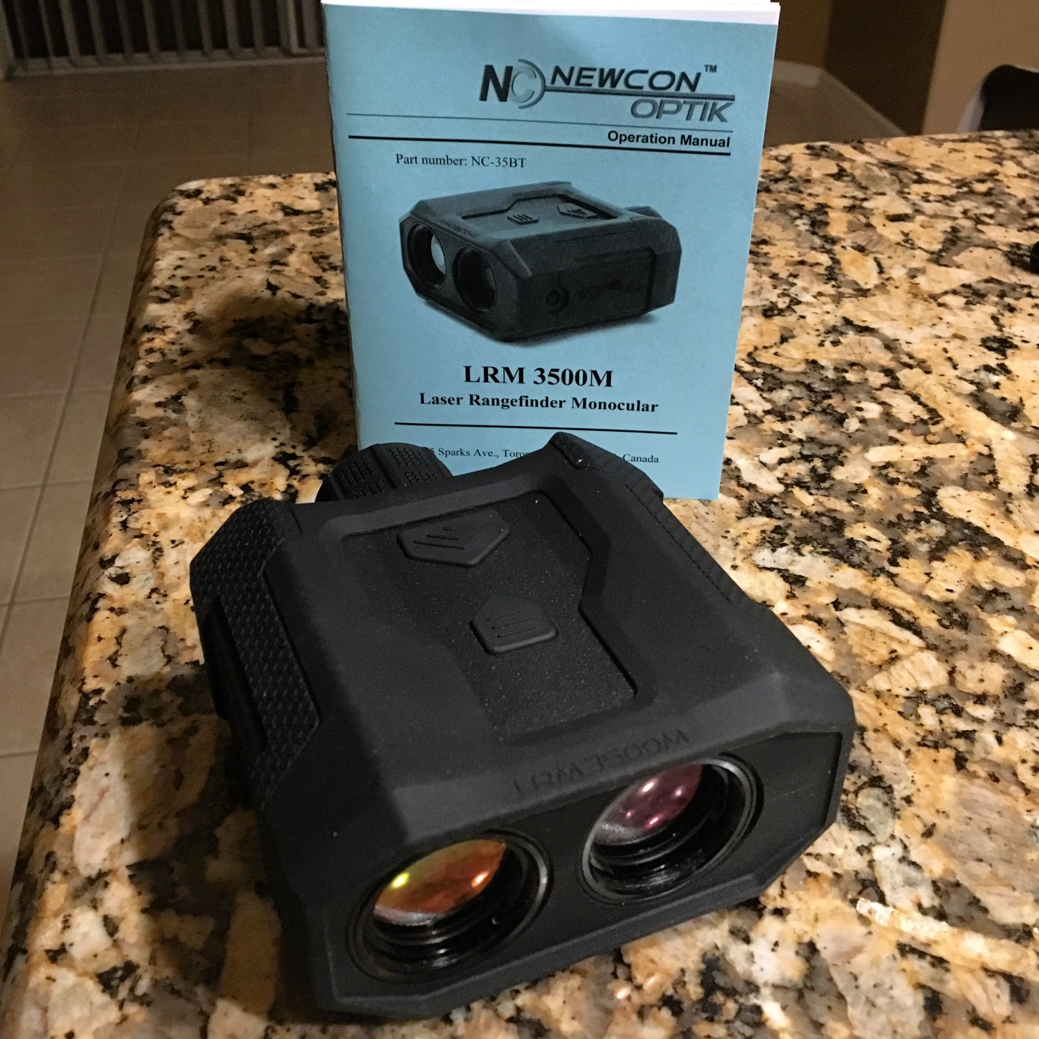

I don’t know anything about NewCon’s older products but the 3500M outer body is made of hard plastic surrounded by an rubber armor case.
You don’t need anything more than that unless you’re a JTAC in an assult force.

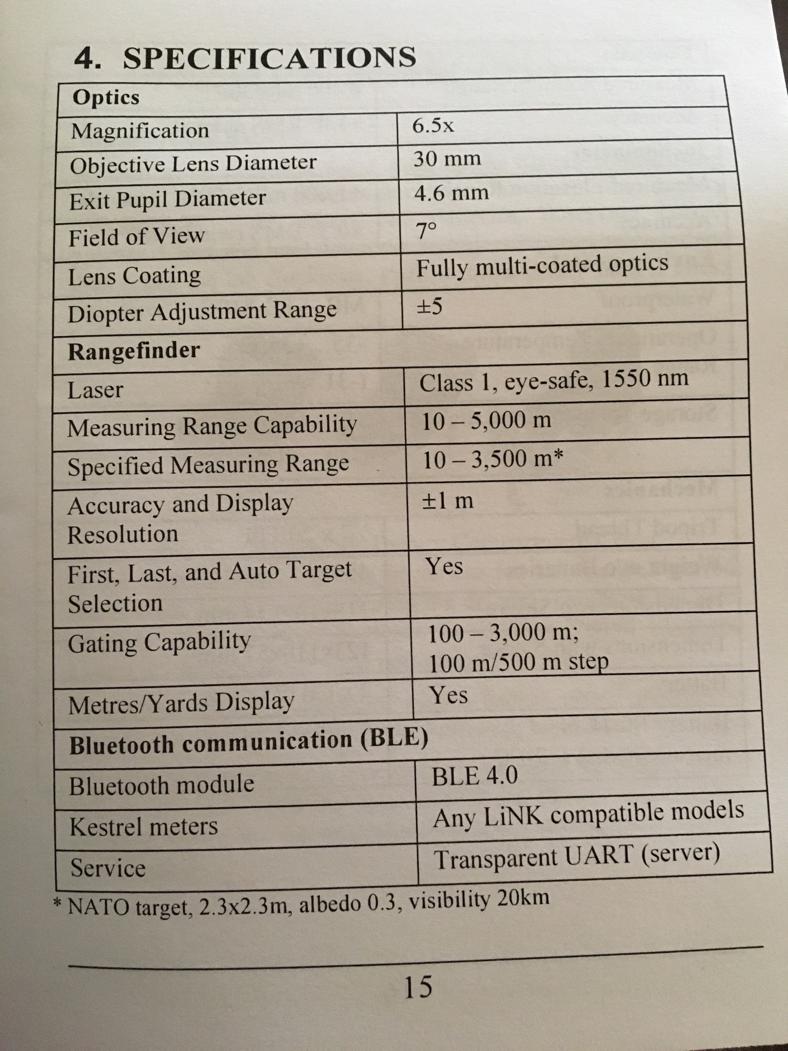

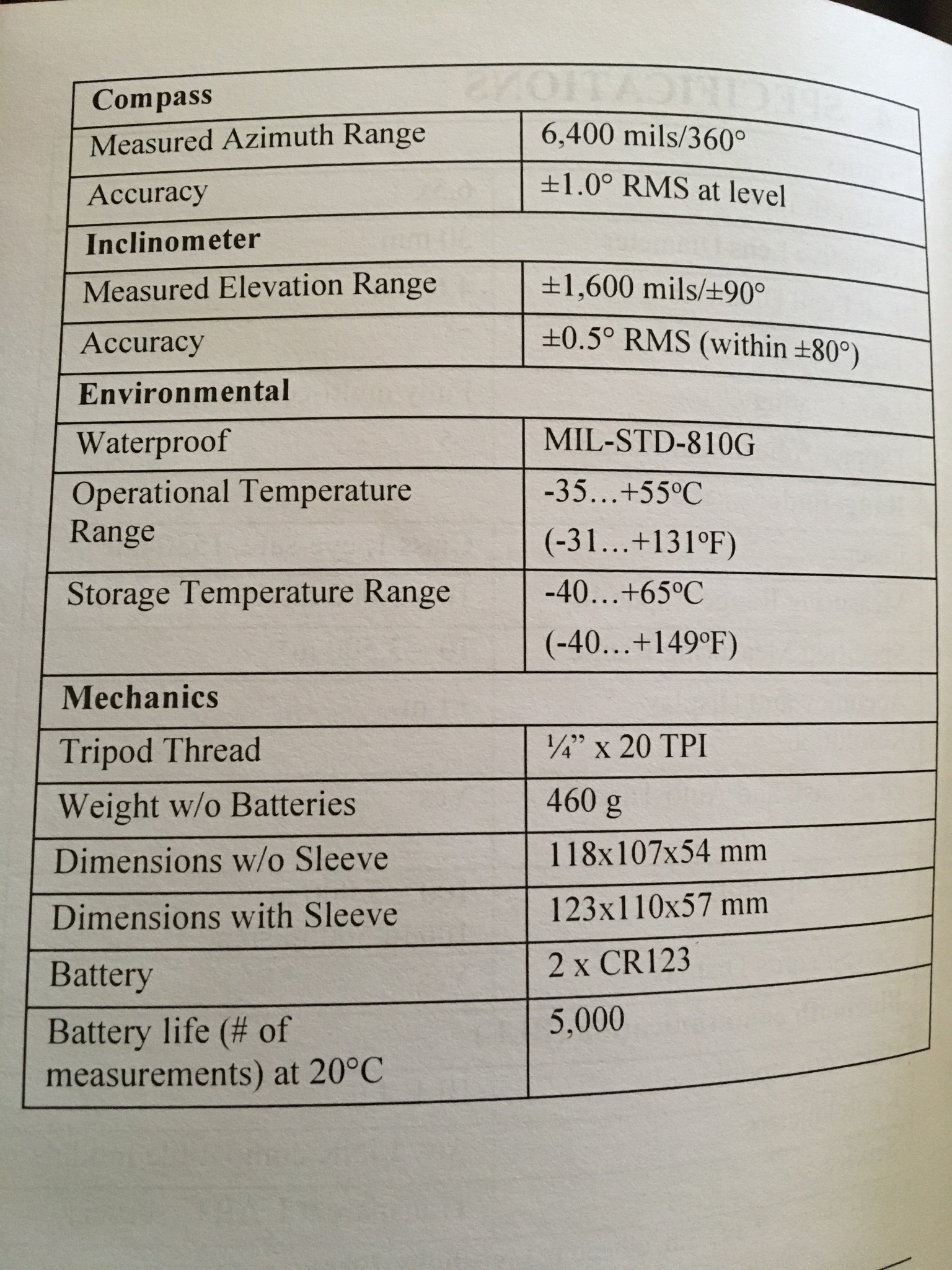

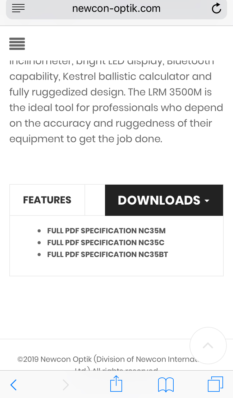

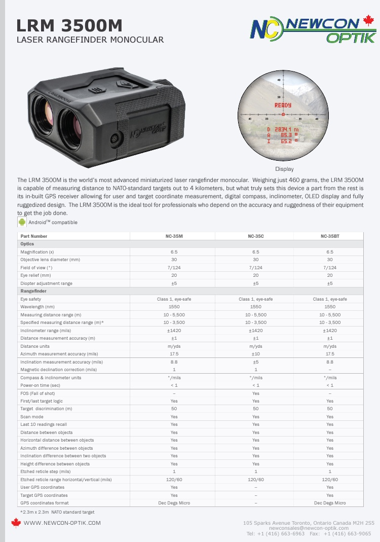

I don't know where you are pulling these sheets from but if it is their website they have really updated it since I last looked at it. I couldn't find any decent specs sheets back then.
So let me get this straight:
Internal compass
5500 m range
eye safe laser outside of NV range
internal gps
cable ports
NV monocular compatibility
rugged construction
low beam divergence laser
good customer service
Priced around 4500 to 5K
Why would anyone buy a PLRF25?

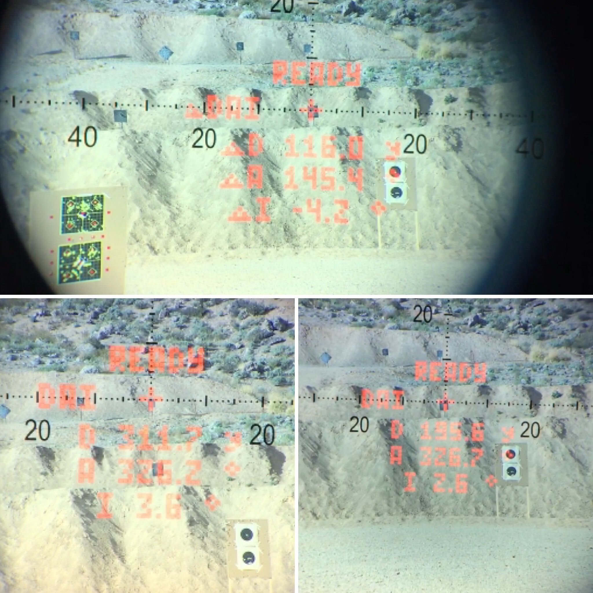

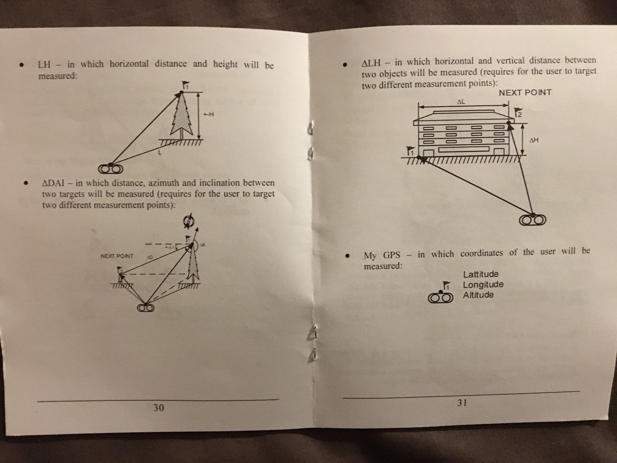

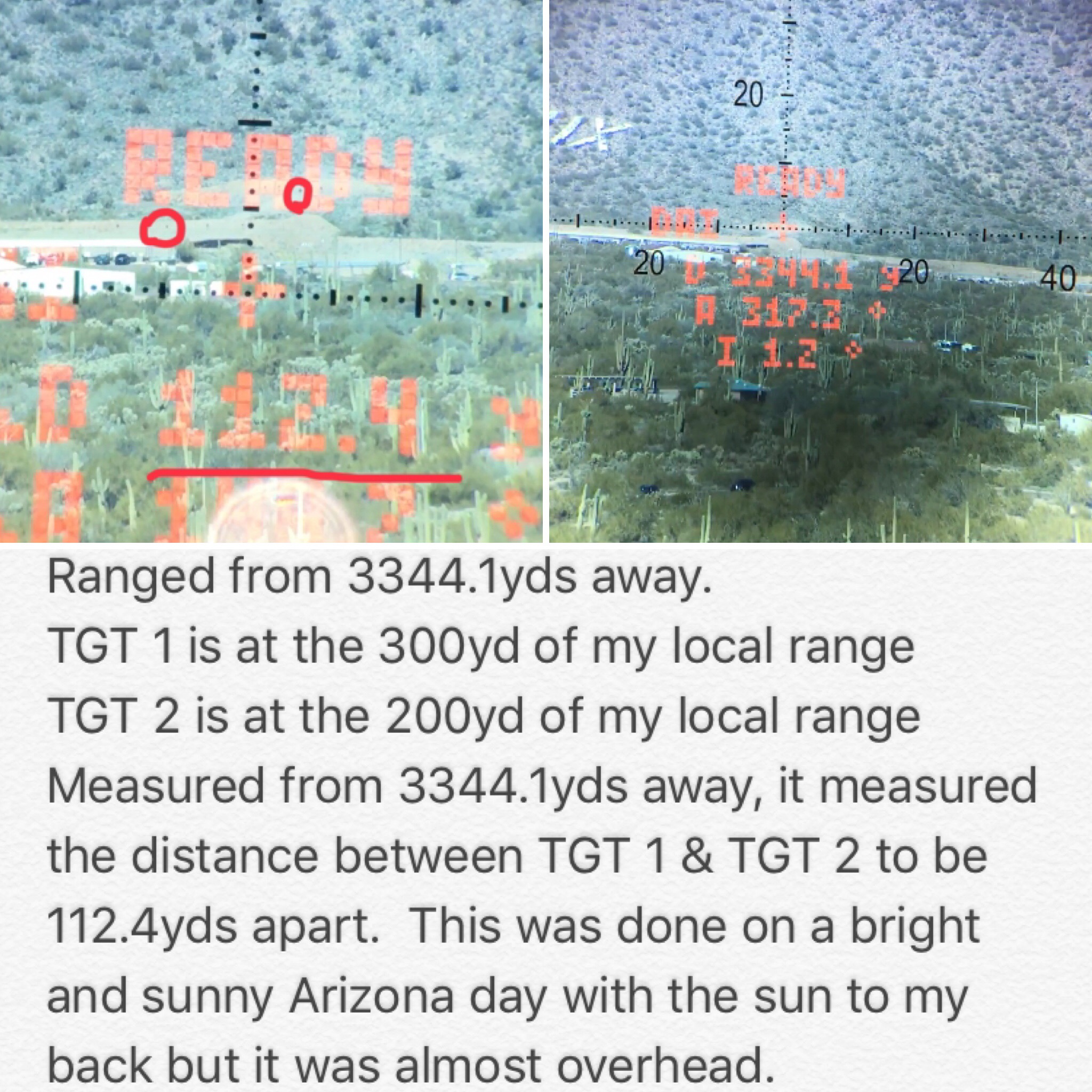

Some distance measurements between two targets.
Top pic is the distance between the two target mode
Bottom two pics are the individual distance of each target

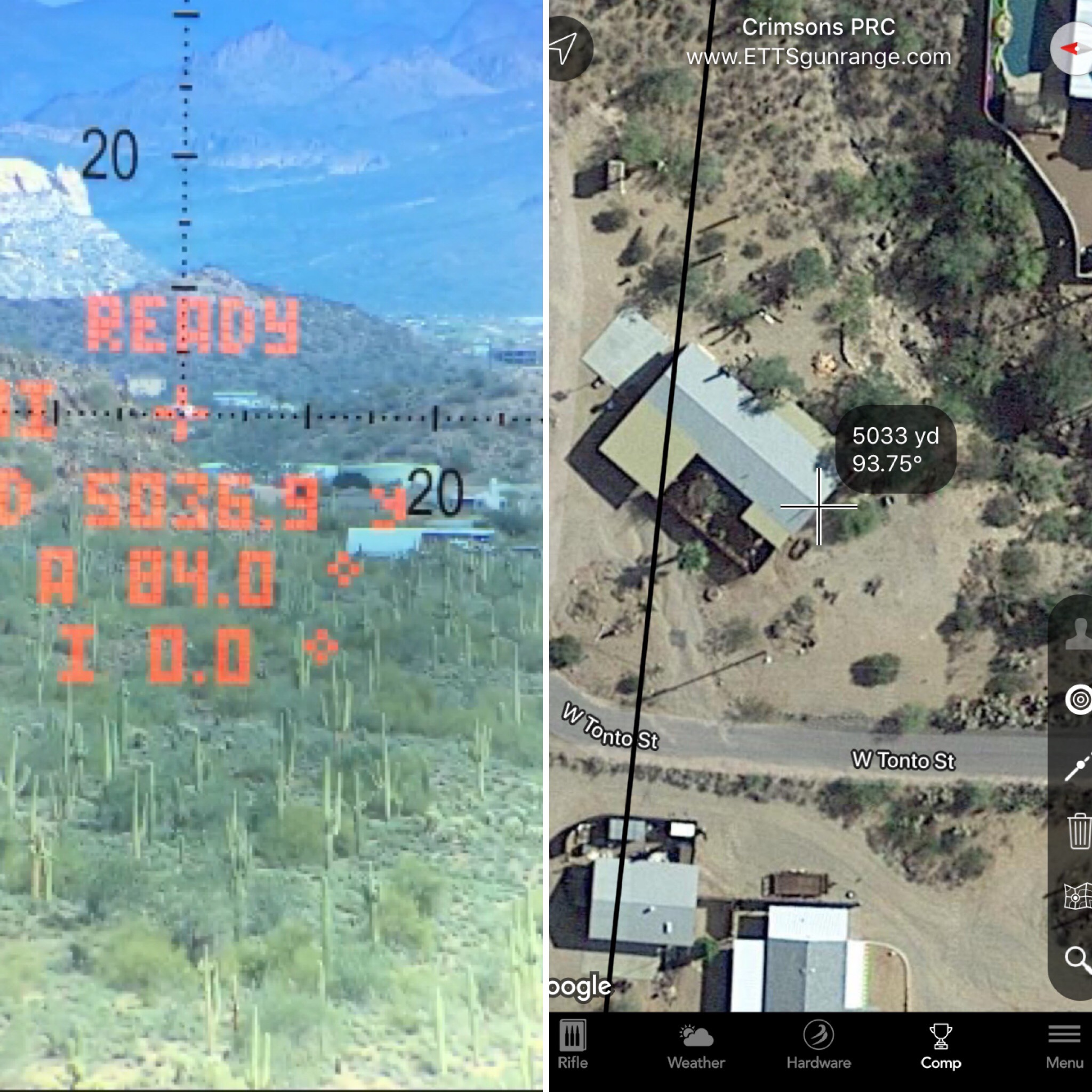

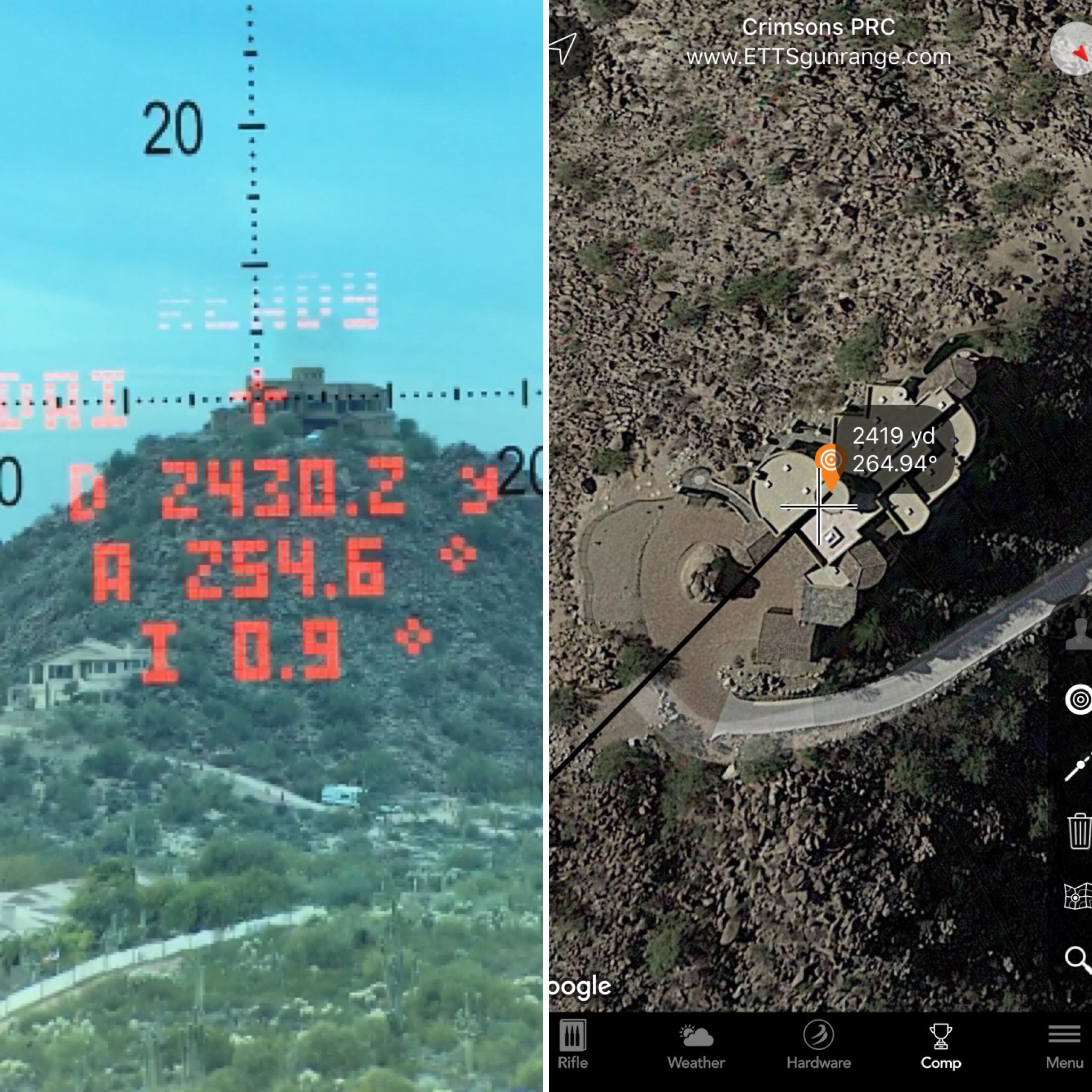

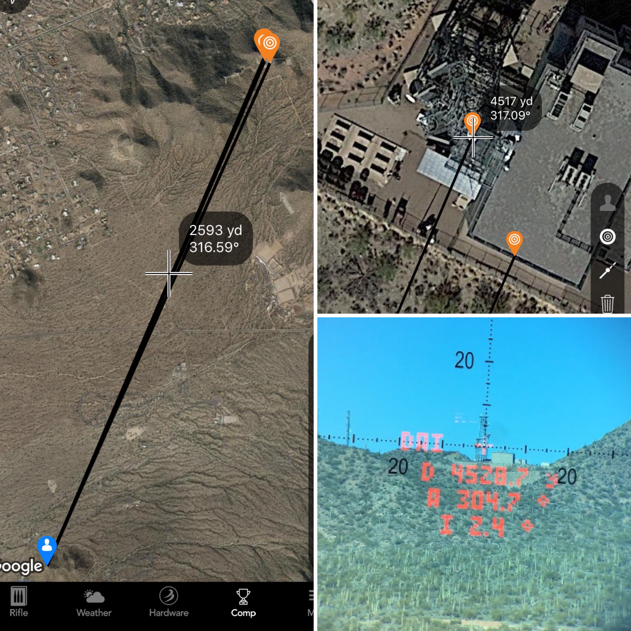

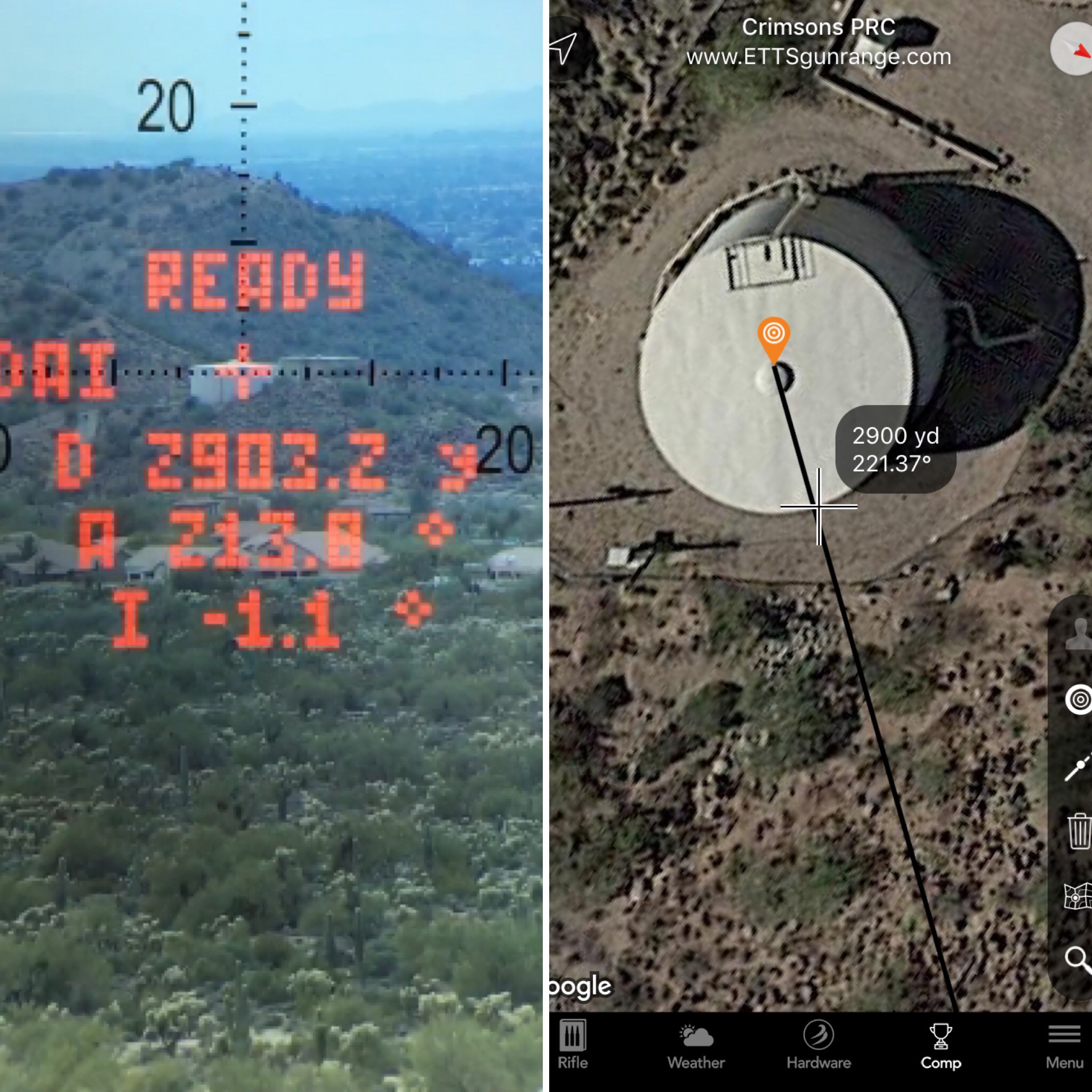

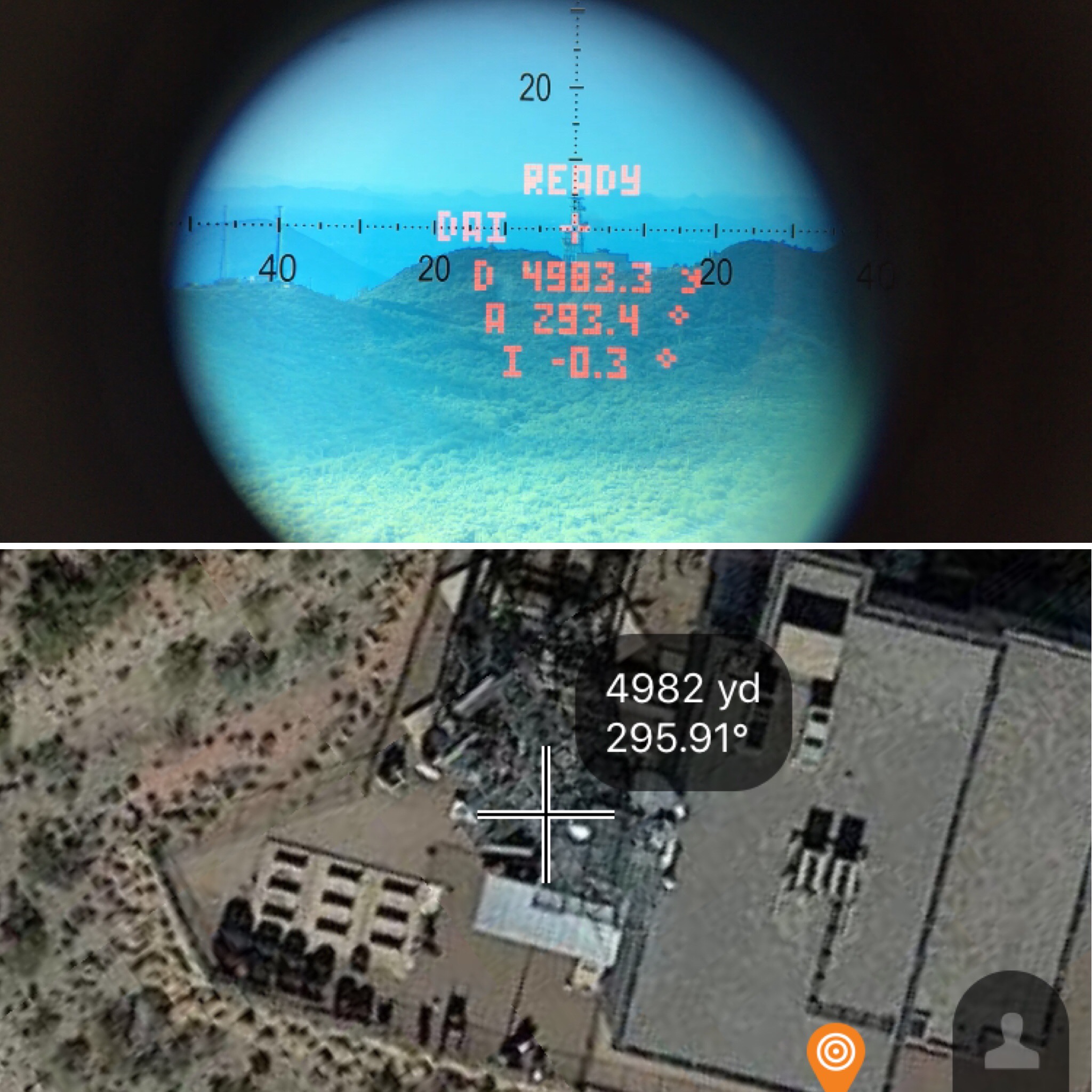

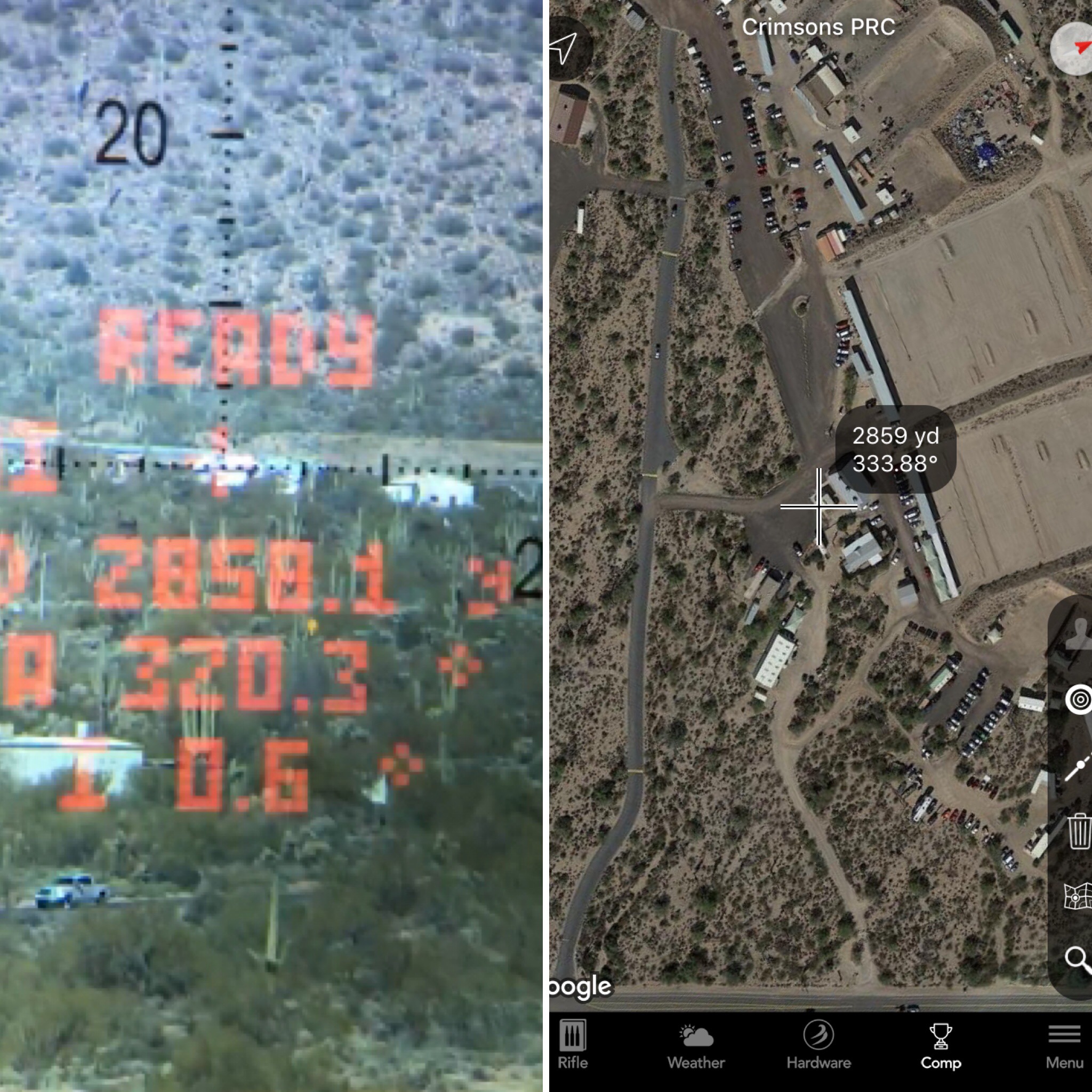

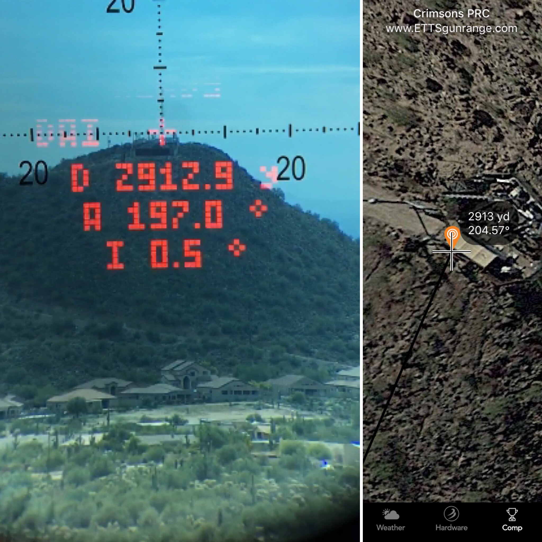

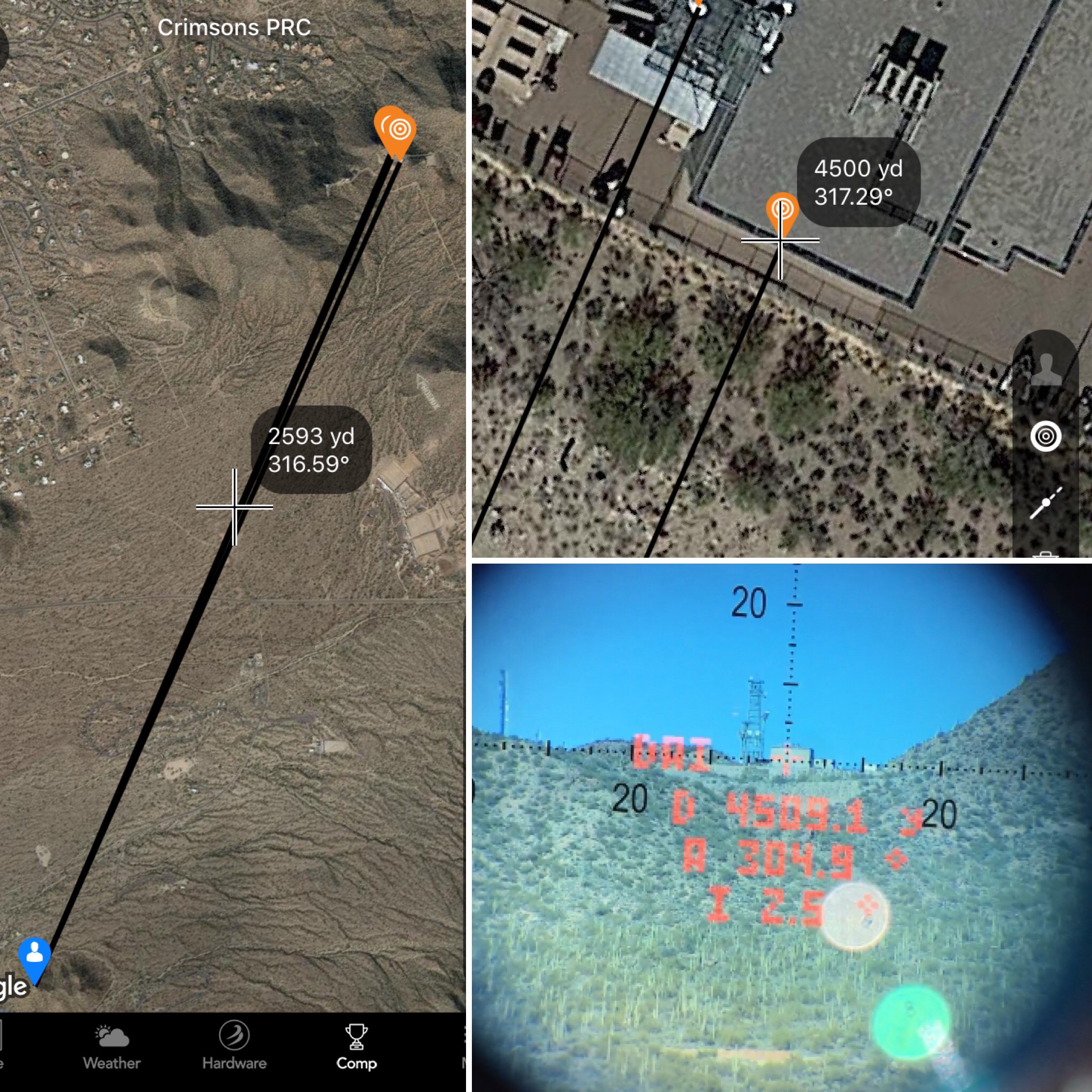

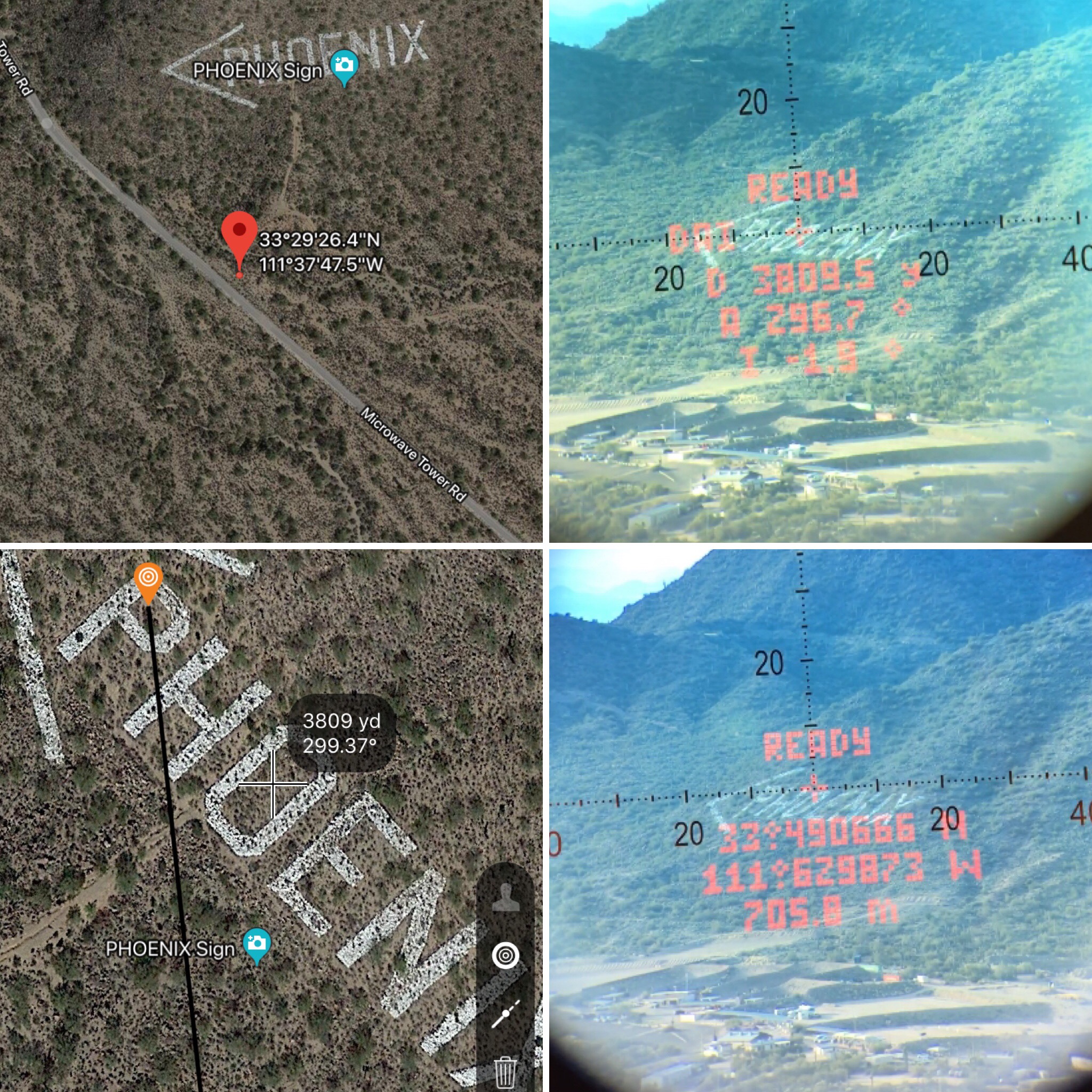

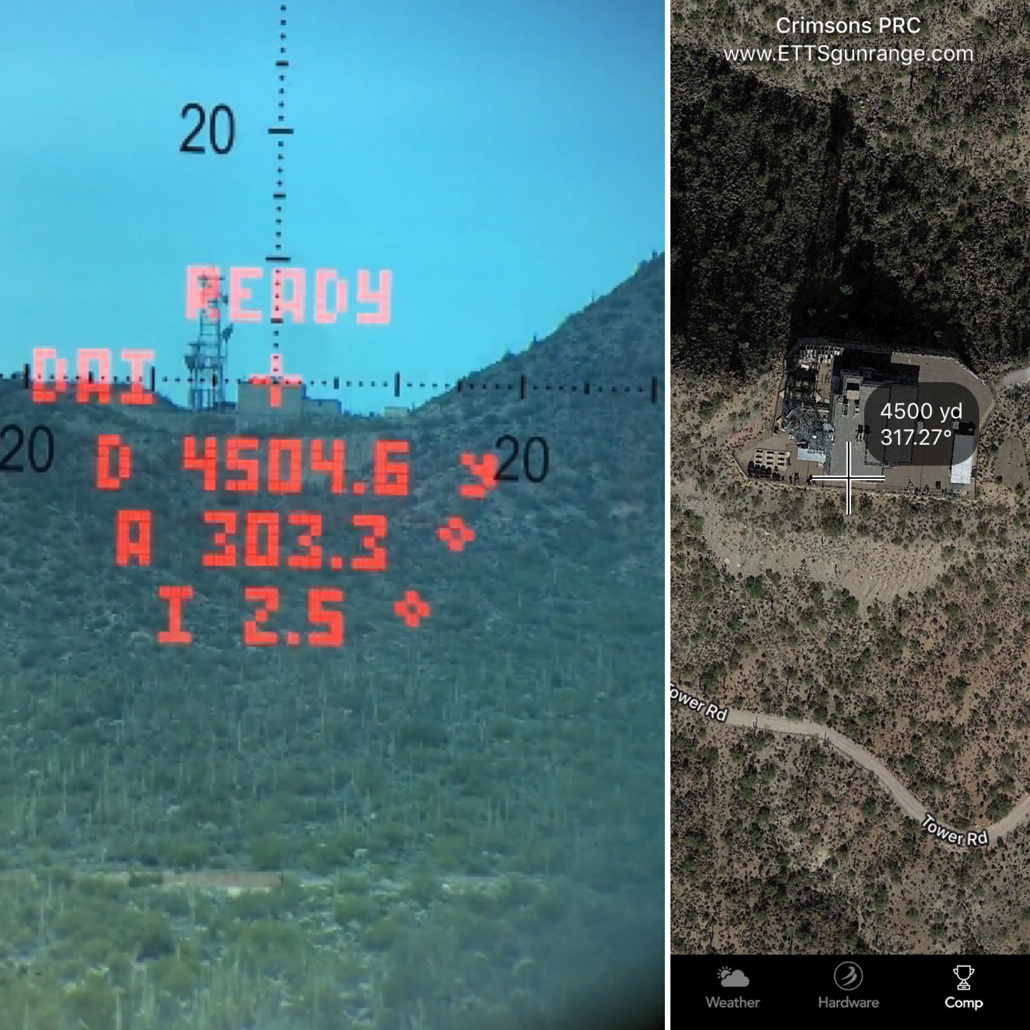

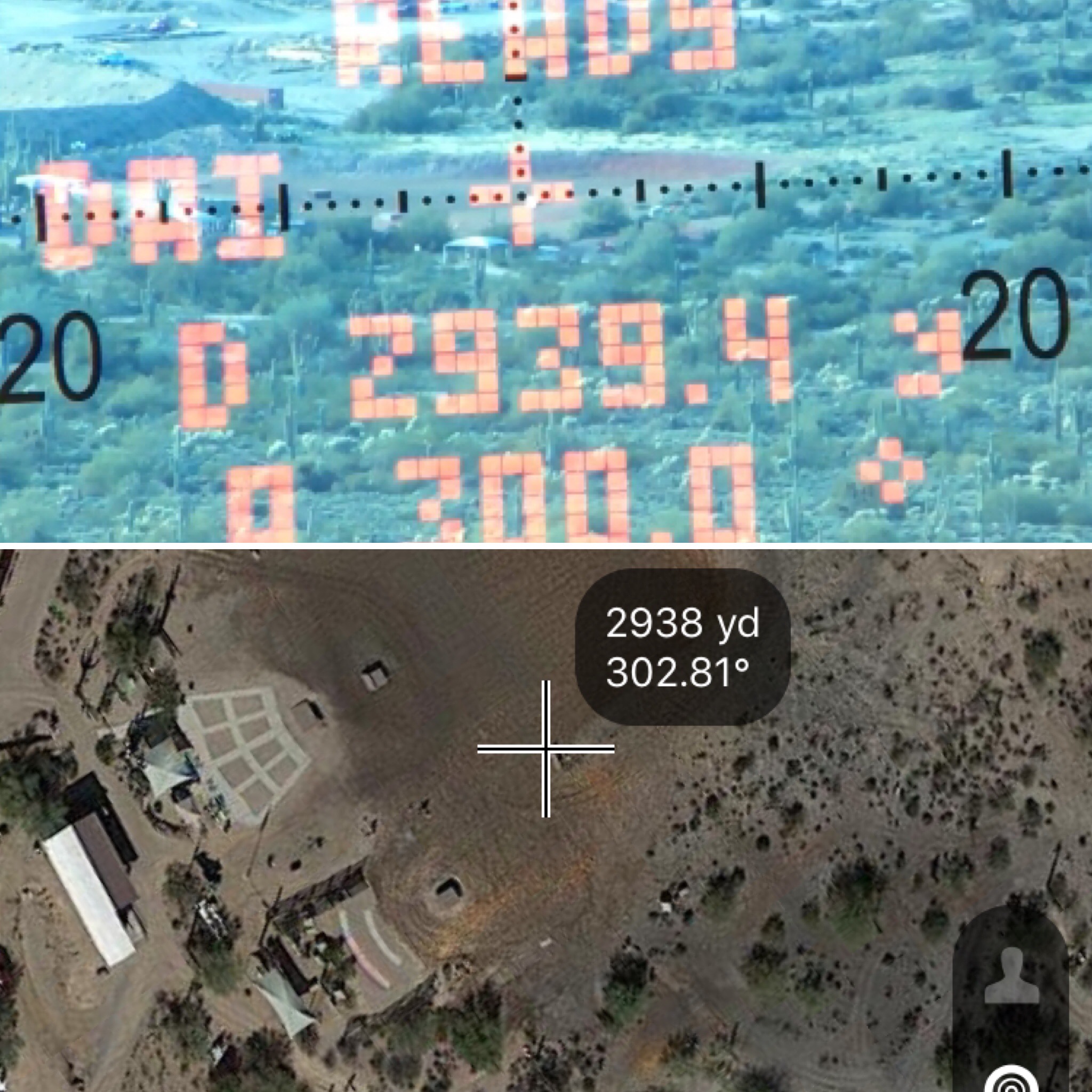

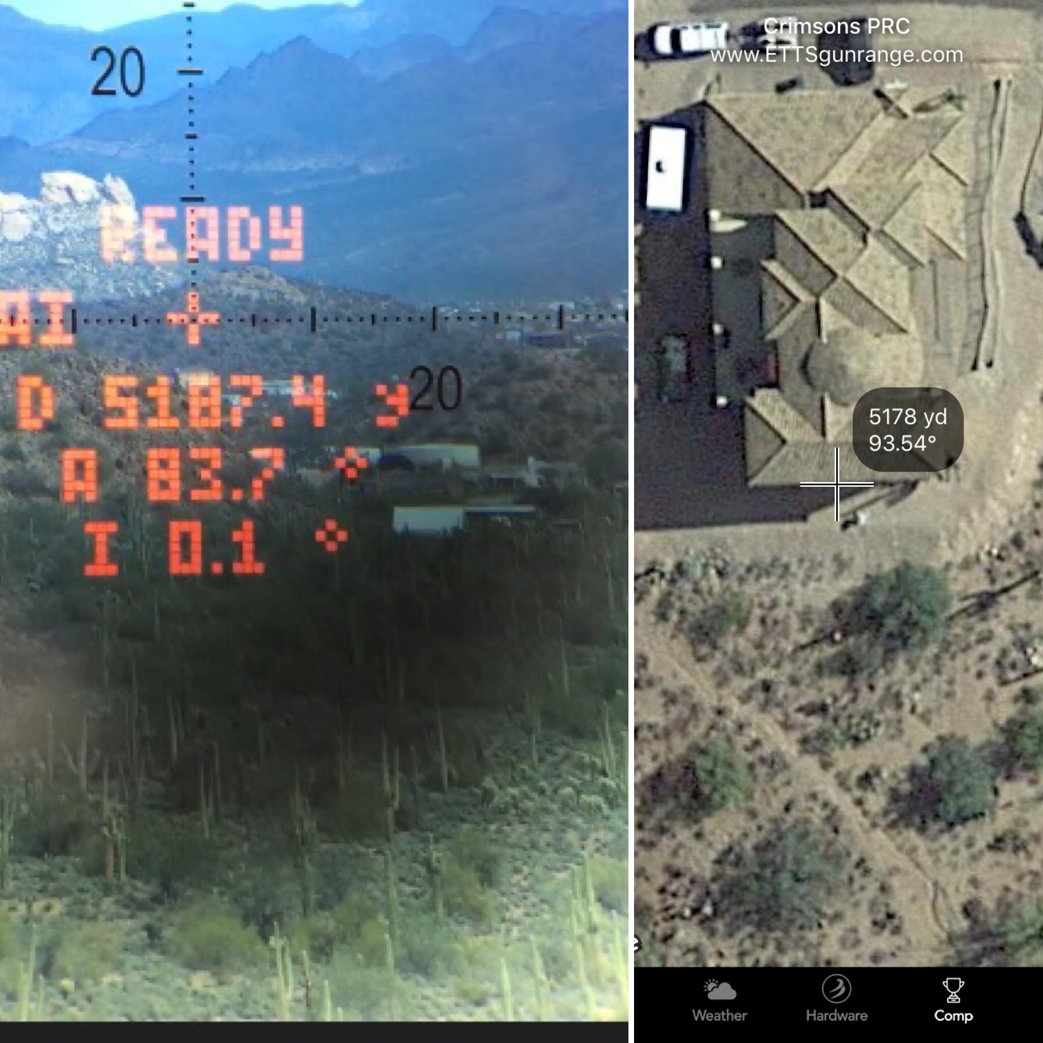

Hiked to a different spot to do some ranging.
Ranged an antenna off a cellphone tower
Ranged a steel plate that was less than MOA. This was a hard one to get steady off my cheap tripod. It got returns all day.
Tested out the TGT GPS after updating my magVar
Hit another steel plate that was bigger than MOA. No idea how big.

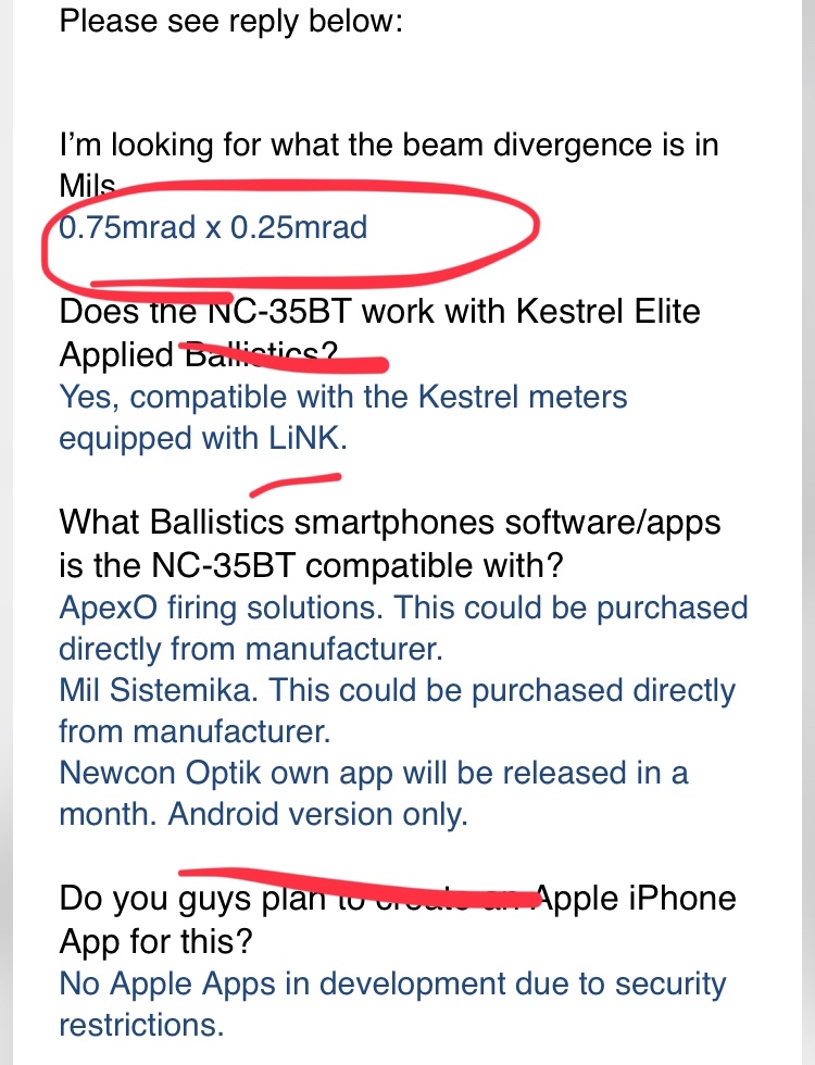

WOW !!!! That is so coooooool . If you get a chance do you think you would be able to try it out on deer/coyotes ? I need one that will range a coyote at 1300-1400 yards or so . The only one I have seen which would do this is a vectronix.
If the stated beam divergence is correct it should have no problem( 0.75 mils x 0.25 mils) ..

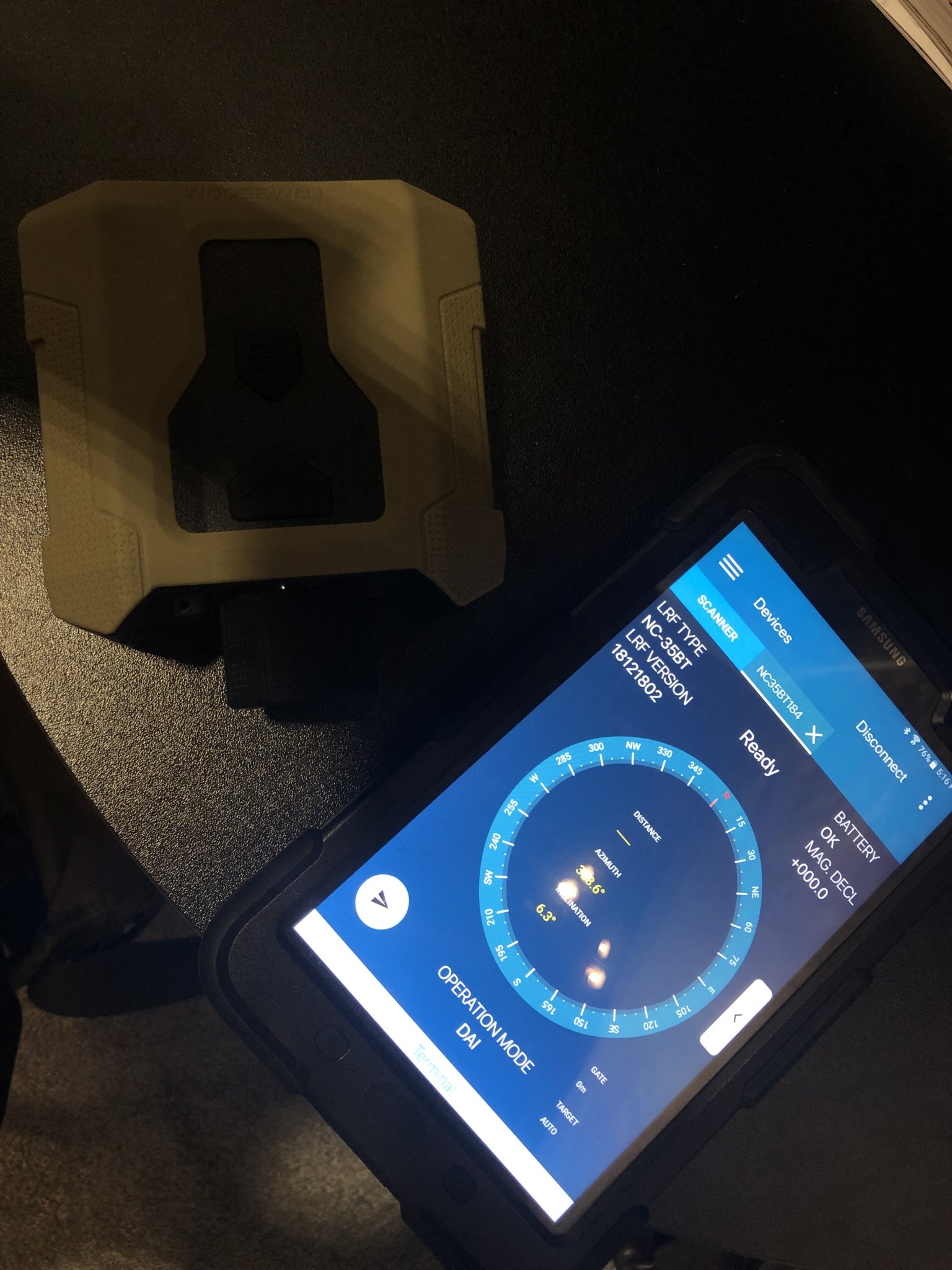

Have you tried linking it with a kestrel or any other ballistic computer/app yet?
I’ve connected it to my Kestrel Elite. Works as advertised.

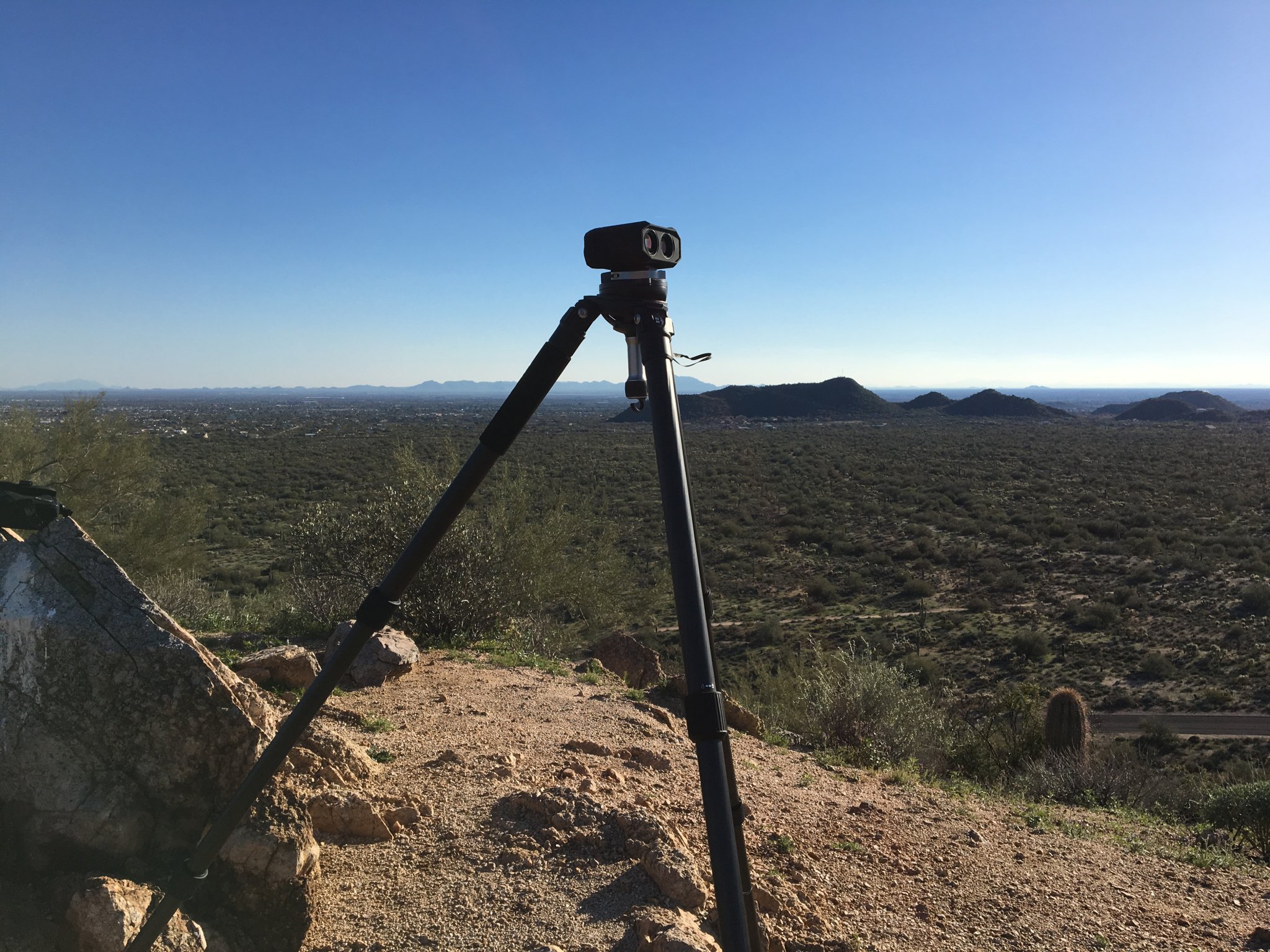

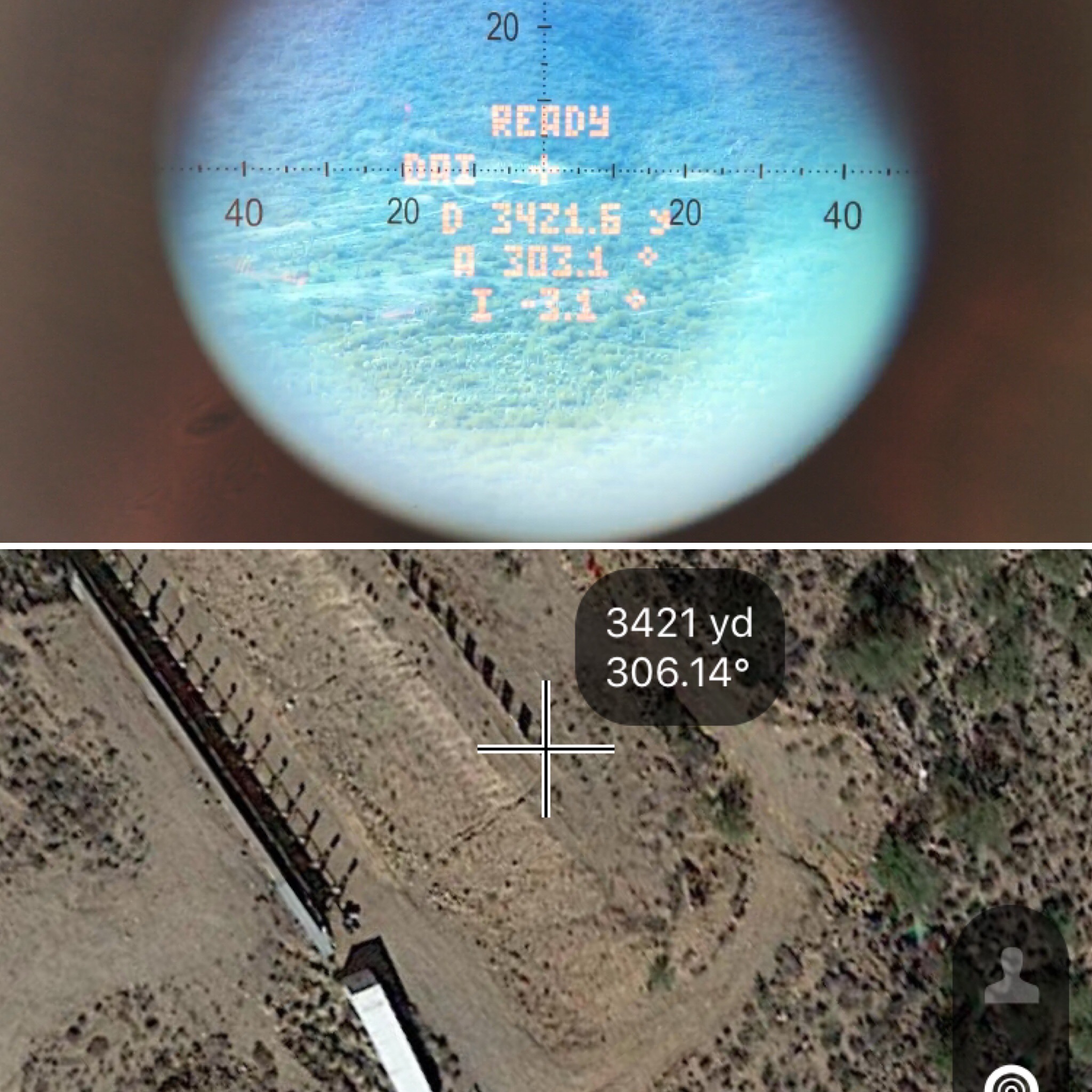

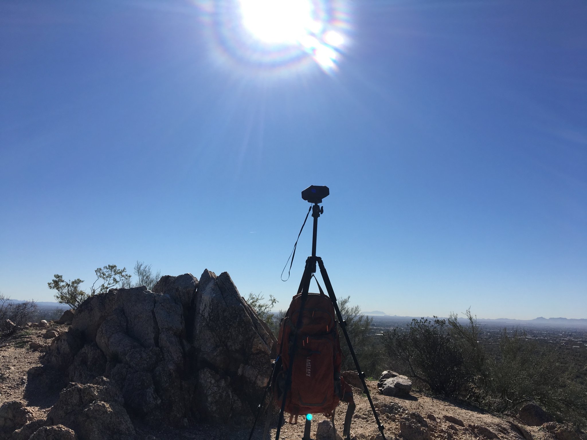

Took the LRM out today with my new tripod and RRS Leveling base. Nothing significant to report. The LRM performance is awesome so I didn’t bother taking screen shots of map data and ranges to over lay.
I was able to range a 1moa white steel target from 3426yds away. The leveling base and tripod made it steady enough and I referenced it to the google map data and it was within 1 yd. (it may have been smaller than 1moa. Can’t tell because the center dot is 1moa. Either way the center dot covered the target and I got a reading within 1yd referenced to google map data)
One thing I’ve notice is the LRM doesn’t care if the sun is out and beaming light into the transmitter or receiver lenses. It performs the same if it’s overcast or bright out.
Considering all my ranges are done in Arizona, we have plenty of sun to go around.
I don’t need any more convincing. I made a good purchase.
