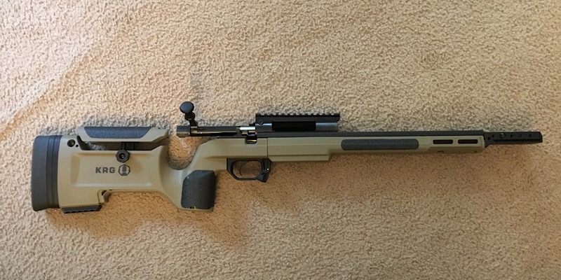

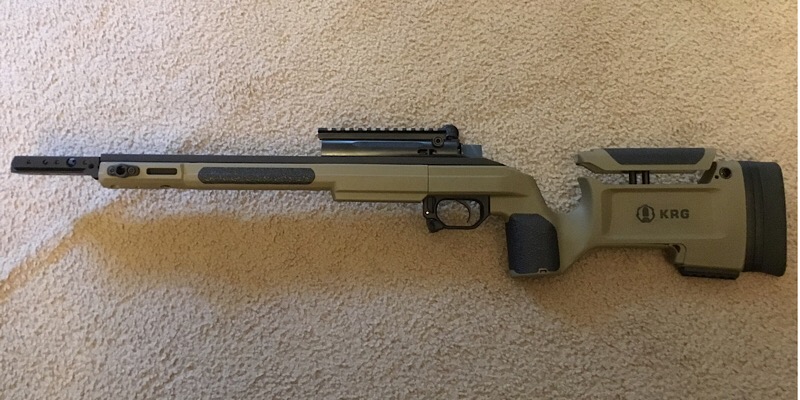

I picked my nucleus up today. It seems as if ARC fixed what my buddy liked to call the "Pussy Finger" problem with the bolt release. His nucleus was an early delivery, and I couldn’t rotate his for the life of me. I have no problem what so ever rotating the bolt release on my action. It is so much better. I just dropped it into my bravo and it feels amazing. It’s my first custom action, but I really really like it. I love the Bravo chassis. The ergos on it are amazing for the price point. And the grip tape I put on it makes a big difference in texture. Well done ARC and KRG.
Now I’m just waiting on my barrel and I’ll be ready to rock. Once the barrel comes in, I’ll throw the Burris XTRii and Vortex rings on top of it and see how it shoots. I really think it’s coming along very well. I’m crazy excited now and can’t wait to finish her up.

What grip tape is that? Did you put the grip tape on the cheek piece too?
