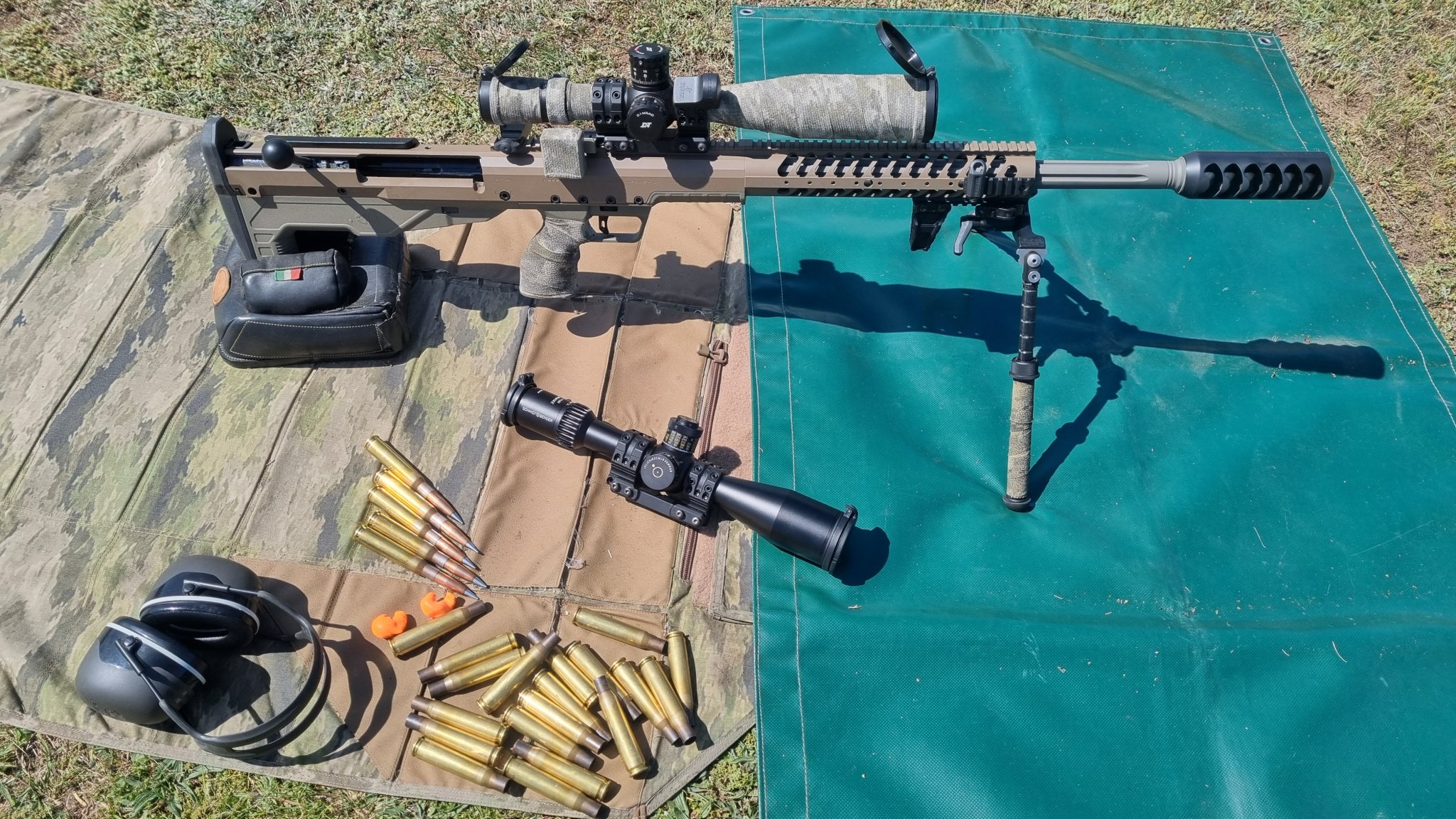

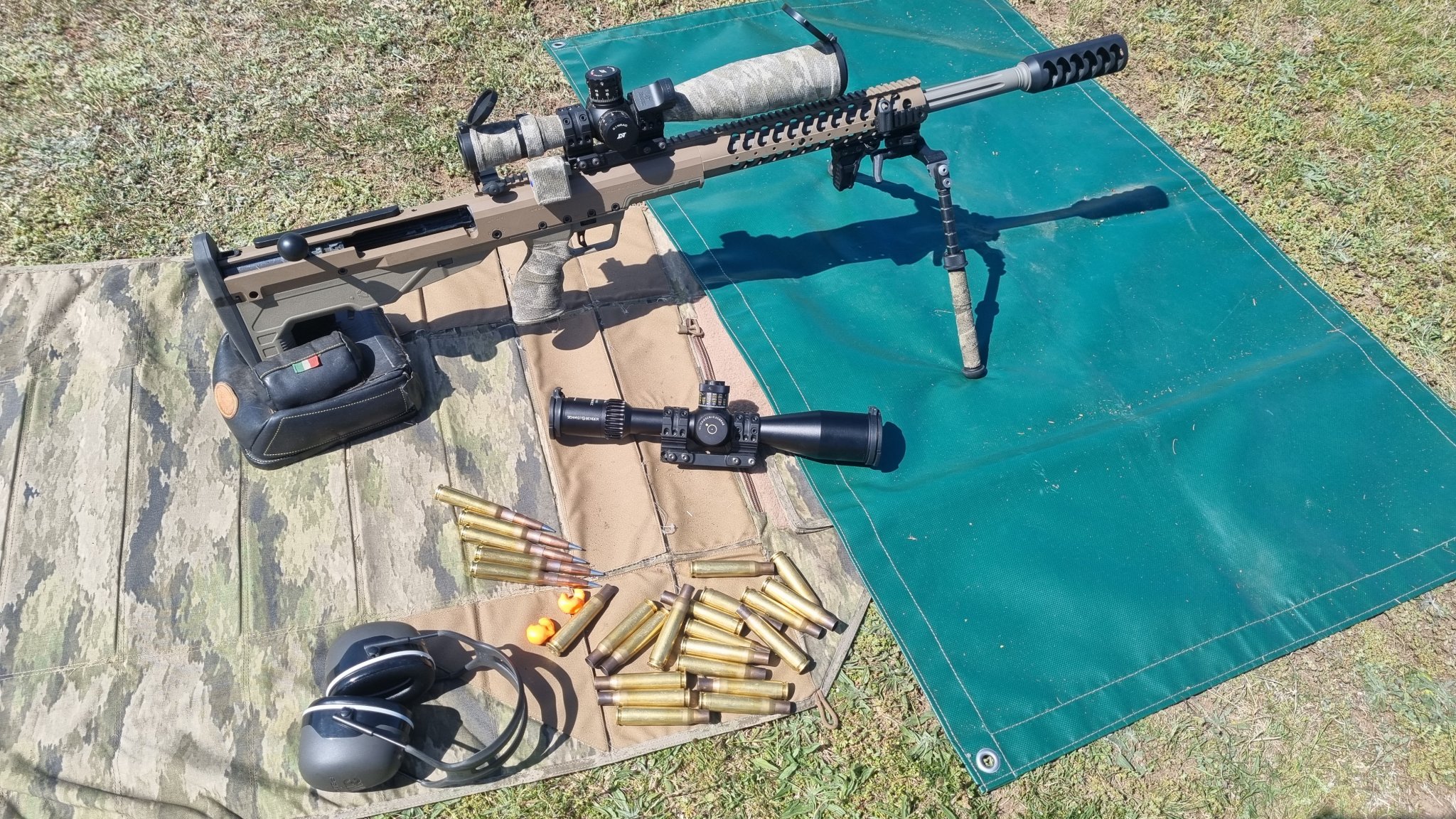

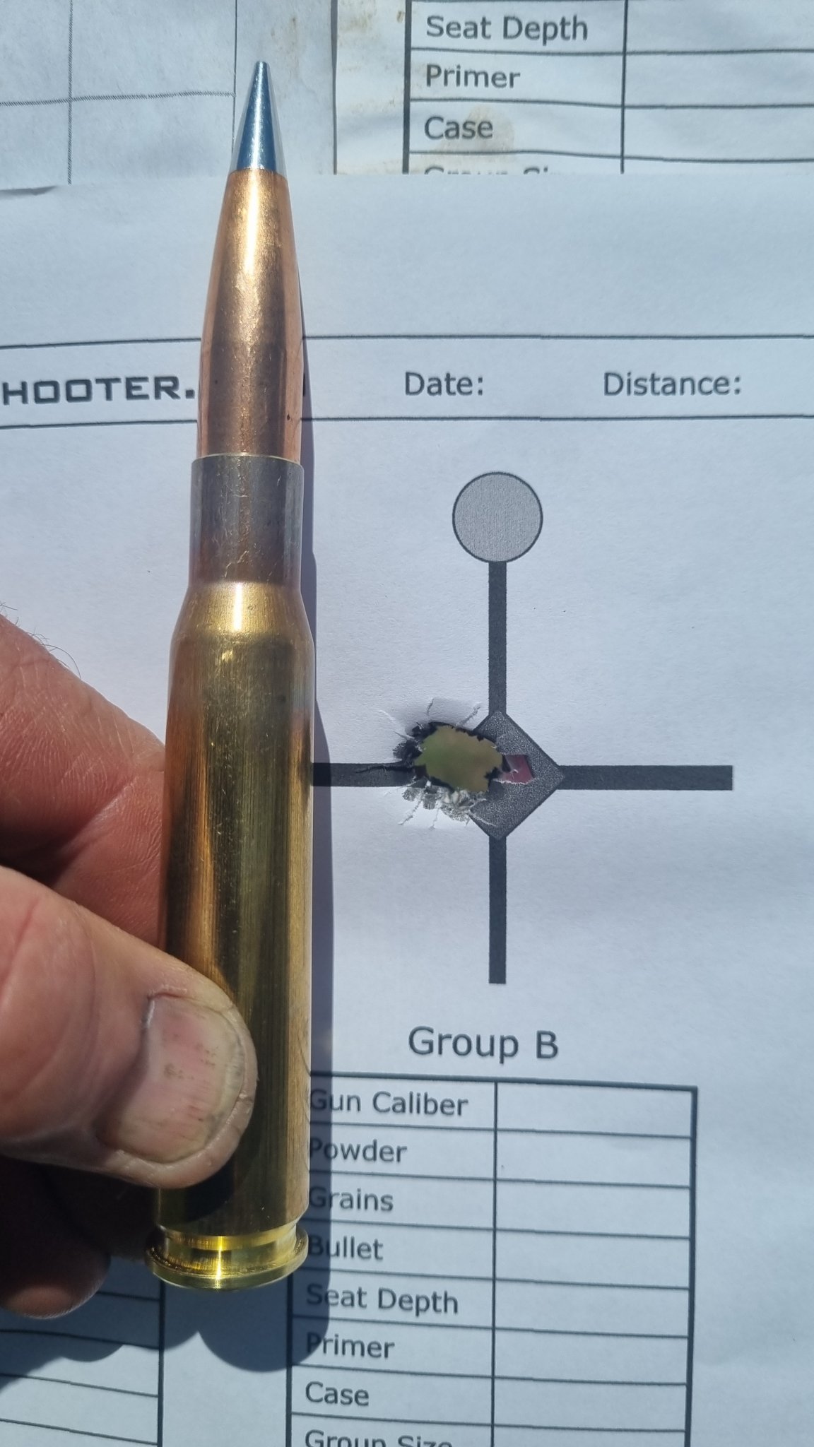

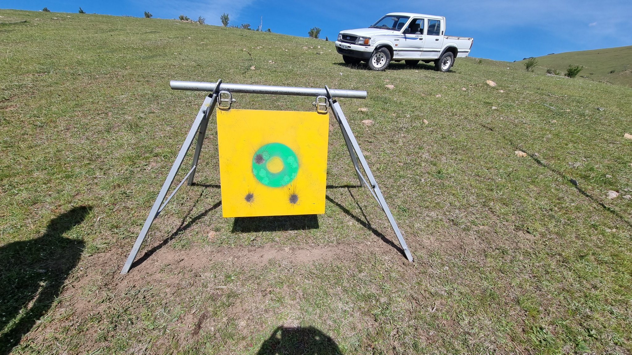

New load for the 50.. 750 Amax 226gr AR 2218....COL..5.920" RWS case , RWS Primer
3 shots at 110yds

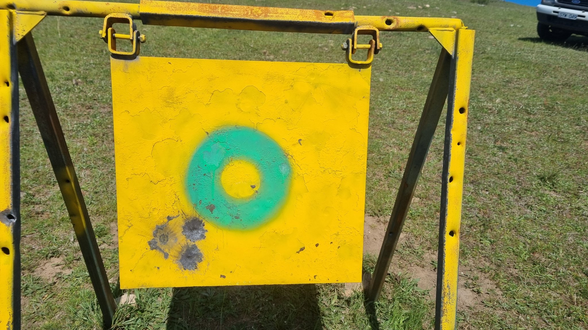

1200yds

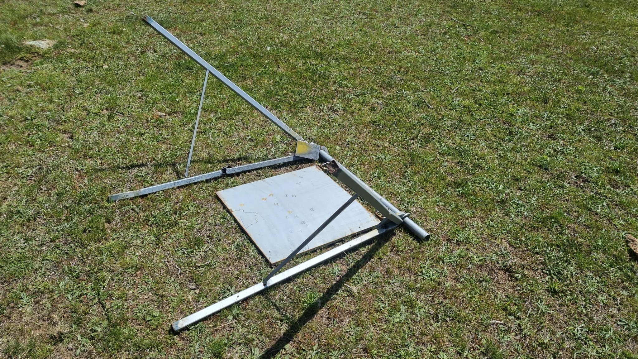

2000yds
The 50 had enough energy at 2000yds to swing the 16mm thick plate with one of the lower hits to topple it!!

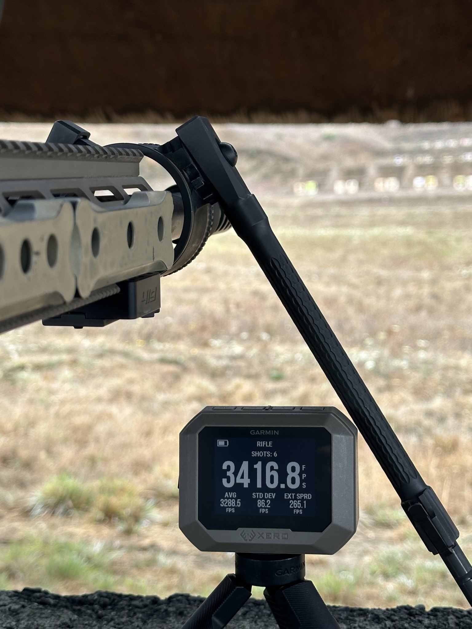

Doing some initial tests with that 26” .300NM Proof Carbon barrel I got from @PRDRIVER
Did some pressure testing with N165 pushing 176 A-Tips and 178 ELD-X since I have boatloads. Wow, kind of amazed I could get into 3400 fps with no pressure and using a single-base powder. These were really pleasant to shoot compared to some hot 220 LRHT loads I had from a long burned out barrel.
I had a barrel made with a custom chamber throated to the longest length I could seat a 215 Berger in a 300WM case for more powder capicity with H1000. With 78.9 grains its running 2897 on average with no issues. That velocity is smoking with 175's. How many mils to 1000yds?
About 5 mils.
Super fast light bullets slow down faster, so it’s not really intended for ELR, but should be fun for the inside of 1200 yards spot I shoot most frequently day/night. My other two barrels are truck axles and so insanely accurate I want to preserve them for ELR as much as possible. With a .338 suppressor this thing is going to be a kitten.

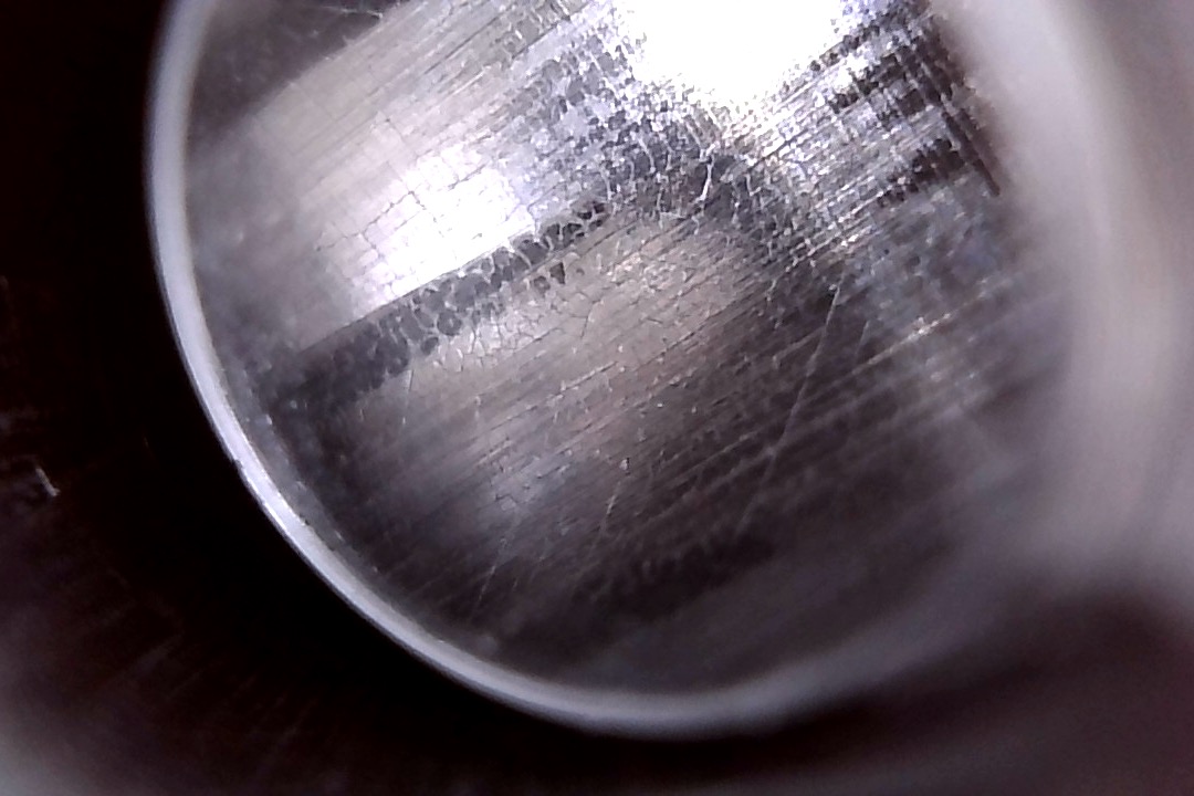

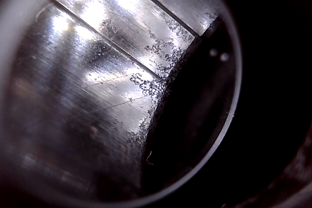

I found that my .375 factory barrel performs the best after at LEAST 20 rounds. However I’m hearing from reputable sources on this forum that the carbon should be cleaned out after shooting to prevent rusting in the barrel and the barrel should have a few patches soaked with Hopes afterwards. Problem with doing that is I have to get the bore really dirty again before it goes back to shooting 1/2 MOA with a single digit ES.
Would applying Lock Ease colloidal graphite help with this issue?
Of course this is an age old debate but I never clean a barrel until accuracy drops off. Nothing, not even an oily patch. Most of my barrels go hundreds of rounds before I find the need to clean them.
I usually shoot around 50-60 shots max , through my 375...then completely clean ( carbon /copper) and store with Hoppes. #9
Just shy of 2000 rounds on my factory barrel........ still less than 1/2 moa.

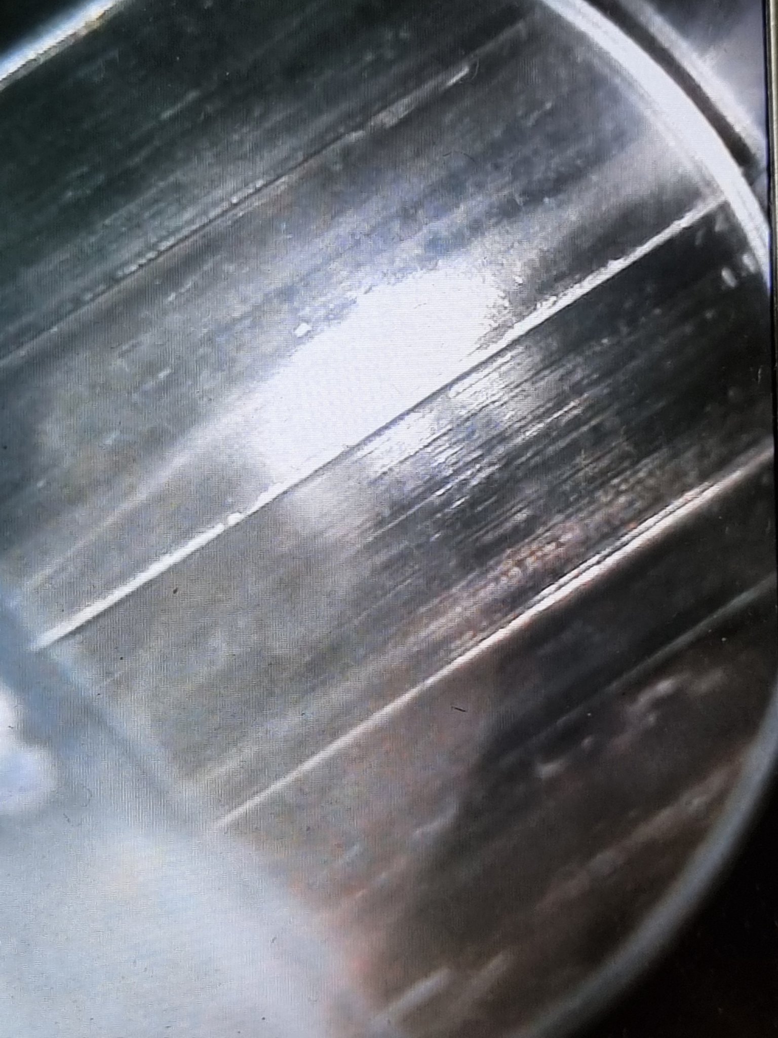

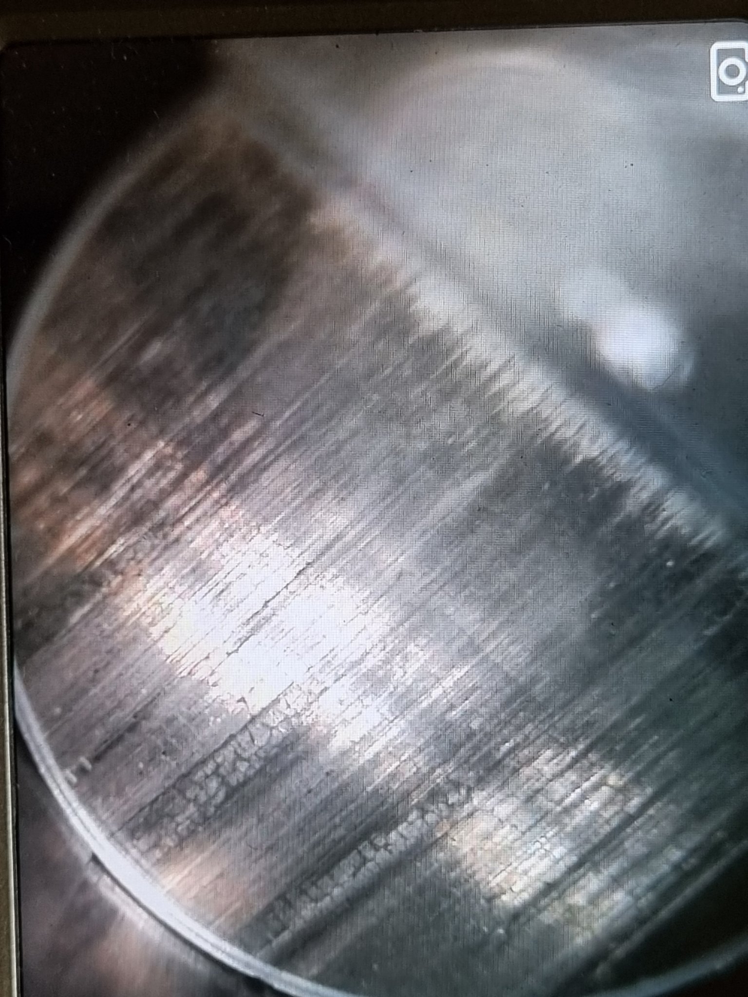

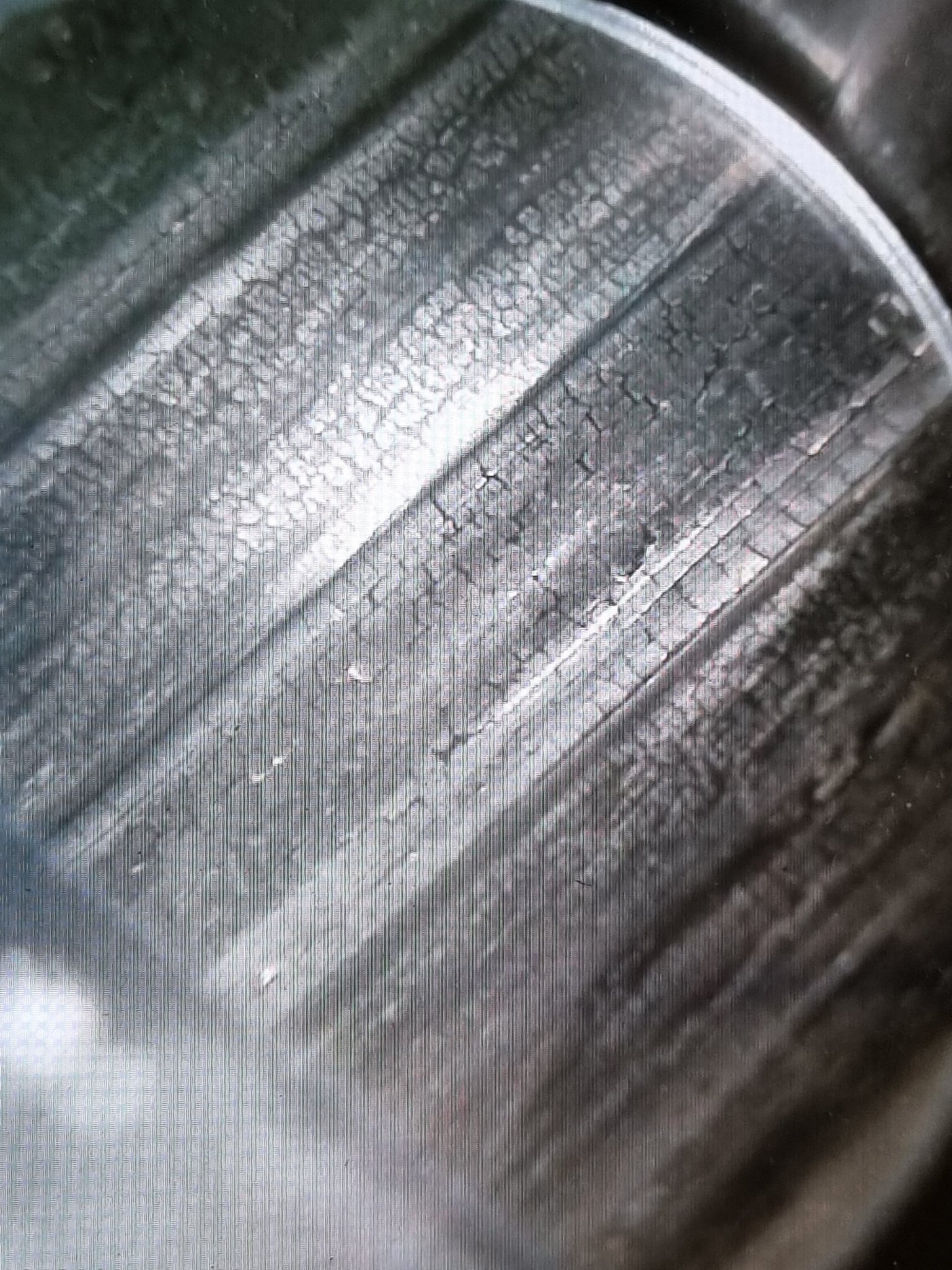

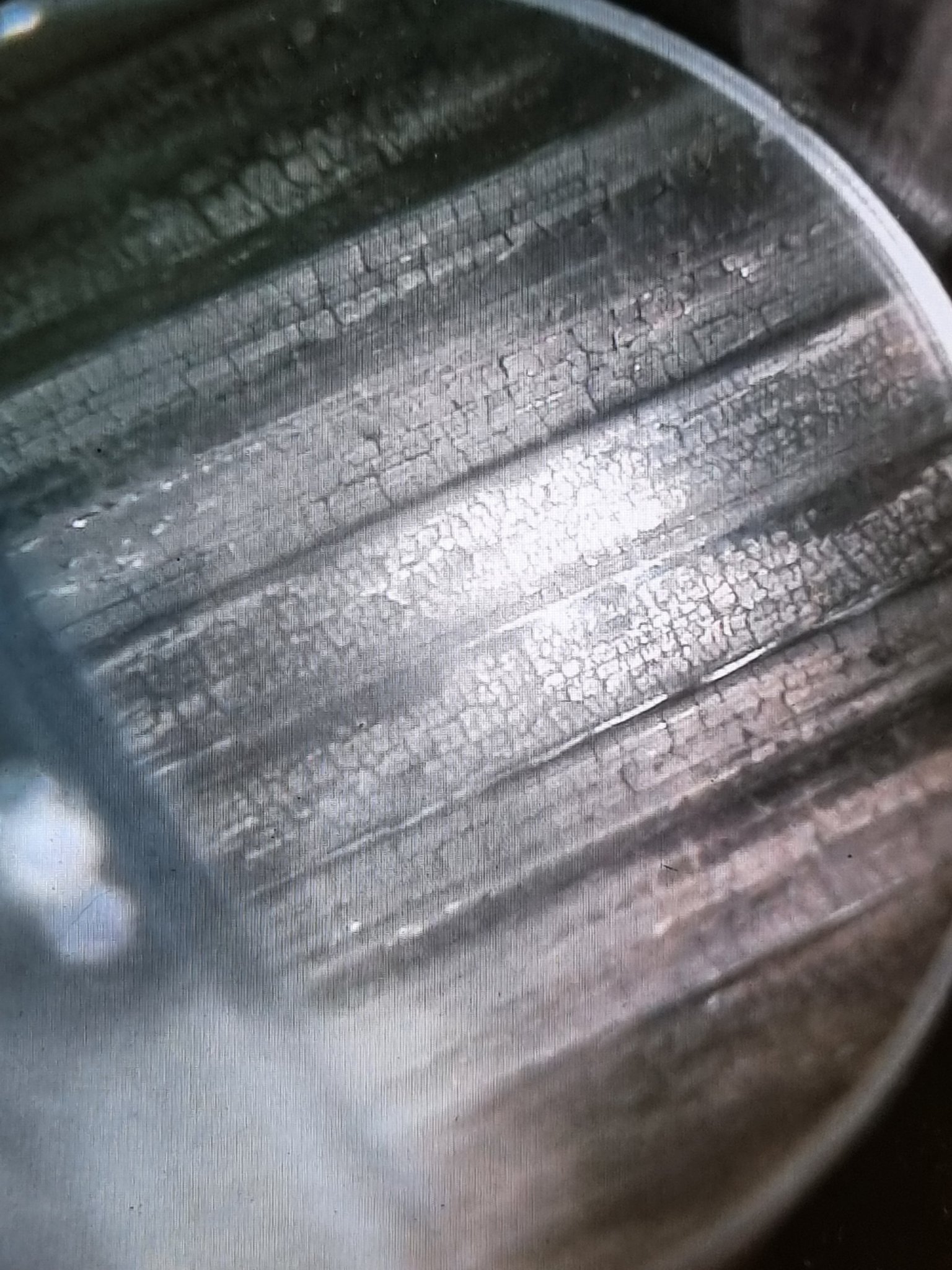

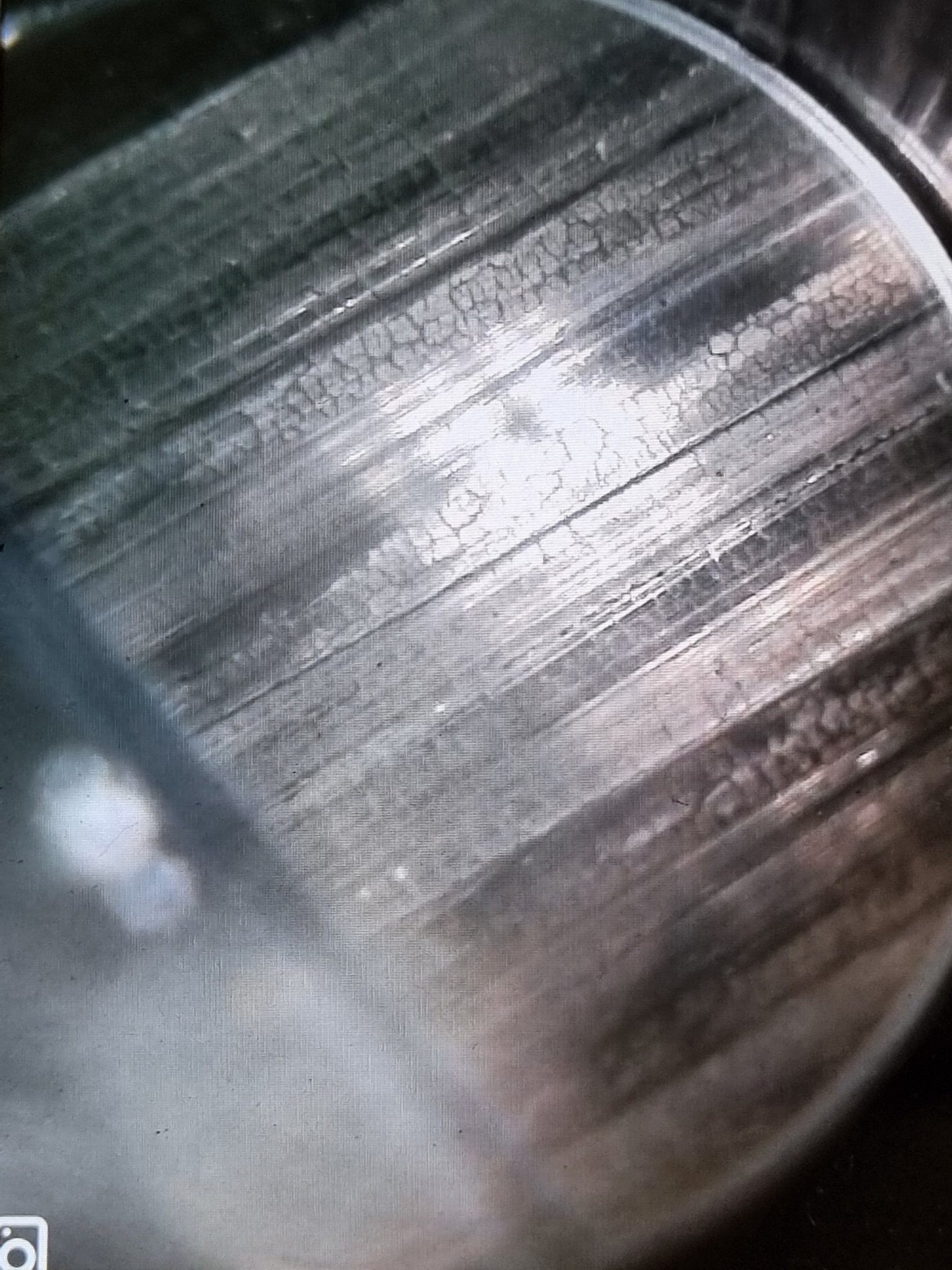

This is around the 1800 mark.... still sharp defined ....just heavily firecracked.

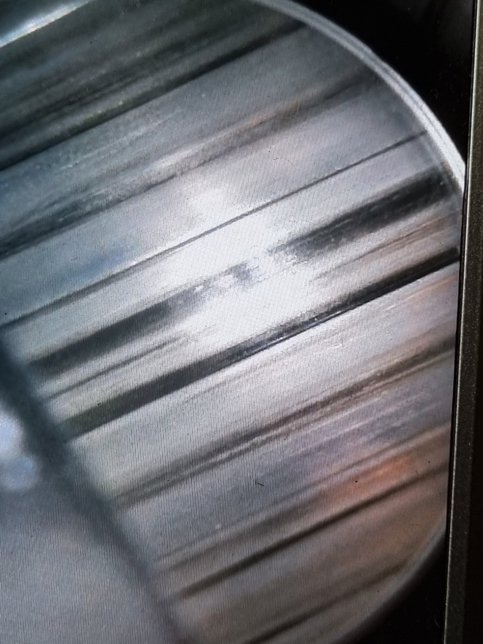

Anecdotal. I have found there is only some correlation between what the barrel looks like inside and how it shoots. Tooling marks, fire cracking, filiform erosion and yet this barrel still shoots sub MOA on my Tikka. I think only guys at the Frank Green level can make sense of this stuff.
This is my experience. And speaking of Frank, he is the one the guys that recommended cleaning last with a Hops patch, my barrels have been rusts free since. After a good scrub down I loose my zero and it require 7-10 shots before the barrel settles back to it's last confirmed zero. If you listen to Hodnet, he just takes a carbon remover through and calls it a day.
