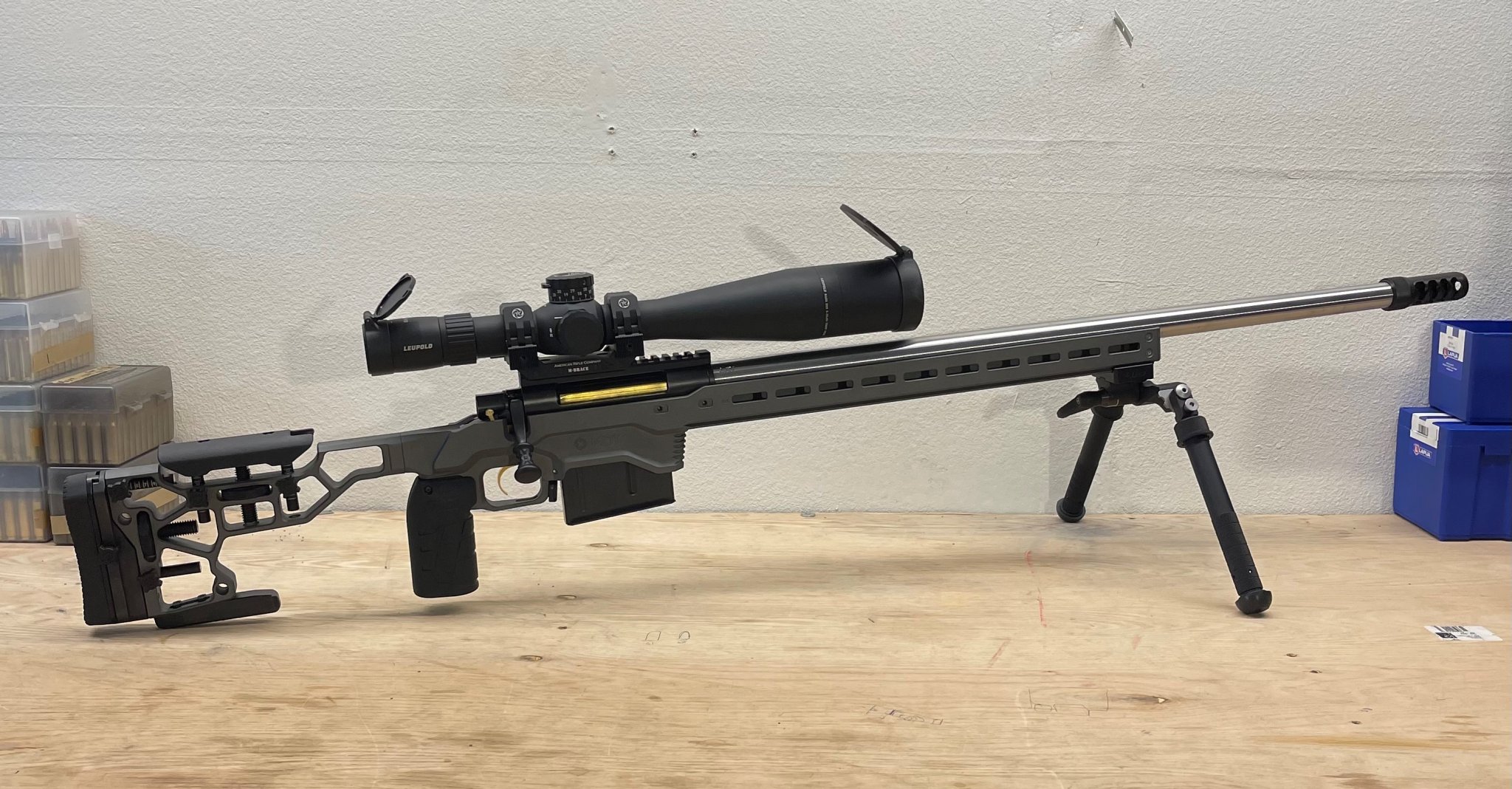

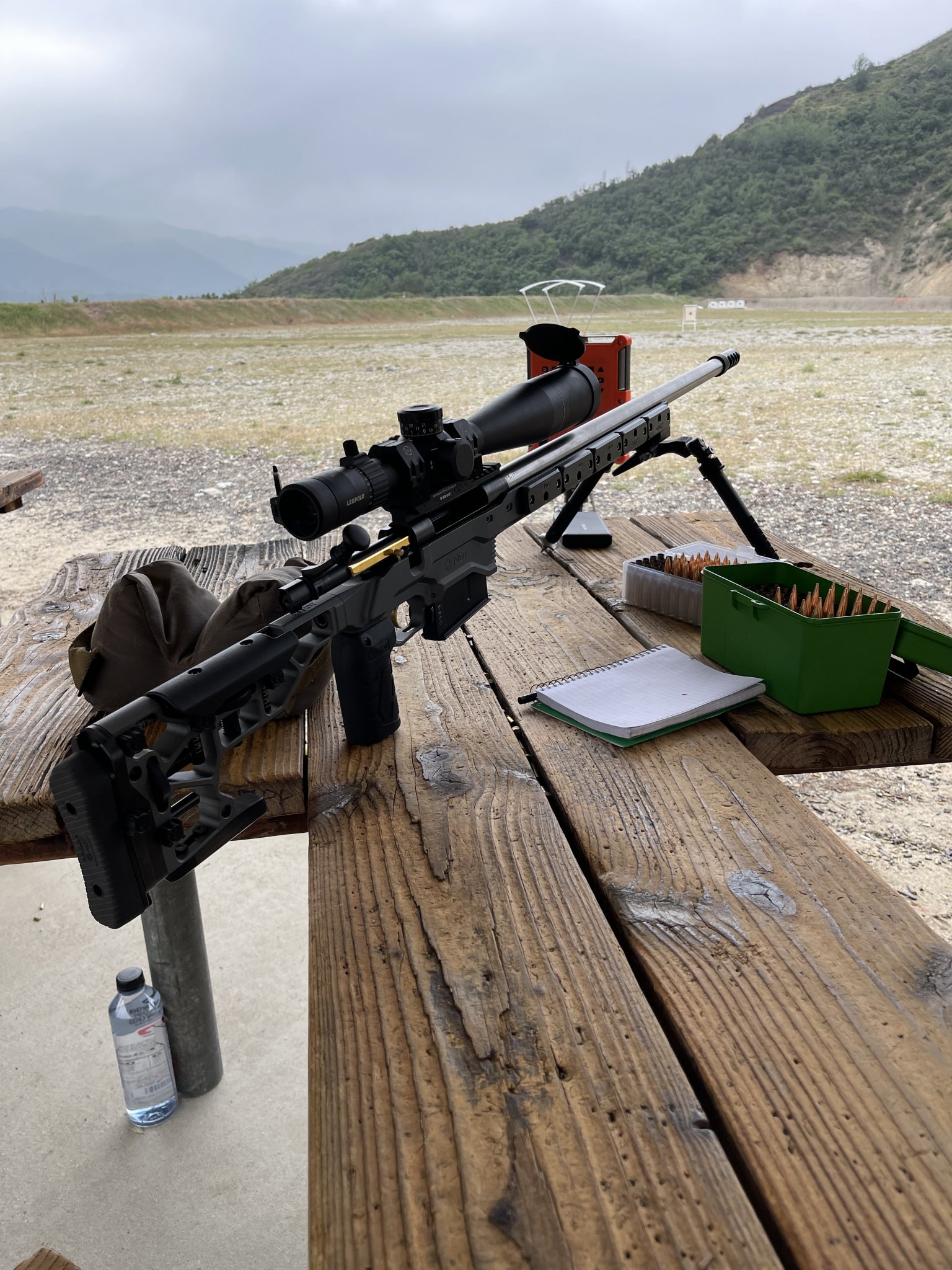

    What do you guys think of my 1 of a kind black and gold edition Mausingfield?
    For the record ARC did not recommend TiN coating the extractor. I bought a spare with my action and had it coated.
    Also had the Gold Edition Triggertech!
    Super pumped on this build!!!!
    That’s interesting. I have a customer that’s sending me a Mausingfield extractor to Cerakote to get the TiNi look. Mixing up a custom color didn’t take too long and it’s a pretty good match.
    Reactions: bbhank
    Don't know about an extractor in a bolt gun, but I have a high end 1911 with a tin barrel and after about 3000 rounds it still looks new. Just wipes clean after a range session.
    Build Specs:
    Mausingfield
    .338 Norma Rogue Improved with Bore-Rider throat
    TriggerTech Gold edition
    K&P MTU 1/9 twist barrel 28"
    Area 419 Magnum brake
    MDT ACC Chassis
    For those of you who are still hating on my Improved Savage style, you should know: your mom loved it!!!!!

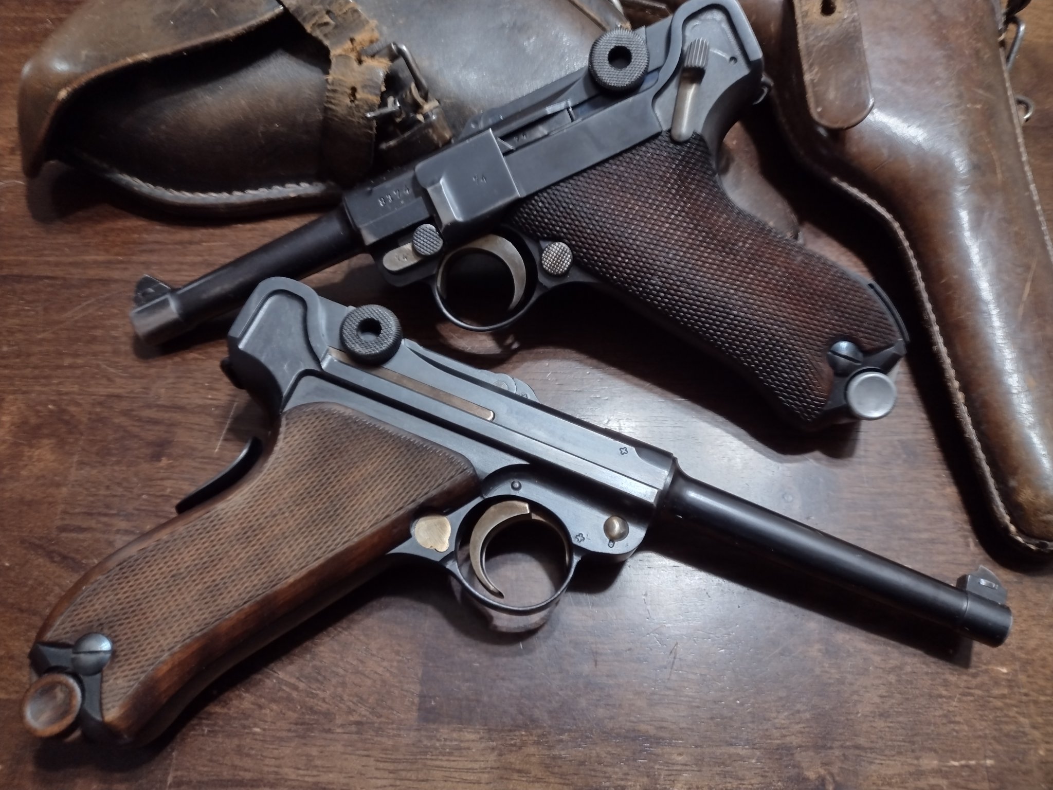

    Seems to be fine for 85-100+ years...
    TiN is tougher, don't get me wrong... But not much of the visible portion of the extractor rubs, especially the 'new' MF's.
    Pretty sure those Lugers would have a form of case hardening which is a type of surface treatment, steel will colour under heat but without case hardening it’s not at all durable.
    As for the bolt part, I mistaking thought the entire bolt was done in gold and not just the extractor. Agreed that the extractor doesn’t rub much.

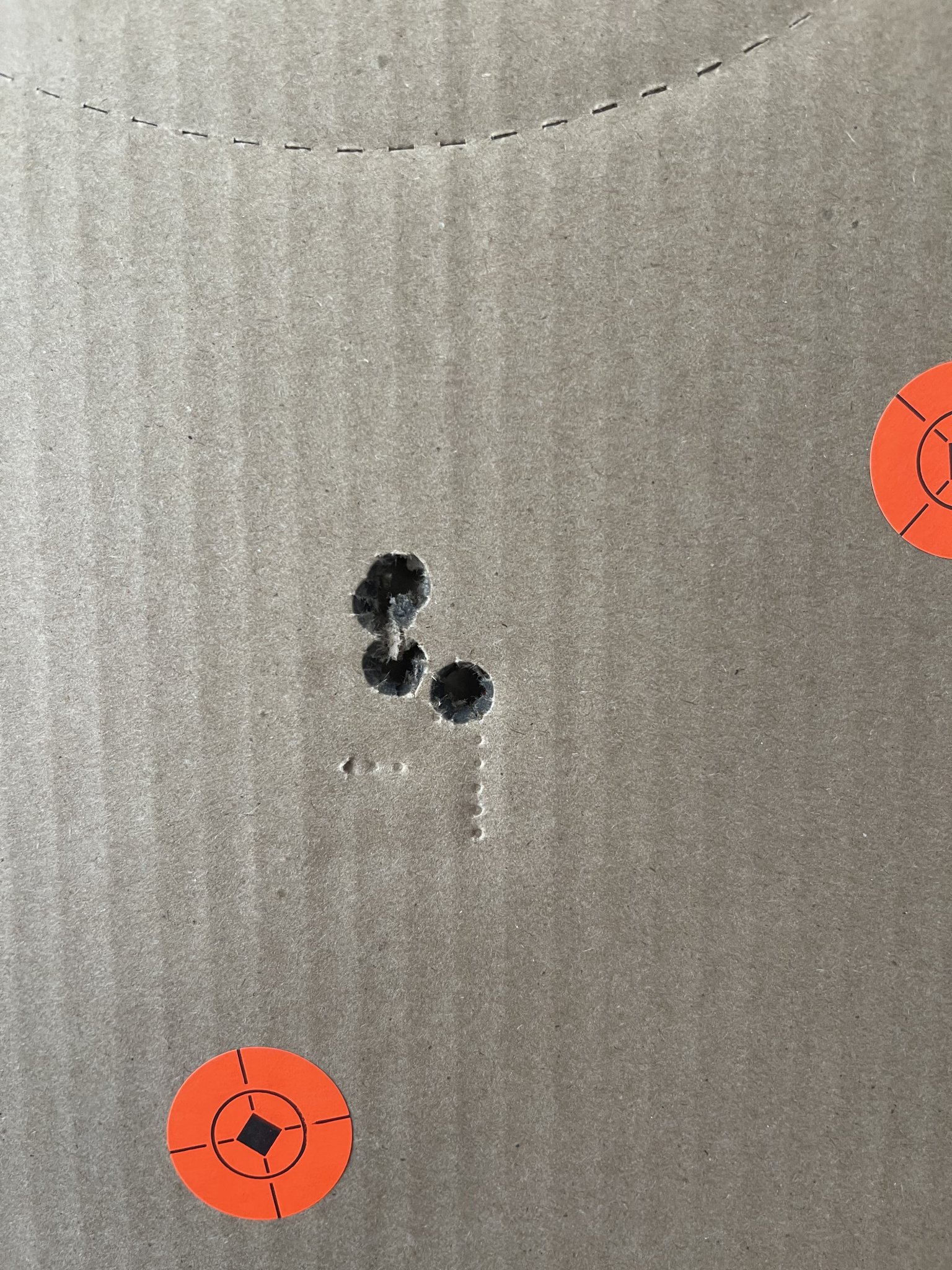

    Made it back to the range on Sunday for more fire-forming.
    So far the rifle is showing real promise. The group attached was 4 shot .4 Moa and 5 Shot .60 Moa group, with an SD of 10.3. I think thats pretty awesome consider how much the case is moving while I'm fire forming.
    We also saw a bald eagle in the trees on the way to the range. They are starting to become common for me here in SoCal, they are awesome creatures.
    I'll bring my spotter and phone scope next time for a better photo!

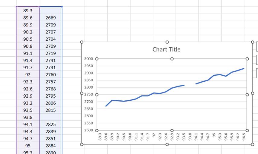

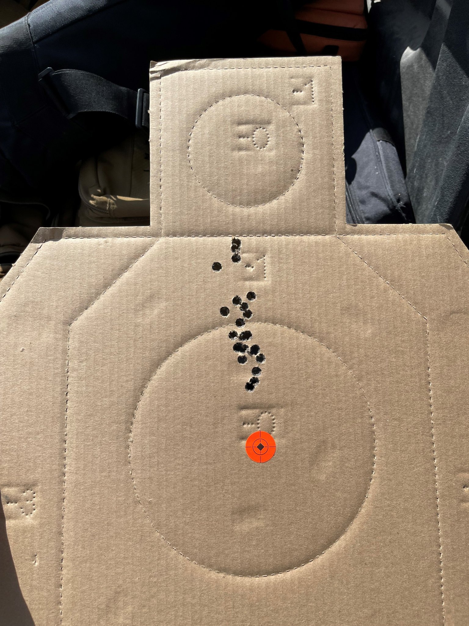

    Finally got my Whidden custom die yesterday so I worked up a Satterlee test to find pressure.
    I loaded in 3/10th increments from 89.3 to 96.5. My Lab Radar didn't pick up two rounds but I got a velocity of 2931 @ 96.5 of Retumbo with a Berger 300 OTM. The last few rounds were crunchy when I seated them, however by the time they got to the range they had enough space for me to hear powder when I shook them.
    No signs of pressure even at 96.5 so I am going to try a drop tube and see what else I can squeak out of it.
    PLEASE REMEMBER THIS IS AN IMPROVED .338 NORMA NOT A STANDARD SAAMI NORMA. So don't duplicate my data in your loads.
    Here is pic of the target!

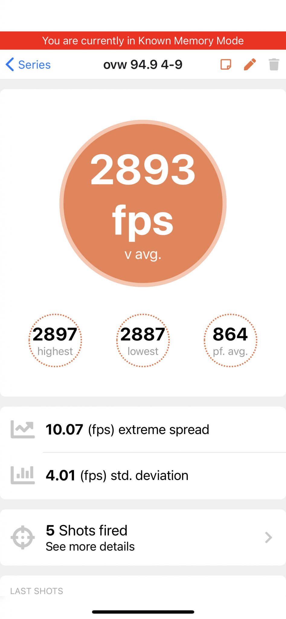

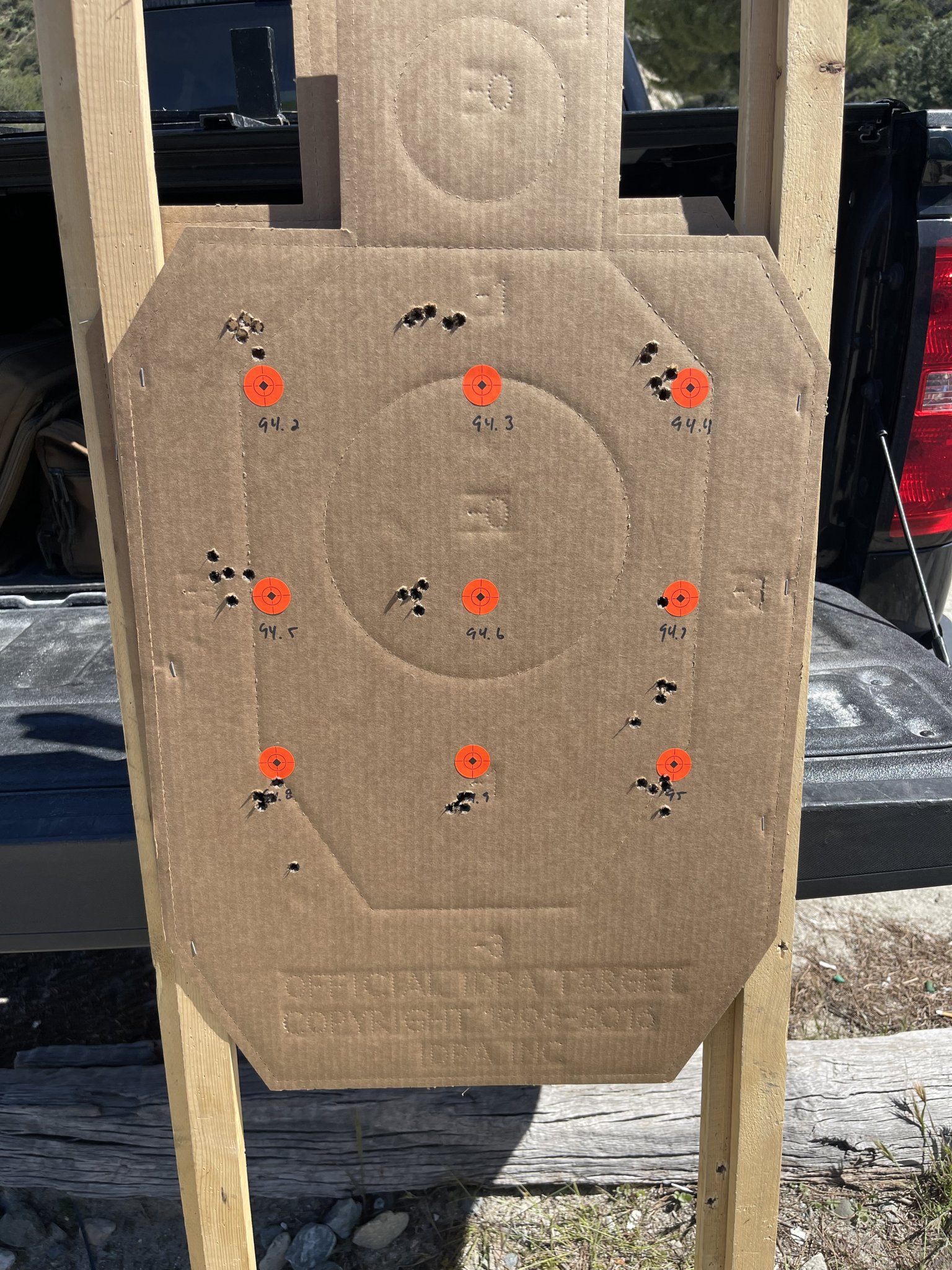

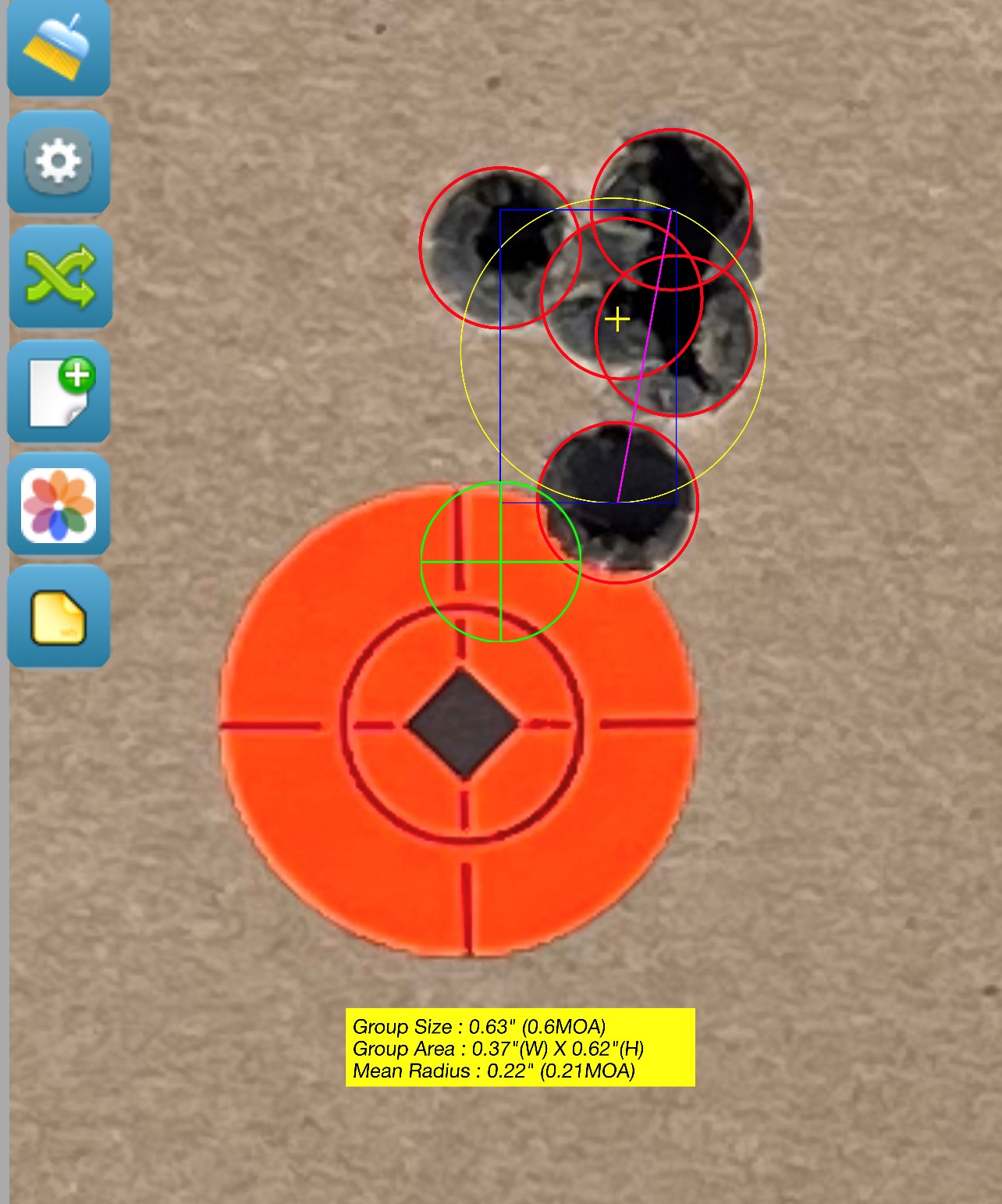

    Got my overall charge weight test completed
    Saturday I went out and tested 95.1-96 grains and the rifle was super violent, shook the action screws loose and didn't print any decent groups.
    Sunday I tested 94.1-95 and got a 1/2" group with an SD of 4.01 and a ES 10.07
